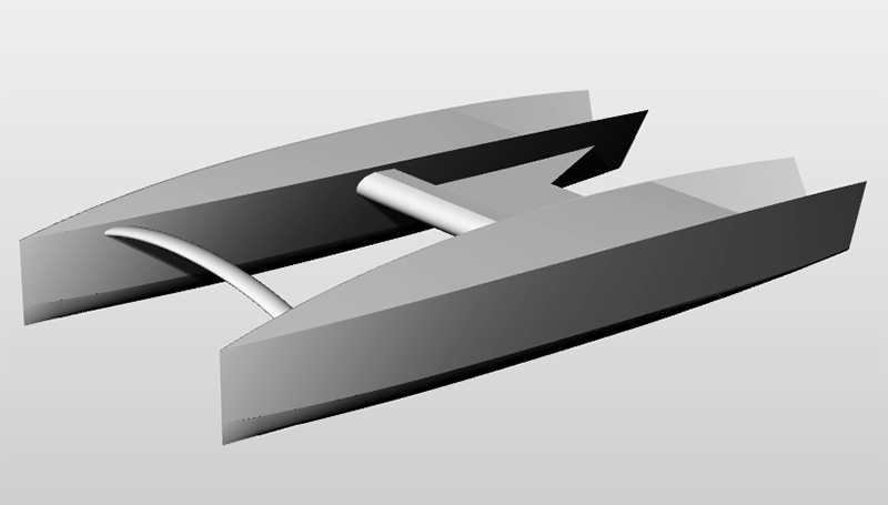

    This is an open bridgedeck so the engineering is tough but the weight penalty is minor (maybe). Trying hard to minimize the complexity of control surfaces by raising the natural efficiency of the boat.
    With enough computing power and active surfaces you could make a 4 m beam work but if things fail or wave heights exceed the design envelope then the design is going to work against you.
    There must be some sweet spot where the basic boat is great and the active stuff provides the stability/comfort that allows you to keep driving.

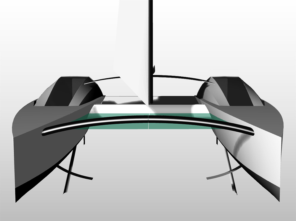

    Why would you turn the lifting foils inward rather than outward?
    The advantages to outward
    1 Greater contribution to righting and greater damping of healing motion. Foils actually make thrust out of pitching as long as the AOA is less than ~14 deg.
    2 Naturally deeper position on a healing boat -and your design has a problem getting the foil deep enough even before it gets major lift.
    3 The housing, and deployment mechanisms of the vertical and horizontal foils pack close together and combine, rather than opposing and pinching off the narrow hull as you presently show.
    My last thought is that the benefit of this concept is too subtle. The benefit is speed, reduced drag of reduced displacement vs increased induced drag and cost. My inclination is to make a design that can get the hull above the water and a hull that goes in and out of the water smoothly. A deep V instead of trying to minimize whetted surface area. If you are going to fly, then fly. If you are going to displace....

    I have considered outward rather than inward however once the boat is heeled- dont the foils then produce a component of lift to leeward rather than windward on inboard side? This was the main reason i initially opted for the inward position...
    Also, the main reason for this is not just speed. Its equally important for the improved seakeeping characteristic which makes life at sea much more comfortable...
  6. Skyak
    Joined: Jul 2012
    Posts: 1,203
    Location: United States
    Skyak Senior Member
    They most likely will have a small component to lee ~sine of the heel angle. Inward will also tilt with heel and in the same way your current dagger board has the same small component downward, increasing displacement. Bottom line, it is a small component and it is easy to calculate. So is the righting benefit from going outward vs inward
    Are you aware that the lift of a horizontal foil falls off significantly around one cord length from the surface? If your hull is only a foot and a half deep and your foil is a foot wide you have no room to lift. It would be nice to use this effect to cushion ride height, but it's so close to the surface that the foil would breach frequently in rough seas. If comfort is as important as speed I think the single bent dagger board is the way to go for the simple reason that the horizontal part of the foil needs to stay deep in the water. My opinion of comfort is that big cats are already quite good so making a worthwhile improvement will be difficult.

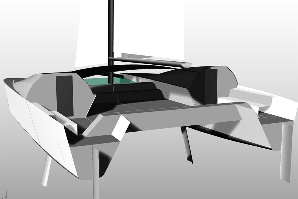

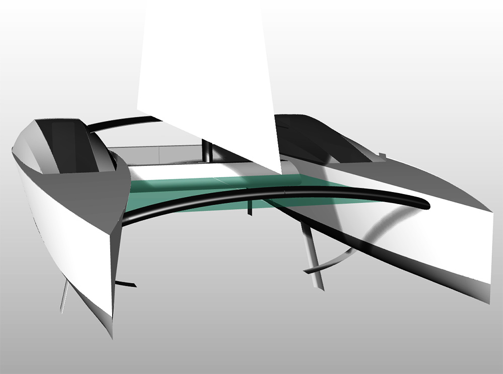

    a few more renders showing the sail plan and interior.
    So far the total surface area of all panels shown in the render is 336sqm. There is more to add but its getting close to having all structural panels included.
    Allowing for 10% wastage - thats 129 sheets of PVC foam. I have another spreadsheet which will calculate the cost of infusing all these panels.
    Its designed to be 100% flat panel construction, infused foam core e/glass construction with carbon reinforcements to beams foils and rudders. Ill get to the weights soon...
    Total mast length = 20m
    Mainsail = 90m^2.
    Genoa is 51m^2

  11. jorgepease
    Joined: Feb 2012
    Posts: 1,614
    Location: Florida
    jorgepease Senior Member
    Dang this is a SMALL boat, I will come help you build it, will take about 2 weeks!!! lol
    If anyone wants here is a Rhino file with basic shape. The Rhino file posted above opens as a single layer, this might save you some time. The V is really pronounced in mine, don't know why, if somebody wants to tell me how to fix that, would be nice )))
    Actually I like it, I want to see how interior unfolds )

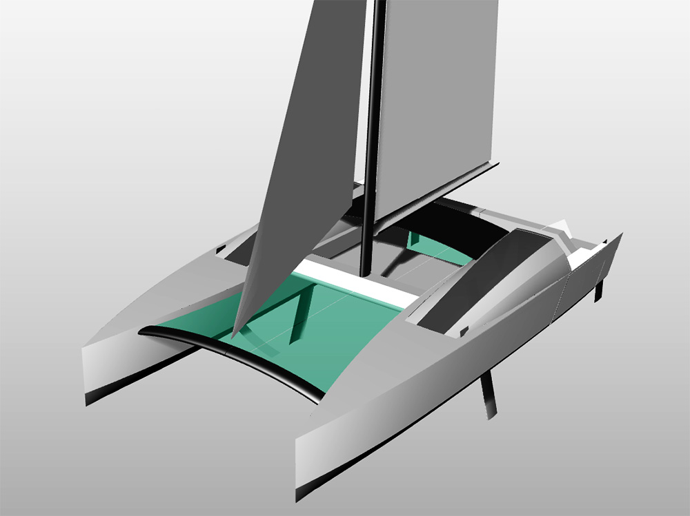

  12. jorgepease
    Joined: Feb 2012
    Posts: 1,614
    Location: Florida
    Staying pretty faithful to the design, only a slight mod to the coach roof and door which you will need to open a a hatch in coachroof to get into or do some pretty serious ducking. I will work on interiors next, I think the hull from the coachroof start to the end of the bridgedeck should be opened for storage and a seat. I will do that version later.
  13. groper
    Joined: Jun 2011
    Posts: 2,467
    Location: australia
    groper Senior Member
    Looks great jorge - rhino certainly produces a nicer render doesnt it!
    The entry into the cabin requires some lateral thinking, first you cut away a small area in the deck just in front of the door to create a step down. Then once through the door theres another step down before reaching the floor level included in the original drawing.
    At this interior floor level, there should be enough internal volume to create a galley kitchen with benches down both sides- thats why the bulkheads are cut away in that funny shape. But your welcome experiment with whatever layout you can make work!
