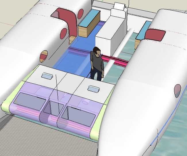

    Also- the weight summary is still a work in progress remember, its by no means finished so please keep that in mind. I have to add beam tension and compression caps but have not calculated them yet and they're not in there. Theres other things too so its heading towards 4.5 tonne as an early very optimistic estimate... theres still no bimini on this one either and that would be very difficult to live without in reality... ill probably have to add one if it was to be built.
    Theres also a structural problem here in that there is no support for the aft cockpit sole. The cockpit floor doesnt have the rear beam to connect it to using the lowering tender idea so i cant run a longitudinal stiffener all the way down the center. It dawned on me this is why the sig45 uses such a big trampoline through there as they cant easily create a stiff floor of such expanse...

    Yep- need some sort of transverse stiffener to run longitudinals into from the mast beam aft. Unless it hangs under the floor - looks a bit ugly- the only other option i can see is to have a very thick floor.

    Ok so how will you acheive bending and tortion stiffness from such a thin floor structure? Even with a series of I or H beams- have you calculated their properties? I suggest you do to see where it ends up compared to the main beams which have a section depth of some 500-700mm.
    Then account for the material costs and weights and complexity to build. I think youll find its more efficient use of material to put it in 2 larger sections rather than many small ones...

  15. groper
    Joined: Jun 2011
    Posts: 2,467
    Location: australia
    groper Senior Member
