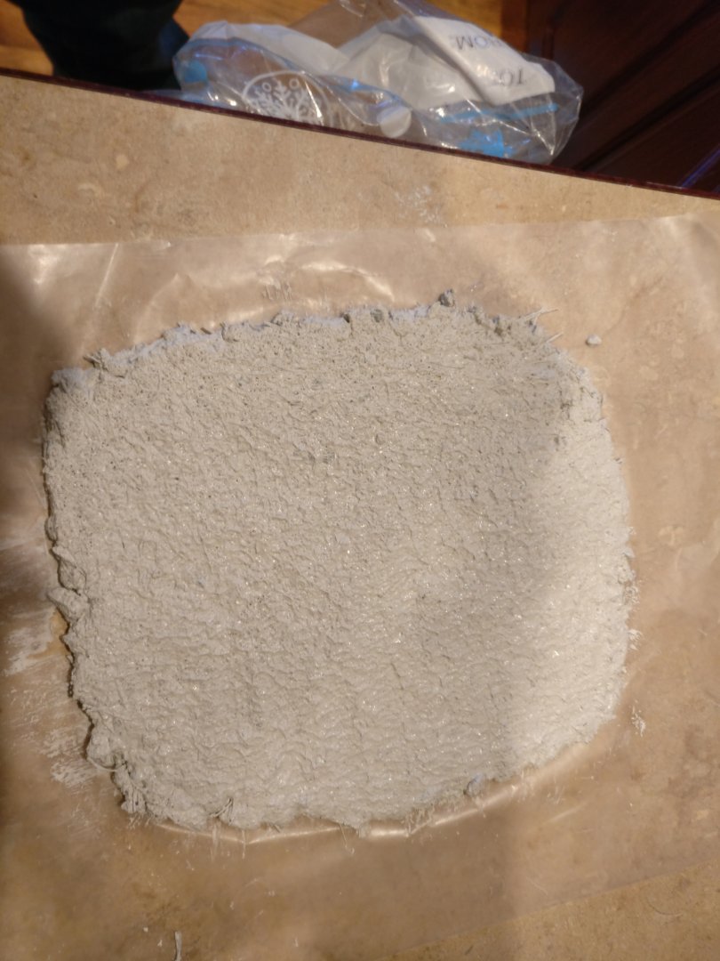

    Second test panel, and update on the first:
    First test panel had quite a bit of cracking, albeit mostly due to my wife picking it up before it had cured (a few hours).
    To answer a few of the questions:
    The purpose of the white pozzolan is mostly for aesthetics, and because I think I can. Based on the research I've done recently, it looks like VCAS is just crushed glass, and of all the possible pozzolans, I think has the lowest impact on the color. There is another purpose though: permeability. The other side benefit of building reactive powder is reduced permeability to ions. In other words, if seawater can't penetrate, then you can use (non-stainless) steel fiber, and not worry about corrosion. Similarly, you don't have to worry about coatings: the concrete is its own coating, which would make for a really really low maintenance boat.
    Anyhoo, things I didn't like about test panel #1:
    Too thick. Aggregate size was as large as 1 cm, I was hoping for nothing bigger than 2mm.
    Too heavy. No lightweight aggregate.
    Still too brittle.
    Too many voids
    I did a bad job troweling.
    Sanding revealed aggregate, which was a pain.
    I likely used too much water, and didn't use any water reducer (albeit the mix contained quite a bit already).
    Things I did like:
    White. Took a water-based stain really well (a nice deep blue).
    Sanding gave a really smooth finish
    Ultimate strength for the mix is 9000psi, which is pretty good, and it is supposed to contain quite a bit of polymer. It may be worth meshing out the aggregate.
    Chopped fiberglass was pretty easy to add.
    For MK II, I bought an open bag of mortar (55 lb.) for $8 and a bag of vermiculite for $4 (8 qt).
    Vermiculite seems to be a cheap and locally available lightweight aggregate that has some pretty neat advantages:
    Either improves (or at the very least, doesn't hurt) strength.
    Provides some pozzolonic activity
    Makes heat a non issue (is used to make refractory concrete)
    Makes the concrete insulating.
    EDIT: Also, it's crazy light. Apparently you can add up to a 7:1 vermiculite to Portland cement ratio, which results in something on the order of 15% the weight.
    Disadvantages include that it turns the concrete gray again (which may be due to the pozzolonic activity, but I'm not sure).
    No word on other properties yet, but the concrete hasn't cracked.
    This mix was a 2:1 (or maybe 2:1.5) mix of mortar and vermiculite, with a ton of glass fiber. Still no water reducer (esp. in the form of acrylic liquid) or other pozzolon. Also, still no source for decent microspheres ordering locally. The local precast place hasn't returned my calls (yet?).
    I may crush some of my own glass, as it will allow me to get really clean stuff, as well as controlling particle size (powder).
    I also may reduce the number of glass fibers, and try and increase the ratio of vermiculite, to get the mix as light as possible.
    I actually want to switch to PVA fibers. They bond better than anything else, and as far as I can tell from reading, give the most impact resilient and crack resistant concrete. I don't know if I can find any locally and I'm trying to avoid paying shipping.
    Finally, in speaking with a fellow teacher (who is a former civil engineer) and in reading some more of the canoe design papers, I may experiment with post-stressed concrete. The idea here being that pre and post-stressed stuff can be made way lighter (and the best and fastest concrete sailboat I'm aware of to date, Helsal I, was prestressed). Post stressed would have the advantage of being able to have its cables inspected. I think I would only want to do pre-stressed if I could a) get the permeability down to zero and b) get a cable I knew could tolerate some exposure to sea water. I'm not sure whether the fiberglass and basalt rods can be used this way.

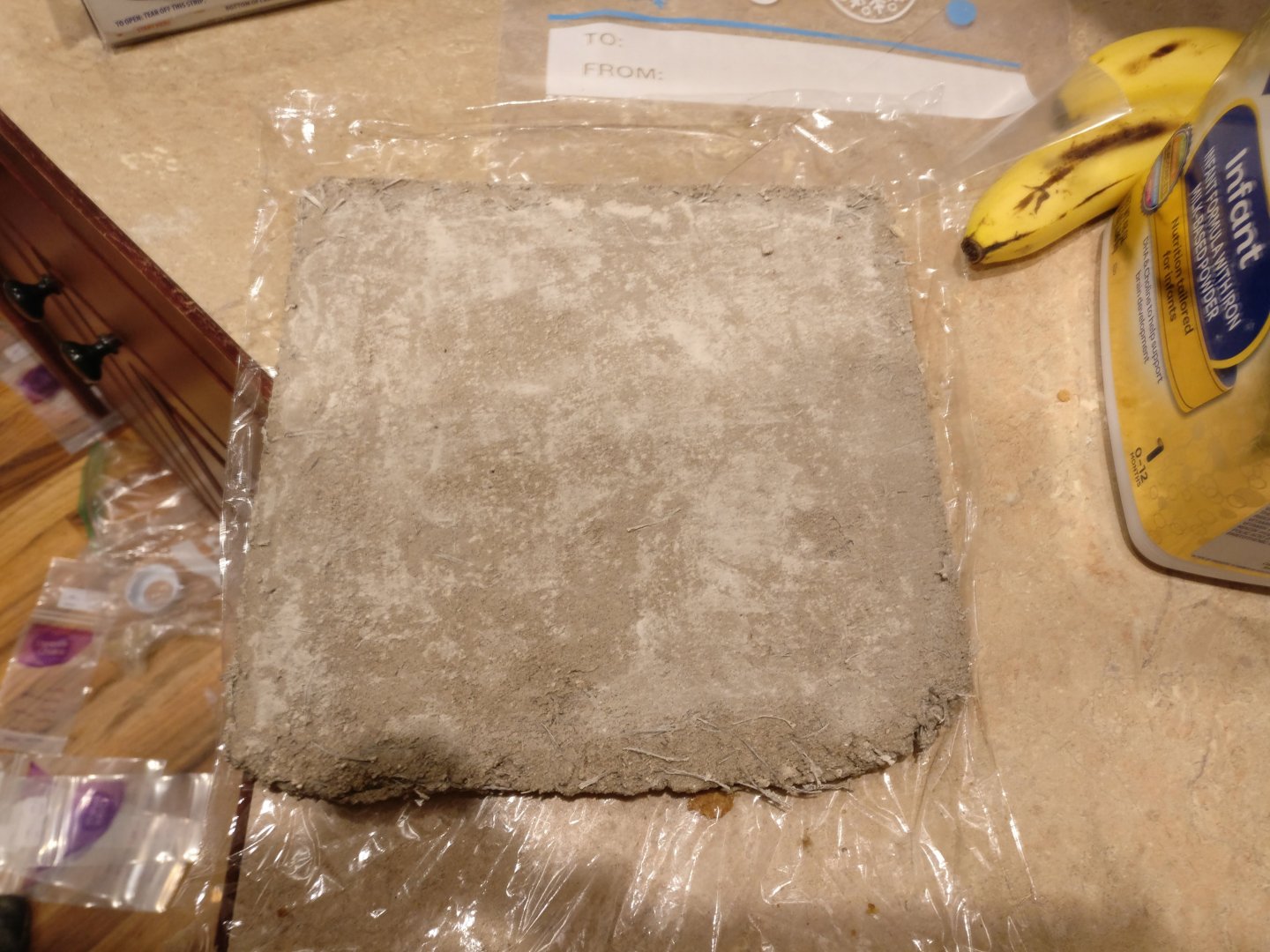

    MK II pic:
    Still haven't used any water reducer or pozzolans (although I think the vermiculite is supposed to have a mildly pozzolanic effect, I think this is offset by the need to use more water).
