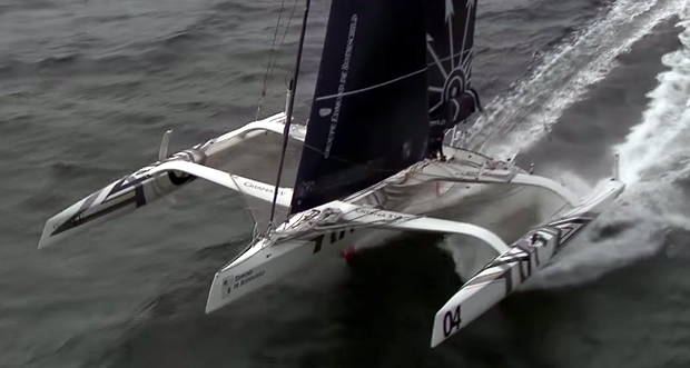

    Gitana Mod 70 on foils!
    Gitana picture by Yvan Zedda/Gitana; video-- https://www.youtube.com/watch?v=j2y2az8A124
    The written stuff with the video-translated by Google and almost readable:
    End 2013, the members of Gitana Team were embarking on an adventure just as exciting as complex transform Multi70 Edmond de Rothschild, a 70 feet originally built to run a crew on a monotype circuit, so that it becomes the first trimaran racing wheel. The project is ambitious . Just like Rome, was not built in a day , the transformation of Gitana XV will claim more than two years of research and innovation to achieve the goals it has set the team with five arrows. But in the opinion of all , the game was well worth the effort. Just a few days with his new appendages , the Multi70 Edmond de Rothschild has definitely taken off , with 43 ​​knots on the clock in 20 knots of wind , thus validating the efforts of an entire team supported by shipowners - Ariane and Benjamin Rothschild - passionate and committed .

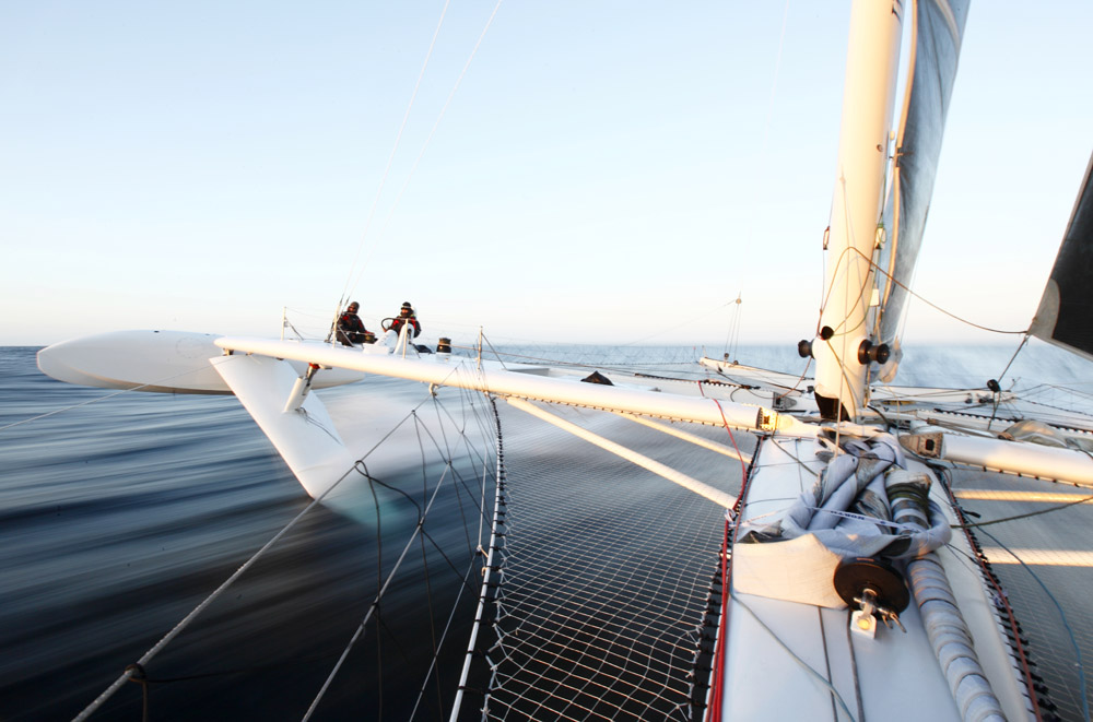

    Woohoo! Congrats to them! That flex at 2:48 is somewhat scary, the entire starboard ama is vibrating-pitching up and down. The bow must be moving at least 9 inches relative to vaka. I can't believe that would be healthy for the cross-bars and boat.

    I don't know-there was some movement but not very much as best I can tell. If it had moved a lot the altitude of the ama would have changed and I don't think it did change. Stiffness of a foiler platform is very important for that reason....
    I still can't get over how good she looks.
    It would be interesting to know how much wind she needs to foil-not foil assist but full flying. And the comparison between the main foil on this boat and the one on the big version of Macif is real interesting: the horizontal potion of the UptiP foil on this boat appears to be about twice as long as the same one on Macif.

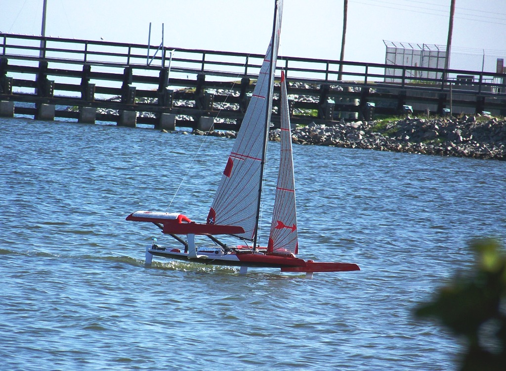

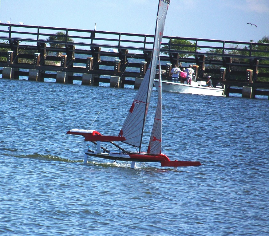

    Lite Air Foiling/automatic power on demand
    No, no Gary-the Gitana is working great! You must have gotten yourself all mixed up when you tried to compare Gitana to my boat. The Fire Arrow has the advantage-because of the lifting foil and rudder T-foil on the main hull-of being able to fly in very light air which is ideal for a 20' and under sport trimaran. And the Fire Arrow system automatically increases RM when required.
    No other tri currently sailing does these two things-that will change-you can bet on it.
    But I wouldn't ,necessarily, expect a 70' ocean racer to need that kind of power and that wide a wind range. But who knows what the future will bring.......

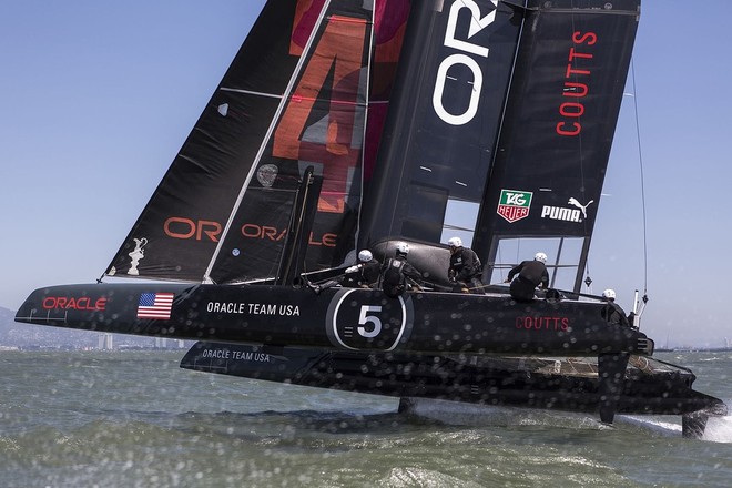

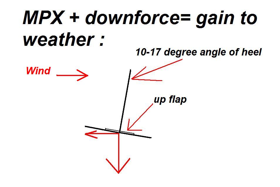

  14. Doug Lord
    Posts: 16,678
    Location: Cocoa, Florida
    Doug Lord Flight Ready

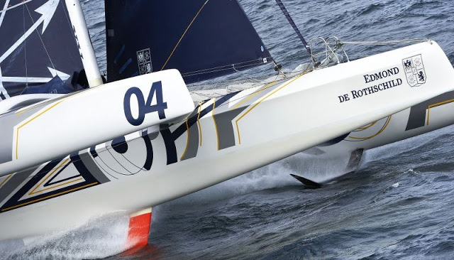

    Leeward Heel in Multihull Foilers
    "Leeward heel" making a multihull foiler almost impossible to sail is nonsense!! Look at the two foiling video's of Gitana! And see the last two still pictures below showing Gitana foiling at a small angle of heel. Look at the video's of Hydroptere and many other multihull foilers. And every picture below shows a multihull foiler sailing at an angle of heel and two of those pictures were taken during record speed runs!
    The Fire Arrow is specifically designed to sail at an angle of heel from 10 to 17 degrees. Without that angle of heel the windward force* from the mainfoil when it generates downforce would be impossible. And without the designed in angle of heel it would be hard to keep the windward hull(and foil on the Test Model) clear of the water. The Fire Arrow foil concept is designed to allow foiling in the widest possible wind range from 5mph to above 25 mph(on the full size boat). The system allows the main hull to clear the water early and allows the RM to be automatically increased as the wind gets stronger. All the while keeping the boat flying and the mainhull clear of the waves.
    *see sketch below
    click: Note picture 3 of the Flying Phantom shows it sailing at record speed as does picture 6 of an Oracle AC45! Both are being sailed with a leeward angle of heel as is every foiler pictured below.

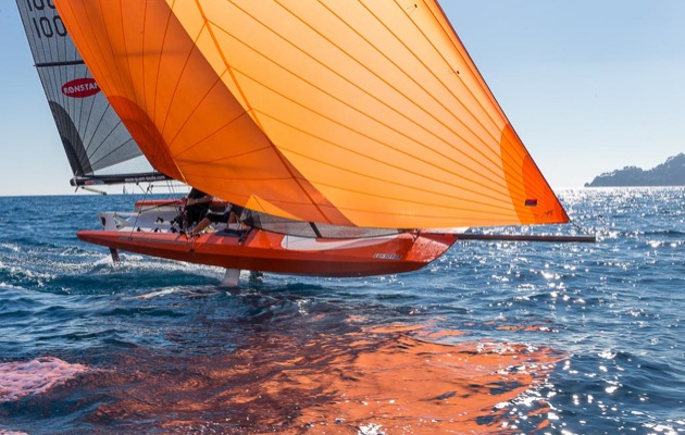

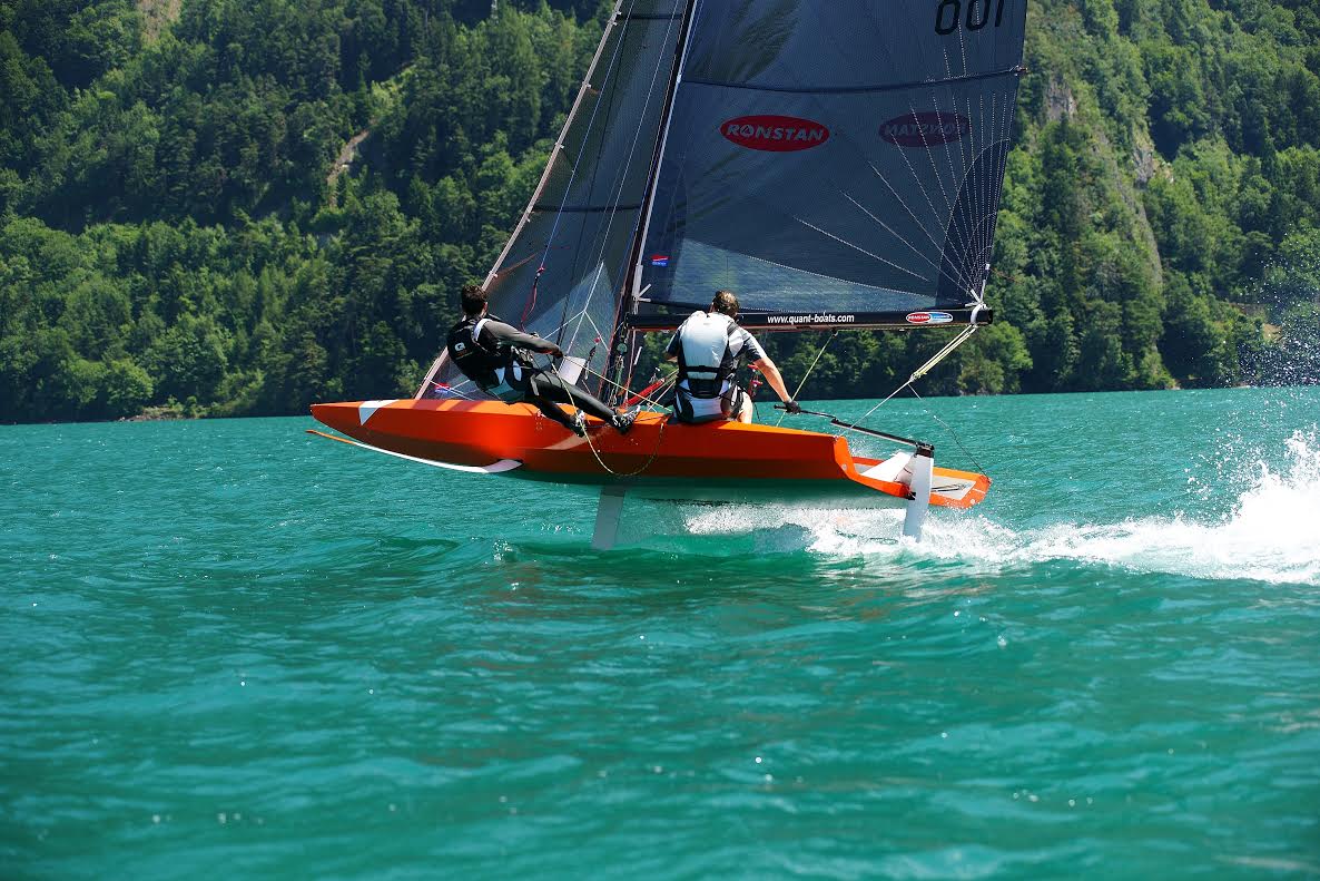

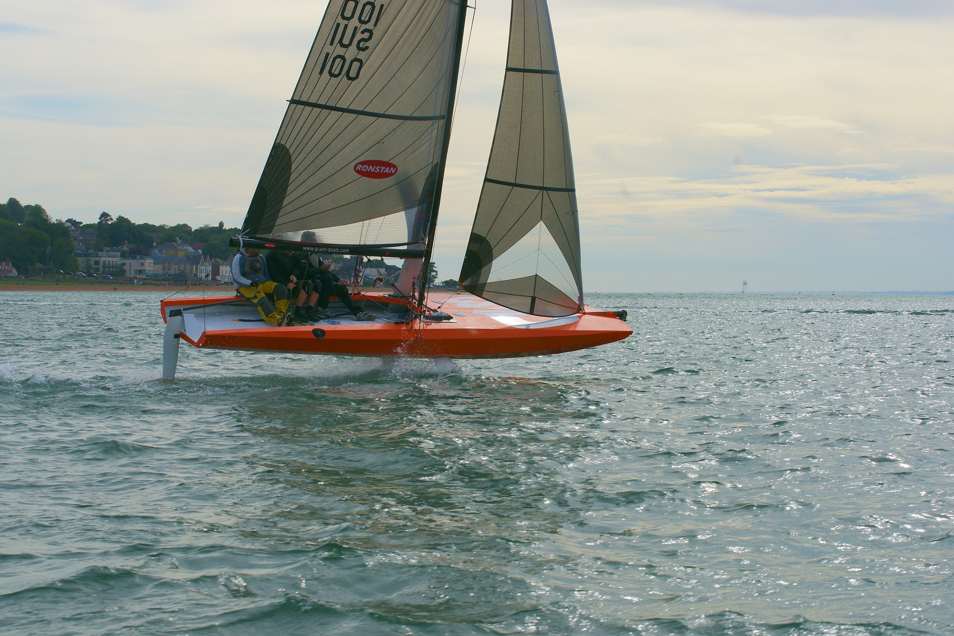

  15. Doug Lord
    Posts: 16,678
    And it's not just multihull foilers that successfully sail at a leeward angle heel. The Quant 23 is specifically designed to foil at a small angle of heel:
