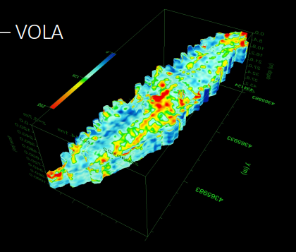

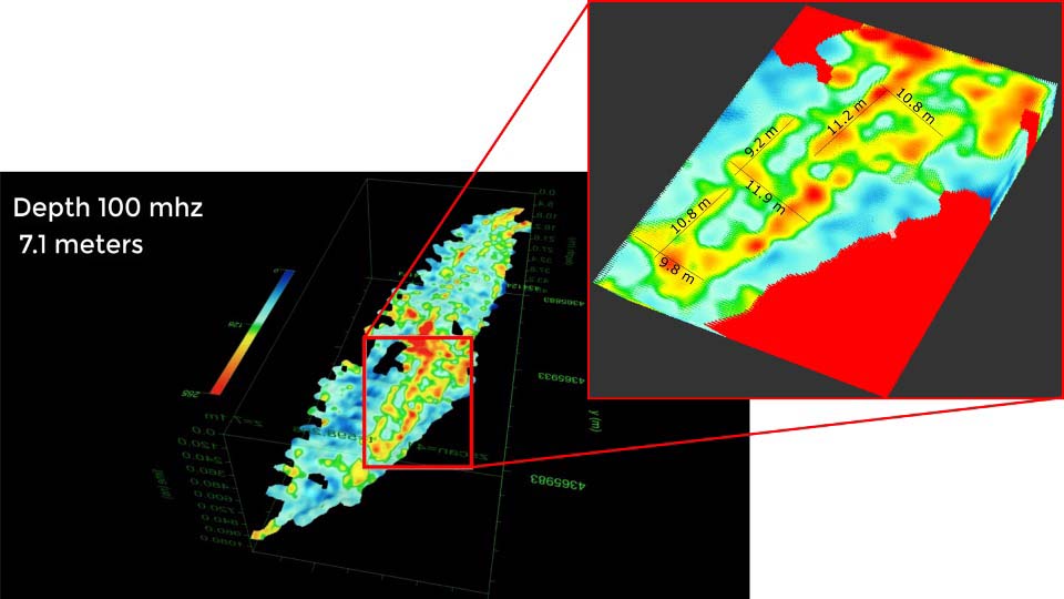

    I guess since the discussion is more or less derailed by the Ark controversy, I might as well point out that the debate arises because many advocates for a box-shaped Ark refuse to consider the recent Ground Penetrating Radar/LiDAR scans publicly released in September 2021 showing a framework of ship timbers over 6,000 feet in elevation close to Mount Ararat at the Noah's Ark National Park (Durupinar) recognized by the government of Turkey as the Ark's location because the scans show a framework built like a ship, not a box-shaped barge.
    https://www.israelhayom.com/2021/10...aim-to-have-found-true-location-of-noahs-ark/
    Noah’s Ark hunters claim boat FOUND in mountains using 3D scans https://www.the-sun.com/news/3725022/noahs-ark-buried-turkish-mountains-experts-3d-scans-prove/
    There is a substantial population who insist that a box-shaped barge-like Ark was built by Noah, not a ship design, and that the new scans showing a framework of ship timbers cannot be legitimate. As such there are major debates going on right now over whether a box-shaped wooden Ark would have been seaworthy as opposed to a more conventional ship design more similar to the Eureka, Solano, or Great Republic.
    List of longest wooden ships - Wikipedia https://en.m.wikipedia.org/wiki/List_of_longest_wooden_ships
    Because the government of Turkey had some of its top scientists producing the scans, e.g. Dr. Fethi Ahmet Yüksel Head of Geophysics at Istanbul University and Dr. Salih Bahraktutan, Head Professor of Geology at Ataturk University, who are claiming the scans are not of a geological formation, it complicates matters for critics of the scans, thus the controversy. The scans are being featured in upcoming documentaries by the History Channel and Science Channel so they could feature more broadly in the news soon.
