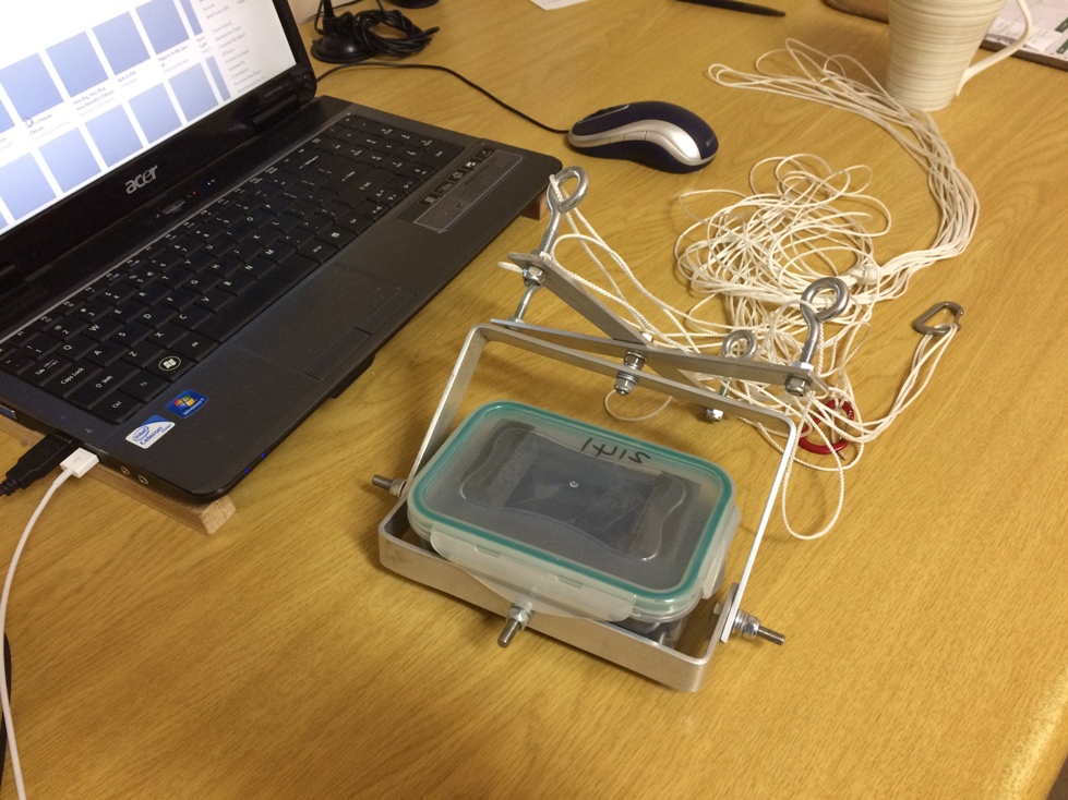

    What I am looking for is a kite that can fly unattended if you lost your mast.
    It should be able to stay up in varying wind conditions and should be cheap and easy to build and replace, when it gets into the water from heavy gusts it should just be a simple matter of reeling it in and let it fly again when wind conditions are more favourable. This way you can have 2 or 3 different kites on board for different wind conditions. My experiments so far were very encouraging and my KAP rig is ok. It takes time and practice but I am very sure that it will work well. In other words a small boat with a kite is MUCH better than to scull or row. From my experimentation so far I am confident that you would be able to broad reach reasonably well

    the pics

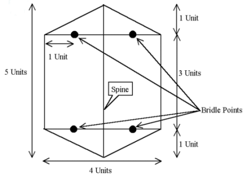

    This is what I want to experiment with Rokkaku
    http://www.my-best-kite.com/rokkaku-kite.html
    https://en.wikipedia.org/wiki/Rokkaku_dako
    the idea is that these kites can fly unattended for extended periods, not like the surfing kites that needs constant attention
