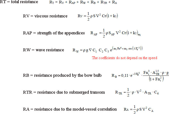

  12. TANSL
    Joined: Sep 2011
    Posts: 6,558
    Location: Spain
    TANSL Senior Member
    Just for the purpose of verifying sources other than Wikipedia, I have consulted the studies of people who have addressed these issues, such as Morton and Getler, Guldhamer and Harvald, Holtrop and Mennen. I have seen few references in them to the third power of speed. As an example, Holtrop-Mennen make the following decomposition of the power necessary to tow a ship : (How to move from V ^ 2 to V ^ 3 is something I do not know)
      File size:
      39.8 KB
      287

    Pressure is in force/surface area not force x surface area.
