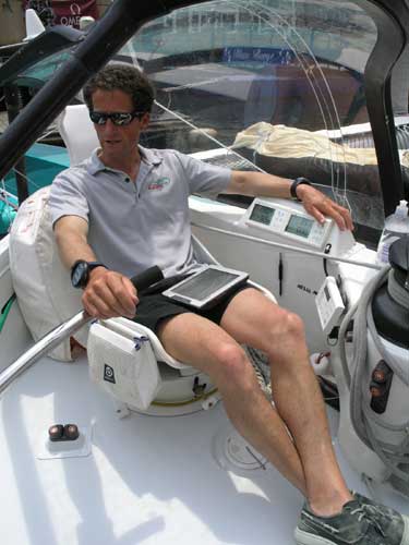

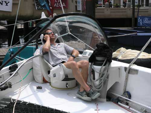

Interesting photos, Chris. Quite different, however, from these taken at the end of the 2004 Transpac:
http://www.sailtriad.com/geant/at_the_helm.jpg
http://www.sailtriad.com/geant/lounging.jpg
I can vouch for these; I was in Boston as these boats came in. Sodebo and several others had similar enclosures and "super chairs" though, IMO, Geant's was the most advanced. Quite a change from 2000, eh? Also quite a change from your--later--pics taken at the Multicup event.
ORMA 60's sail in two completely different guises--single handed offshore and fully crewed inshore. I guess it makes sense that they'd change the setup of the boat from one to the other--especially such a competive and well-sponsored boat as Geant.
I'm not suggesting that these enclosures are particularly well streamlined--for the boat's sake. They do, though, pretty obviously, work well to reduce the physical stress on the helmsman. It would be a much more comprehensive move to enclose the entire crew. See my other post for more.

Re ORMA protection; I looked at the top four just after the finish of the 2000 Transat, and crawled all the way through three with my camera; none had that sort of protection then.

Dave, Orma 60's are extreme boats and those guys really go to the limit. The boats are many times at the edge and a mistake can easily lead to a capsize. These are not easy boats to sail. I believe that there are not many sailors that can race those boats at that rhythm.
For example, Franck Camas, one of the best skippers, had said that he had never been inside the boat more than 3 minutes (each time) during the entire race. This can give you an idea of the needs and demands of these sailboats.
If they can see the waves and the sea, they can go faster, and they have a much better view outside the boat. Believe it or not, they had said that one of the things that had permitted that incredible average speed of 20 Knots was moonshine; they could also see the “race track” during good part of the night, and for that they would have to be outside.
