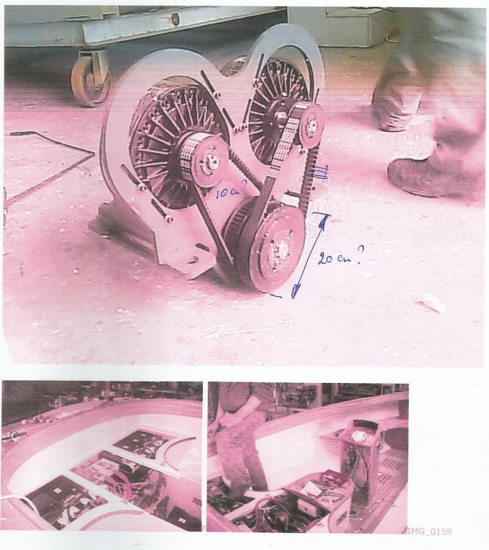

    Hi Xellz, In that case go for AC motors. Yes, LiFePo4 are very reliable and one can hit a nail into the battery and nothing will happen, no explosion. I can post you the specs and tests done of my LiFePo4. I am not too sure whether I can do that with the 20Ah battery, 3.7 Volt from the hobby people. But there are hundred thousand hobby people who have purchased them. Ask them what they think and experienced. But you are crazy to ignore flexible solar panels, not only cost those LiFePo4 an arm and a leg, for what reason.? With solar you always get some energy into your batteries, (excluded during the nights) , provided you haven't forgotten to have a MPPT regulator or MPPT charger. Just because sometimes there is a fire on a yacht who was using petrol, does not mean people don't buy petrol engines anymore. Here the same, you can use LiFePo4 batteries and does something stupid with the fuse and I can guarantee you that you will have a fire on board.
    Hi Kerosine, maybe not essential and certainly not meant for cruising (refer Rumars) , but is sometimes very handy to have a very low speed and that is my experience.
    Xellz, you will make it and at the end does the correct thing . I enjoy my solarboat, but am in the process to add a small sail to it, just in case.

    Just something about charging. Because I placed 10 lithium batteries of 3.35 Volt parallel and 4 x in serial the total voltage is 4 x 3.35 = 13.4 Volt and the maximum Voltage allowed on LiFePo4 is 3.6 Volt per battery i.e. 4 x 3.6 = 14.4 Volt. The charger I have is a lead acid battery, but it limits the current to way within the amperage allowed for charging the batteries i.e. at 1C till the voltage reaches to 13.8 Volt, thereafter it does constant voltage to 14.4 Volt. I have done this for 7 years and the logic is that the parallel connected batteries are keeping each other balanced, while I only have to keep an eye on the 4 voltages on each group. Only when one discharge extreme high currents, will most likely the batteries go out of balance. Up to now, my Li batteries are in good condition.
    By the way, I saw that Ocean Volt copied me most likely, in placing the motors in liquid substance for cooling by the seawater. I think they also use transformer oil, but it sound better and is much more marketing oriented to state "liquid substance approved by ". You could also consider that if you use separate purchased motors.
    Ever considered an DC motor on your battery bank, which powers a generator, which powers AC motors? You can keep the very heavy thick copper cables very short between batteries and DC motor and then with 220 V ac motors driving your propellers. Simple, you stay within the 48 Volt and can easy control with AC speed control your AC motors.
