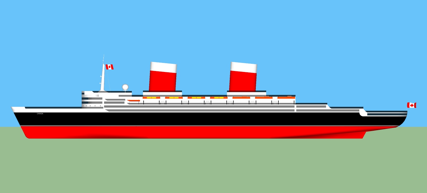

  4. OceanLinerFan
    Joined: Jan 2012
    Posts: 29
    Likes: 0, Points: 1, Legacy Rep: 4
    Location: Melissa, Texas
    OceanLinerFan Junior Member
    Thanks for the early responses guys :D
    As to the GA...I haven't been able to come up with a new one as of yet for this updated design (she has gone through quite a few iterations since I started working on her basic design). However, I can give some details as to the layout inside the hull. The deck height in the hull is intended to be 9 ft, and a similar deck height above the main strength deck in the superstructure. The watertight deck would be situated approximately 14.6 ft above the design waterline of the ship. That would leave 3 passenger decks above the watertight deck in the hull, and one service deck below it (not including the machinery spaces).
    However, attached is a side profile of the concept ship as well as a SketchUp midsection view with the ship's centers of mass and buoyancy (to 1:1 scale in SketchUp). I will try to draw a newer version of the ship's General Arrangement as soon as I can.
    Thank you for the interest in my ship :)

  8. Ad Hoc
    Joined: Oct 2008
    Posts: 6,910
    Likes: 855, Points: 113, Legacy Rep: 2488
    Location: Japan
    Ad Hoc Naval Architect
    Ahh...i see.
    All you have done is a hydrostatic calculation of a 3D shape that is floating on a given draft. That is all. This has nothing to do with what the design, your GA, will actually weigh or displace when fully loaded. You can only establish this by doing a weight estimate. No matter how detailed or guessed, you cannot design a boat without a weight estimate.
    Once you have established a weight estimate at the same time, you also work out the centres for each item. It is basic maths, just a weight times its lever divided by the sum. As shown here as an example.
    Nope this is the last and easy part. The most difficult part is your design, the GA and the weight estimate based upon your GA. If you don't do that, then what have you got other than a series of numbers?

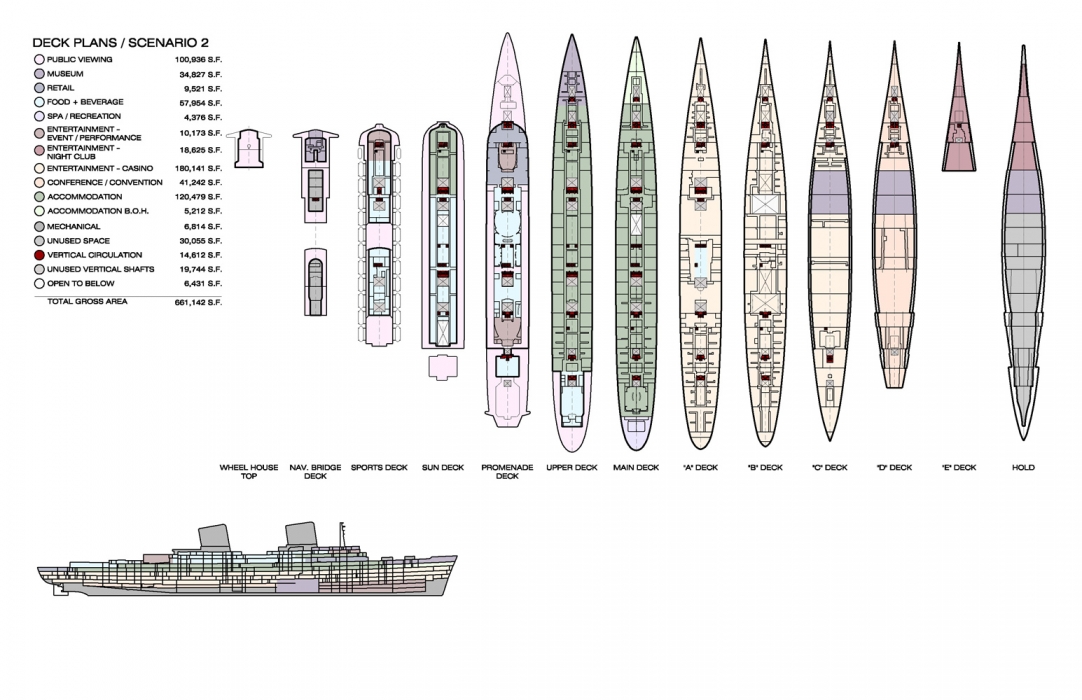

  11. JSL
    Joined: Nov 2012
    Posts: 810
    Likes: 61, Points: 28, Legacy Rep: 41
    Location: Delta BC
    JSL Senior Member
    some deck plans
  12. gonzo
    Joined: Aug 2002
    Posts: 15,189
    Location: Milwaukee, WI
    gonzo Senior Member
    How did you get the weights if there is no structural design?
  13. JSL
    Joined: Nov 2012
    Posts: 810
    Location: Delta BC
    JSL Senior Member
    How can you get the weights? Well, a comparison using the Hull Cubic Number (LxBxD) is a place to start.
    I used the the Cubic Number of the 'United States' and translated the displacement (45,400 tons)to the 'Canada' (OceanLinerFan listed at 36,400 tons) and got 35,796 tons. This is a difference of less than 2% [ (36,400-35,796)/35,796 x 100 ]. Reasonably close at this this stage of the design.
  14. TANSL
    Joined: Sep 2011
    Posts: 6,565
    Location: Spain
    TANSL Senior Member
    The "Cubic Hull Number" can be a fairly accurate method for predicting the weight of a similar ship, built 100 years ago. Nowadays construction methods and materials used in the accommodation are so different that, in all probability, this method will result in a higher weight that the real. On the other hand, the machinery, services, fire protection, safety etc, for a current boat are much more complicated and suggest that, perhaps, for a ship built in 2030, is not a suitable method.
    The weight of a passenger ship is an extremely important item that must be calculated very seriously. It can not be based on statistics on so old ships, although the external shapes are similar.
