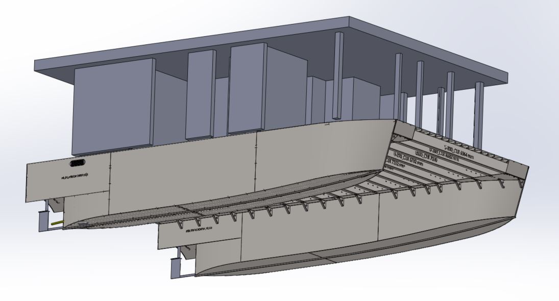

    I am just designing and my customer is building this kind of houseboat. This one has a full steel structure. It will be serving as a hotel room all round year in frozen lake in the middle of Finland.

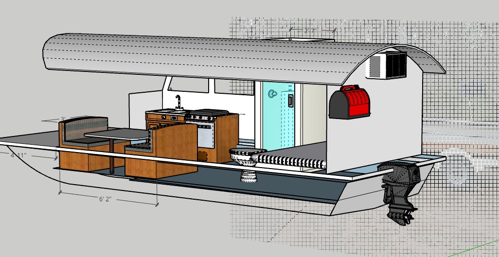

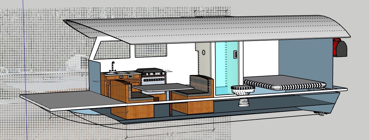

    So I decided instead of building a hull for 5-6k Id buy one and retrofit. I think this 96 Grumman 22' deckboat will make a good start for my trailer-able houseboat. I only paid 1600 for it and the trailer. Now I need some ideas on building the interior as light as possible.
  10. fallguy
    Joined: Dec 2016
    Posts: 8,745
    Location: usa
    fallguy Boat Builder
    Do you understand how dangerous this proposition is? Looks like a nearly flat bottomed boat with a ton or better at 3’ higher cofg.
    The rating plate has a gear max on it. Post it and see if anyone else wants to help you. Please keep in mind the horsepower rating will not be accurate if you modify the vessel.
    I think it is a bad idea, so I can’t support it.

    Fallguy you don't even have all the details and you are already to sink my idea.
    This is for ICW travel only boat is rated for 130hp and 1155 cargo 1730 total (max).
    I just want to cruise at 6 knots. 2-4 people at the most.
    How do you get 2200 3' above cofg? You haven't even asked what materials it is being constructed with or how it will be powered.

    So the center of gravity increase is what I don’t like with the rated horspower.
    If you figure 660 for passengers; you have 1070 left for the structure and engine, batteries, solar cells, stovetop, food, etc. Not much, but perhaps enough.
    It is not something I am smart enough to say okay to..but as long as your hp wishes are reasoned; perhaps someone else can help.
    Corecell 12mm is very light. Modify your design for windage; you don’t need full headroom in a salon sitting area; test the boat with some smaller four strokes.
    I see you are not too crazy with a flybridge; that is good.
    Personally, I would strip the loose parts out and weigh the boat and trailer and determine the boat weight at a certified scale; then strip out anything Grumman did that you can and weigh it again. You might pick up a few hundred more pounds.

    No clue. I was thinking 20 horsepower might work, but you really might need more. The Tohatsu 4 stroke 20 is pretty light and you can get in for a couple grand.
    But you really need to avoid that massive roof you proposed. The way to reduce windage and rooftop and weight is to put some angles into the walls. They won’t be too much bother because you have stuff on the walls. But then you need to waterproof them.
    Take a picture of the inside of the boat. The gunwhales will be an interesting bit.
    Maybe some other, wiser people with less liability concerns will help you. Sort of out of my league, but you better build it light or it’ll be dangerous.
    You also might consider a forward cockpit or aft cockpit. Shrinking the living space will give you weight savings and allow outside seating.
