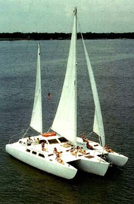

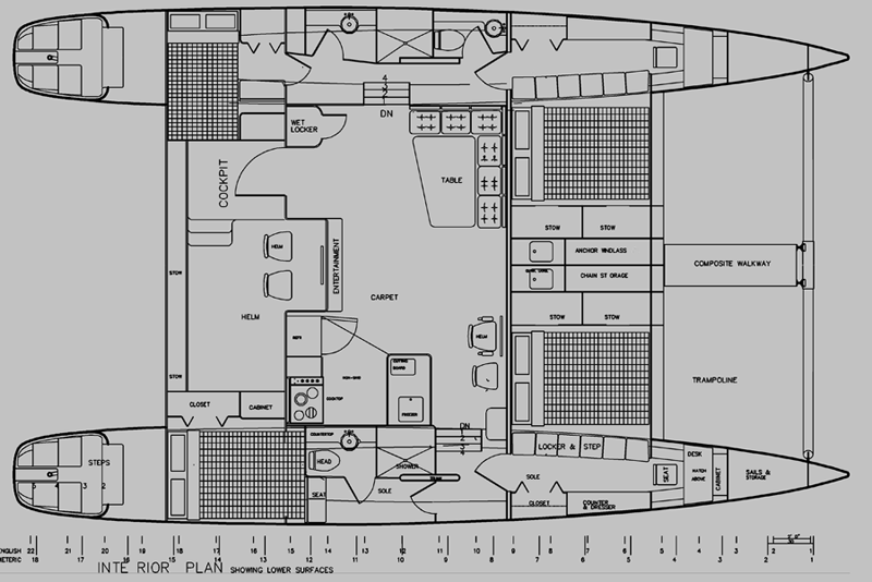

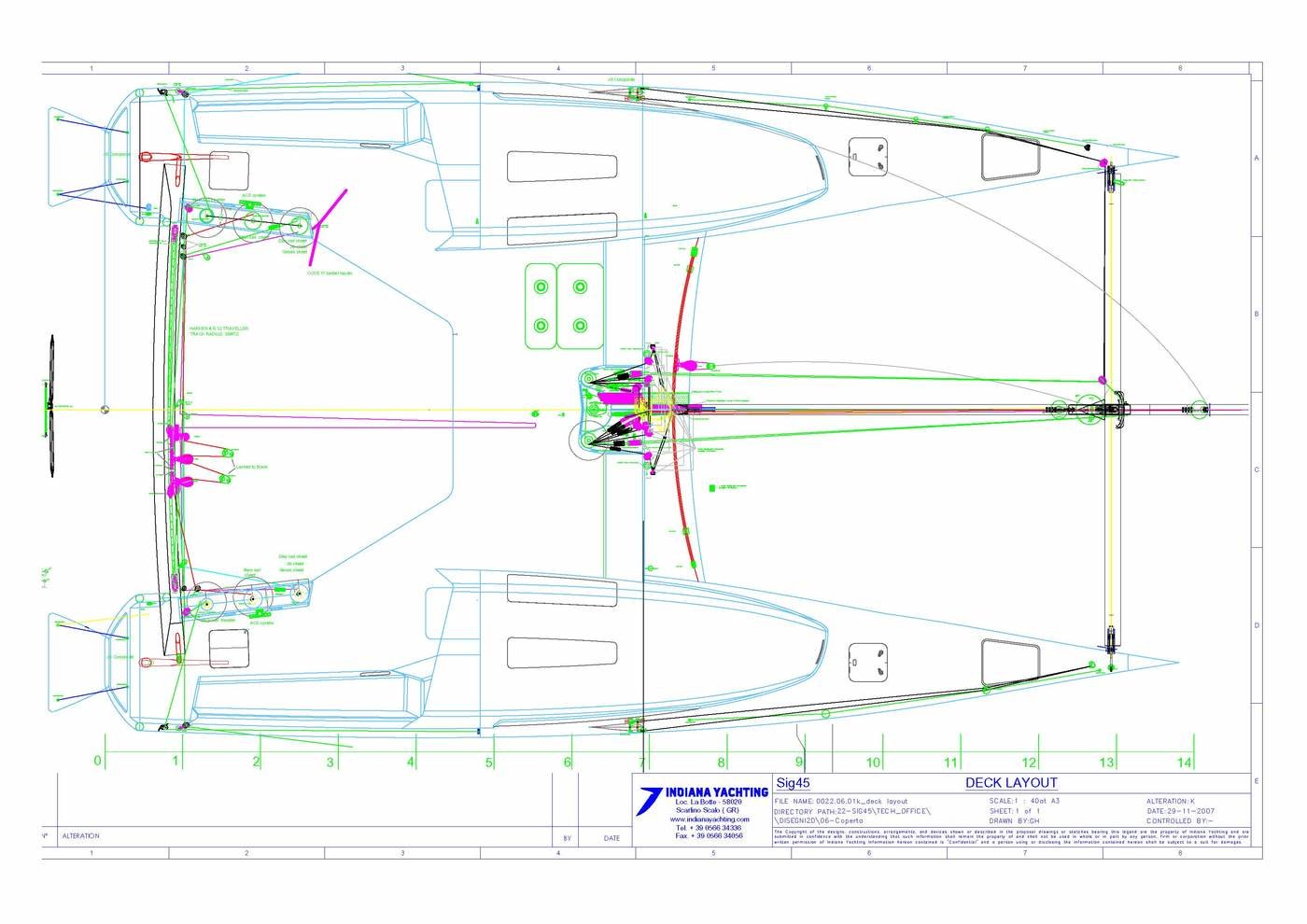

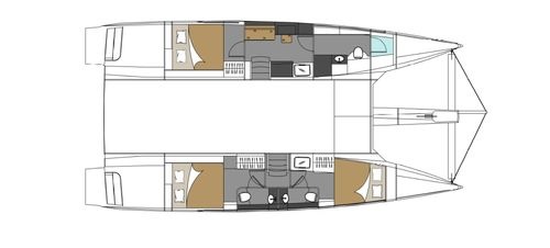

    The Le Breton Yachts SIG45 is an interesting catamaran. It is 45 x 27.5 foot weighs 12000 lbs and in the initial design had a max payload of 3000 lbs. The rig carries a 75 foot carbon wing mast has 92 square foot of area with a 1000 square foot mainsail, 460 square foot self tacking jib and a 1500 square foot gennaker. The hulls length to beam is 13:1. The underwing clearance is 3.8 foot. This is not a floating caravan. The SIG45 can sail faster than wind speed having sailed at 22 knots in 16 knots of wind in tests and the maximum speed seen is 28 knots. The hulls show a wave-piercing type of bow, and there is zero overhang in either the bow or the stern. In plan form the hulls are slightly asymmetrical flaring out inboard amidships to gain some internal volume.
    This cruising catamaran (yes, it is a cruiser) comes from the LeBreton yard in Amsterdam. The naval architecture was done by Van Peteghem Lauriot Prevost in France. Unlike most cruising catamarans, this cat does not use the bridgedeck area for accommodations. The flared-out sections for maximum hull beam provide enough accommodation to fit a practical galley, seating double berth cabins and loo etc. The accommodation is comfortable and works.
    The daggerboards are carbon and outboard in each hull, and give a board-down draft of 9 feet and a board up draft of 3 feet 10 inches due to rudder depth. The rudders are also carbon fiber. On deck the mainsheet traveller spans the connecting beam at the stern. The boat is steered with surprisingly short tillers. Forward is a soft trampoline but aft the connecting deck is rigid and appears to have a teak planked veneer over at least part of it with the rest being nonskid paint. Halyard winches are clustered at the mast base and I suspect the self-tacking jib sheet is controlled from this bank of winches also. There are three other sheet winches port and starboard aft at the steering stations. These winches also control the broad traveller. The sheet loads of the mainsail can top 9000 lbs.
    There SIG45 was originally designed in 2002 and actually finished in 2009. The first boat was to be built with a foam e glass expoxy sandwich with carbon used in cross beams and other high load points. The cross beams are a D section with the aft full width bulkhead has top and bottom unidirectional carbon flanges with the forward sections acting as an aerodynamic shape that handles torque loads. The designers had analysed the structure and concluded that the weight savings of all carbon fibre would not be sufficient to justify the additional cost. Especially when carbon fibre hull skins would be to thin to handle knock resistance etc. The second SIG45 was built in the US for an American client who wanted an all carbon foam epoxy cat. Result was a slightly lighter boat but I do not know what later builds were done in. The original SIG45’s cost in excess of $1 mill. The jpegs give the idea. PS you can charter a SIG45 in Greece. Those who have sailed on it say its fast, fun and really annoys Lagoon owners who take twice as long to get somewhere.

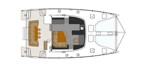

    The Pacifico PS 153 is a catamaran built by Pacifico Yachts, a Russian company. The cat is a cruiser that is 50 x 24.6 foot weighing 33,000 lbs and carrying a 60 foot mast and about 1200 square foot of sail. The cat is designed by Albatross Marine. This boat is about accommodation with reasonable performance.
    It has 900 square foot of accommodation space with 6.5 foot ceilings through out the boat. As standard it is available with 3 (owner) or 4 cabins (charter) and can be further customized to special requirements. The main deck saloon has a functional galley, a spacious dining area, a chart table (second control post).
    Built to the highest standards with extensive use of high modulus fabrics, carbon fibre and epoxy resin (for higher longevity and no risk of osmosis) the boat has full ISO Certification in Cat A. It is a catamaran designed and built to sail across oceans in any weather conditions, in comfort and safety.
    Why the interest? The price is $453,000 US ex factory. Relatively cheap for a boat this size and type. 5 to 10 year old Lagoon 50’s sell for more money. A new Lagoon 50 will cost about double. Unfortunately Pacifico does not specify what is included in the standard price and I suspect it will add a bit to the base. If the boats structure is built as specified and the pricing is real this cat could be a good cruising cat. The designers are experienced and have produced good boats previously.

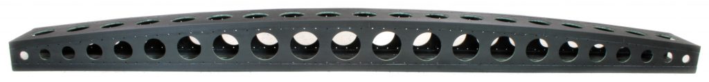

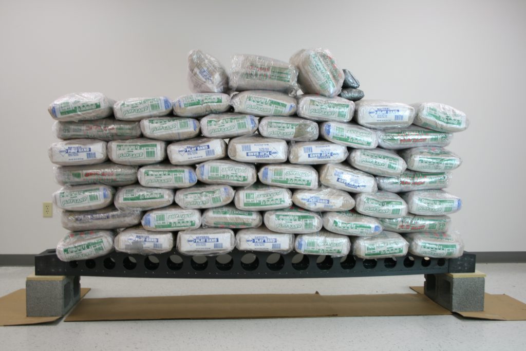

    For information only. Carbon Fiber Structural Beams are becoming interesting. Many load-bearing structures could use customized carbon fiber structural beams. Element 6 Composites specializes in designing and fabricating custom carbon fiber structural beams for a wide array of industries and users. Although these beams are typically more expensive than a similar metal component, the substantial weight savings that can be achieved through advanced composites often outweighs this upfront investment. EG The first jpegs are of a beam weighing in at only 9 pounds, this 8ft curved beam held 2500 pounds without breaking.
    The second jpegs are of a 24-foot long arched box beam was designed for an application that required a lightweight structure to support a heavy distributed load. Several rounds of analytical and finite element analyses drove optimization. A combination of selective carbon fiber placement and hole pattern provided a minimum weight design that met all strength specifications. The web site is at: Carbon Fiber Building Material | Element 6 Composites https://element6composites.com/carbon-fiber-applications/carbon-fiber-trusses-beams/

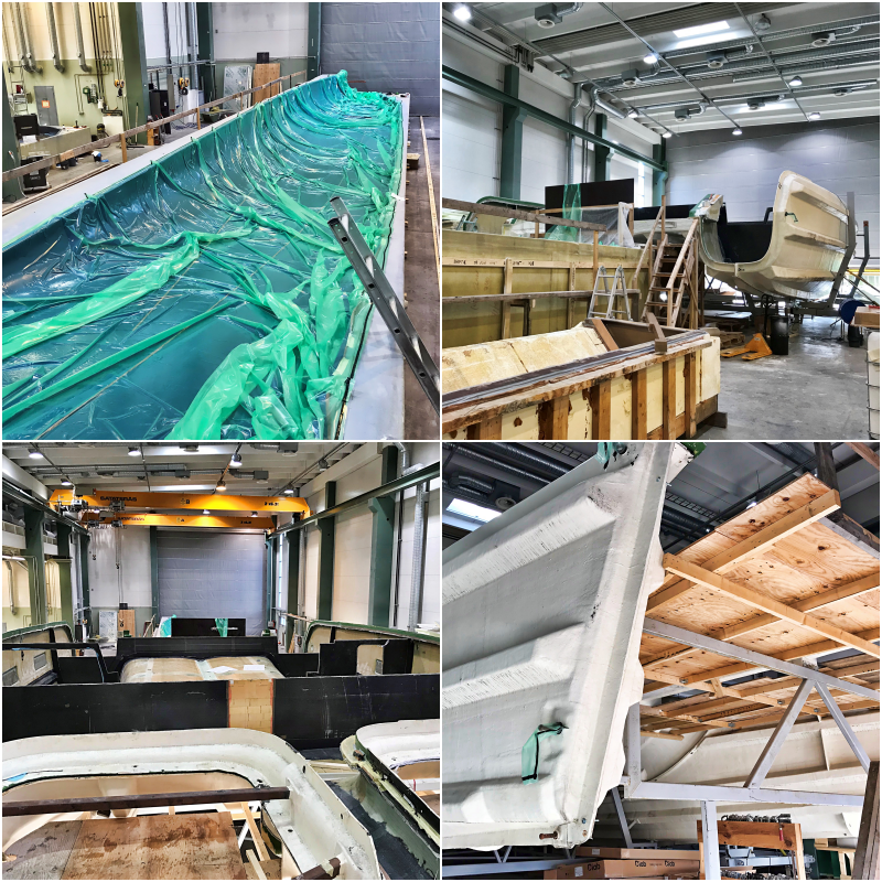

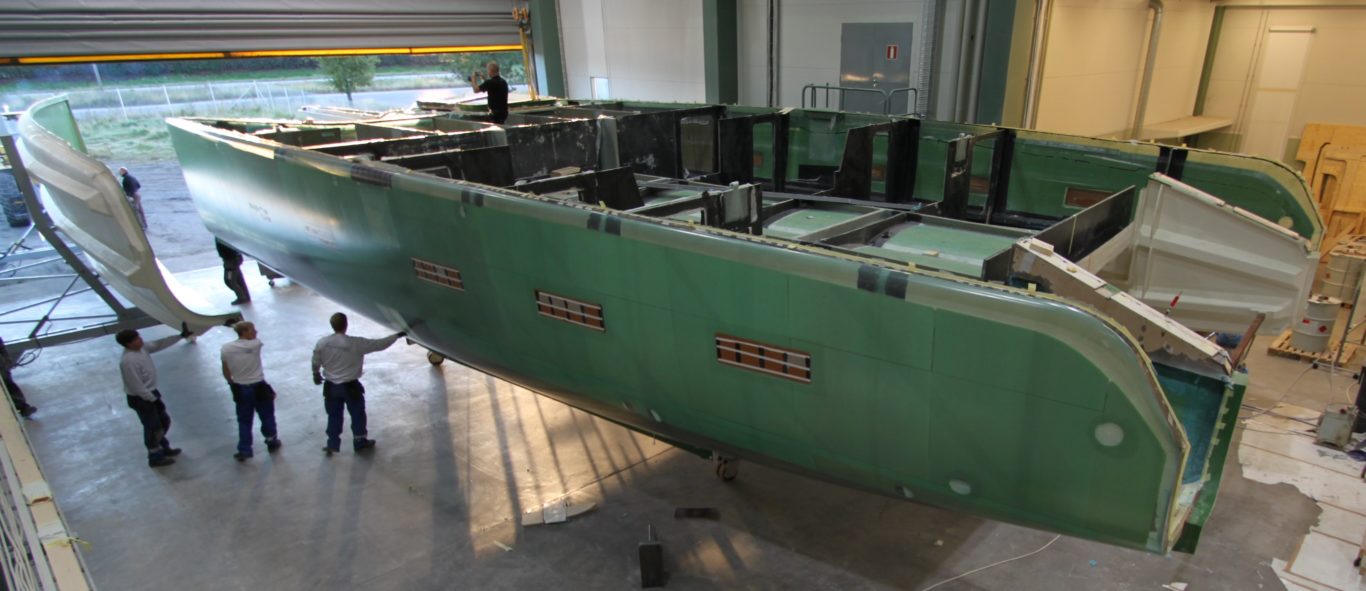

    The C-60 is the first multihull design by German Frers (very famous large mono designer). The C60 is 60.7 x 29.8 foot weighing 44000 lbs and carrying a 85 foot spreaderless full carbon Lorima wing mast with a 1474 square foot main and a 677 square foot self tacking jib with a 1355 square foot code zero. The rig is controlled by a number of motorised winches to ensure a crew of just two can sail the boat. Most ropes are run under deck to ensure safety and simplicity with no tangling.
    The C-60 is built as a semi custom by Ocean Quality Systems, a company founded in 2010 by the owners of four companies that do carpentry, engineering and electrics for Nautor, Swan and Baltic Yachts. The companies still continue to supply parts and services to the other yards. The owners ambition was to create a Finnish yard building high quality multihulls that matched Nautor, Swan and Baltic Yachts.
    The C-60 is on the edge between comfort and performance. Any more hull beam would affect performance. The bow is reversed and sharp to reduce pitching in waves, as a true wave piercer. As a hidden safety feature the bows have crash boxes protecting the hull and structure in case of a collision. Each hull has 3 watertight sections. The cat has curved carbon dagger boards. They are lifted by a push button B&G system indicating what depth they are.
    The hulls and decks are vacuum infused rigid foam glass with a full carbon foam option. The deck house was designed and built in Titanium. The strength to weight and stiffness of titanium has major benefits and allows the fitting of large areas of windows of 12mm laminated and tempered glass.
    Bow thrusters enable fast and efficient manoeuvring. The engine rooms are located midships to help centralise weights. Frers is applying high quality mono techniques to multi’s.
    The boat accelerates well, is very stable and is fast with speeds of over 20 knots recorded. The boat is also “comfortable” with an owners wife claiming “I can actually sleep in the forward cabin” whilst heading upwind at above 12 knots. Money will not be one of your worries if you can afford this boat as the several million will buy a very high quality product that sails well. We can all dream.

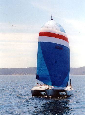

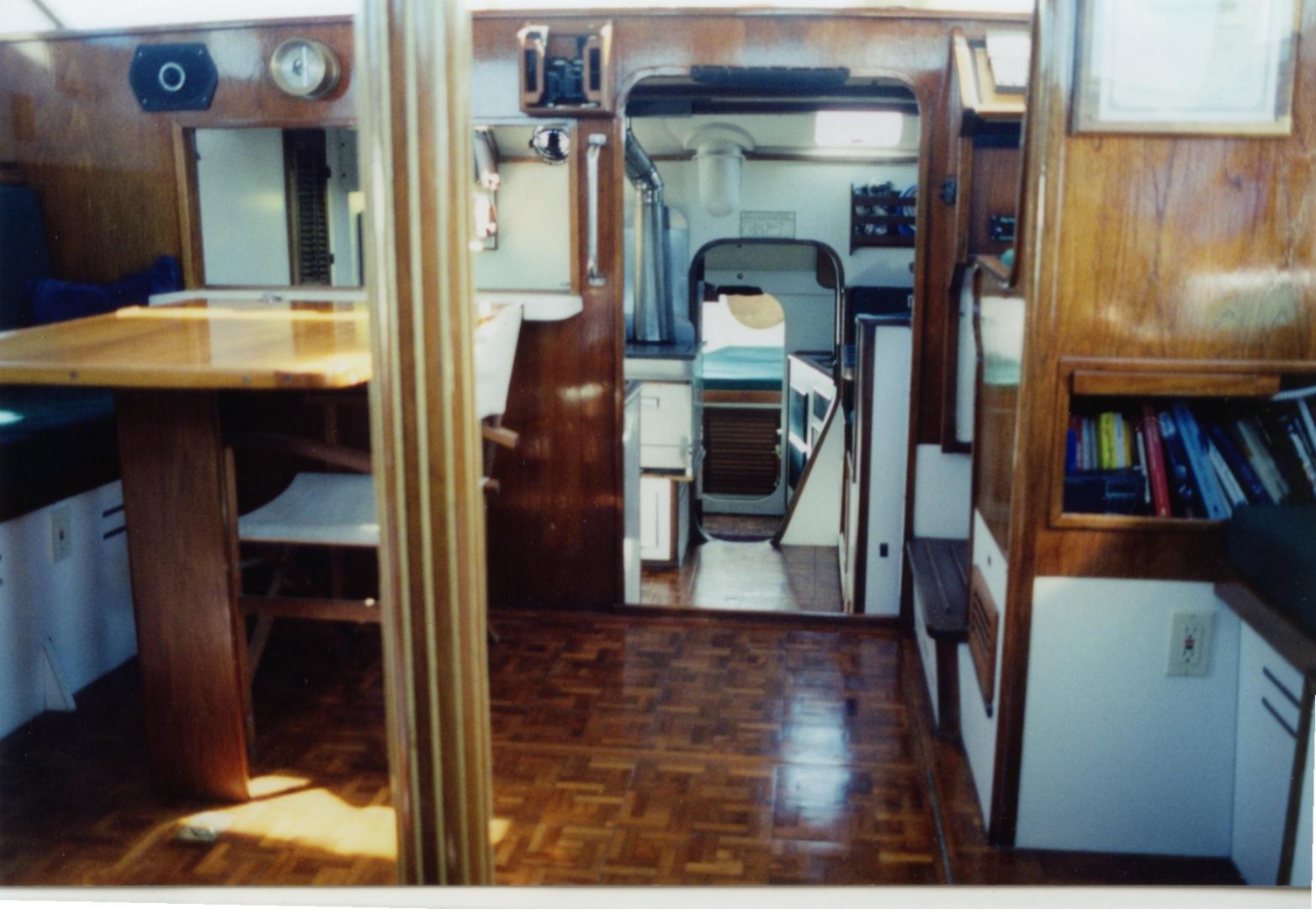

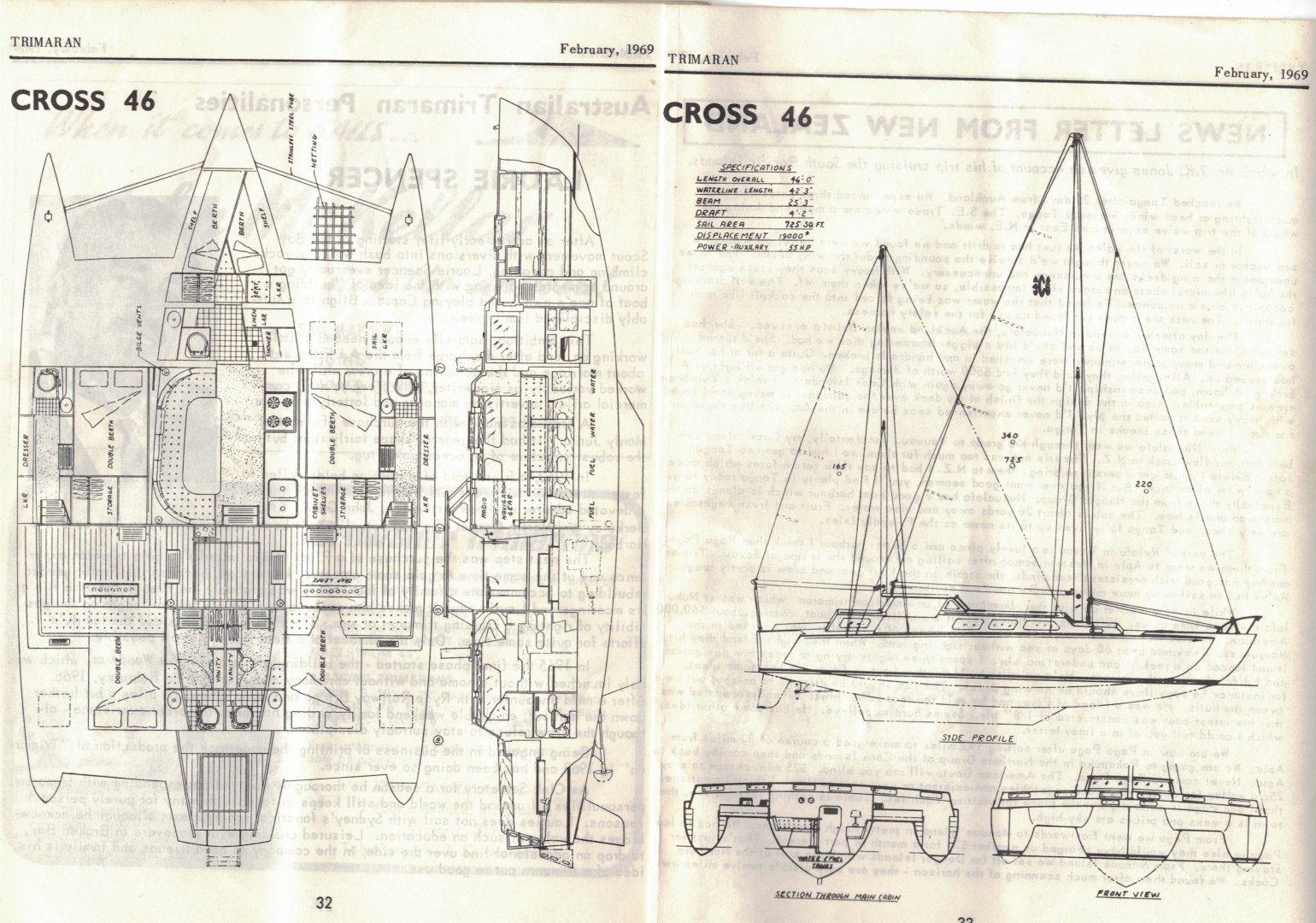

    The Cross 46 is a popular cruising trimaran from the late 60’s. The tri is 46 x 25.25 foot weighing 19,000 lbs and displacing 27,000 lbs. The ketch rig carries a 165 ft mizzen, 320 ft 14 oz main, 220 ft 12 oz self tacking jib, 400 ft genoa and a 1070 ft 1.5 oz spinnaker. It has aluminium masts with 5/16 inch stainless steel rigging with 3/8 inch SS caps.
    This boat is really about accommodation. I walked over a Cross 46 in Cairns owned by 2 South African couples. They had no problems living on the same boat after 2 years. Literally one couple had the starboard side of the boat and the other had the port side of the boat. They treated it like 2 apartments. They only shared the main saloon. Very few boats I know could achieve this level of privacy. The jpegs give an idea of the level of comfort.
    The trimarans were often home built from cold moulded Marine-ply / Epoxy sheeted and timber. These are large boats that take a lot of time to build but were designed for home building. There specifications were often slightly oversized to allow for the material quality variations etc. EG the hulls were double diagonal 6 mm ply. The hull curves have a big radius that helps minimise build problems etc. Several of these boats had the original mini-keel running about half the length of the main hull removed and daggerboards were installed in each float. The installation of the boards has allowed a Cross 46 to point up another five degrees and increased her windward ability immensely. The Cross 46 when cruising could average 135 miles/day on ocean passages. There have been reports of peaks of 15 knots in really good conditions (like surfing down seas in strong winds).
    The modern interpretation of these boats are either eg a NEEL 50 or a Lagoon 50 both of which could average higher speeds across an ocean but unless you have electric winches you will be working a lot harder to achieve that performance. A Cross 46 suited its time and if you can find a well maintained one would be a good buy, but remember you are buying a very big boat which will require continuous maintenance.

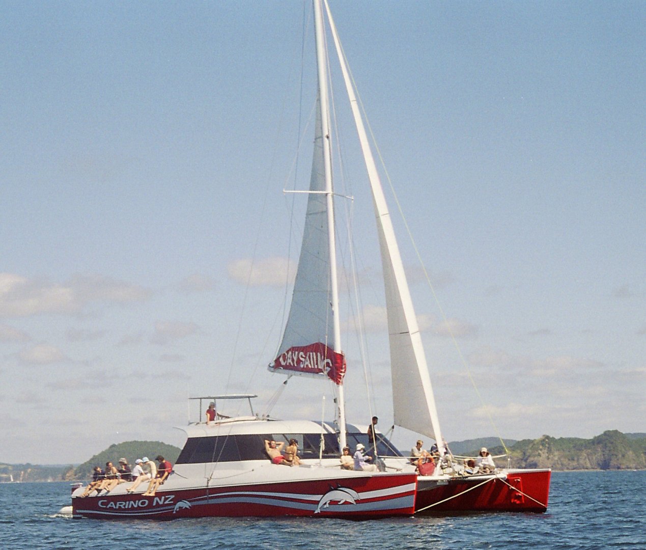

    This is a story of what can happen to a reasonable design when business is the driver. Carino started life as a 40 x 23.6 foot cat designed by John Morgan. It weighs 8800 lbs and was designed to be a charter boat in NZ for day trips in the Bay of Islands and could carry 40 passengers which means its displacement was about 17000 lbs. The mast was about 200 x 150 mm carrying about 700 square foot fractional sloop rig could carry full sail in 30 knots of wind to meet charter regulations. The cat was basically two 6 foot wide hulls at gunnel level and an open bridge deck with seating for passengers. When I sailed on the boat it performed quite well doing about 7 knots upwind in 10 knots of breeze with a max of 12 knots reaching in 15 knots of wind. The day I sailed it only had 12 people on board.
    The original construction was ply timber with 9 mm Gaboon ply hulls and hull decks with stringers at about 1 foot centre lines and ring frames every 3.5 foot. The bridge deck is 12 mm ply on top, 18 mm honeycomb core and 6 mm ply on the water side (remember this has to take up to 7000 lbs of passengers). The crossbeams are 2 layers of 12 mm ply either side of a timber top and bottom flange and uprights. The fore beam is an aluminium section. The bridge deck had a lightly framed canvas spay hood for guest comfort. A nice boat that could be turned into a minimalist cruiser for fun.
    But the charter business is not so kind. First Carino magically it is extended 10 foot to 50 foot long (cut here and insert and additional piece in each hull and bridgedeck). Next add a substantial cabin to accommodate those who don’t like wind or water, add some grunty desil engines to replace your two 10 horse power outboards and now you have a better money earner that motors as much as it sails. The original Carino spent most of its life sailing. Not that the current version is bad, its just the original 40 foot version was a very nice boat. Money often wins over nice. The first jpegs are of the old boat the last jpeg is of the 50 foot version.

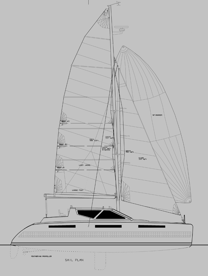

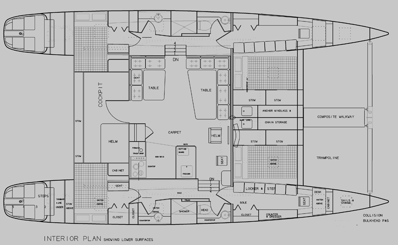

    A quick story of an evolving cruising catamaran. Kurt Hughes 45 bridge deck cat is one of his more popular designs. The revised 45 is 45 x 25 foot that weighs 12,000 and displaces18,300 lbs. The aluminium or the composite mast carries a 495 square foot main, 232 square foot blade, 368 square foot genoa and a 700 square foot spinnaker. So far there is not much changed from previous versions. The previous versions had a cylinder moulded ply or fiberglass composites hulls with ply or composite beams decks etc. The mast can be aluminium or carbon etc. Request the build option you like and Kurt Hughes will probably be able to provide it. As Kurt says he has chosen to allow the builder to make as many of their own parts as much as possible. EG The bow tube is composite, as is the compression tube, chainplates, mast and boom etc.
    But the real difference is in the hull shape. The previous versions of the 45 just had a simple U hull shape without steps or flares and an old “normal” bow. Now the hulls have reverse bows to dampen pitch in waves, and a spray deflector that slides back into hull flare. The hull flare is the best way to get good room inside the hulls and still have a skinny waterplane so it can be fast. What appears to be a small change requires quite a bit of design rework of bulkheads etc especially when you are also providing build your own options of masts chain plates etc.
    Basically the 45 has about the same internal layout options, but the boat has a suncover over the cockpit and transom steps for easy water access added.
    I have only spoken to one 45 owner of the older non flared hull model and he was very happy with his boat saying it was a great cruiser with reasonable speed and a simple rig. He could get 8 knot averages which is all he wanted. Top speed was irrelevant to him.
    The first 3 jpegs are of the older model but the layout and rig are similar. The following jpegs are of the new shape done by a guy who paid for the design and did an approximate 3D version of the hulls. The final jpeg is his plan for the foam core, orange is 100 kgs/meter and blue is 80 kgs/meter.
