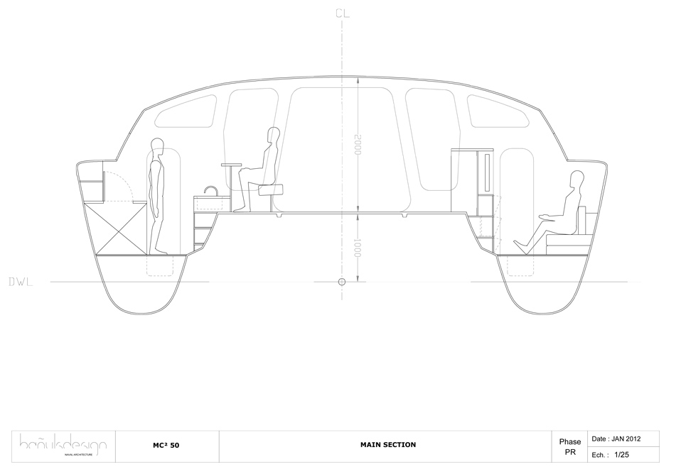

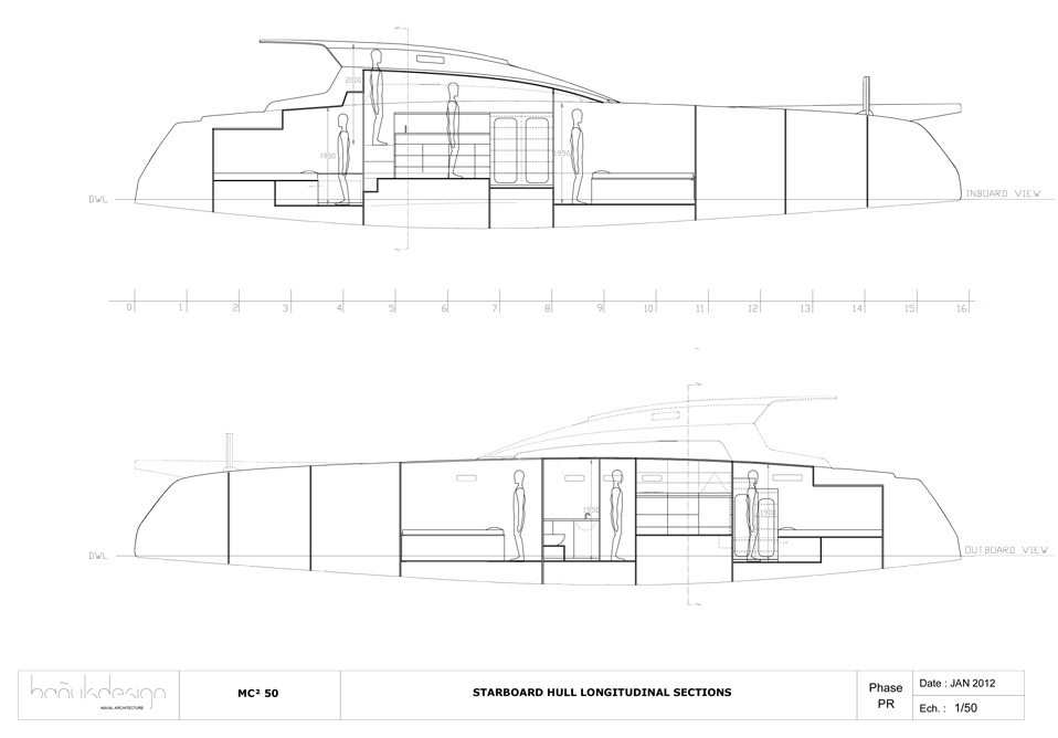

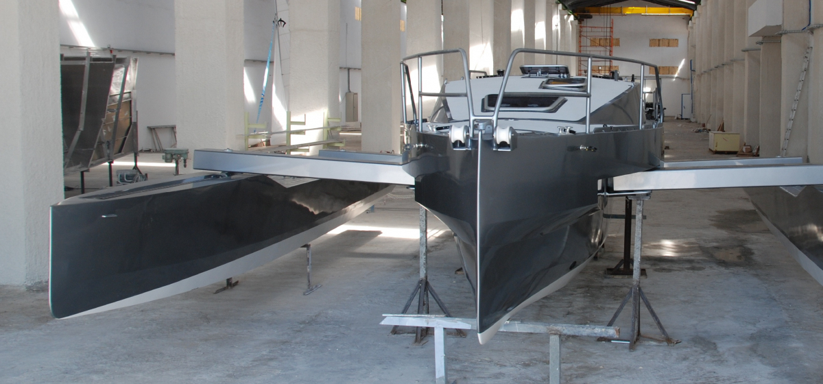

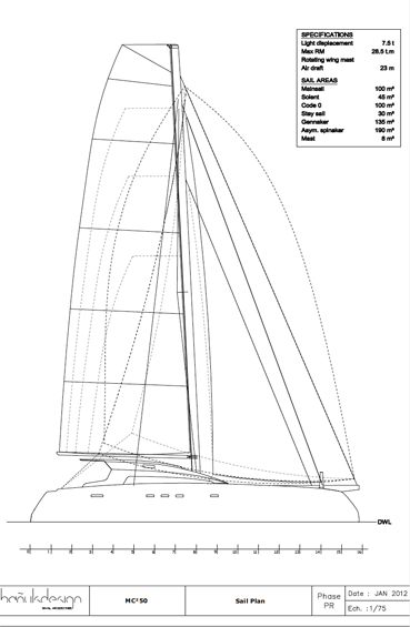

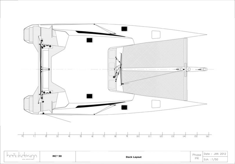

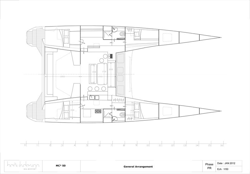

    The second Banul cat we will look at is the 53 footer. The cat again is a high performance cruiser of 53 x 26.2 foot weighing 16,800 lbs and displacing 22,200 lbs. The mast is 75 foot high and 86 square foot (sq ft). The sail area is main 1075 sq ft, jib 485 sq ft, code 0 1075 sq ft with a total of 2150 sq ft. Length to beam is 14:1 and a minimum underwing clearance of 3.25 foot. Again this boat is a very high performance cruiser racer. Again the hull and deck are E-glass / Epoxy foam (Corecell) sandwich construction. Hull and deck parts moulded from female tooling to reduce fairing and save weight. Vacuum bagged and infused to control resin content, fiber ratio and improve strength/weight ratio all post cured in an oven. The mainbeam, aft beam, daggerboards, main cabin roof, rudders, chainplates and selected reinforcements are all carbon fibre construction. If you can afford it the entire boat can be built in carbon fibre. Both the 60 and 53 cost in excess of $2 million US dollars for this combination of performance and space. I know a local guy who after giving Tony Grainger his start in boat design, he had quite a few Grainger boats built then brought a Banul 60. He then said he needed more performance so he went to DNA in Holland and brought a foiling T10 trimaran, 30 knots plus and another $1 million US plus spent. Oh well, for the rest of us we may as well continue dreaming.

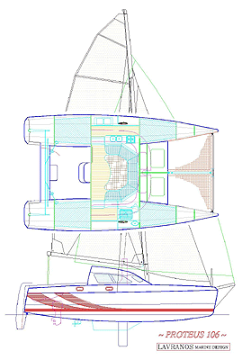

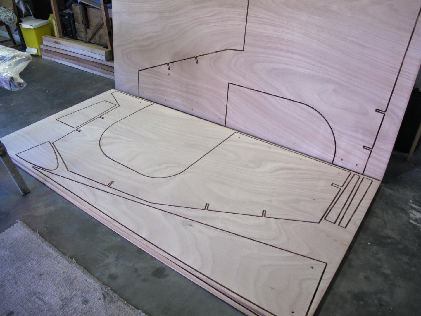

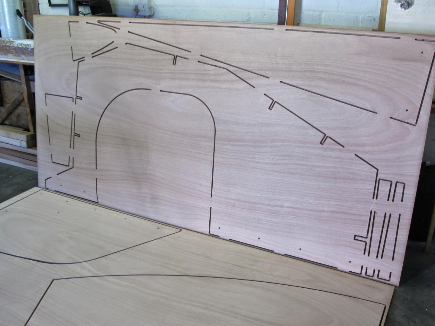

    This Lavranos Marine Design is a small family ocean cruising cat. The cat is 35 x 20.9 foot weighting 6300 lbs with 775 square foot of sail. It is designed to do ocean crossings and is of low cost plywood construction and could be built by a capable of amateur with a minimum amount of labour and skill. This simple, strong, cheap boat is also aimed at being practical for local use. She is configured with two machinery and keel variations; A 4 stroke 20HP outboard on a hinging nacelle is fitted for economy, as is tiller steering, with "kick up" rudders. The other choice is that a saildrive "single cylinder baby diesel" can be fitted, as can fixed mini keels. The rig is a pair of cap shrouds and headstay triangulated, single diamond. The sail inventory is essentially a mainsail, a roller furler jib, and a storm jib. Optional: Genneker.
    The hulls are 9 mm ply, underwing 12 mm ply, forward underwing 2 x 6 mm ply, bulkheads 9 or 12 mm ply. Stingers are 50 x 20 mm with some 60 x 30 mm in Meranti. Internal furniture 6 mm ply. Main cabin top build in material of choice. 87 sheets of Ockume Marine Plywood at BS1088 grade for hull and decks comprising of 6 sheets of 6mm x 1220 x 2440mm, 66 sheets of 9mm x 1220 x 2440mm, 15 sheets of 12mm x 1220 x 2500mm. It takes 150 kgs of Epoxy Resolution 816 and Cure Agents to build the boat with over 320 sq mtrs of 300 gsm cloth covering the hulls and decks.

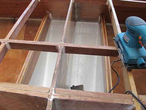

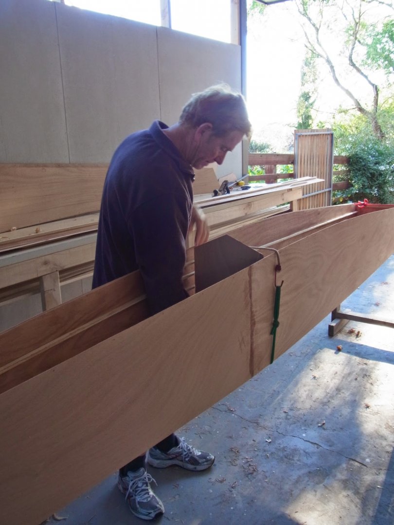

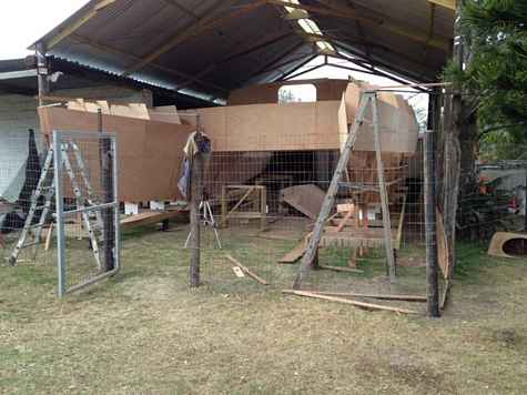

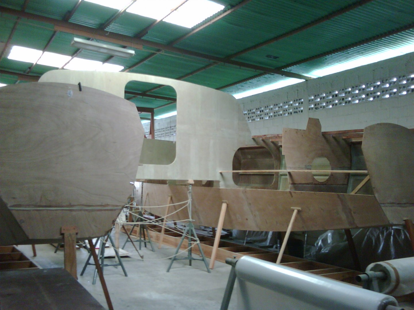

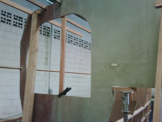

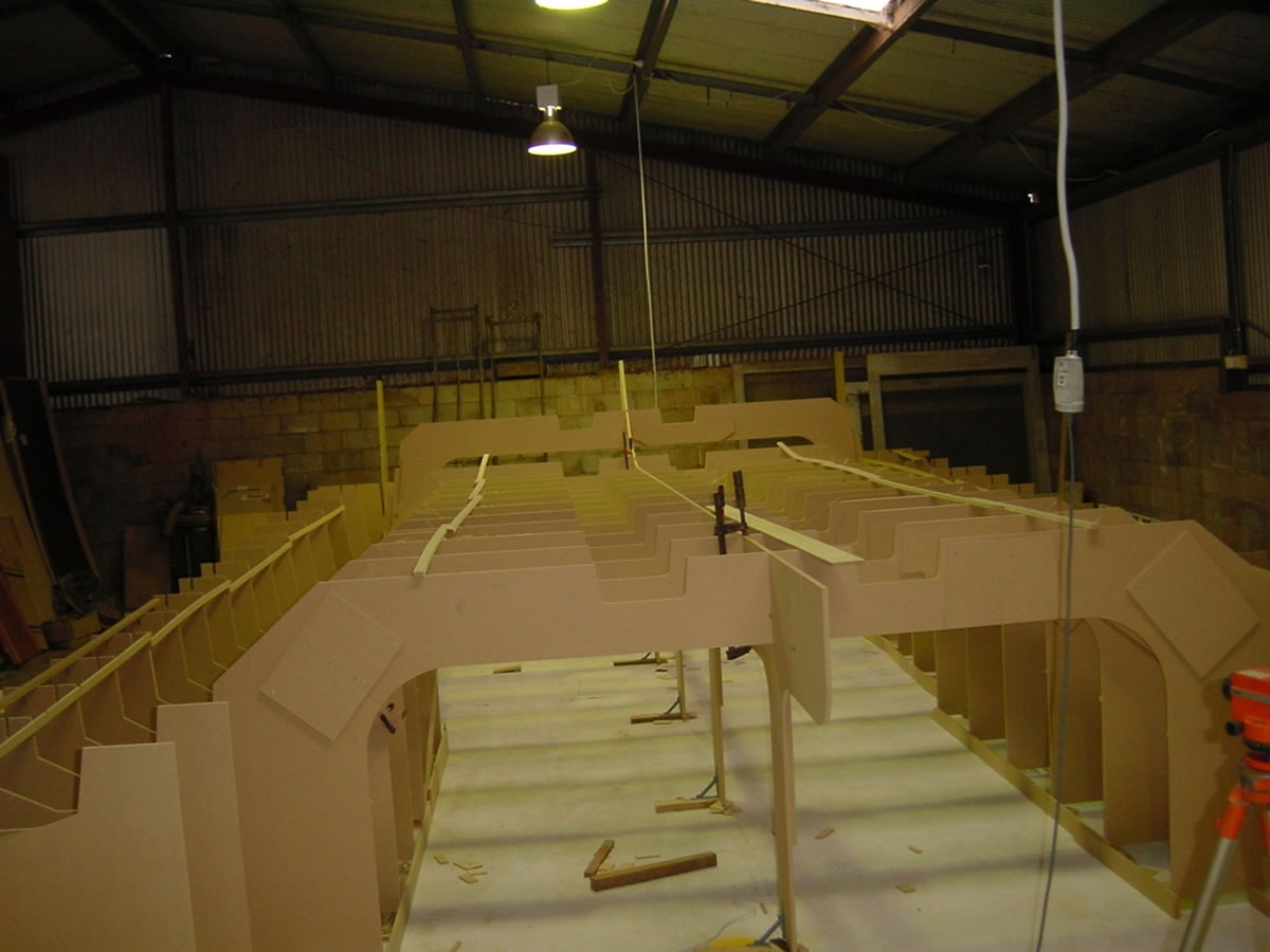

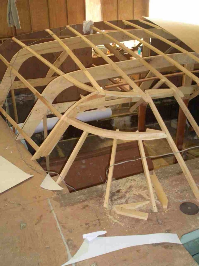

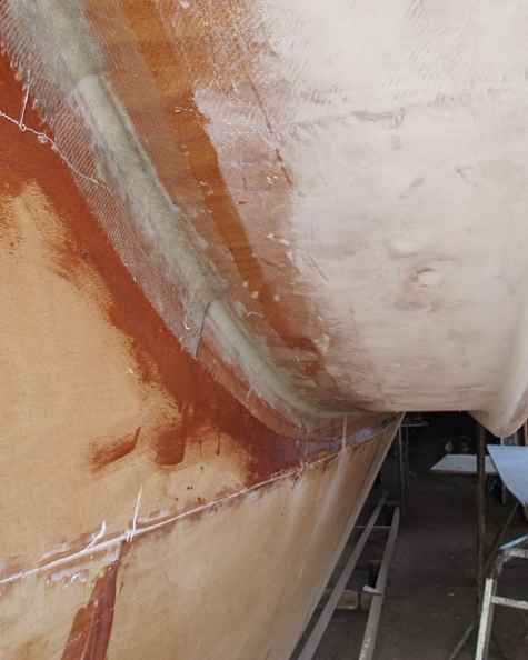

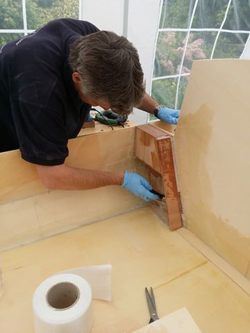

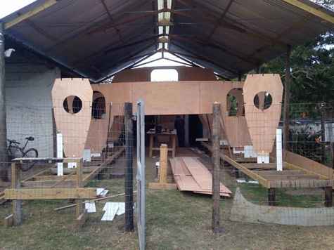

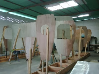

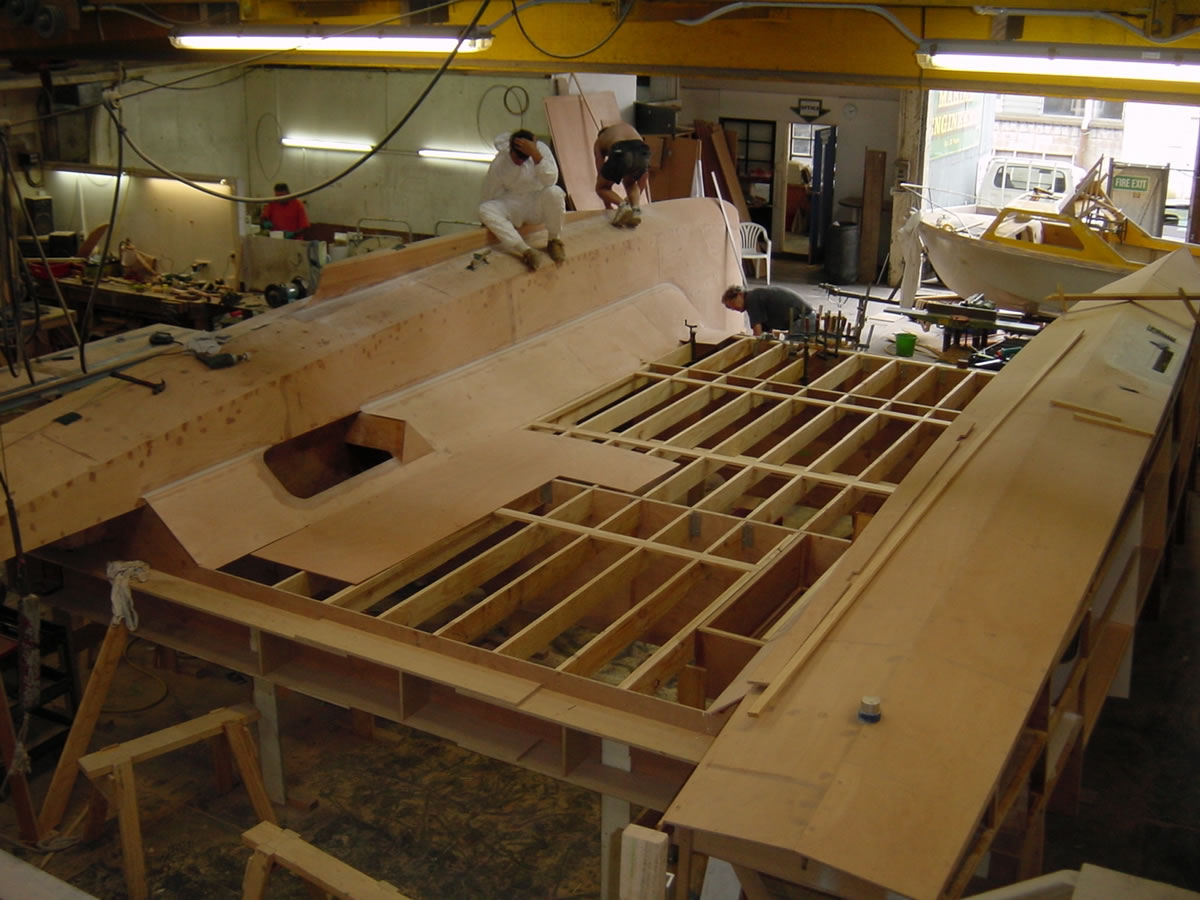

    Some additional jpegs of the Proteus 106 build. The bulkheads are 12 mm ply. Cab roof 4 mm ply 25 mm foam 4 mm ply.

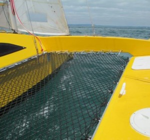

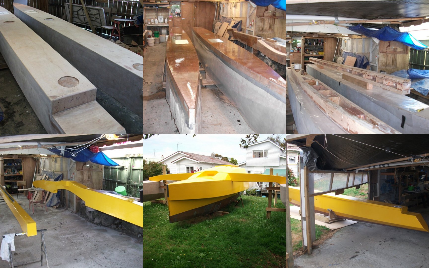

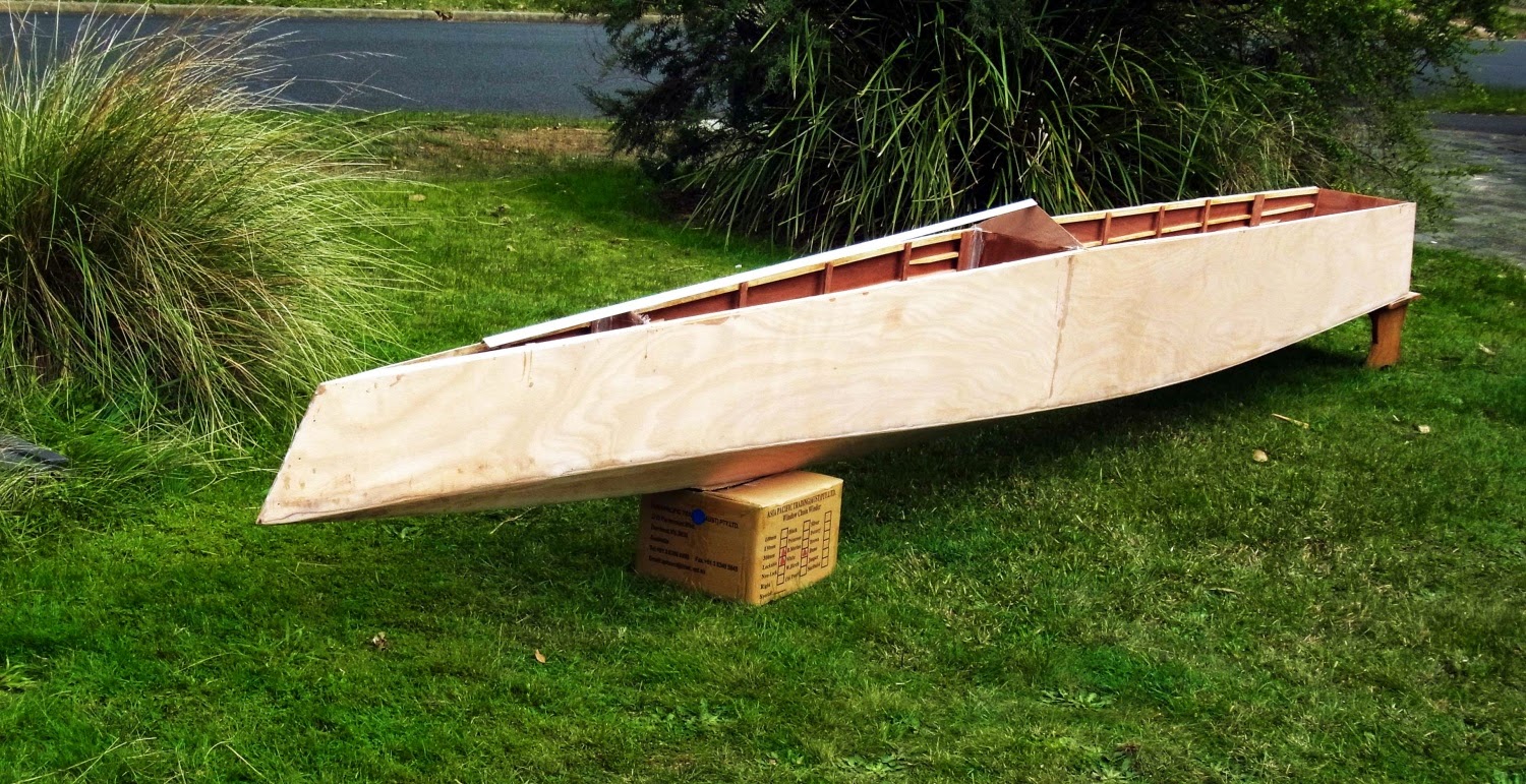

    Graeme Delaveau is a New Zealand designer of cats and tris mainly in plywood with timber stringers, crossbeams etc. The designer, first boat was Nick Cruz, so he named this tri Nicky Cruz 7.6. This build had the following mods: 1) longer floats to enable a straight beam across the rear of the cockpit and 2) the float sheer height raised. Nicky Cruz 7.6 Sports Weekender is 25' x 19' 3'' foot weighing 1600 lbs, displacing 2200 lbs. Sail Area 345 square foot on a 130 x 90 mm section, untapered so if I want to go to a square top later the rig will be stiff enough. Construction is basic 6 mm ply over frames and stringers glassed over. The wooden box beams have 2 timber lamination's top and bottom of beam with timber separating blocks every 500 mm, ply fore and aft faces. The rear beam is about 240 x 350 mm with top and bottom lamination's of 2 layers of 240 x 50 mm. The fore beam is deeper with a heavier lamination on the top flange.
    The owner of the yellow boat reported with his current rig he could carry full working sail in 20 knots upwind comfortably, and with a little judicious feathering of the main she seems comfortable in 25 knots of wind. The interior has a small galley bench and seat with 2 narrow side bunks. A nice cheap to build tri.

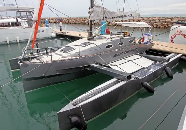

    The C329 trimaran nicknamed the Tardis is an aluminium trimaran of 29.5 x 20 foot that can fold to 8.2 foot. The tri weighs 7700 lbs and can displace 10500 lbs. It carries 620 square foot of main and genoa on a 38 foot spreader mast that has rigging to the main hull only. The main and float hulls and decks are aluminium with the cross arms of carbon fibre. It accommodates 6 people in 2 double berths and a saloon table that converts to a double. Headroom of 1.91m to 1.87m. A shower-toilet cabin. The interesting part of this boat is its folding system. The cross arms attachment to the float is on a track. As the float moves toward the main hull the cross arms rotate with the float end of the cross arm sliding forward or aft on the tracks in the float deck. A neat solution which keeps the floats parallel to the main hull as it folds. I have no details of any of the boats structure etc. This is a practical cruiser that has room and a reasonable carrying capacity. The jpegs give more detail.

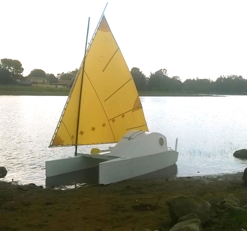

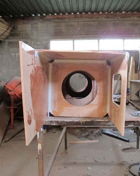

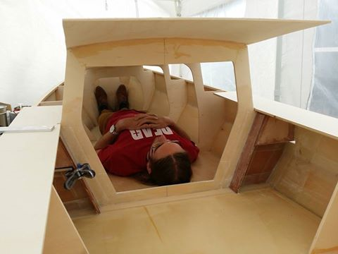

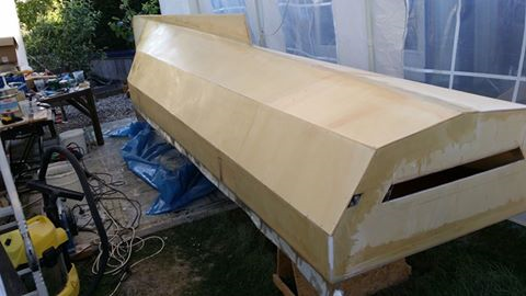

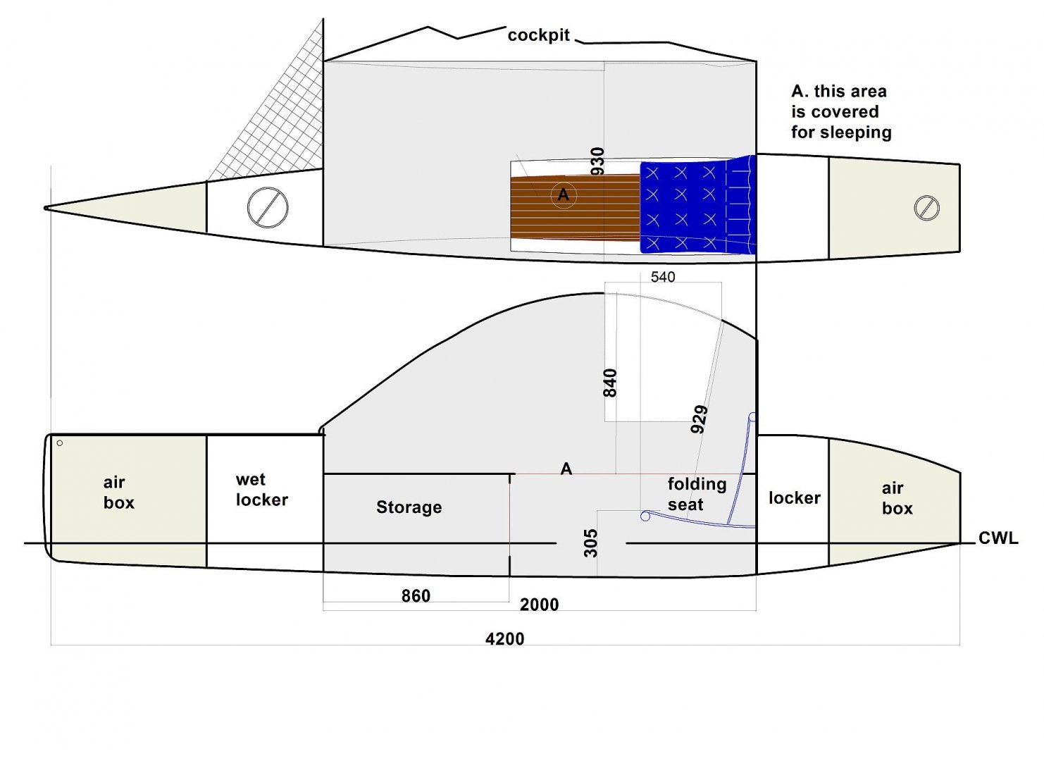

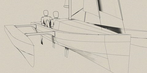

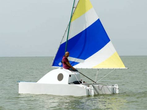

    Bernd Kohler designed a personal multihull cruiser for the least amount of work and cost. The boat is a cross between a catamaran and a proa. Unequal hulls like a Proa but sails like a catamaran. He calls it a CATAPROA®. The craft is 13.75 x 7.5 foot and can be compressed to 5.4 foot. Its empty weight is 200 lbs and displaces 630 lbs. It carries 88 square foot of sail in a “crabclaw” rig (actually a Sunfish rig). A one or two person boat for raids and treks. The cabin looks tiny from the outside but is adequate. Most surprising is the handling quality, which was even better than expected. Coming about and gibing is like a very good dinghy.
    To follow the low cost approach he used a Sunfish sail and parts of the rigging. The mast is a carbon tube with a diameter of 50mm. To shift the pressure points (CLR) of the hulls to the correct position in relation to the CE of the sail from one tack to the other, the daggerboard is canted forwards and backwards. The system works to perfection.
    Construction is the time proven plywood/glass/epoxy composite system. The construction is a mixture of systems. No “stitch and glue” (too time consuming when you look at the steps necessary). The hulls are taped together and then fillets and glass strips are added on the inside. The sheer line is conventionally built up with stringers. The boat was built in around 180 hours. A first time builder would require more time. The total weight of the boat including the rig is 89 kg. The mast hull weights a mere 22 kg. The hulls sides, bulkheads, decks, cabin are 4 mm Ocume ply. The keel panel, transom etc are 6 mm ply. Rudder housing, beam support etc is 8 mm ply. 18 x 18 mm gunnels and other wood supports. 20 x 25 mm stem. The exterior is covered with 100 gsm cloth in epoxy. Aluminium cross beams are 70 x 3 mm square tubes. The window is 3 mm polycarbonate. The jpegs give an idea of the Catproa.

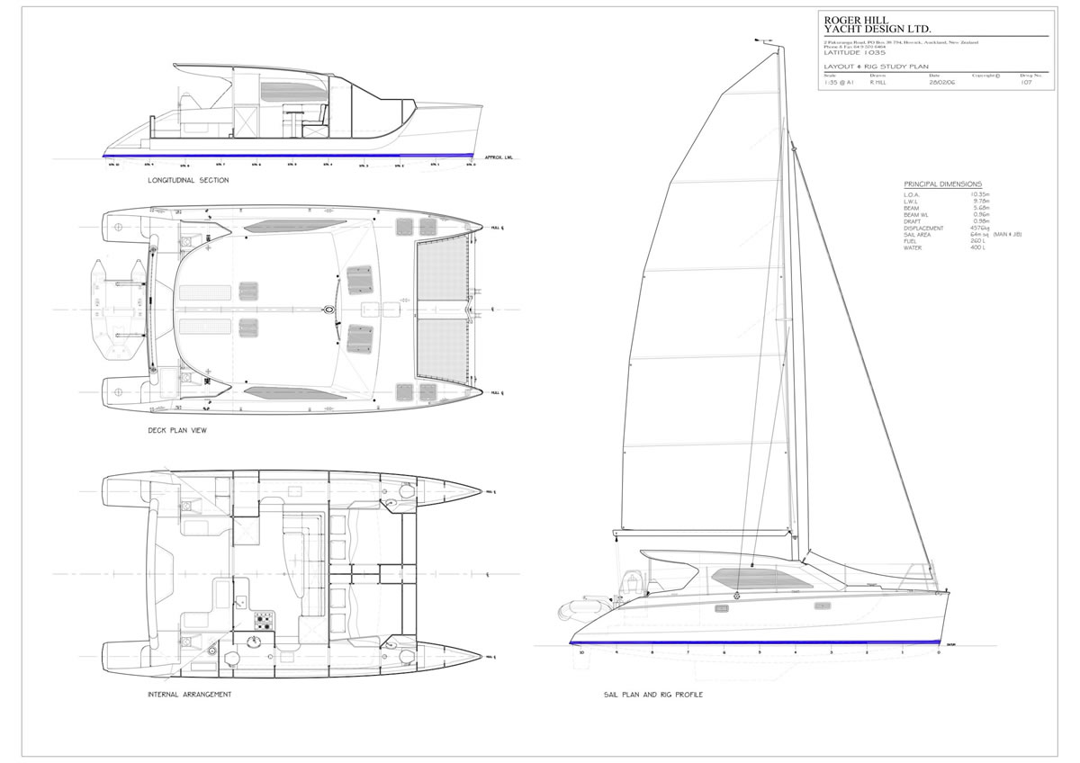

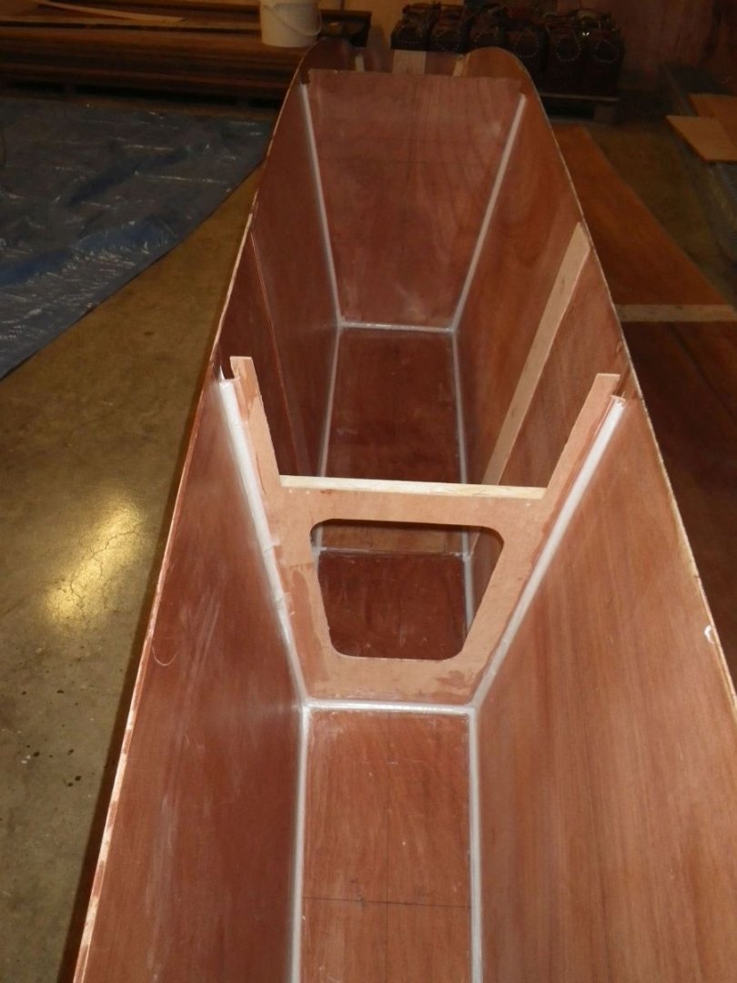

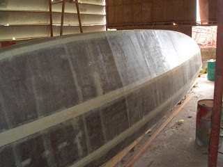

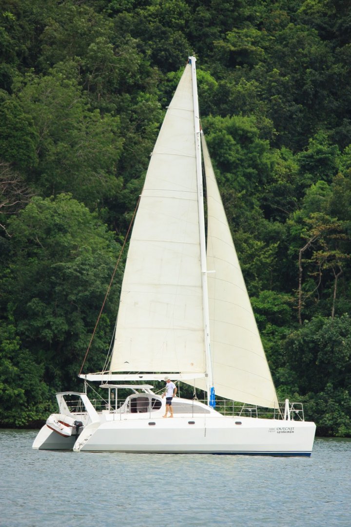

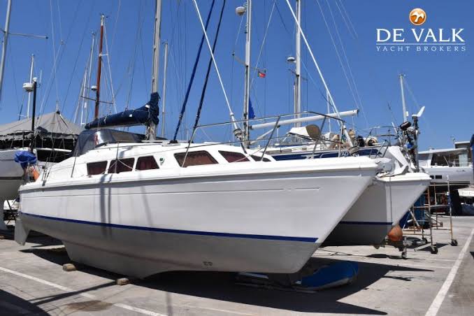

    The following 2 Roger Hill cats are close cousins. The 10.35 meter model is a semi production cat made from flat panels. The 10 metre is a ply home build design that has been built in several locations. The 10.35 is 34 x 18.75 foot displacing 10,200 lbs and carrying 690 square foot of sail.. The 10 is 33 x 18.75 foot displacing 8800lbs and carrying about 650 square foot of sail.
    The 10.35 can be obtained as a complete composite kit. The 10.35 was commissioned by an Australian builder who has orders for several boats destined for a charter group in the Whitsunday islands. The internal layout is offered in 2 versions, a ‘normal’ private yacht and the charter version! An option of centerboards or shallow fixed keels is also available, the later being cheaper and easier to build but not giving the same sailing to windward ability and shallow draft capability. The construction system is detailed completely around a composite kit set, pre made and pre cut flat panel process that will enable even the most unskilled amateur builder the opportunity to build this design as specified. The hull shape is a simple double chine around the bottom and there is a knuckle in the topsides that will add stiffness and reduce the panel size for ease of handling while under construction. The entire project can be built the right way up and there is minimal secondary bonding on the outside of the hull which will reduce the time and cost of the more normal fairing and painting process.
    The 10 meter is a plywood timber construction with single chine hulls. The design has a simplified but effective structure to simplify building. Construction is almost totally out of sheet ply materials with foam cored panels for the cabin top, bridge deck. and 2 primary bulkheads, there is a minimal amount of ‘solid wood’ required in areas such as the stems and connecting some panels where access is prohibited for coving and taping. A ‘beaching’ skeg is detailed that will allow the cat to take the ground without damaging the bottom and simplifies the steering with fixed, under hull rudders (and for prop protection should a small sail drive unit be fitted instead of an outboard). As is normal for all cats that are expected to sail well to windward centerboards are fitted but are not intrusive to the layout nor difficult to build and fit. The rig and sail plan is simple and the deck layout has all the sailing controls lead aft to the cockpit for ease of handling and safety. The jpegs give some detail.

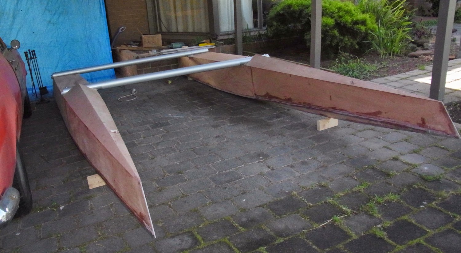

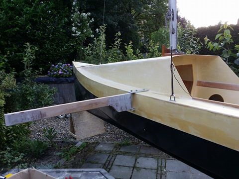

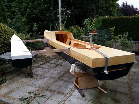

    The following trimaran is a dutch home build. The tri is a day sailor with a small cabin for storage or covering your head. The tri is 18.4 x 12 foot displacing 800 lbs. It has a day sailing cat rig EG Hobie. The main hull is 3.25 foot wide, the float hull is 1.2 foot wide. The main hull, floats and decks are 6 mm ply covered externally with 280 gsm glass cloth and epoxy. All chine seams are taped. Bulkheads and cockpit floor are 6 mm. The really fun part of this design is the folding cross arms. They are timber. The outer portion of the 3.25 foot cross arms 40 x 100 mm, the inner end are 40 x 180 mm. On the ends of the cross arms is glued a length of plastic gas pipe with an internal diameter of 8 mm. This pipe is glassed onto the cross arm with 4 layers of 280 gsm cloth intertwined with 5 layers of uni directional carbon fibre for about 200 mm either side of the beam. A 6 to 8 mm bolt is put through the pipe and connects to 6 x 50 x 250 mm stainless steel connecting plates. The connecting plates are bolted to 200 x 200 50 mm blocks attached to bulkheads in the main hull and floats. The timber cross arms after all the end connectors are complete is covered with glass cloth. This boat sails well and performs its job as a day cruiser very well, a mini Dragonfly type tri. A good concept.

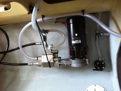

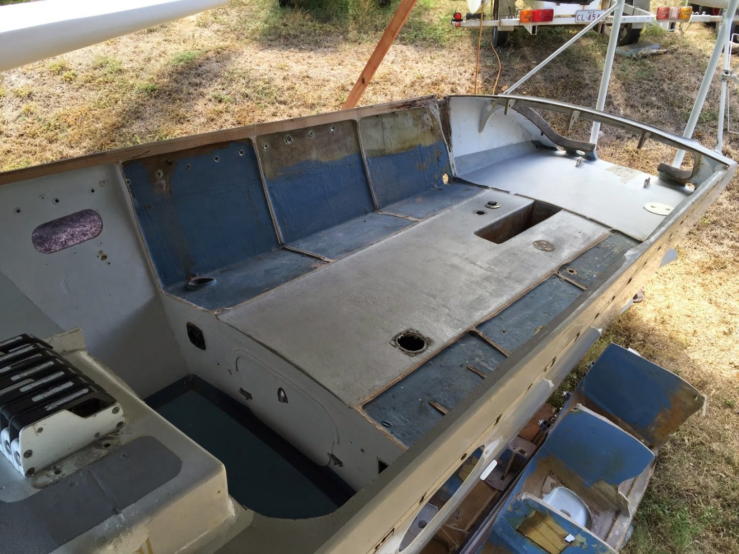

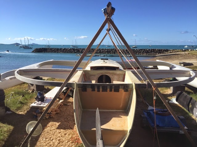

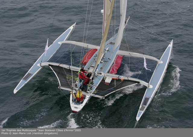

    The following is about a 1994 tri designed by Bruno Fehrenbach. The tri was designed and built for the formula 40 racing. Its 40 foot long and looks about 30 foot wide. Pure guess, but I would think it displaces about 7000 lbs. A later owner then hired Merfyn Owen to redesign the crossbeams. She is constructed of 12 mm strip plank western red cedar with 2 x 250 gsm UD E glass either side and epoxy. The beams which were timber and ply box beams reinforced with carbon fibre. The decks and bulkheads are plywood. After completion Spirit then "Spirit of England" went on to pursue a long and successful racing career.
    In 2010 she was sold to her current owner Jason Gard and underwent a mini refit. Her plywood float and ama decks were replaced with carbon. All the bulkheads were replaced using carbon ring frames in place of the plywood. All the work we did not only replaced what was there but it also increased the strength. Her rigging and electrical wiring was replaced after which she set sail to Australasia via Panama and the Pacific. Since then she has sailed more than 20,000 nm or halfway around the world competing in numerous races and regattas and is now enjoyed as a simple and fast cruiser. In Australia another full refit and rebuild of the interior and cockpit was done. Everything has been removed, paint sanded back to timber and glass in most areas and then it's been redesigned and rebuilt out of 60HD foam with a layer of 400 gsm double bias on each side. The boat has minimal accommodation with only 2 bunks one either side of the daggerboard case. The boat had a water maker installed in the Caribbean. The water maker or desalination unit has proved to be one of the most impressive things we have. It uses very little power (16 amps) and produces about 25 lts an hour of fresh water. It's incredibly simple and there is a lot of information on the net about the units.
    The reason for the interest is the amount of effort to keep this boat going. Its had cross beam redesign and rebuild, its had float decks replaced, its internal plywood bulkheads have been replaced by carbon foam structures. Its entire interior has been stripped and replaced. Its cockpit has been stripped and rebuilt. Its had a complete rig replacement and a complete set of sails replaced. The boat was still winning serious races in 2015. The accommodation is sketchy at best for a 40 footer. The “upgrades” have cost in excess of $150,000 and months of personal effort by the owners. The reward they have sailed half way around the world with 200 mile days are normal. Peak cruising speeds is 16 – 18 knots. Racing the boat goes 20 knots plus.

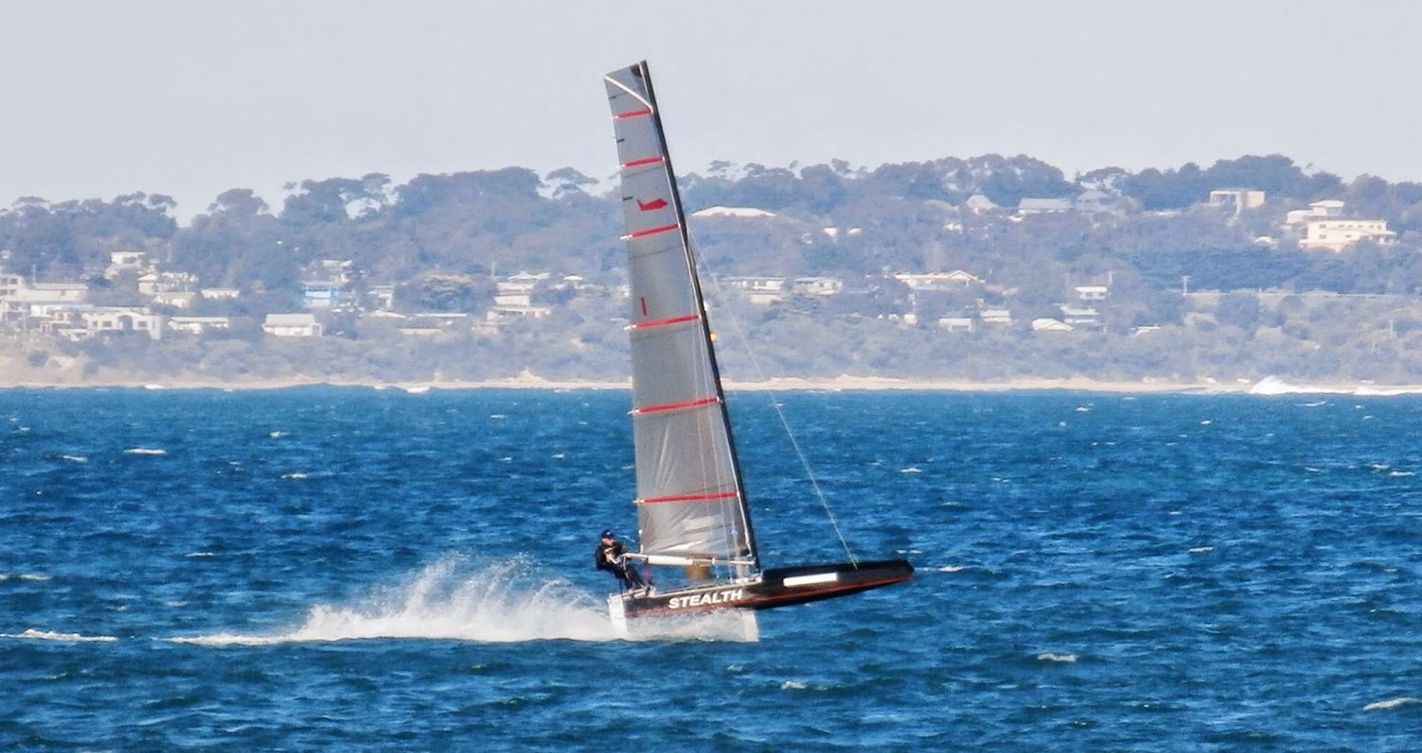

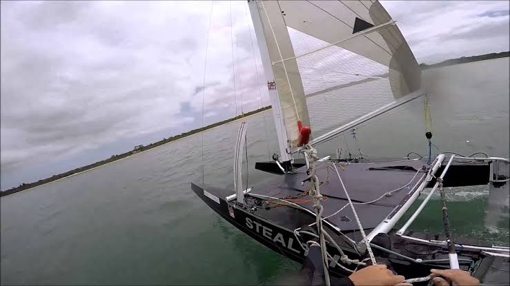

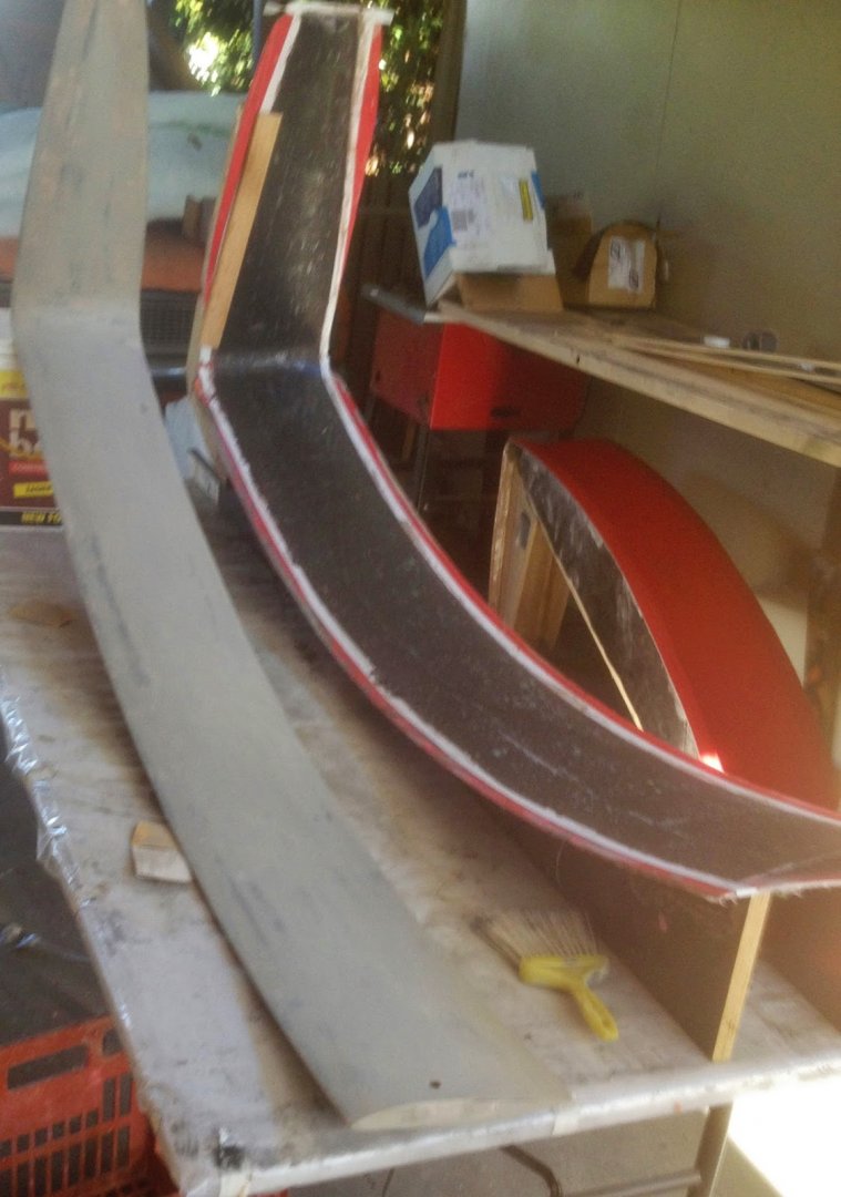

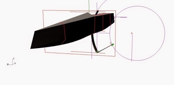

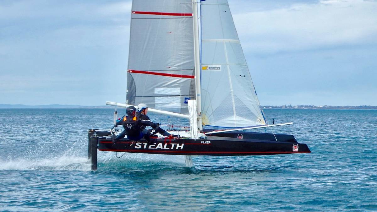

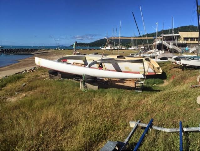

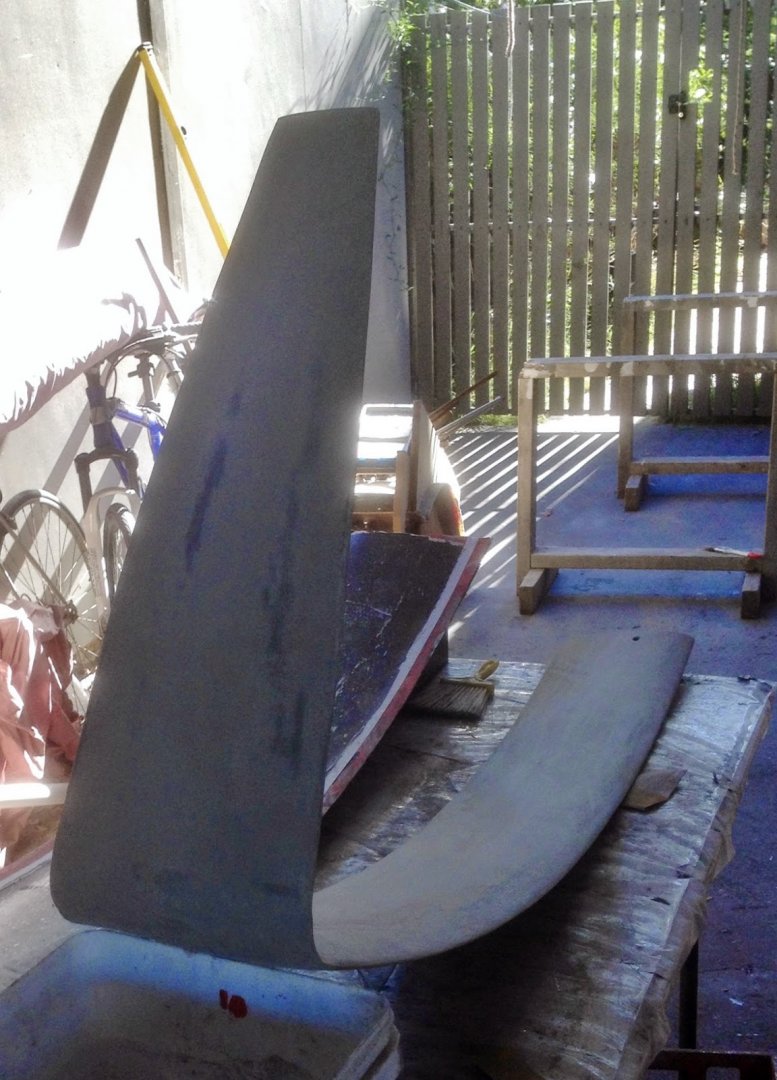

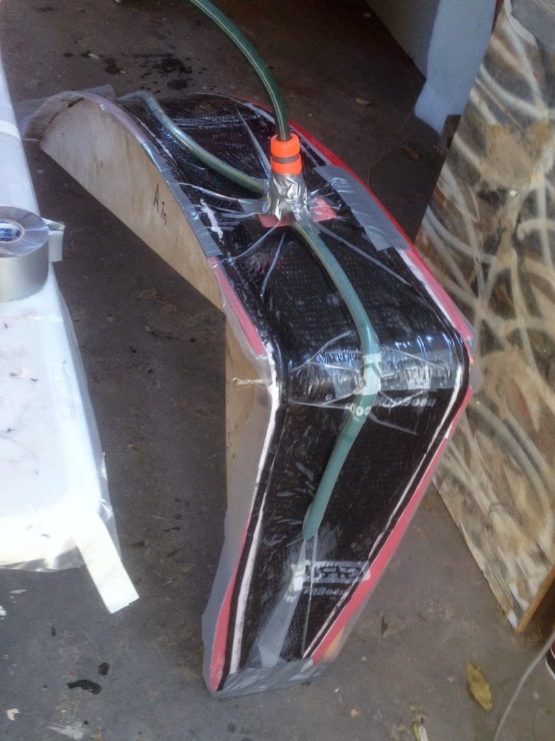

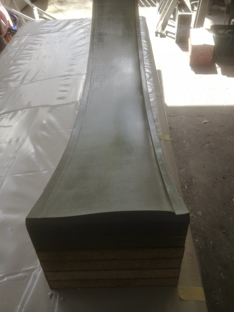

    This boat may be known to a few of you, the Stealth 15. The Stealth 15 is a plywood foiling cat that was developed by Barry Marmion with his son Brad. Barry was involved in the building of several of Australia’s early C class cats and understands how to build and develop very fast day sailing cats. The 15.5 foot ply hulls were built in Barry’s carport using 3 mm plywood with timber stringers as shown in the jpegs. The boat is 15.5 x 8 foot carry about 140 square foot of sail. He glued 3 broken sections of A class carbon mast together and rigged it with a 2nd hand cut down A class main to end up with a boat costing $ 4,500.
    Brad and Barry decided to design and retro fit foils to the Stealth. To construct the moulds Barry had 8 plugs (4 for each foil) made up using a router machine at RMIT, and then took moulds of the plugs. The 1st set foils had 10 layers of 200 gsm carbon and an expanding foam core, they weren’t up to the stresses and broke under the keel. The 2nd foils of consisted of 15 layers of 200 gsm carbon fibre with end grain cedar core They are still good a bit heavy (5 kg) each. The materials for moulds and foils cost around $ 2,500.
    The development process was not easy due to the fact that Stealth was not built for foiling. Breakages include 1 set of foils, 4 rudder blades, 5 rudder boxes and Barry had to reinforce the main bulkheads. From the jpegs you can see it is a viable foiler that can do what was intended. I do not know if plans are available.

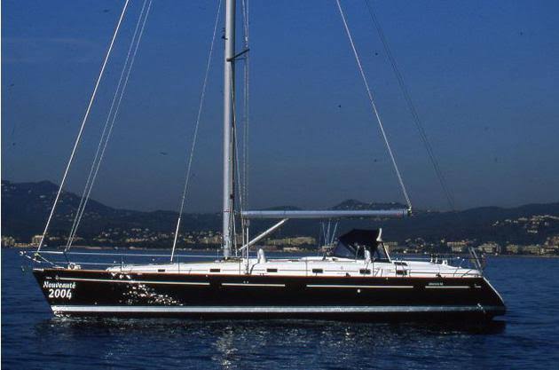

    Catsketcher again brings up a very valid point about the fatigue life of a hull, deck structure etc and how some boats are ”over built” to allow for this fact. I fully agree. But there is a limit to what is required in over building. In the Nordhavn 64 trawler case the boats 101 mm thick fiberglass hull is an absolute overkill. The Nordhavn 64 displaces 185,000 lbs (82 tons) could live with a 60 mm layup and still be strong/stiff enough. The Lagoon 38 weight is 16000 lbs and displaces 22500 lbs with a 12 mm bottom. The Prout 45 displaces 22500 lbs has a 9 mm solid bottom. A Prout Snowgoose 37 weights 12000 lbs and displaces 18000 lbs has a 7 mm thick solid bottom. All of the cats, if they have low aspect ratio keels, will have heavier layups (up to double) in and very near the LAR keel. As you can see the Lagoon is very solid and I would almost say its overbuilt.
    The Beneteau 50 is 28000 lbs displacement and the hull is built with a reasonable safety/fatigue factors. EG Westerly 490 29000 lbs is 15.5 mm thick, Swan 48 displacement 31,000 lbs Kevlar, uni glass is 13 mm thick.
