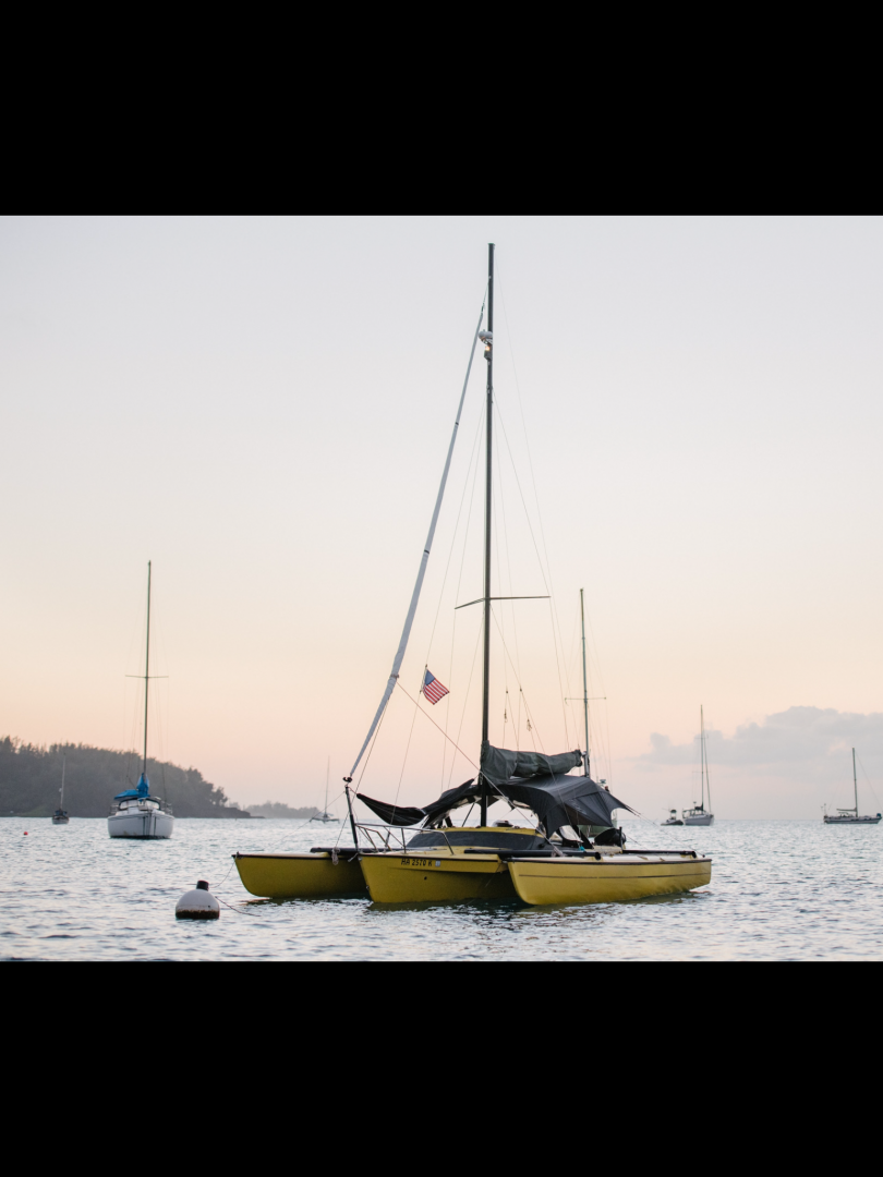

    As I mentioned I have been putting a little write up together on the Tramp that I intended to share here someday. I figured I would finish it up and go ahead and post it now since there has been an inquiry about it and we are discussing it.
    Some of it may be redundant, but hopefully these last few posts will be helpful to anyone seriously considering the purchase one of these boats:
    I thought I would do an in depth feature on Ian Farriers Tramp trimaran.
    As a past owner I have first hand knowledge of the design and still have a lot of photos and documentation, and I believe the Tramp played an important role in the history of trailerable trimarans which is sometimes forgotten or unknown.
    A lot of people know Corsair, but before Corsair Ian Farrier designed and introduced one of the most popular best selling production built trailerable trimaran designs known as The Tramp.
    The original Tramp was manufactured by Haines Hunter and featured Farrier’s patented folding system which was later incorporated into the first Corsair, the F27.
    If one was to compare the F27 to the Shelby Cobra, then the Tramp was Farriers AC Cobra -smaller, less power, simple, but with the same basic formula and concept.
    Borrowing from his earlier Trailer Tri design, the Tramp had all the same bells and whistles but was instead production built in fiberglass sharing many of the same features found in later Corsairs.
    A trailerable day sailor, The Tramp concept was all about ease of use from trailering, to sailing. Light and compact enough to be towed by a car, but roomy enough for a whole family, the Tramp at only 19’6” features a spacious cockpit, kick up rudder and center board, built in storage lockers, and a lightweight beach cat style mast with internal running rigging exiting at the mast base inside the cockpit.
    The Tramp was also available in a Super Tramp version which featured a taller mast and bigger sail plan with the addition of running backstays.
    I have attached the specs and drawings for reference, and will instead focus on what I think are the Tramps strengths and weaknesses.
    First, construction-wise The Tramp was overbuilt. Haines Hunter was/is known as a power boat manufacturer and the hull layup is very robust with a thick Gelcoat finish. Ian later admitted one of the main things he disliked about the final product was it being overweight, that and how expensive it was to produce the boat and how they didn’t really make any money.
    Also being his first production built boat, and launched during a time when Multihull safety was a topic of argument, I suspect Ian errored on the side of caution and overbuilt the folding beam system which is comprised of thick wall foil shaped aluminum tubing.
    Back to the weight issue, while light weight is important for speed and sail ability, the positive thing about the build quality of these boats is that they have held up very well after 44 years of use and abuse, thanks to the tried and true construction and quality materials used.
    Now for some of the things that make the Tramp great.
    First, its big roomy open cockpit with unobstructed views and a boom positioned high enough above for a bimini top below to keep you out of the elements and protected from the swinging boom.
    Second, an internal halyard control line system which exits the mast inside the cockpit putting the majority of the lines in one spot making single handing a breeze without disturbing occupants.
    And while on the topic of the mast, stepping it is a less hectic and scary affair as the base of the mast hooks on a pin mounted in the cockpit floor so the mast can be lifted and pushed forward until it meets a cove in the cockpit combing where a lock pin is then inserted.
    Third, for such a small boat you still get things like an anchor locker and a large sail/storage locker in the bow. Some even convert the large locker into a head or single birth. There’s also a built in storage locker in the trunk, and it’s easy to add additional storage if needed.
    Now, why I feel the Tramp played a significant role in the popularity of the modern Trimaran trailer sailor.
    First, some 200 or so boats were said to have been made and they ended up all around the world, with a lot still being actively sailed today.
    For a lot of people, the Tramp was probably the boat that started their love affair with Trimarans, with many later moving up to larger more capable and expensive Farrier designs.
    Corsair is a well known brand with more production built folding Trimarans sold and sailing than any other I would imagine.
    The Tramp was basically the production prototype for what would later come. Farrier learned from the manufacturing mistakes and continued to refine and improve his design creating bigger, faster, more capable trailerable Trimarans that borrow from the same basic design features of the Tramp.
    And so the Tramp, as his first foray into mass production, played a most important role in the lineage of his design, as well as his earlier non production designs of course.
    Now for the Tramps weaknesses.
    I’ve already mentioned it coming in overweight. Now couple that with semi-submersible floats and low freeboard, and you have a boat that can be wet in chop/swell and sensitive to weight and its placement.
    Construction-wise after 40+ years there are known issues with these boats.
    The first issue is the top deck to hull joint. After many decades the glue becomes brittle and you can get leaking from rain and when submerging a float. Some people live with it, others have removed the rub rail and cut the lip of the joint flush and glassed it over smooth. I found success running a thick bead of neoprene caulk around the top and bottom of the rub rail where it meets the hull surface.
    The second most common issue is daggerboard case leaks when sailing. There is a modification that can be done to fix this which is best done when servicing the daggerboard uphaul/downhaul system. It is documented on the owners group forum.
    Third is the motor well on the Tramps as well as some later Corsairs is too tight and restrictive to allow the motor to be trimmed well clear of the water. I suspect when the boat was designed smaller cowled lighter weight 2-strokes were the popular motor, but today most people use 4-strokes which are a bit bulkier. The solution is to notch the rear section of transom along the back of the well along the bottom to allow the leg to tuck further up to clear the water.
    Forth, if you buy a Tramp I highly recommend you remove the floats and clean, inspect and grease the bushings and bolts that comprise the folding system. These boats have been folded and unfolded numerous times over the decades, with water, dirt, salt, etc.. finding its way into cracks and crevices. It’s amazing how reliable and well Farriers folding design works, which is why it’s been the gold standard, but it’s a bit unfair to ask an articulating mechanical system made up of metal and plastic with such an important job to continue to perform flawlessly after decades of use on and off the water. So seriously consider preventively servicing the folding system before you experience a failure.
    Lastly, due to the shape of the hull with the stern rising up to meet the transom, when you launch a Tramp, you must submerge the boat and trailer adequately to get enough volume in the water to lift the boat off the trailer. If you are launching in shallow water or at a launch with a mildly graded ramp, you might consider adding a tongue extension to the trailer. The original trailer had a tilting feature I suspect to aid in such situations, but I found an extension to work best.
    Also while on the topic of trailering, be sure your rollers and supports are in good condition. The outer floats are designed to just touch the outer bunks when folded. If however you have broken rollers or collapsed supports, or one fails during transit, it may cause the floats to rest too heavily on their bunks which can cause damage to the outer float hull skins.
    Now for some cool mods you can do to the Tramp.
    First, there is ample room and structure in the cockpit to add additional storage and access hatches, and equipment like stereos, breaker panels, GPS, etc..
    You can also easily modify the cockpit to transform the entire thing into a giant bed for camp cruising by adding support rails either side of the cockpit below the bench seats to rest bunk board atop. I made mine up of separate panels that would then stack and stow just in front of the mast under the cockpit combing.
    I believe all standard Tramps came with the welded outboard eyes on the rear beams for use as anchor point for running backstays. Following Farriers drawings one can add tangs to the standard Tramp mast and attach runners for additional support when flying headsails.
    There was an optional camping cockpit enclosure offered for the Tramp, however if you don’t have one you can use the bimini as a support for a soft dodger enclosure and a couple of hammock rain flys to create enough protection to keep from getting wet provided the boat stays pointed into the wind. Otherwise a tarp over the boom in A-frame orientation will do the trick.
    With the additional of a boom extension slipped into the end of the boom, one can stretch and tie up a hammock so that it drapes from the mast to the boom end above the cockpit floor, under the bimini. Alternatively, one can also drape a hammock from the mast forward to the bow using the bowsprit vertically stopped agains the rail to support the opposite end, with the hammock draped over the forward deck.
    Lastly the forward locker hatch has ample surface area to mount a small solar panel that will keep a 12V battery topped off for light load use like lights, stereo, bilge, USB charging, etc..
    For those seriously considering the purchase of one of these boats, I highly recommend you read the Sailing Manual OldMulti posted a link to above. It will tell you everything you need to know about these boats, and it’s not often that one is provided with such a thorough resource.
    After owning and sailing the crap out of mine, mostly in much more dynamic sea states than it was designed and intended to be sailed in, I will forever be a fan of this design and it’s robust build quality.
    I can also honestly say that this original review of the boat, back when it was new on the scene, really captures the essence of the Tramp and sums up the Tramp experience quite well.

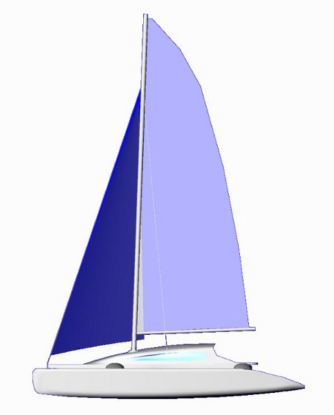

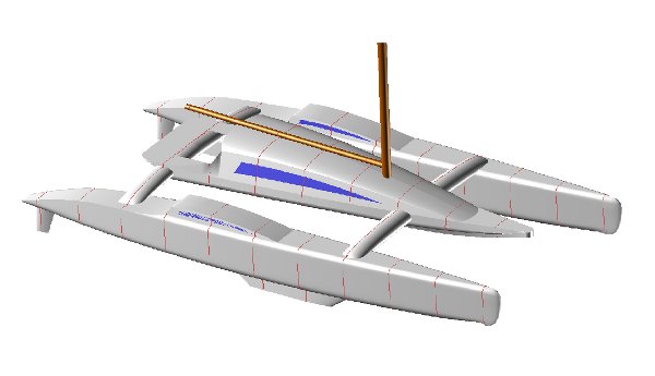

    The following has been done before but I found a few more diagrams of the design. The “Resort” is a trimaran that is a floating hotel aimed at the charter market but could be a very effective floating house capable of some ocean travel. The sailing rig and engines could drive the vessel at EG 10 knots under the right conditions in reasonable comfort due to its size and configuration. Upwind would be more about the available power but reaching or running could be sail alone.
    The resort is 85 x 42 foot with a weight of 112,000 lbs and a displacement of 145,500 lbs. The two 75 foot masts carry a total sail area of sail area 2500 and 3000 square foot depending on the use of 3 lower sails or 4 including the flying upper stay sail. All the sails would be roller furling and be controlled by electric winches. The length to beam over the main hull is 7.8 to 1 and the float length to beam is 9 to 1. The draft over the fixed fin keels on the floats is 5 foot. There are 2 engines which are 110 kW electric and 2 x 28 kW thermal generators. No mention of the batteries etc.
    As a commercial charter vessel, the accommodation includes 6 fairly large VIP cabins (of 12 sqm) with ensuite bathrooms, and additional pullman (up to 18 passengers). This is the equivalence of 4 star hotel rooms with crew providing equal service and quality. There are large private open spaces inside and out. There are separate crew quarters with a crew mess for the up to 6 crew. Helming and sail control is on the forward edge the flybridge.
    The construction is composite foam glass. The build would feature a lot of flat panels due to the simple shapes and I suspect an aluminium deck house superstructure to simplify the window instillation and handle the large open spans. This build would require an excellent electrician and plumber to a design the layouts and install to equipment. I hope they had an equivalent on board engineer to maintain this gear whilst sailing. Big boats have big maintenance requirements.
    The performance limitations of this tri are the wide hulls that are required for accommodation. The tunnels between the hulls are low and narrow which is OK for a power cat or tri with unlimited horse power but causes a lot of drag for a sailing craft.
    If you want a floating home this could be a good idea but if tou want performance under sail look elsewhere. The jpegs give the idea.

    This tri is designed and built as a cruiser racer with the emphasis on the cruiser part. Designed by Nigel Irens/Benoit Cabaret and built by Marsaudon Composites, Paradox was launched in 2010. The overall concept was derived from the ORMA 60 ocean-racing trimarans., but the owner, Peter Aschenbrenner, wanted a multihull that was safer and that could be sailed short-handed with non-professional crew.
    Paradox is 63 x 46 foot with a displacement of 19,700 lbs. The 78 foot carbon fibre rotating wing mast (has a 1.8 foot chord and 144 square foot area) carries 1,927 square foot of sail area upwind and 2,433 square foot of sail downwind. The length to beam on the main hull is about 16 to 1 and the length to beam on the floats is 18 to 1. Draft over the rudders is 5.5 foot and over the daggerboard when fully down is 13.5 foot. The engine is a Volvo 75 hp turbo diesel.
    Compare this to an OMRA 60 which is 60 x 60 foot displaces around 12,000 lbs carries a 98 foot carbon fire wing mast with over 2500 square foot upwind and 3500 square foot down wind. The draft over the daggerboard can be 15 foot with foils on the floats. The power to weight and stability of OMRA 60’s made them very fast boats.
    So, Paradox is a cruiser how does it sail? Compared to a true ORMA 60, Paradox has a smaller rig – her mast is some 18ft shorter and she flies her gennaker from the bow rather than a long bowsprit. With 3 tons of extra weight due to her full interior and less sail area she is a far more comfortable boat to sail than her ORMA cousins, but Paradox is still capable of cruising at well over 20 knots and reaching 30 knots at full tilt. In the RORC Caribbean 600 Paradox averaged 15 knots for 40 hours in the 600 mile race around 11 Caribbean islands.
    The accommodation is limited but very practical and comfortable with plenty of space and headroom. Totally reliable with solar power, a watermaker, refrigerator and plenty of storage space for food equipment etc.
    The build is constructed from epoxy resin infused carbon fibre rather than pre-preg over foam and Nomex cores, Paradox has exceptional torsional stiffness and a much higher load tolerance. Nigel Irens really understood what structure was required to produce this cruiser which has allowed it to be driven hard over the years. Paradox’s carbon fibre wing mast rotates up to 45 degrees to each side. Her heavier weight provides similar righting moment to an OMRA 60 but Paradox has a smaller rig which allows her to be driven hard in heavier airs.
    This is an excellent example of what a fast cruiser can be, pity I am not a mega millionaire to have one. The jpegs give the idea.
