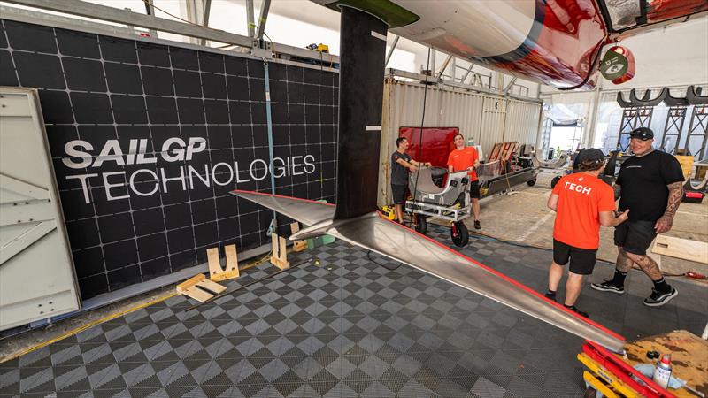

    SAILGP has confirmed that its new high-speed T-Foils will be added to its entire international fleet of F50s in January 2025, ahead of the ITM New Zealand Sail Grand Prix | Auckland. SailGP CEO Russell Coutts said the development would be a ‘game changer,’ anticipating the league’s latest upgrade would bring faster speeds and the most competitive racing to date. Set to replace the current L-Foils in season 5, the T-Foils were designed to improve the performance and control of the F50s at high speeds. The new design eliminates the issue of negative loads damaging the foil structure and reduces loads on the board cases, reducing the amount of maintenance and repair needed.
    Constructed from machined titanium and carbon, the T-Foils have thinner sections than the current L-Foils, allowing them to delay the onset of cavitation by around 11 km/h / 6 knots. When combined with the in-development rudders, the onset of cavitation will be delayed further still, resulting in increased control and higher speeds. The expectation is that the current speed record of 99.94 km/h will be broken by speeds approaching 110 km/h (59 knots).
    The global racing championship has carried out testing over the past 18 months at venues around the world, with a number of teams getting first-hand experience of the new test foils in training. The Canada SailGP Team clocked 101.98kph (in a wind speed of 32kph) using the new foils while testing in San Francisco, the fastest-ever speed registered on an F50.
    The jpegs give the idea of the new T foils.

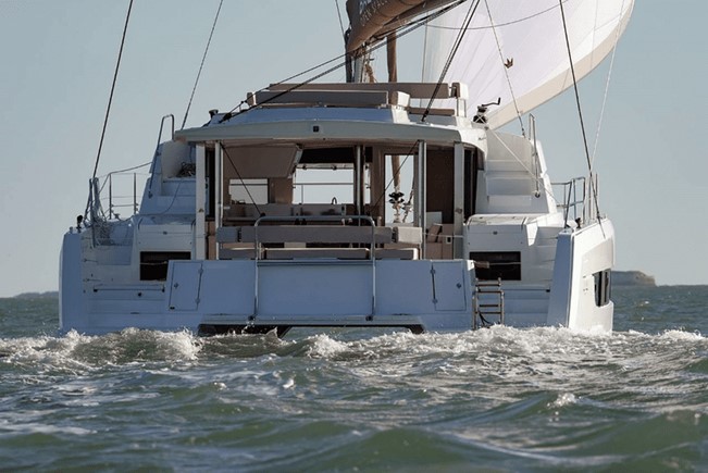

    This about a production cat that has tester using terms like floating motel and floating home. Describes the interior very nicely. The bali 4.4 is an evolution between the Bali 4.2 and 4.6 and was designed about 2020 and manufactured from 2021.

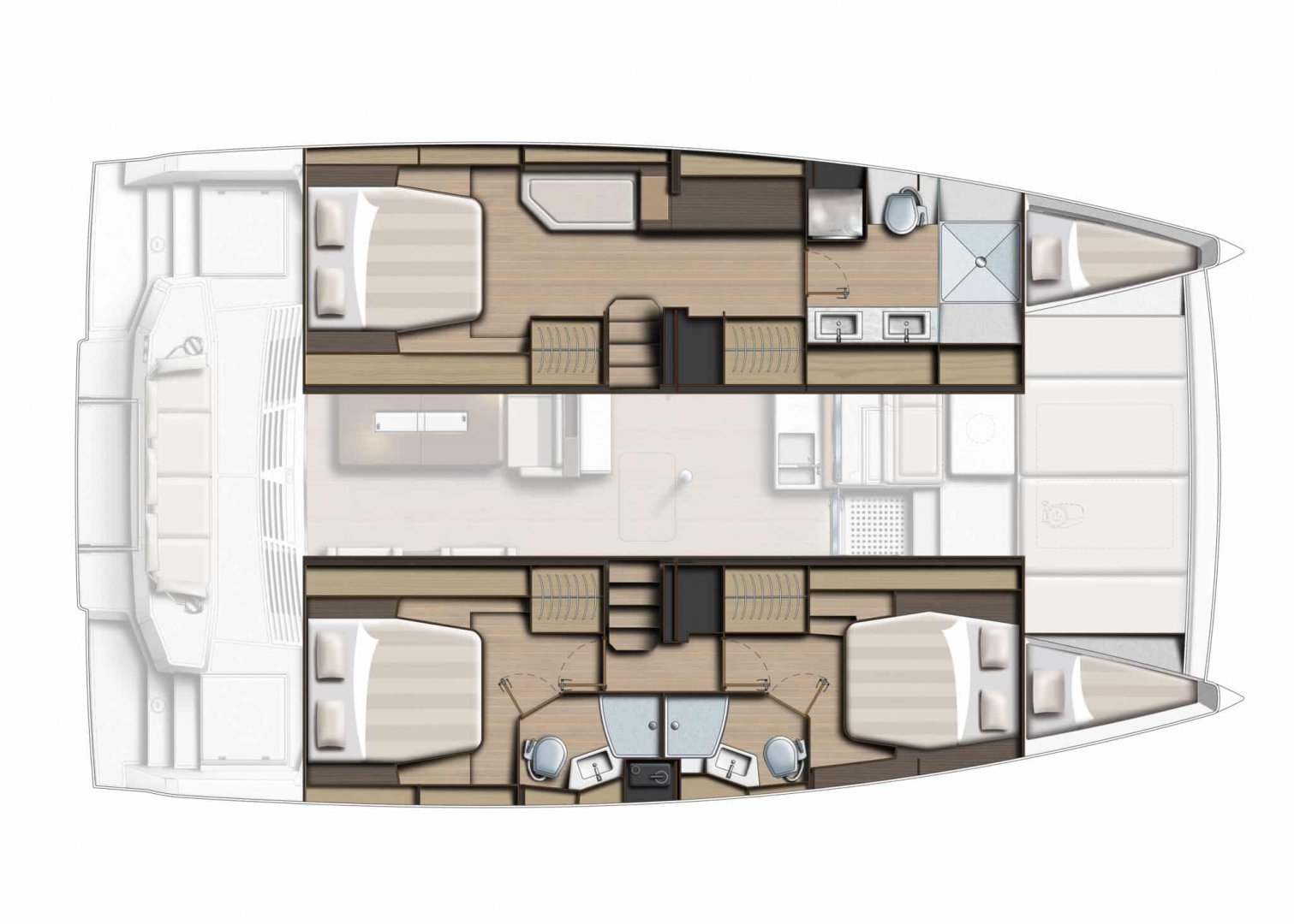

    The Bali 4.4 is 44.25 x 24.25 with a weight of 29,990 lbs and a displacement of 43,210 lbs. The fixed mast carries a 818 square foot mainsail and a 452 square foot self tacking jib. The code 0 is 796 square foot. The draft over the fixed keels is 4.3 foot. The 2 engines are 40hp or 57hp Yanmars.
    The accommodation is a choice of an owners cabin in one hull with 2 double cabins in the other hull or both hulls having 2 double cabins with full ensuites. The main saloon with integrated cockpit is vast with upstairs galley, much seating and entertainment galore. Literally a home away from home.
    The downside is the test reports on performance. It starts like this quote: “Like most Bali models, the 4.4 is designed for boaters who want a platform for enjoying life on the water, a floating home that can be moved from anchorage to anchorage, and even from one ocean to another”. Another line is: “As soon as the mainsail was hoisted and the Code 0 unfurled, we trimmed the traveller and the sheets. With the wind oscillating between 8-15 knots on the beam, our boat speed was 7-8 knots with a few peaks at 9 knots during little gusts……When we came up to 50/55° off the true wind, boat speed barely exceeded 5 knots, leeway was noticeable, and the sail trim needed to be quite precise. In such conditions, not ideal for relying purely on sail, one or two of the engines can be used to help you maintain course.” I am quoting one of the kinder performance reports. This cat will sail and take you places but do not expect high performance of EG an Outremer.
    The construction is mainly foam glass throughout. The fitout and equipment options allow you to upgrade the cat a little to suit your requirements.
    This is a pure cruising charter cat that allows you to have a home on the seas. The jpegs give the idea.

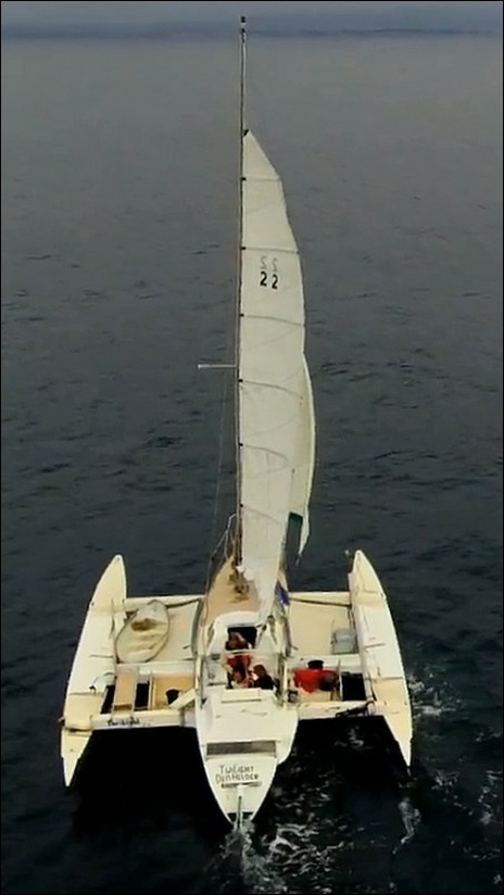

    The following is proof that you can make a cat from anything that has a reasonable hull shape. The Exe dory is a 14 foot rowing dory. Take 2 of them put a few cross beams in and you have a cat. Then put a simple rig on it and go sailing. A fun day boat for a few people.
    The Exe dory is designed by Selway Fisher and is 14 x 3.9 foot with a weight 70 lbs. The waterline length is 11.3 foot and the waterline beam is 2.55 foot. The length to beam is 4.5 to 5.5 to 1 depending on crew loading. The draft is 0.33 foot. The dory is oar powered and can have a fixed seat or a sliding seat. A good little rowing craft.
    The basic structure is 3 sheets of 6 mm plywood and some timber for framing, seats, gunnels and keel line. The “chines” are bog and glass tape. The Exe is a simple dory shape and relatively easy to construct.
    Now if you are enthused you can construct 2 Exe hulls then buy plans for the Docat Supplementary PDF plan and you will get the additional plans to build the cross beams, strengthen the hulls, provide leeboards and a simple rig. The resulting cat is 14 x 10.75 foot with a weight of 200 lbs. The rig has a wooden mast of 10 foot and as gunter rig of 72 square foot. The draft ranges from 0.33 foot to 2.33 foot over the leeboard(s) and rudder. A low power outboard is an option. The cat can be disassembled for transport.
    The cat requires 6 sheets of 6 mm plywood and a lot more timber for the crossbeams, bridge deck, leeboards, mast and rudders.
    No comments about performance but it would be a fun daysailor or a limited range camp cruiser for 2.
    The jpegs give the idea. The Docat is the first jpeg. The remaining jpegs are of the Exe "monohull".

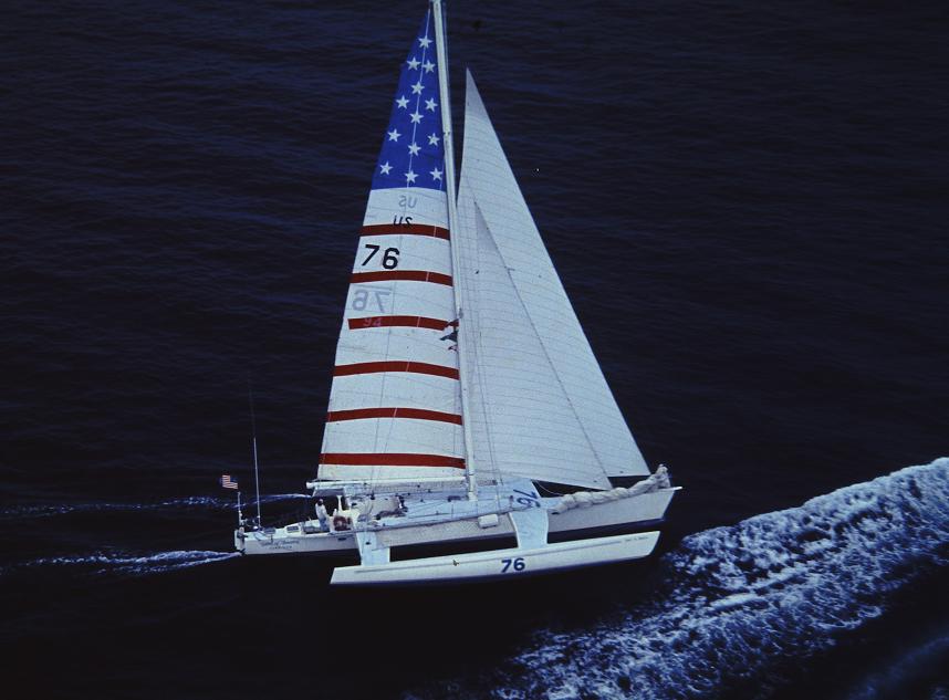

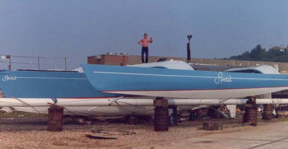

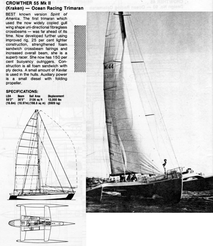

    In 1974 the Lock Crowther designed Kraken 55 was launched from a farm in NSW Australia. It was sailed across the Pacific to Honolulu in 31 days were Mike Kane named it “Spirit of America” (SOA) and went racing. He had at the time had the fastest sailing boat in the world. EG 1975 Round State Race, 240 miles where SOA was 1st in 13 hours at an average 18.5 knots. SOA also entered many other races having some success but also had small development issues which limited its success.
    The Kraken 55 was 55 x 32.5 foot, weighed 12,000 lbs and had a 70 foot aluminium fixed mast that carried a 900 square foot mainsail and a 1060 square foot foretriangle. The number 1 Genoa 1400 square foot. Spinnakers up to 2500 square foot. The draft ranged from 2.5 foot to 7.5 foot over the central hull daggerboard. A 25 HP outboard was the motive power.
    Now Mike Kane raced hard but there were several weaknesses in the Kraken 55 design. Submersible floats was the major weakness and eventually caused the second Kraken 55 built to capsize. The second issue with low buoyancy floats was waves slamming into the cross beam fairings which eventually were damaged on SOA. Next was a single rudder on the main hull which lifted out when the low buoyancy float went under. Third, the rig was on a flexible structure (was not torsionally rigid enough) which meant sails became full at times increasing overturning moment.
    Result, SOA had some modifications done (eg SOA was lengthened to 62 foot with a fuller stern for the 1978 OSTAR) before selling the tri and turning to a Norm Cross design. Eventually Robert Underwood (of Prout fame) found SOA abandoned in France and had it rebuilt after stripping it out, steam cleaning it, having it repainted (blue tri in jpegs) etc. Robert then sold renamed Spirit to Canada who used it for a few years before it was found again tied up in Galveston, Texas since at least 2015.
    Now I mentioned a second Kraken 55 which was built by a farmer in Victoria Australia. It was a “standard dimension” Kraken 55 with an upgraded crossbeam structure. It was done by a home builder who employed 2 other guys. Phil Smiths “Yumi Maru” initial sea trials again highlighted several issues. The rig was pulling the main cabin apart and required a 18 mm stainless steel bolt through the main cabin to limit chain plate and rig movement. The submersible float went under and left no steering control until sheets were released. A steady 26 knots was possible prior to the float going under after which you slowed to 18 knots with little control. In Yumi Maru’s first serious ocean race a spinnaker pole guy was released, not a spinnaker sheet, resulting in a capsize. The tri was recovered and a Karken Mk 2 design was released and applied to Yumi Maru. Result was 55 x 36.5 foot, weight of 13,000 lbs and a slightly enlarged rig. The floats were 160% buoyancy, non submersible and had a longer water line with the buoyancy pushed further forward. The forward cross arm was strengthened and most of the structure lightened. A new build would also have had a lighter main hull. Yumi Maru sailed to Japan and back, did some local racing before being sold into charter work in Guam with solid decks instead of the nets and tourist seats.
    The structure of both builds in Australia were polyester on Airex foam core using unidirectionals, E and S glass cloths with limited woven rovings. The decks were plywood. The cross arms were a box section with unidirectionals at each corner of the box and top and bottom unidirectional flanges.
    For its time the Kraken 55 was a very fast tri and helped set a theme for future ocean racing boats.

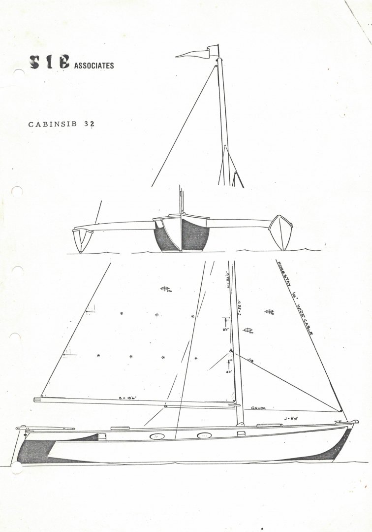

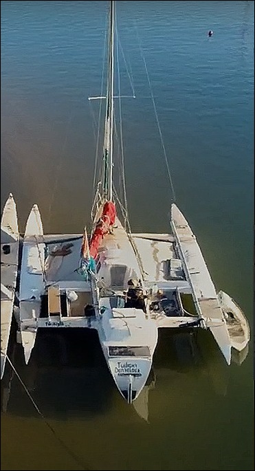

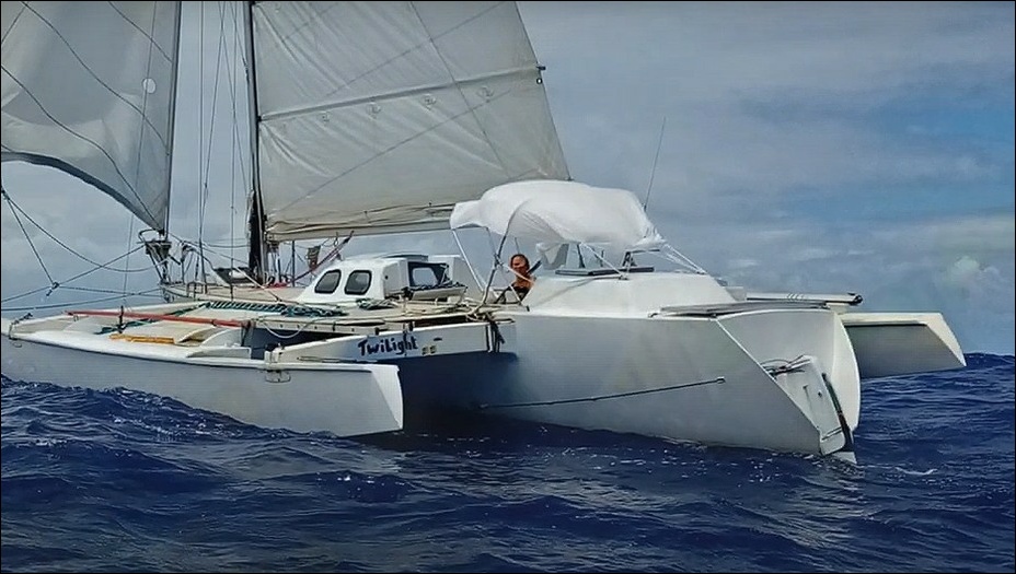

    A home builder decided to extend a USA built flush deck Cabin Sib constant camber 32 footer to a 39.6 foot Cabin Sib. How? Saw the tri in half at its fattest point insert a 6 foot section in the main hull and do a similar action on the floats and add an additional rear crossbeam.
    The original Cabin Sib 32 foot design by John Marples is 32 x 24.4 foot with a weight of 3,200 lbs and a displacement 4,200 lbs. The 40 foot fixed aluminium mast carries a 526 square foot main and foretriangle. The maximum sail area suggested is 613 square foot. The draft when the centreboard is down is 5.4 foot. The suggested outboard power is 10 HP that produced about 6.5 knots.
    The structure is constant camber panels of 3 layers of 3 mm WRC or ply with 9 m plywood bulkheads and 9 mm ply decks. The wood box beams are 200 mm deep and 210 mm wide. Where crossbeam go through the main hull there are doublers that build the hull thickness up to 27 mm. This would be a relatively fast boat to build but it has one down side, accommodation.
    I suspect this is part of the reason the original 32 foot to be extended to 39.6 foot and had a small cabin roof added to the flush deck. The 24.5 foot beam of the tri was not increased nor was the basic hull shape so the displacement would be about 5,300 lbs. The original rig was maintained and left in its original position but chain plates were made composite and moved aft. An additional rear cross beam was added. Also, a wind driven self steering system was added.
    The additional hull structure grafted in could have been constant camber panels or eg 2 layers of 4.8 ply panels curved to shape. The decks could be again 9 mm ply. Mr Marples designs strong boats so the structure could handle the 1,100 lbs displacement increase, especially if the rig was not significantly increased.
    The tri in the 32 foot and 39.6 foot formats crossed the Atlantic under sail so the boat is very sea capable. The lengthened hulls were claimed to improve windward performance with the same rig.
    The interior of this tri is basic with a main hull width of 4.45 foot and a small area of 6 foot headroom. Result a toilet forward, a double bunk then the main cabin with a very basic galley on one side and a seat on the other side. The cockpit is next with an additional aft cabin added. The interior is improved but this is still a fairly basic (but very sea capable) 2 person long distance cruising tri.
    The jpegs give the idea. The first jpeg is a flush deck Cab Sib 32. The following drawings are of the original Cab Sib 32 design. The following jpegs are of “Twilight” sailing, interior and rebuild jpeg.

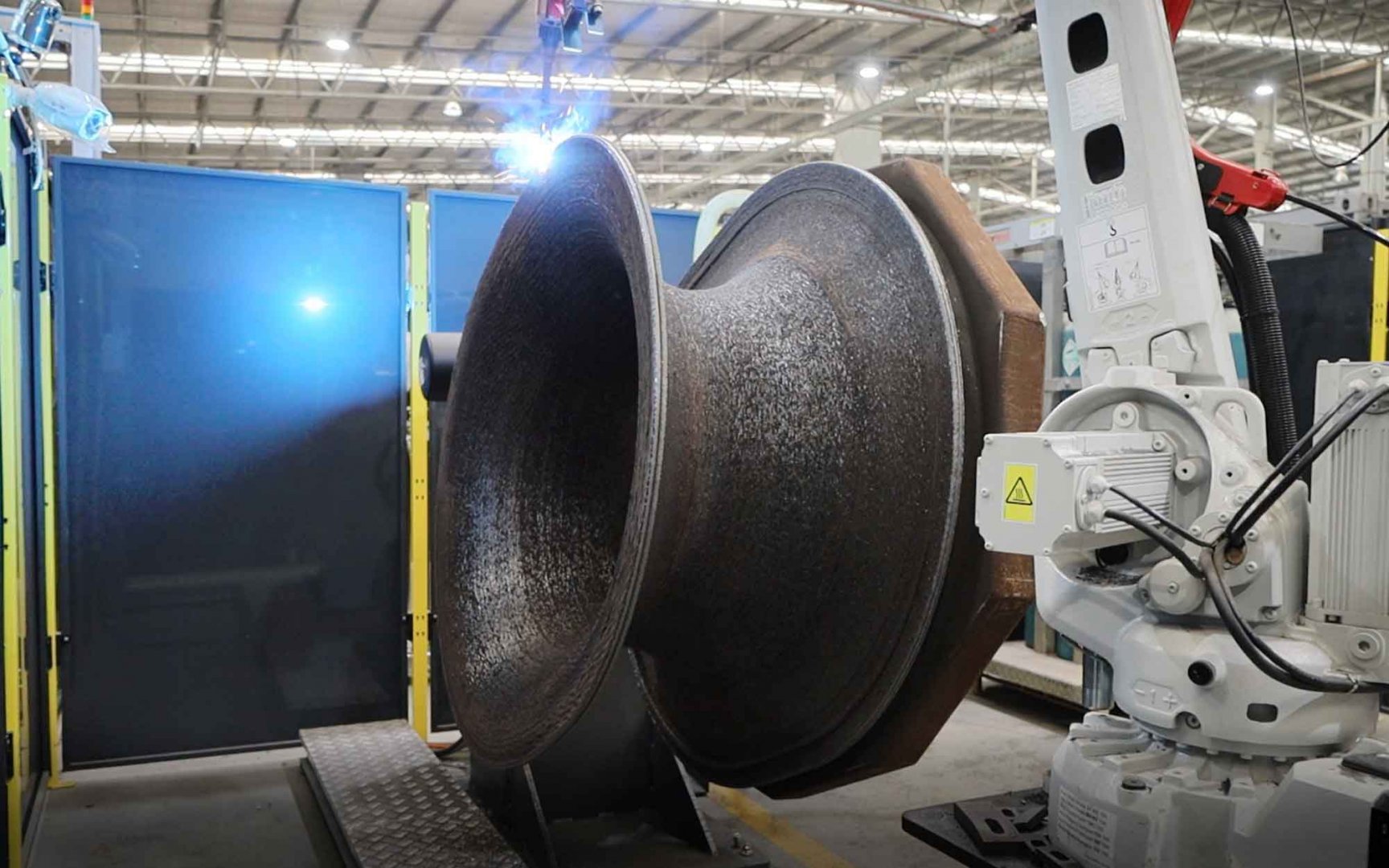

    An Australian company called AML3D is providing equipment, software and feed stock for 3D printing of metal parts. They also manufacture parts as required. #D printing of metal parts is not new but this company has an innovative lead in the business. The companies products from one manufacturing 3D print can produce items in aluminium, titanium, copper alloy’s, nickel alloys, steel and stainless steel using appropriate feed stock.
    The other significant advance is that the metal heating and laying down of layers of metal is handled at the nozzle used for laying up the materials. Result the 3D printer can be compact and light compared to a 3D printer that requires a heated enclosure. In simple terms you are MIG (TIG etc) welding each layer to the underlying layer.
    The US Navy was so impressed that in May 2024 it sought funding to have 1 of these 3D Metal actively integrating additive manufacturing (3D printers) on each aircraft carrier to produce metal parts to minimise down time on ship systems. The parts that can be manufactured can be large, we are talking feet long and 2000 lbs of weight.
    The interest here is the same technology could be used to manufacture difficult hull shapes in aluminium, steel or titanium. Yes, it would take time but robots work 24 hours per day and are capable of printing a frame structure as well as a shell at the same time.
    I will quote from AML3D information: “WAM® revolutionises the production of medium to large-scale and exotic material parts by combining an electric arc with certified welding wire feedstock in a free-form manufacturing environment.
    AML3D's patented Wire Additive Manufacturing (WAM®) process fits into the Direct Energy Deposition (DED) category, specifically DED-arc. Unlike many other metal additive manufacturing methods, WAM® enables the printing of metal parts in an open free-form fabrication environment using localised inert gas and certified wire feedstock. This localised gas shielding eliminates the need for an enclosed chamber, unlocking the potential for larger component build sizes. The certified wire feedstock is melted by an electric arc, and the molten metal is deposited onto a substrate, layer by layer to create a three-dimensional part.”
    Technology is advancing quickly and combined with designers using CAD/CAM we may find boats being manufactured faster and more accurately.
    The jpegs give a hint but look at the website if you want more detail: ARCEMY® | Wire-arc Additive Manufacturing Solutions https://aml3d.com/arcemy
