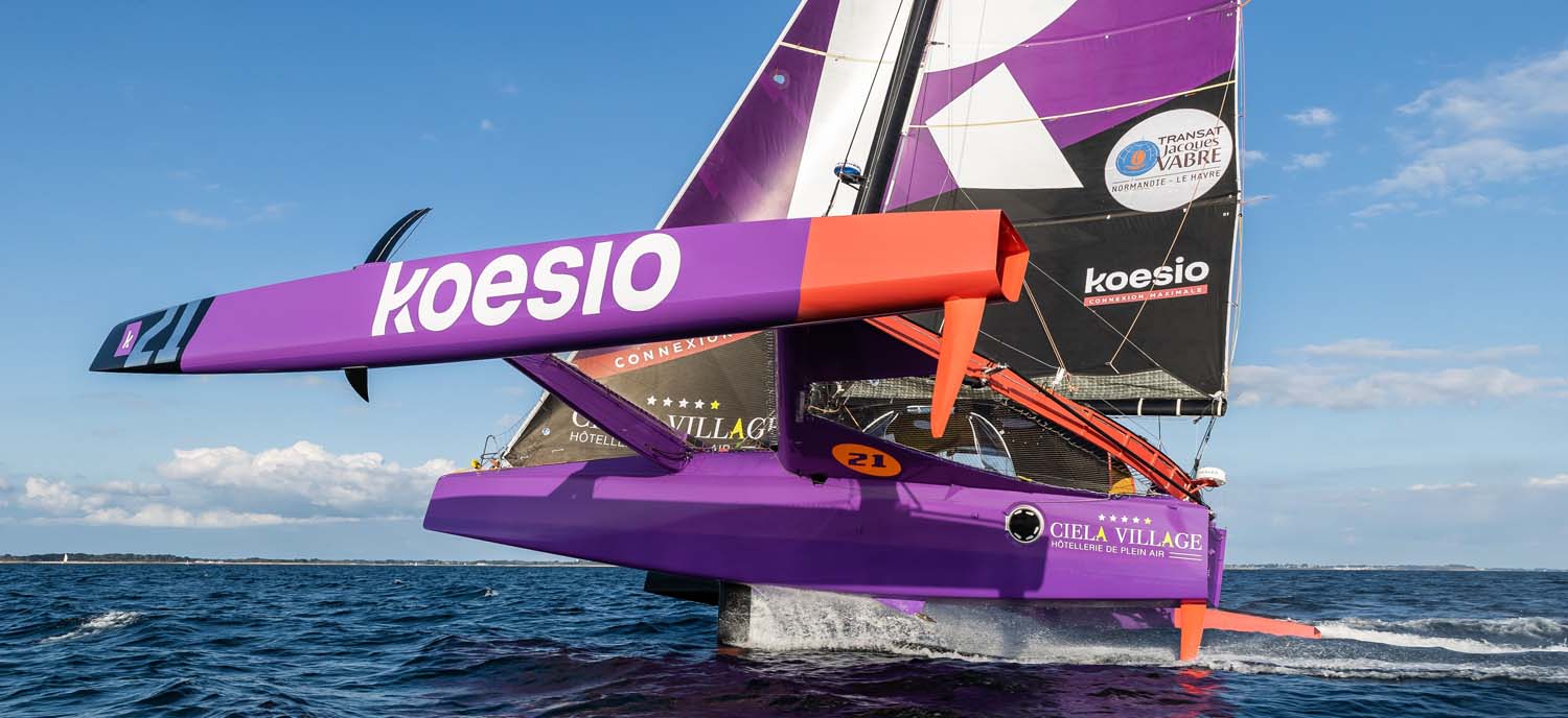

    I always said 50 foot multis can fly, I never thought they flew this high thought (look at the jpegs). It was a far from simple operation: 50 x 50 foot, and 5,500 lbs had to be transported from Nembro, (Italy) to Marina di Carrara, south-east of La Spezia. 93 mi (150 km) and one mountain range to cross. The flight time was around three hours. A long flight time* which, when added to the need to climb to altitude, required Heliswiss International to refuel their AS 332 Super Puma helicopter during the trip.
    The tri is a pure racing machine for the Ocean 50 class which has a series of fairly strict rules to reduce costs. The rules include glass fibre is required for the build, except for the crossbeams, mast, rudders and foils, which can be made of carbon fibre. The class implements other measures, EG you are only allowed to change sails every two seasons and the foils are one-design.
    This tri was built in 2020 and was named Planet Warriors then Ciela Village then Koesio and has sailed in many races including winning the 2022 Route du Rhum in the livery of Koesio. The length and beam of 50 x 50 foot with a weight of 7200 lbs. The draft of both over the central daggerboard and float based C foils is 11.5 foot. The 2020 design has a 67 foot rotating carbon wing mast with an upwind sail area of 1,904 square foot and a downwind sail are of 2,850 square foot. The power to weight of these single-handed racing tris is amazing. And before you ask these tris can average 20 knots and peak at over 30 knots.
    VPLP studied many configurations with the aim of optimizing weight. Weight-saving efforts also included the static parts of the boat, such as the fittings, the engine, the lines, the pipework and the wiring. As a result, Ciela Village is the lightest boat in the Ocean Fifty fleet. Next came the hull shapes, VPLP drew on feedback relating to foiling behaviour from the two previous Ocean Fifties designed by the firm (Solidaires en Peloton-ARSEP and Ciela Village, now Leyton), thus turning the research significantly towards enhancing performance. In practical terms, a lot of work was done on the longitudinal centres of volume, moving them aft to stop the boat from porpoising too much because of the lack of foiling surfaces in the stern.
    Another innovation involved the K-shaped set-up of the beams, with the after beam extending to the foot of the mast. This freed up space so the cockpit could be twice as long and entirely shielded with plenty of room under the canopy. This has been a huge improvement for the skipper’s protection out on the ocean, but also for the Grands Prix because weight could be centred, the winches and other gear having been moved forward. “As a result, the crew are further forward, giving the boat a better trim overall,” said VPLP.
    A comment from the Route Du Rum Ocean 50 skippers “The skippers talked about it at the finishing line. It’s obvious that, given the level of commitment and the intense pace, particularly in the first week, those who were better protected from the elements were able to maintain higher average speeds.
    A lot of work was also done on her aerodynamics with a view to reducing as much as possible air resistance, a factor that is becoming increasingly problematic for these boats which are sailing faster than ever.
    The jpegs give the idea of an interesting trimaran.

    Holy smokes, the transport probably cost as much as the boat !
