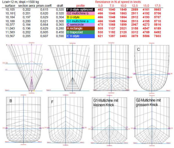

    Othmar did an investigation into what hull cross sections and shapes would have the least resistance across a speed range. The first jpeg gives the results. It interesting that Othmar then choose a hull shape of a shallow v which he didn’t show the results for. The next jpeg shows the drawings for the P 12. Othmar choose a simple multichine section for following reasons
    * easy to build in composite (or plywood)
    * safety when grounding
    * stiffness in longitudinal direction.
    An interesting design and good information on hull shapes. Be warned, these numbers are a guide not definitive. Each design sometimes use higher resistance hulls to improve seakeeping or EG load carrying. The jpegs give the idea.

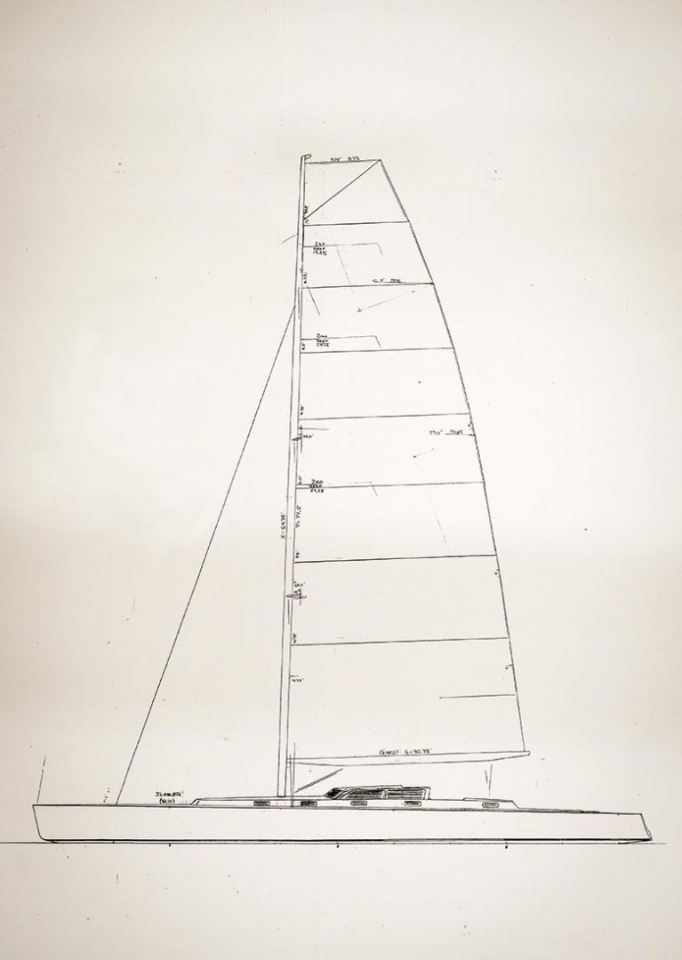

    The following is a few additions to the P 12 and hull resistance items. The proa P 12 “Mareinoa” was test sailed by the builder and Othmar in 2014 with the following results. The proa’a shunting works very well in under 10 knot winds conditions. It needs less than a minute for 2 people to roll in the foresail, change the rudders, move the main to the other side, and unfurl the new foresail.
    “Wind conditions were 2-3 Bft, and some little gusts. Main surprise the yacht sails always barely slower than the measured apparent wind on board. That means at last we sail faster as the true wind. Some measurements:
    Apparent wind ~ 5-6 knots - boat speed ~ 5 knots
    Apparent wind ~ 8-9 knots - boat speed ~ 7,5 knots
    During maximum speed the ama was barely lifted. The boat was always perfectly balanced, and need no rudder action. Although we sailed without daggerboard, the leeway was low as we saw at the lane behind the boat.”
    The first jpeg is of the rig of “Mareinoa” which had a weakness in gusts. The top of the masts flexed too much. Additional stiffening was done.

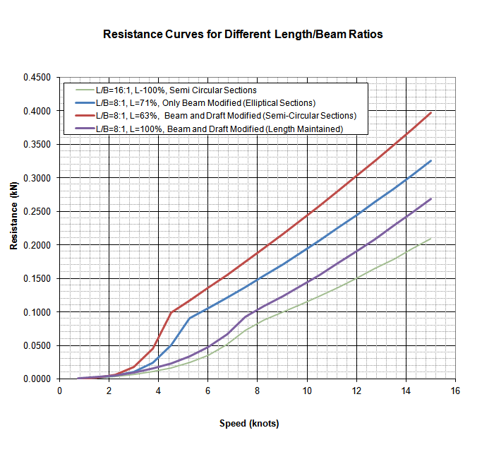

    Next on hull resistance. Malcom Smith is a Naval Architect with an interest in proa’s who calculated some resistance of hulls at various length to beams for comparison. To quote Malcom “In my opinion there aren’t many general rules for hull design. Each design needs to be considered individually based on the specific requirements of the intended purpose.”
    As an example he compared a 16.3 foot hull with 265 lbs displacement. The first hull had a length to beam of 16 to 1 with a round bottom (gray line, lowest resistance). Next was an 8 to 1 hull with an elliptical bottom and an 11.6 foot waterline length (blue line, second highest resistance). Next was an 8 to 1 with semi circular section and a waterline length of 10.3 foot (red line, with highest resistance). Finally, was an 8 to 1 hull with a modified draft and a full 16.3 foot waterline (purple line second lowest resistance).
    Translation of the above. The displacement was fixed so the waterline length varied according to hull shape. The result was waterline length is very important, the hull shape was of less importance. The shortest waterline 8 to 1 hull with the “best” semicircular cross section had twice the resistance of the 16 to 1 hull. The longest waterline 8 to 1 with a simple hull shape only had a 25% increase in resistance compared to a 16 to 1 hull.
    In short, length to beam has less effect than waterline length in this comparison. If you can have a good hull cross section shape with a reasonable waterline length and displacement you should get a low resistance. The second jpeg give the idea.

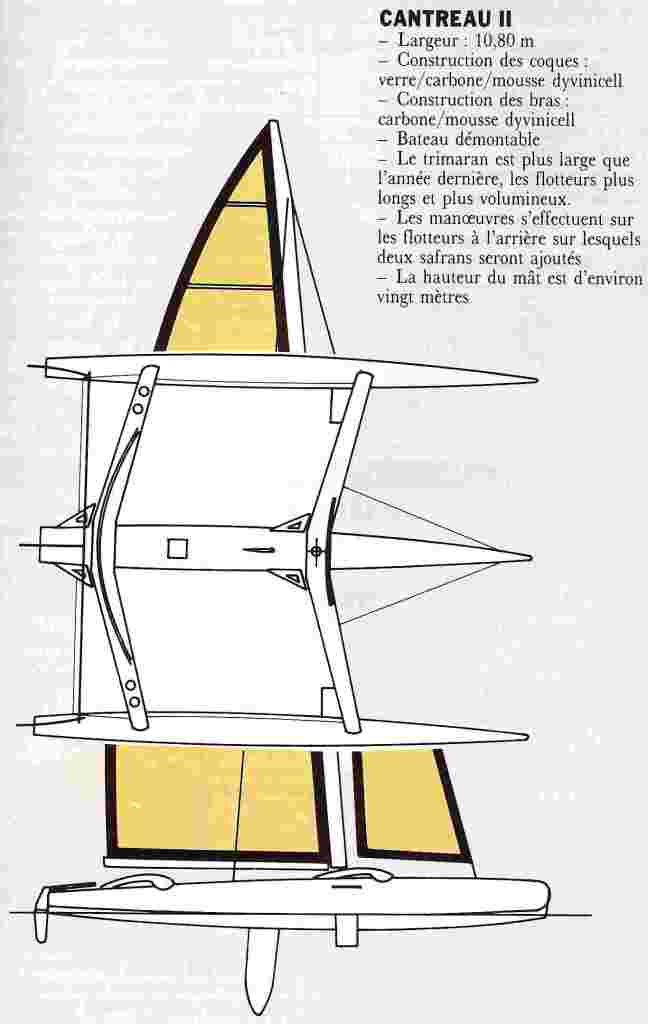

    The Formula 40s multihulls were an interesting time in multihulls. They started as mainly catamarans and had to conform with a few simple rules like 40 foot long maximum, a minimum weight of 4000 lbs and a maximum sail area of 900 square foot (?).
    In 1986 the majority of the fleet were catamarans, VPLP started to design a trimaran with a blank sheet of paper. The challenge was a minimum weight trimaran which sailed like a catamaran, flying a hull. That was something new at the time as most trimarans sailed on the main hull, with floats to balance the boat for transverse stability. VPLP had the crew on the windward float, three rudders, and aimed to sail flying a hull. Biscuits Cantreau 2 was faster and beat the catamaran fleet.
    Biscuits Cantreau 2 started as 40 x 34 foot over the hulls with sliding hiking racks for an overall beam of 40 foot. the weight was aimed at 4,000 lbs (1.8 tons) but the tri ended up weighing 5,150 lbs. The original aluminium wing mast was 67.8 foot high but was replaced by a 67 foot carbon wing mast of 500 mm chord. The length to beam on the main hull is 12 to 1, the length to beam on the floats is 15 to 1. The draft is 9 foot over the central hull daggerboard. Later angled boards were added to the floats. The tri had 3 rudders on the sterns of the hulls for 1987. When the tri needed power it used a 25 HP outboard.
    This started as a race boat without accommodation. Later 3 berths were installed and camp gear for the rest. This tri is still a racer.
    The build was built by Jean LeCam in carbon for his own use at JMV in 1987. The materials were carbon fibre either side of klegecell in epoxy with some uni-s glass in the structure. This would not have been a cheap build in 1987. The early 2000’s upgraded Nigel Irens designed mast, boom and bow spirit were autoclaved prepreg carbon. The boom has internal hydraulic ram for adjustment.
    This tri was the forerunner of most of the developments in things like OMRA 60 tris which provided the groundwork for the modern Ultims. PS Biscuits Cantreau 2 was a very successful racing tri that is still racing today in both the US and Thailand. Its peak speed according to the designer was 28 knots, according to the last owner 38 knots. Lets just call it fast.
