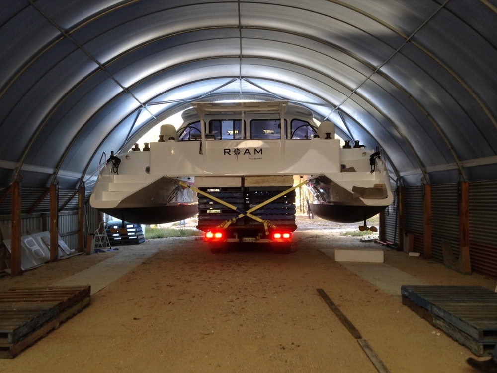

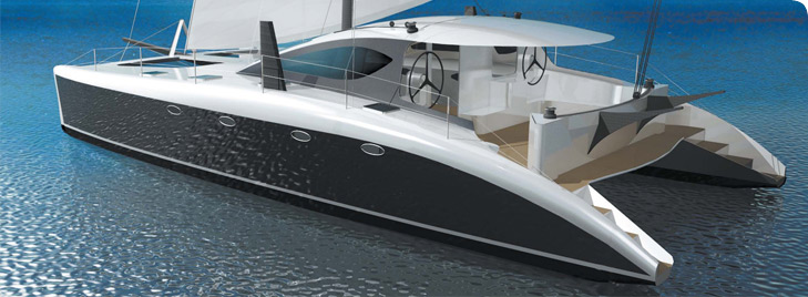

    “Roam” is a Spirited 480 design by Craig Schoinning. This cat is a serious bridge deck performance cruising catamaran that is basically a kit boat for home building or as a starer kit for a professional builder. The Spirited 480 is 48 x 24.8 foot with a “displacement” (read weight) of 18,000 lbs depending on material choice. The payload can be up to 4850 lbs. The 61 foot mast carries 1442 square foot of sail area. The hull length to beam is 14 to 1. The minimum draft is 1.8 foot and has daggerboards that draw over 6 foot. The engine power is 2 x 40hp Lombardini with Sail Drives. Speed under power is 8.5 knots at cruise with peak speed of 10.8 knots.
    The Spirited 480 is a serious offshore design with long slim hulls provide easily-driven comfortable performance. The rig size on this design is moderate and is therefore more manageable for the crew. The cockpit is large with large doors and windows to the main cabin creating a flow-through affect. Inside the saloon cabin there is ample space for the galley and saloon seating. The galley is set against the aft bulkhead with generous bench and locker space. Opposite this is the spacious seating area which keeps the galley centrally positioned between the saloon and the cockpit areas. The two forward cabins can be set-up with fore and aft queen sized bunks or athwartships island bunks. The island bunks are popular because they have access steps each side and also a flat section each side of the bed for a book or cup of tea. The options leading forward off these cabins can be either an ensuite, a walk-in-robe or a separate shower. On the standard layout there is a private double cabin aft starboard and opposite a large sized head with separate shower.
    The build of this design varies according to the owners wants. The kit options include DuFlex Balsa/Foam or Plain Foam with e-glass and vinylester. Carbon is used in bulkhead flanges etc. Some WRC is used in forebeams etc. The kit panels arrive as flat panels and are cut out as required. The hull bottoms arrive as resin infused moulded sections to provide a round bottom cat.
    The interest in this design came from the following web site: the VESSEL — Sail Surf ROAM http://sailsurfroam.com/thevessel
    This cat took 6 years and 7 months to build versus the “estimated” build time of 5000 hours (about 2 years full time), but it is a fully complete build.
    An interesting cat that if you have a spare $500,000 and a few years to build, could be yours. The jpegs tell part of the story.

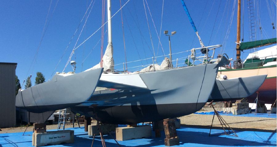

    The TCR 45 cruising trimaran was built by Southwest Multihull Construction in Cornwall, UK and designed by Edward Phillips in 1974. The tri is 48 x 30 foot and weighs 14,000 lbs. The 50 foot fixed aluminium speaderless mast carries 1,012 square foot of sail in the cutter rig with a main, self tacking inner jib and outer roller furling genoa. The main hull has a length to beam of 9 to 1. The draft over the skeg rudder and fixed fin keels on the floats is approximately 3 foot. Her diesel is old school, a Norwegian SABB of 18 horsepower that burns 1/3 of a gallon per hour at 5 knots. Peak speed is 7 knots. This engine is heavy but will last 100 years if well maintained.
    The accommodation sleeps 6 in three cabins. 2 in the sterncastle with 2 amidships and 2 in the forward stateroom. The main saloon has a large galley and seating area with an internal helming seat. The toilet is in the aft cabin and the shower is in the bow. The internal fitout is simple, but very practical.
    The structure is all Airex foam core and e-glass unidirectional fiberglass construction probably done in polyester resin. No wood used. The cross beams are box sections with unidirectional glass. The floats are fully foam filled with unidirectional fiberglass skins.
    The performance of the tri is impressive for its design time. This is the “claimed” actual performance data: 11 knots in 11 knots of true wind. 16 knots to windward in 20 knots of true wind. 20 knots off the wind in gale conditions under staysail alone. Canary Islands to Barbados in 19 days. Victoria, BC to Hawaii in 17 days. Cabo San Lucas, Mexico to Victoria, British Columbia in 20 days. This indicates a fast “cruising” boat that sails very well with a limited rig for its size. The rigs size is OK for the tri’s light weight.
    An interesting design that was ahead of its time when built in 1974 (yes, this tri is nearly 50 years old). The jpegs give the idea.

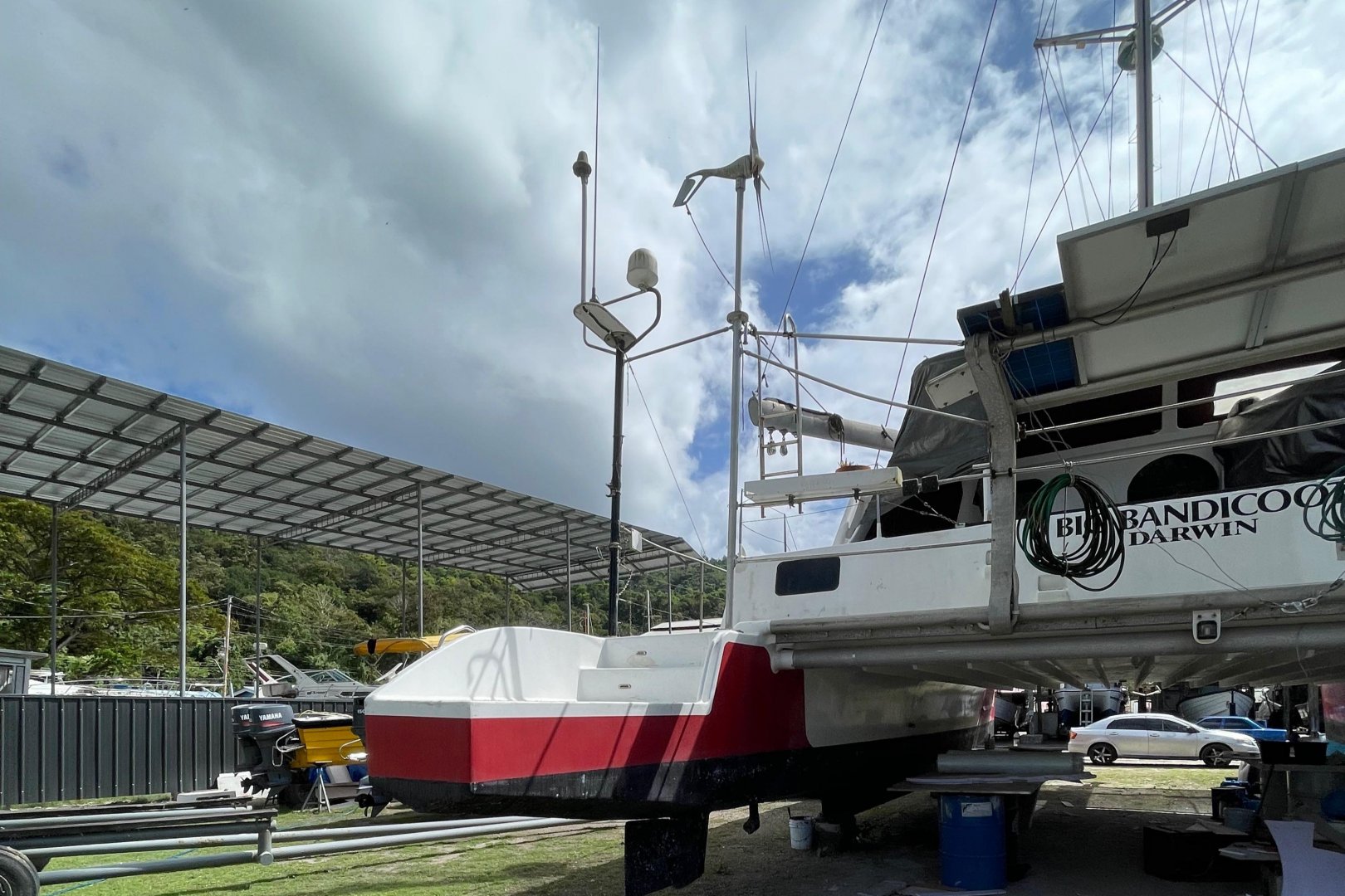

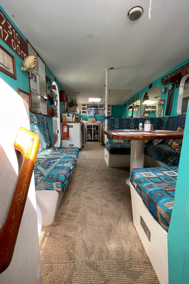

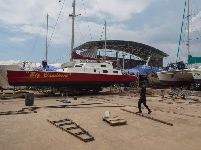

    Part 2 of “Big Bandicoot”. After its failure to become the fastest sailing boat in the world, it was sold to a couple of guys who sailed it for a few years before it was sold to another person who pulled it ashore beside his house to modify it with a bridge deck cabin. Big Bandicoot beam was reduced to 29.5 foot so the cat was now 55 x 29.5 foot. The weight would have increased to at least 11,000 lbs. No mention of the new rig dimensions but the mast would have been replaced by a stronger and probably shorter mast. The sails would probably have been strong enough but cut down in size. The daggerboards were replaced by fixed low aspect ratio keels. There were 2 diesels inboards installed.
    The cat was then sailed from Australia to Malaysia. The next owner then refitted Big Bandicoot and sailed from Malaysia to the Caribbean via Turkey. She was extended from 55 to 60 foot by an extension to the stern and currently sits in the Caribbean.
    The accommodation is 2 double berth cabins forward with toilets, a full width seating cabin then a saloon cabin with seating and galley. There are additional berths in the hulls.
    The boat had the main crossbeam replaced by plywood bulkheads with some of the aluminium from the old main cross beams used to reinforce the beams. The underwing and cabin structure again appears to be plywood. But another change is of interest, the plywood bottom from the water line down is kledgecell foam epoxy sheathed covered with Kevlar and 600 gsm e-glass. The bottom of the fin keels is covered with 3 layers of Kevlar and 4 layers of 600 gsm e-glass. I cannot comment on performance beyond it is seaworthy and has crossed oceans even though it had “lightweight” racing hull structures.
    The jpegs will give the idea of the cats interesting history, that shows you can build in 6 mm plywood if you have a good framing structure that is well built. This cat is over 40 years old and still floating but the advertisement says “The vessel does need some work and this is reflected in the low asking price”.

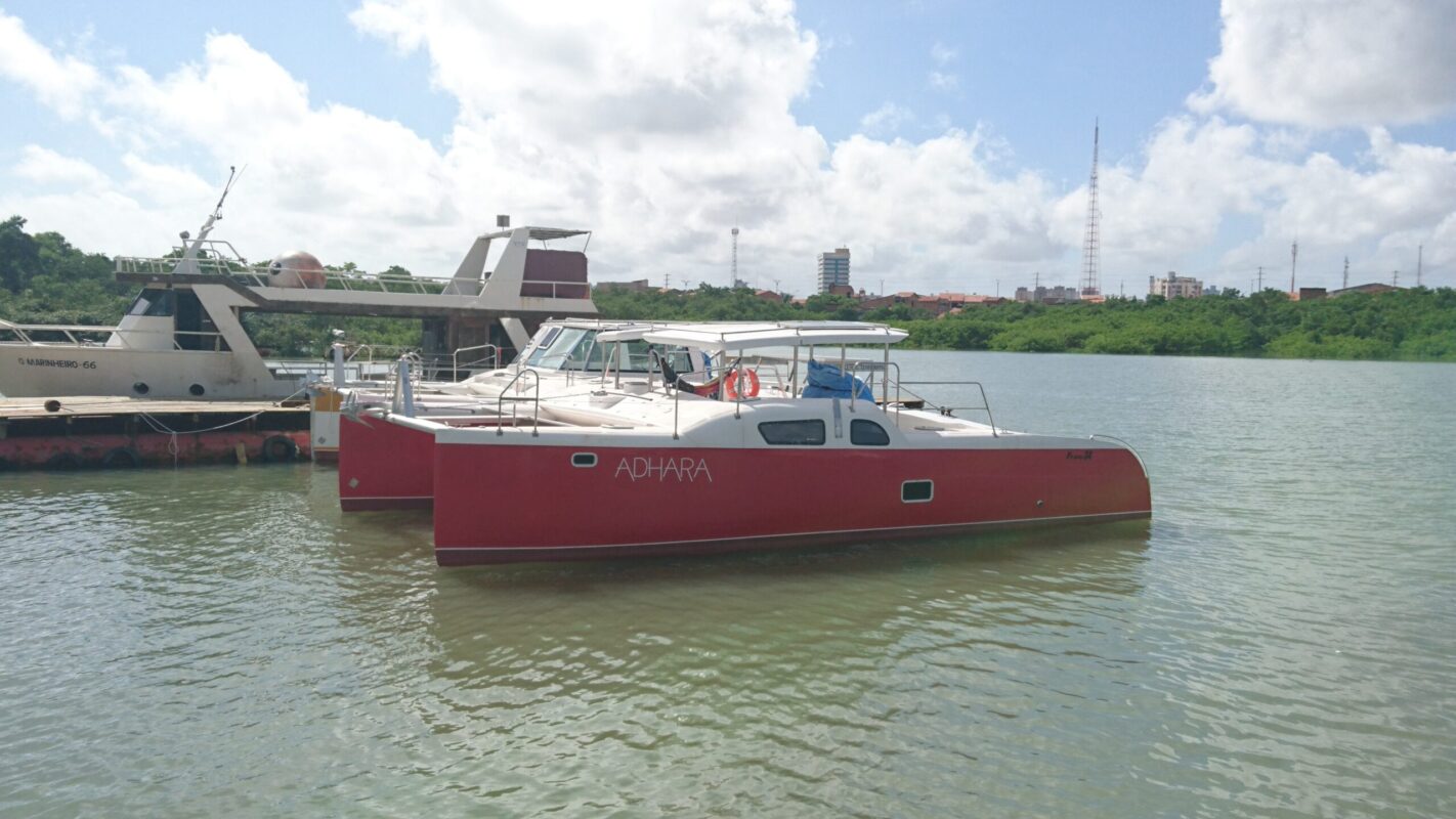

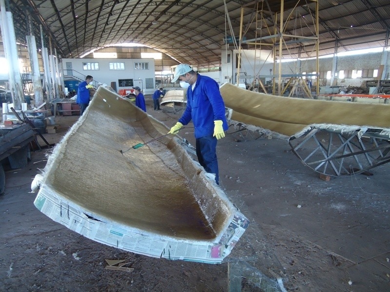

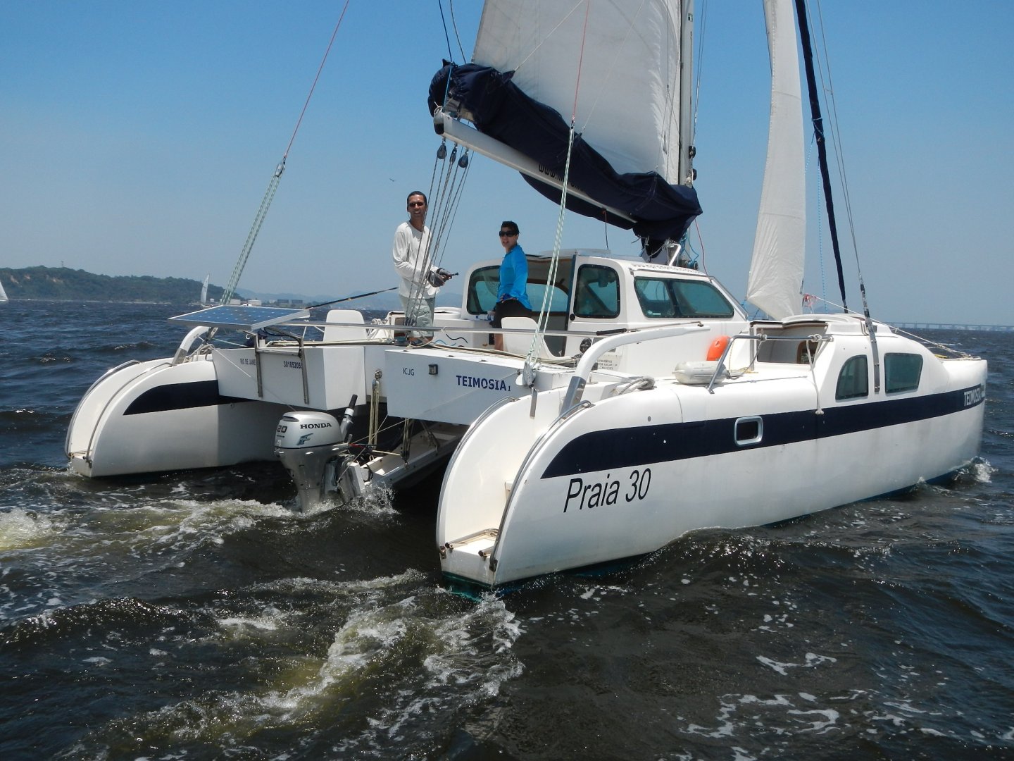

    This is how a basic open bridge deck cat morphs over time into a full bridge deck cabin cruiser. The Praia started out as a 30.2 x 18.3 foot open bridge deck cat with a weight of 3400 lbs. The fixed aluminium mast 7/8 rig carries a 435 square foot mainsail, a 333 square foot genoa and a 630 square foot Code 0. The draft is 2.3 foot over the fixed low aspect ratio keel. The engine was a 10 to 15 HP outboard engine.
    The standard cat could move at 12 knots in 18 knots of wind. In short, a solid cruiser that could sail well.
    Next came a guy who wanted to change careers and decided to become a charter boat owner/operator. He went to Praia and wanted a slightly longer cat for charter work. He helped build the boat as the company was heading for bankruptcy. Result the Praia 34. The Praia 30 had the hulls extended to 34 foot to increase displacement and a solid hard top was built over the open cockpit area. The hard top had roll down vinyl side curtains for rainy days etc. Also 2 sterndrive Yanmar engines were installed instead of a central outboard. It also has new entrances and higher headroom on the hulls, extended stern, larger and open center cabin, double berths on the stern.
    ADHARA (the 34 foot charter cat) has proven to be a success commercially and can sail reasonably well on all points of sail. This inspired some others to ask the boat production company to do a “cruising” version of the Praia. The Praia 34 cruiser was born. This is a full bridge deck cabin 34 foot catamaran with the same beam as the 30 foot version but an increased weight and displacement.
    The accommodation has 2 bouble berths aft, a main saloon that can contain the galley and seating/table. The cockpit is large for a cat of this size.
    Construction is foam glass for above the hulls. The hulls appear to be e-glass with a coremat core.
    An interesting development. The first jpeg is the 30 foot, then ADHARA build and cat and finally the cruising 34 footer

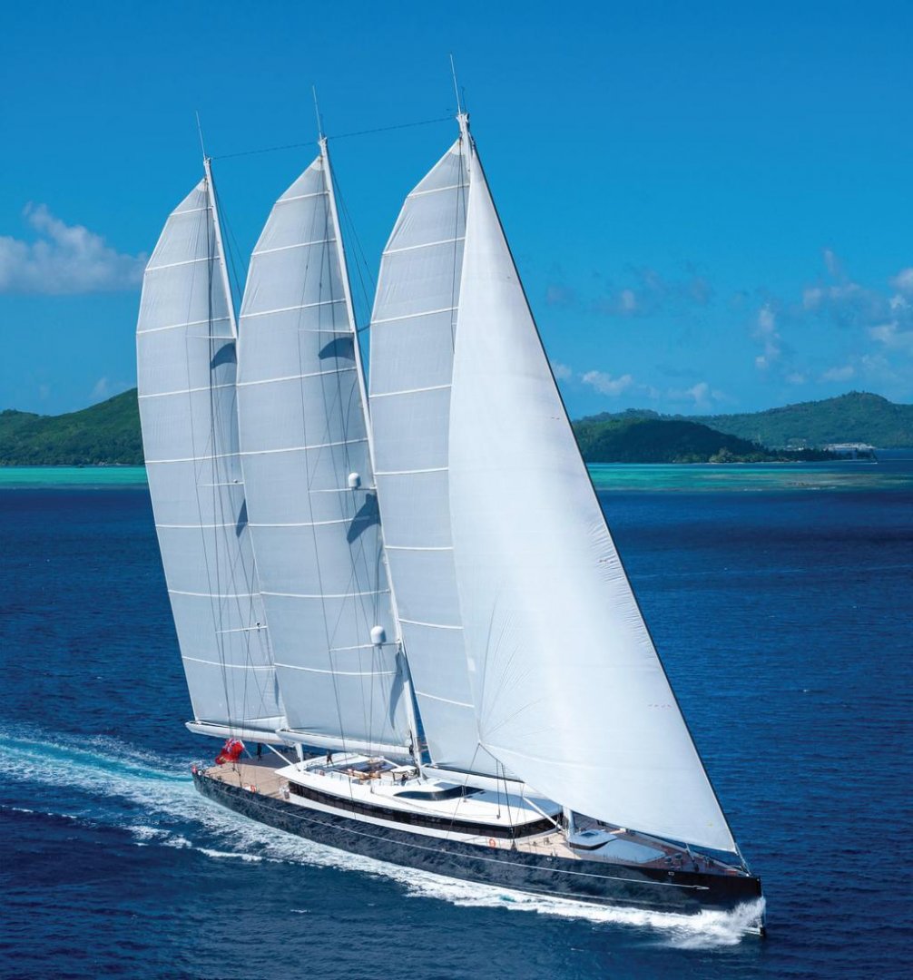

    You don’t need to know how much this boat is worth, its value to us is teaching us about the outer limits of structural design. Sea Eagle 11 is a serious cruising monohull designed Dykstra Naval Architects + Mark Whiteley Design and built by Royal Huisman. It has circumnavigated and done 45,000 miles since its launch in 2020. The monohull is 266 x 40 foot (yes you read it correctly) with a displacement that was kept down to 1,050 tonnes at full load. The 3 x 185 foot carbon fibre masts with carbon rigging, in a schooner rig, that can carry 27,700 square foot upwind and 38,233 square foot down wind. To manage this canvas, 34 winches can all be pushbutton controlled from the helm stations. The blade jib and Yankee’s require much higher sheet loads to maintain leech tension. The sheet loads are still predicted to reach 18 tonnes – but this still allows standard-size captive winches to be used, rather than larger custom-made units. The draft is 20 foot. Sea Eagle has 2 x 1450 HP engines with 2 x 160 HP generators.
    To address the issue of performance I will quote: “In a good breeze, beam reaching, with reefed sails, Sea Eagle II does 20 knots comfortably without pushing it,” designer Erik Wassen reports. And from the commissioning skipper “We comfortably recorded 22 knots in moderate wind conditions. In fact, at 16-18 knots boat speed, I found myself regularly checking the B&G speed displays for confirmation because the motion is so relaxed. Sailing fast with just a gentle heel [typically max 10-15°], she feels very safe.” The theoretical hull speed 22 knots.
    Next accommodation. The main accommodation is for 12 guests, while forward of the foremast is a separate low profile entrance for the 14 crew to reach their quarters. The stowage space for toys is formidable, complete with cranes to launch all with minimal fuss. All I can say is the space is vast in each area with deck space to match.
    Now we get to the aluminium hull construction. The owner wanted a fast light build for his cruising. Royal Huisman did extensive FEA analysis on supercomputers of the structure and reduced the hull structural weight by 11%. Also, the design team Royal Huisman found a construction challenge lay with how to mount such a long, rigid deckhouse structure, which comprises so much laminated glass (windows), onto a more flexible aluminium hull. “When we were doing the FEM [finite element method] analysis, we noticed that the glass mullions would be picking up a lot of the load,” Wassen explains: “the deck is participating in the overall structure and a boat with this beam will deflect and bend in waves.” As glass won’t flex, the build team needed to include some tolerance between the roof and mullions. Aerospace specialists developed an adhesive specially for this project, using it to bond the forward section of the deckhouse to create 2cm of flex. A steel rudder would have weighed 6600 lbs so Royal Huisman’s sister company Rondal, produced the biggest ever carbon rudder, weighing only 2800 lbs, which helps to keep weight out of the ends of the boat
    Royal Huisman are in the planning stages of bigger builds and are finding they may have to build in steel as aluminum is not strong enough for 100 meter (320 foot) plus builds. Quote “We looked at 100 meter as the ultimate size. Above that you might need to go to steel, as aluminum is not strong enough.”
    Are who thought that aluminum would not be strong enough for a large mono. Don’t tell the large passenger ferry builders, they may get worried. The jpegs give the idea.

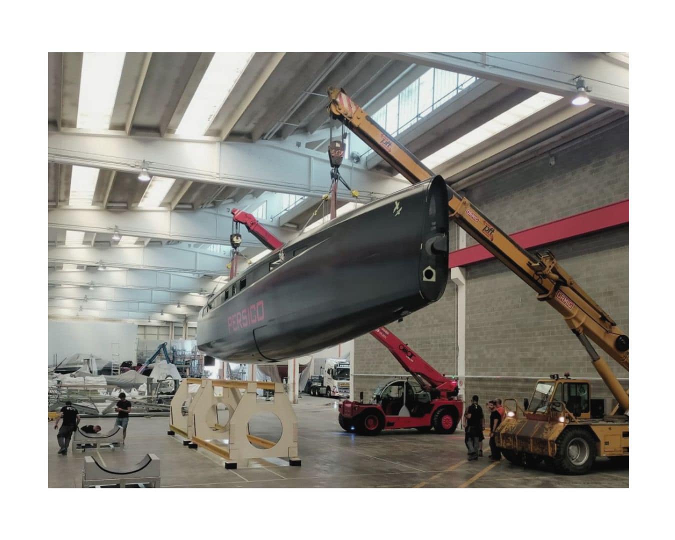

    This cat is being built, this is not a concept. Why do I emphasis this? Because this is a high performance full bridgedeck cruising catamaran that is designed to sail at 40 knots in the right conditions. The Persico Cat 72 is 72 x 31 foot with an overall weight of 45,000 lbs. The sail area and mast height is unknown but a custom designed carbon fibre wing mast and boom was done by Southern Spars. The draft is variable with a set of 23 foot long out facing C foils with automatic rake control, a set of deep daggerboards and a set of T foil rudders. The power for the cat will be Hybrid with a bank of batteries, 2 KW of solar cells and two 25-kW Torqeedo Deep Blue electric motors. A cruising speed of 8 knots is expected under power.
    So why the forty knot speed? Start with the design team Morrelli and Melvin and the build group Persico Marine, both have designed and built high performance designs including America’s Cup cats and mono foilers. Next the Persico Cat 72 is designed to foil from the start. If the design does as intended, its entire hull structure will fly 200 mm above the water depending on the foils for flight control. For the development of the flight system, the owner and designers turned to the same simulation software that was used to design the AC winning AC50 and AC75 by Team NZ. This is the VPP Gomboc optimization software, which acts as a flight controller. Finally, the build structure is very advanced.
    So what sort of performance is expected? The RMFoil becomes effective in as little as 9 knots of wind. Speeds in excess of 20 knots in 13 knots of wind and forecasts of speeds up to 40 knots downwind and 26 knots upwind. For safety and reliability, the fully autonomous foil control system is capable of progressively lowering the hulls and decreasing the speed to the owner's preference, with comfort similar to that expected on a cruising cat.
    The accommodation is not specified but looks like the standard double cabins in the hulls and large saloon with galley and seating. Helming can be done from various positions. Manoeuvring is done from one of the two steering wheel stations located in the large aft cockpit. In addition, all navigation and flight controls can be handled by a small crew of 3 from the helm station. The vessel is also equipped with an inside wheel with flight and mainsail controls to ensure maximum protection and safety at high speeds.
    The cat is built in a sandwich of carbon fiber epoxy prepreg with a Nomex core vacuum bagged and cooked. Carbon was also chosen for the interior, which was designed to be light. This is a quality build using components built in France, Italy and NZ by companies that have a background in AC racing cats. The owner wants one of the fastest real cruising cats in the world and is prepared to pay for it.
    The jpegs give the idea. The last 2 jpegs are of the carbon fibre hulls with final assembly expected in 2024.
