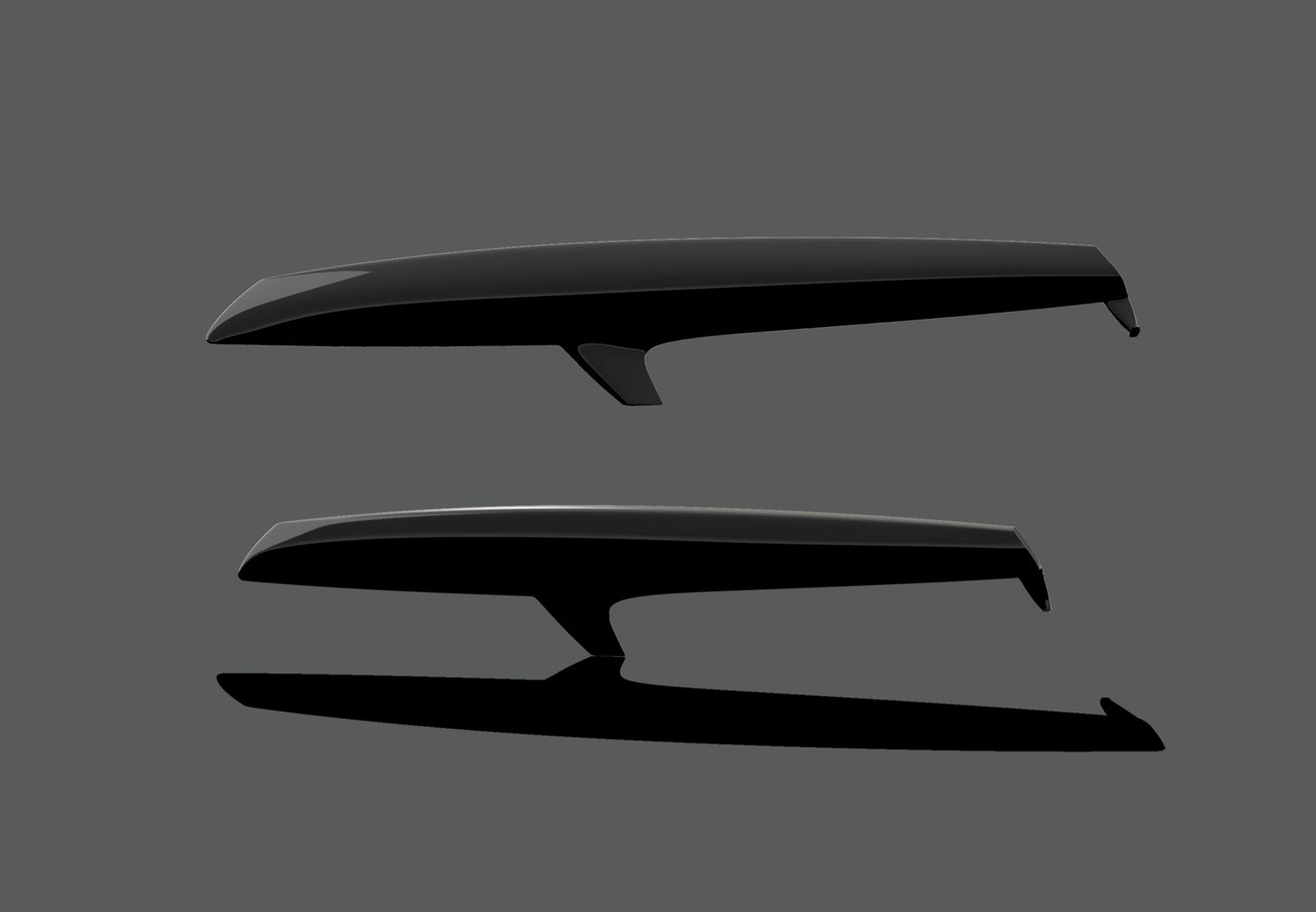

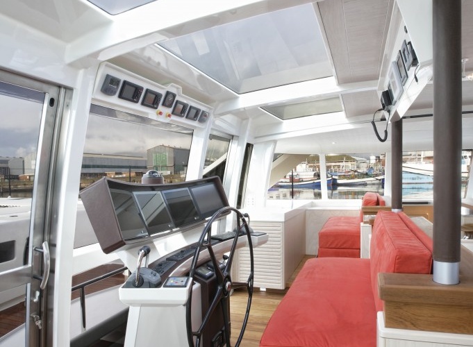

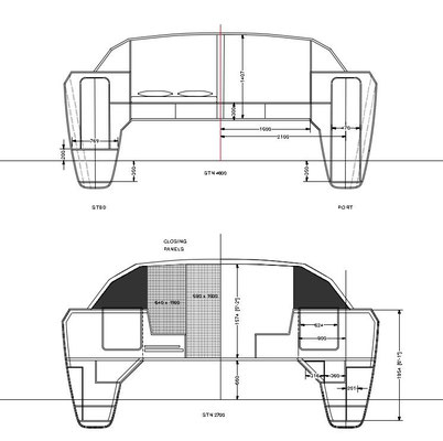

    The first of the pictures presented (which also features at the top of the designer's webpage) is mildly amusing in that it shows this 100 ton 16m wide catamaran sailing on one hull - on a flat sea too! The rig dimensions are not stated but from the pictures they look to be about the same proportions relative to the rest of the boat as one would expect for a much smaller cruising catamaran. Other things being the same, the heeling moment from the sails scales with cube of linear dimensions and max righting moment with the forth power so I cant imagine flying the windward hull to happen with this catamaran - certainly not in the weather conditions depicted. Either these professional designers do not understand the stability of sailing boats or this is misleading graphics being used for product promotion.
    Agree this would make a comfy cruising yacht but given the beam the available accomodation would place it well into superyacht territory so maybe you would actually need rather more than $10 million?

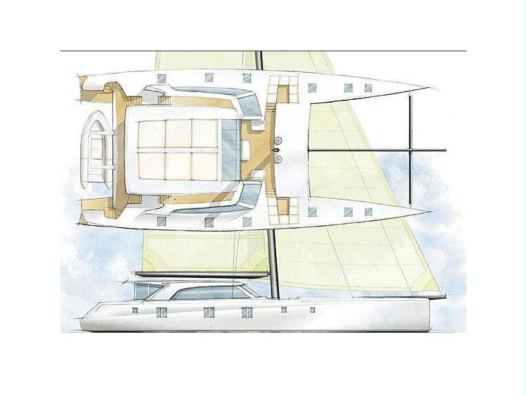

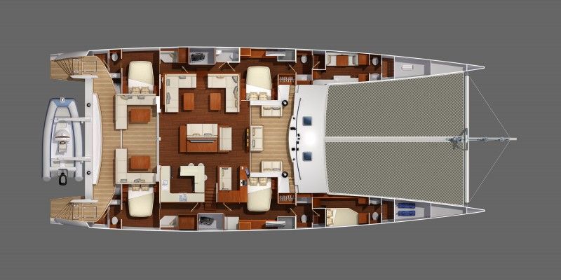

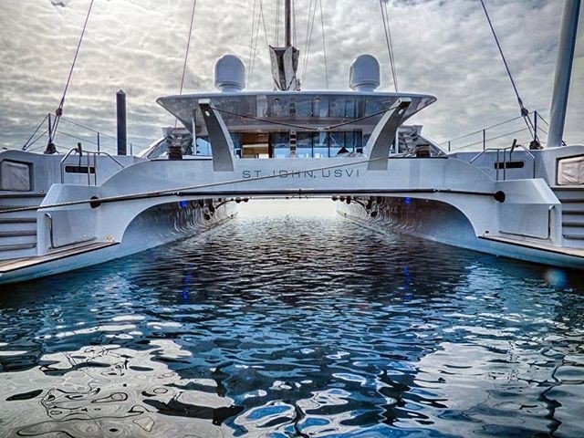

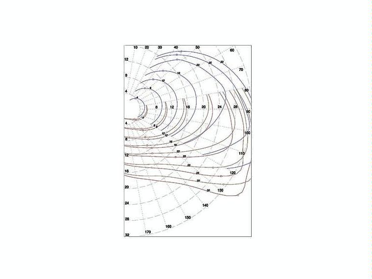

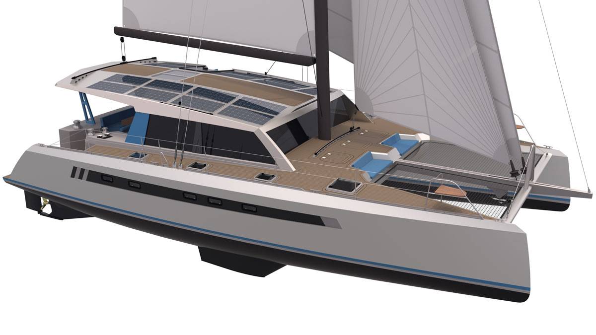

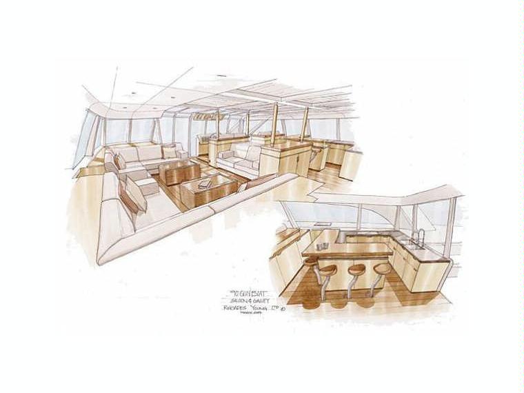

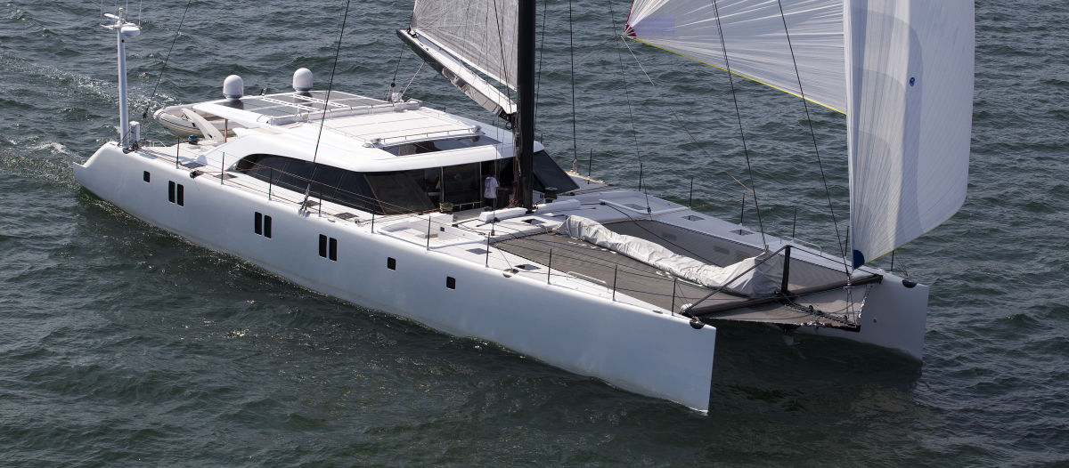

    The Gunboat 90 is an interesting boat, yes its large, yes it sold second hand in 2018 for $11 million dollars, yes it is fast but it was sold after the owner said he wanted a faster smaller boat for his family to sail. He now owns the Eagle 53 partial foiling cat. So, what was “wrong” with the Gunboat 90? The Gunboat 90 (named Sunshine) is 89 x 41 foot with a length of 97 foot over bow sprits etc. The shell weight is 59,600 lbs, the displacement is 82,799 lbs. The 110 foot high carbon fibre Hall mast carries a mainsail of 2012 square foot, a genoa of 1345 square foot, a gennaker of 2368 square foot, a spinnaker of 2490 square foot. The length to beam is over 13 to 1. The draft varies from 6 to 11 foot. The power is twin 190hp Yanmar diesel engines allow a cruising speed of eight knots, topping out at 12 knots.
    The accommodation is large, look at the jpegs, you have space for 4 double berth cabins with ensuites and 2 crew cabins in the hulls. The main saloon and cockpits form a large area for socialisation, food preparation and entertainment with such things as 40 inch TV’s etc.
    The hulls are a composite construction of vacuum-bagged, epoxy foam sandwich and Aramid Honey-comb Nomex with carbon fiber inner skins and Kevlar outer skins for impact resistance. Built by South African yard Gunboat, Sunshine was delivered in 2010. This structure is very well designed and built.
    The result the Gunboat 90 is capable of 400 mile days, has peaked at over 25 knots and has raced successfully around the Caribbean. So why did the owner and his skipper on a sunny afternoon chat about a new faster cat? Because the Gunboat 90 was not radical enough. It was fast but the prospect of foiling around a race course with a reefable wing sail was of more interest. Also, the owner did not need such a large boat for his family sailing. Result the Eagle 53.
    The jpegs give the idea of the Gunboat 90. Please look at the Polar diagram to get an idea of the speed capability.

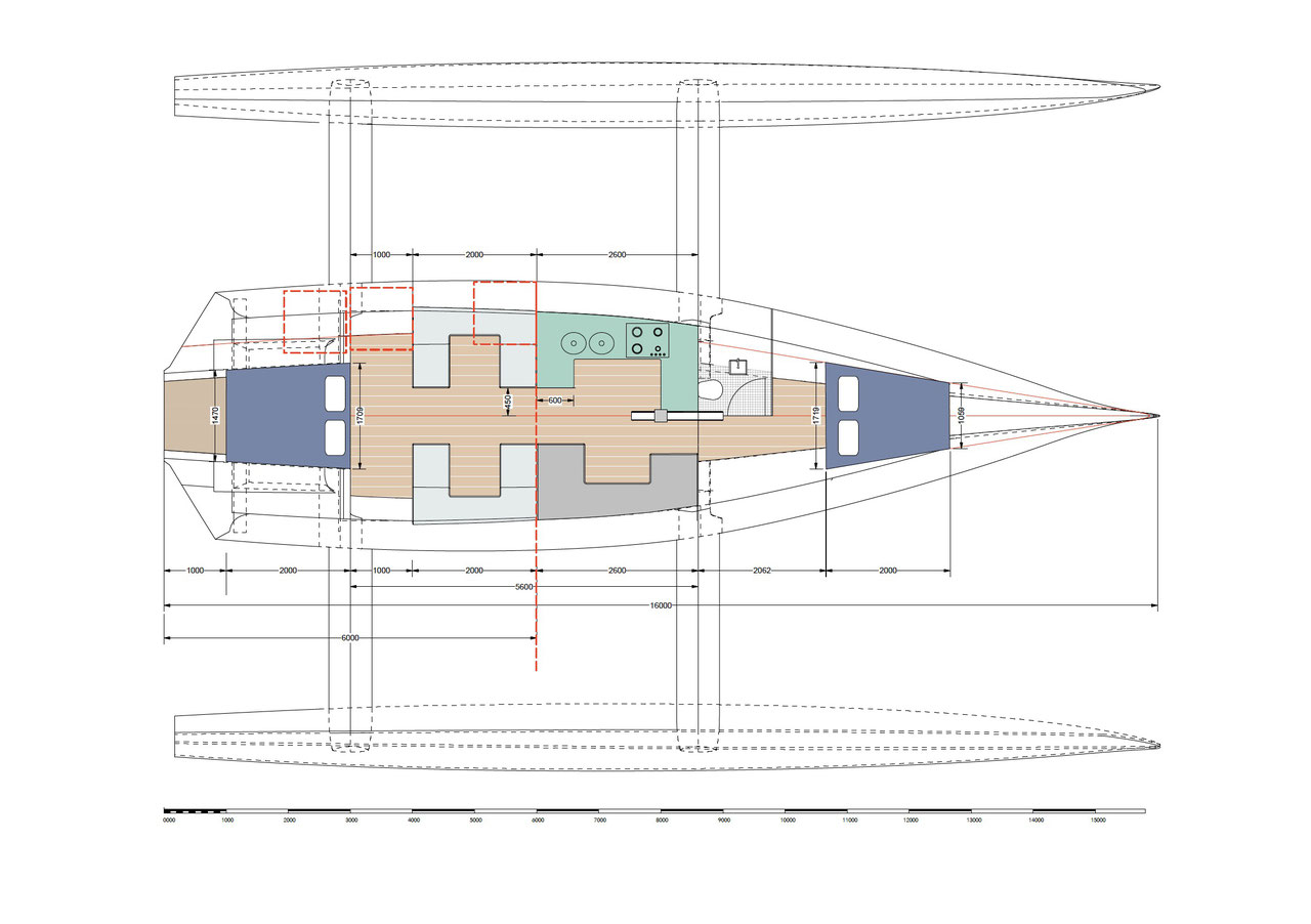

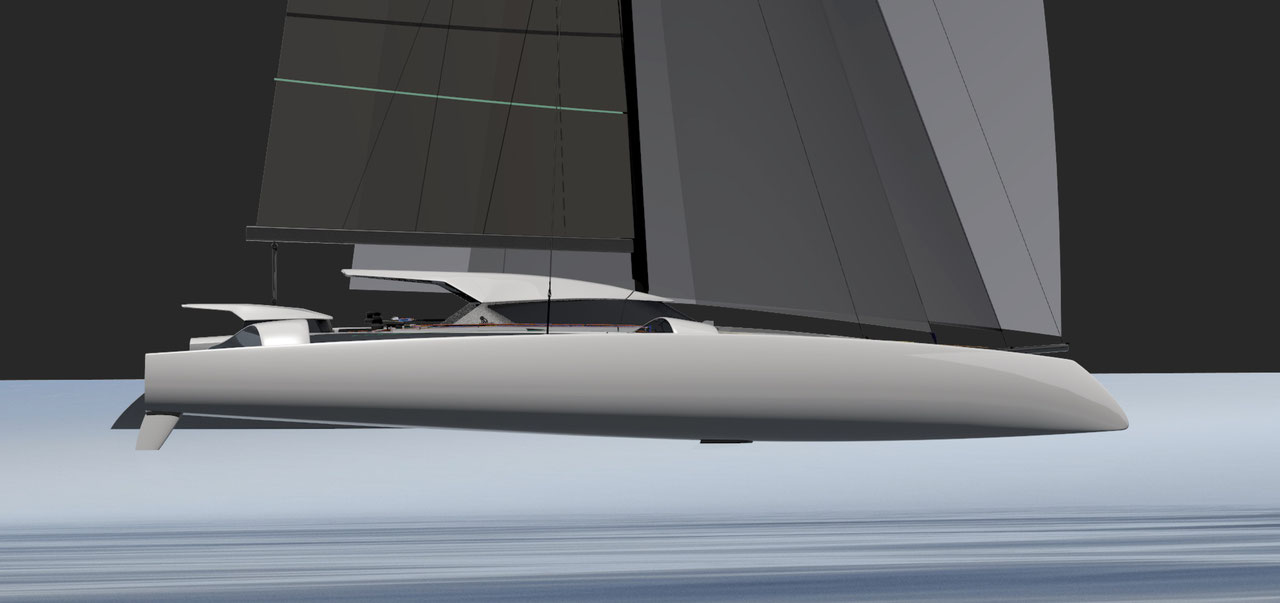

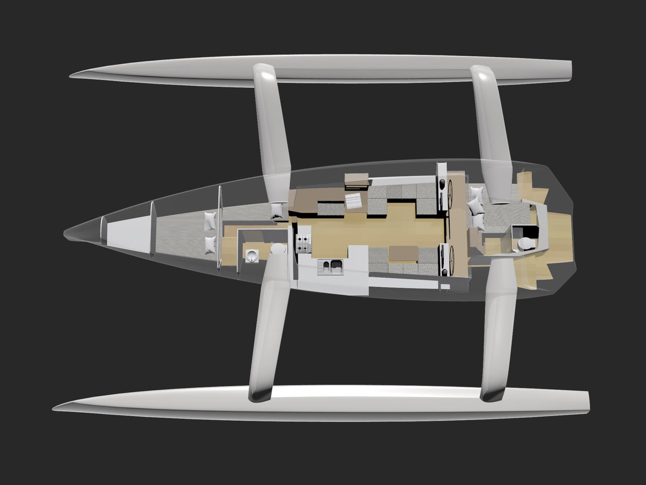

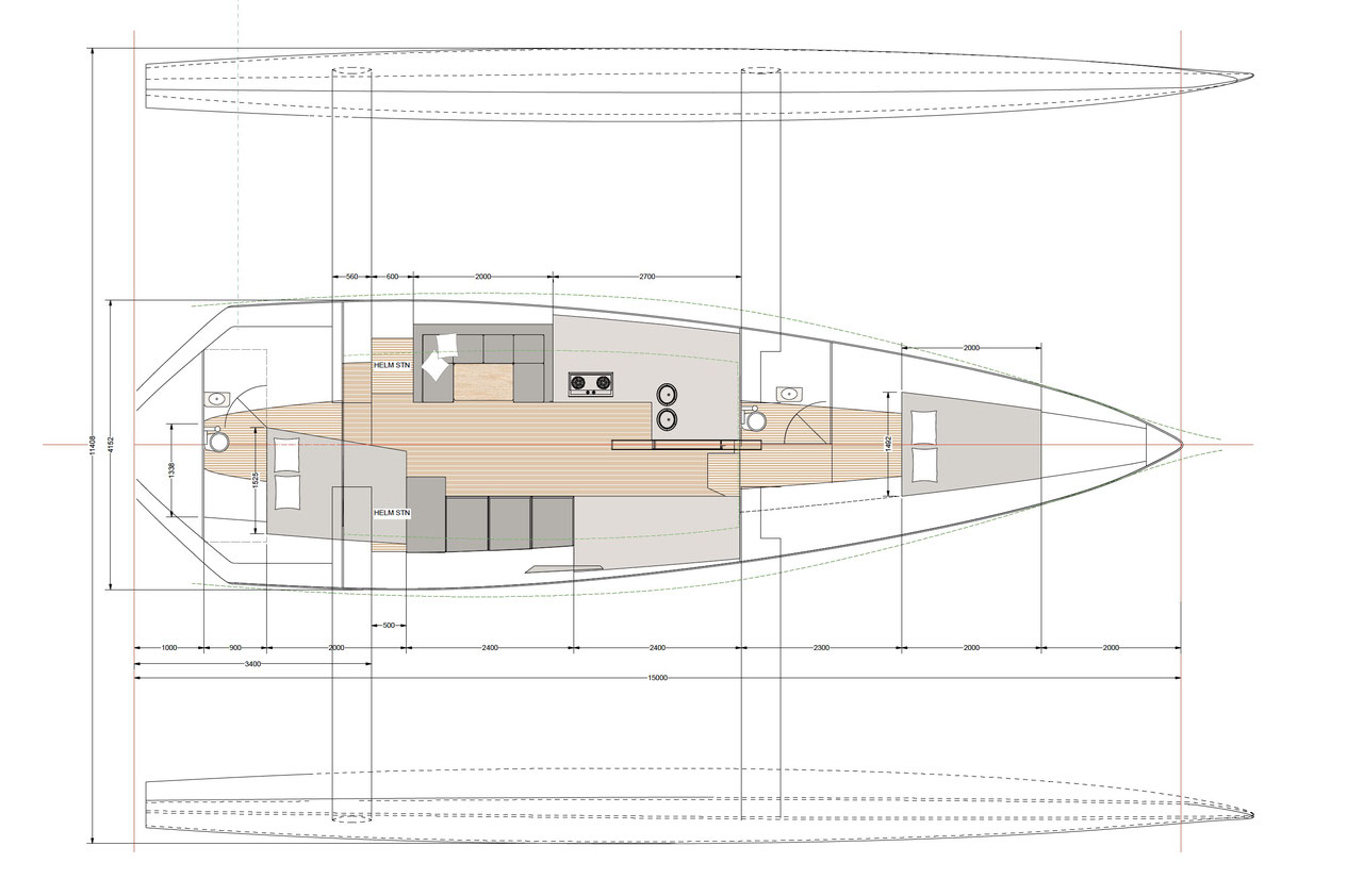

    This is about a new custom design by Grainger Designs. The concept evolved from a series of highly motivated discussions with a couple of veteran trimaran sailors who found themselves boatless and lusting after the next live aboard sailing adventure. The sailors in question are Jason and Clo from Sailing Spirit, a 40 foot ex racing trimaran that has travelled half way around the world. Little detail of the numbers are available so I will give you my GUESSES. The TR 50 cruiser is 50 x 36 foot with a weight of around 18,000 lbs and a displacement of 25,000 lbs. The 70 foot carbon fibre mast probably carries a 950 square foot mainsail, a 450 square foot jib and a 800 square foot Code 0. The draft of the tri is interesting. The floats have large fixed fins that draw 5.25 foot at rest and when healed can draw up to 8 foot. This removes the need for daggerboards in the main and float hulls which lightens the boat, minimises noise, simplifies upwind work and reduces build costs. This is a very logical approach for a cruising trimaran.
    The following is an edited version of Grainger’s website.
    Jason and Clo spend some time comparing the concept of a 50 foot cat to see how it would stack up in terms or accommodation, performance and style. In spite of having more cabins and about three times the interior floor space of the cat, the cat soon took a back seat in the discussions. It was always going to be a trimaran. Jason and Clo (who are professional delivery skippers) spend a lot of time on the water, they have seriously minimal requirement in terms of creature comforts and gadgetry. They have a pretty good idea of what works for them on a cruising boat. The emphasis for the design work was to be on the sailing qualities of the vessel and keeping things simple for minimum maintenance and affordable build cost. Two double cabins and a single bathroom was all they required.
    For a trimaran that will do a lot racing the emphasis is on high buoyancy floats with a lot of buoyancy low down to minimise heeling and get main hull to lift as early as possible. For a cruising trimaran we still want to keep a lot of buoyancy in the floats but the emphasis is on a more V shaped section rather than U shaped for a gentler ride in more animated sea conditions. We achieved the combination of the V shaped hull form with high buoyancy by increasing the float profile. This form will provide a softer motion upwind at the expense of slightly increased wind profile. Fixed fins on the floats don't add much to the draft and provide good upwind performance without interfering with the interior layout.
    Design of the helm station and access to the sail controls is at the heart of the efficient functioning of a sailing yacht. Twin helm stations aft in the cockpit with sail controls readily at hand keep the helm person in close proximity to rest of the crew and guests. The helm has good visibility from the seated or standing helm position, and even better visibility over the cabin top by standing on the side deck. In adverse conditions the helm person can also benefit from the protection of the roof that extends right to the forward end of the aft cabin. An optional tiller steering arrangement allows for helming from the aft beam sitting or standing.
    Construction: PVC foam cores/epoxy infused with glass and carbon reinforcements engineered to ISO12215-17.
    The jpegs give the idea of a very interesting design, I hope we see it on the water soon.

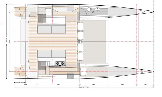

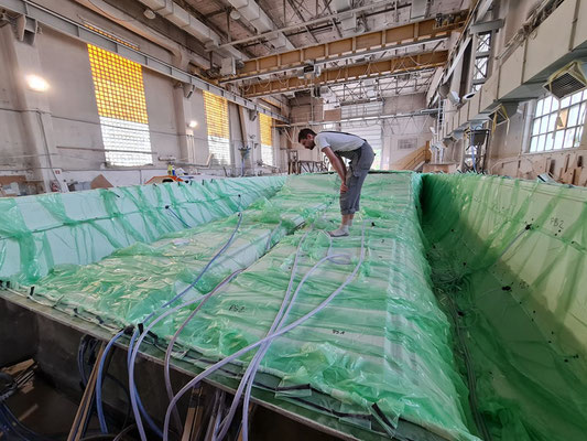

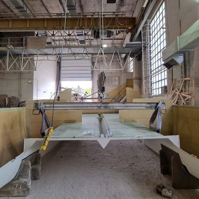

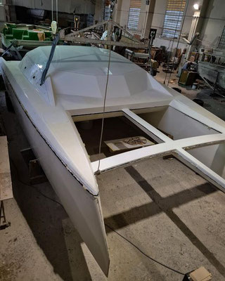

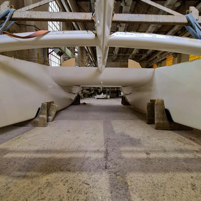

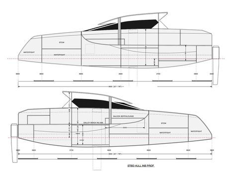

    Whilst we are on Grainger design, I noticed that Tony is now saying he is designing multihulls that are longer for a given accommodation, as it provides a better performance and sea comfort. The I looked through his designs on his current web site and found the shortest design is 40 foot catamaran or a 36 foot trimaran. His earlier designs like the Raku 32 still exist but as a production build and the Raku 35/6 has disappeared. From another source Tony appears to be focussing on larger new designs or semi production kits of his larger catamaran or trimarans. People who want smaller designs appear to not be catered for.

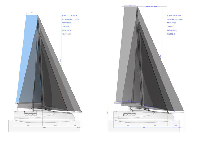

    So, an update on the Raku 32. It is now being built by a Polish company, promoted by Roland Gaebler, a German (who helms a Decision 35 catamaran), who has helped develop a performance version of the cat. The Raku 32 is 32.15 x 17.2 foot with a weight of 6,650 lbs. The standard model carries a fixed aluminium mast of 48 foot carries a 440 square foot mainsail, a 225 square foot jib, a 616 square foot Code 0 and a 904 square foot Gennaker. The Performace rig has a 52.5 foot carbon fibre mast that carries a 495 square foot mainsail, a 23939 square foot jib, a 602 square foot Code 0 and a 995 square foot Gennaker. This is a lot of sail for a 32 foot cat. The length to beam on the hulls is 13 to 1. The draft is 5.5 foot over the daggerboards. The power is outboards of 10 HP.
    The Raku 32 will move very well under either rig if built to weight and is not loaded down with excess crew and stuff. A estimate of speed says 10 knot averages will be possible with peaks around 20 knots. The price start at $270,000 US to $324,000 US for the performance version.
    The accommodation is 2 double berths forward on the wingdeck, a single berth and toilet in 1 hull and a galley and single berth in the other hull. The saloon connects to the cockpit to have a large social area. The hull headroom is 6.2 foot and the saloon headroom is 5.3 foot. The steering can be tiller or wheels in aft corner of the cockpit.
    Construction is foam e-glass with vinylester resin. There is some carbon fibre reinforcement in bulkheads and roof structure.
    This is an excellent fast smaller cruising catamaran that will good fun for those that can afford her. Pity the design is no longer available for the home builder.

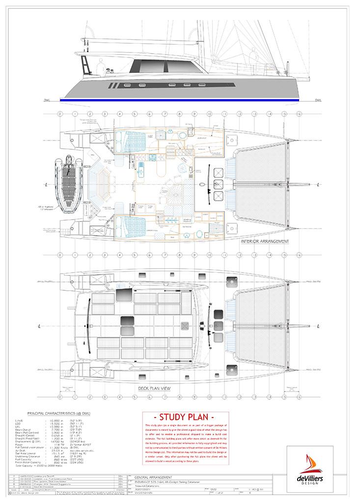

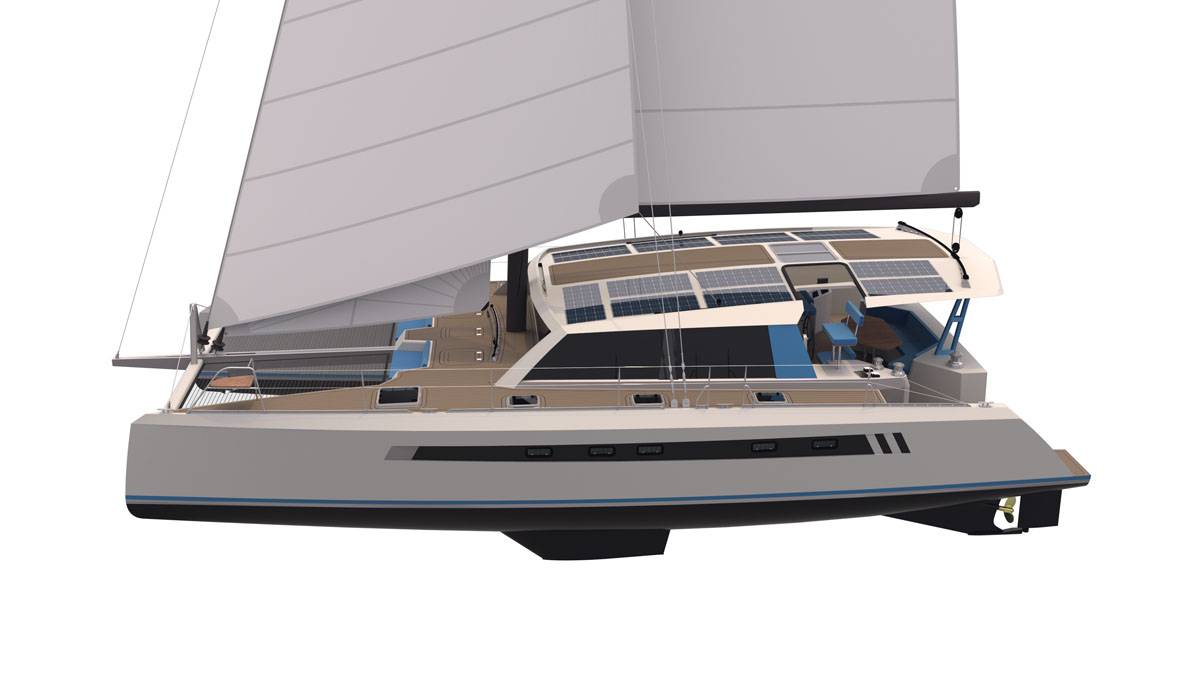

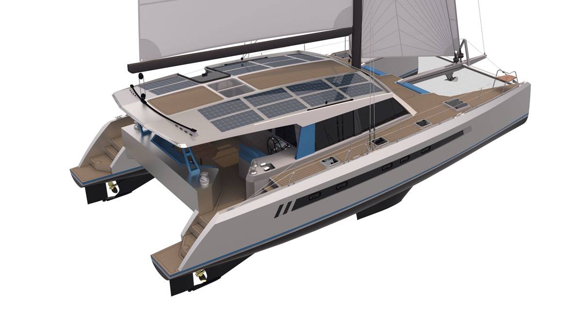

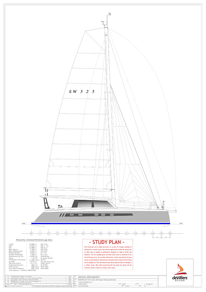

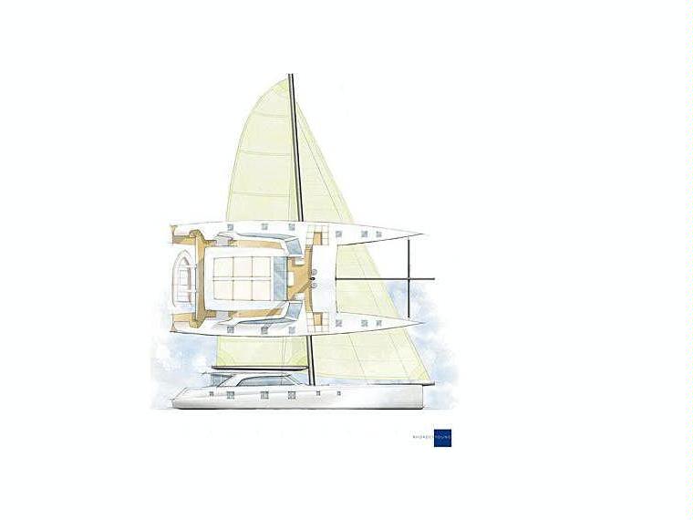

    This is a story about a company wanting to explore options before they commit to a new design. Seawind catamarans sought a new larger design for production. Eventually Seawind chose a Reichel Pugh 52.5 foot fiberglass composite design (the Seawind 1600 Passenger). An alternative proposal for Seawind was from De Villiers Yacht design in New Zealand. The 525 cruising cat is based on an existing hull design but had a complete rework above the gunnel level with new deck, interior and cabin top. Basic first, the 525 is 52.5 x 25.7 foot weighing 32,400 lbs. The 70 foot aluminium fixed mast carries 1631 square foot upwind and has Code 0 and spinnaker options. The draft over the fixed low aspect keels 4 foot. The underwing clearance is 2.75 foot. The power is 2x Yanmar 4JH57 diesels driving through a shaft to propellers in a skeg rudder combination.
    The name chosen by De Villiers was the Seawind Endurance 53. The reason is this cat was a strong design intended to be built from mainly aluminium. As I said, he had done similar cats previously for extended cruising sailing, the DVD 52 foot Aluminium Cruising Catamaran – Design #163 / #183 /#226, and for this design (#232) used the same hulls but modified the topside. This could have been the first aluminium production cat for Seawind but I suspect Seawind choose to stay with composition fiberglass production for consistency and I also suspect these designs were proposed at the time Seawind and Corsair were getting together. Choices had to be made.
    The accommodation spaces are generous. In 1 hull is a guest double bedroom with ensuite and a real work shop forward (or alternative sleeping cabin) in the other hull is a master suite with a double berth, seating and a full ensuite bathroom available. The main saloon has a full galley, seating, entertainment area and a navigation helming station forward. The deckhouse roof extends aft to cover the aft deck lounging area which allows for a 3000 Watt solar array. Aft is a cockpit with dual under cover helming stations. All of the sail control lines are led aft through the house side window sill coamings to dedicated winching stations alongside each helm and there is a self tacking jib to simplify sail handling. Again, on a cat this big electric winches would be a big advantage.
    Performance is not mentioned but with the sail area and relative low displacement this cat could do 10 knot averages and peak at 20 knots in reasonable conditions.
    A nice conceptual design for those who really want to sail a go-anywhere ocean voyaging catamaran.
