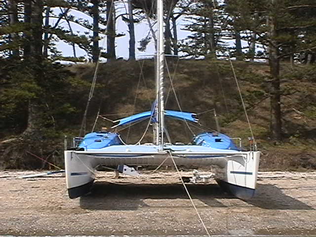

    Today we will talk about a cat that was designed and partially built at sea, specifically the frames were made on a bulk carrier by the ships master John Sawyer in 1983. John designed and built Double Exposure. The open bridge deck cat was completed on land then sailed successfully. “Double Exposure” was 42 x 24.9 foot and displaced 9000 lbs. The Alspar LP6 tapered aluminium spar has a working sail area was 915 square foot with a triradial spinnaker of 1720 square foot. The length to beam is about 12 to 1. The power is two 9.9 HP outboards.
    Now we get to the interesting stuff, “Double Exposure” renamed “TL systems” then renamed to “Tardis” was lengthened to 47 foot. A sister ship called “Fair Curve” was also built. These cats are still sailing with TL systems racing in NZ up to 2018 and is still on the water. 35 plus years of sailing is impressive. But the most impressive part is the performance.
    TL Systems in 0 to 10 knots can beat a Newick 36 foot Echo tri, the boat easily cruises at 12 to 15 knots, goes 10 to 12 knots upwind in any sort of breeze, tacks through less than
    90deg and has done 24 knots for an hour or so on a two sail reach. Another owner reported “I remember sailing single handed from Tiri to Kawau and back in 25 knots NE breeze with a metre or metre and a half of chop, I just kept going backwards and forwards at 18 to 20 knots without even spray coming on deck. TL systems was more of a smooth knife than a sledgehammer through the water.” For a simple 35 year old cat this is seriously fast.
    The accommodation has 3 double berths in the hulls and a galley and seating area in one hull. There is a toilet forward in one hull. This is a practical layout for sailing but is not a floating house. The open wing deck aft of the mast had a hard floor inserted for more comfort. Open deck design but with cantilevered accommodation inboard of each hull behind the main beam. The main beam is big enough to sleep and crawl through to get from one hull to other hull.
    The build is stringer on frame construction with 6mm ply over Kauri frames with Kauri stringers. The underwing is 8 mm plywood. The main beam is a plywood box beam.
    An interesting, simple, fun fast cat. Mr Sawyer you produced an excellent cat. The jpegs give an idea.

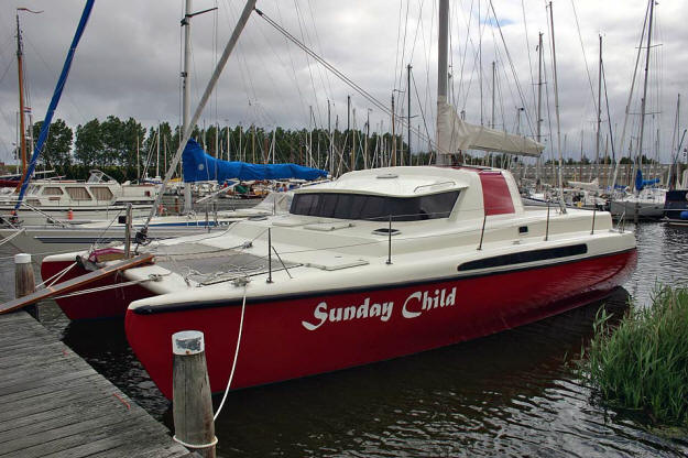

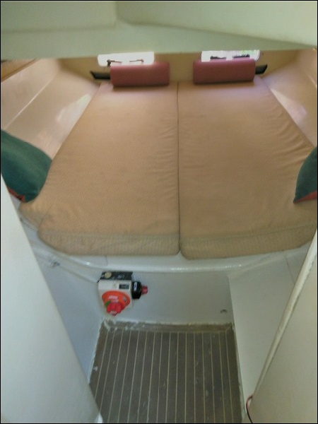

    The following cruising catamaran was designed by Alexander Verheus of Verheus Multihull Design for short handed cruising. “Sunday Child” is 36.75 x 19.7 foot with a displacement of 8000 lbs (probably weight). The aluminium mast is 44 foot high with 325 square foot mainsail, a 365 square foot furling genoa, a 280 square foot high aspect furling genoa and a 987 square foot gennaker. The draft is 2.3 foot over the low aspect ratio keels and rudders. Power is 2 x 9.9 HP outboards.
    The hull shape is inverted bell bottom. That is narrow waterline with flair topsides to increase hull accommodation. The jpegs show the narrow waterline but the hull double berths are wide. This is a good hull shape for sailing and if done correctly, helps provide good speed and a smooth ride in a seaway.
    The accommodation in the main saloon is a J-shaped Dinette with varnished table and a navigation desk. There is a spacious galley in the starboard hull with a double berth aft and a single berth cabin forward. A double berth cabin aft and a head forward in the port hull. The mast base is in the front of the cockpit (like older Prout cats) for ease of sail controls with the helming position close to the mast base so it's easy to control the yacht single handed.
    The yacht was built in 1998 in New Zealand by M&M Boatbuilders and is listed as GRP. I suspect this cat has either strip plank cedar or a foam core judging by the clean interior with a minimal of interior framing. My bet is on Strip planking.
    This is an interesting design; I do not know any performance numbers but I suspect it will be an 8 knot average sort of cat with peaks in the 16 knot range. In short, a very good cruiser. The jpegs tell the story.

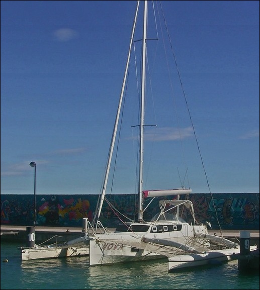

    The TC1040 cruising trimaran is the largest really trailable (it folds to 8.2 foot) trimaran I know. It was designed by Tim Clissold of TC Design Ltd for a guy in Holland who had it built by M&M Boat builders at Drachten. “Nova” was launched in 2007. Nova is 36.9 x 26.9 foot and can be folded to 8.2 foot with a farrier type system. The weight is 5600 lbs and the displacement is 9000 lbs. The 46 foot Sparcraft aluminium mast carries a 548 square foot mainsail and a 290 square foot jib on a ) Facnor FX 7000 roller furler. The draft over the rudder and Catri foils in floats ranges from 3.2 foot to 6 foot. There are also foils on the back of the main hull and floats help with lift and stability at speed. The Hybrid Kubota D722 diesel-electric propulsion. Powering the system is 144V is by an electric engine on a sail drive set up and 4 bladed Piranha propellor drives the tri at 5 to 6 knots using 2 liters/hour.
    The yacht offers two double cabins and a dinette that can be converted into a third double bed. There is a large galley has all electric appliances, rather than LPG, in the main saloon. The head is right by the main hatch, while the shower is forward. The cockpit is where all sail controls lead to and the helm is a tiller steer. The claimed sailing speed of the tri is 8 to 15 knots. Realistic.
    The construction of the PVC foam-glass-epoxy sandwich yacht. The amas are rounded, using the stressed foam method in two vertically split hull moulds, while the main hull has flat panels for ease of construction above the chine line. The crossbeams are large section aluminum tubes with control arms.
    The jpegs give the idea of this tri. Only problem I see is the mast raising, a 45 foot mast with its bits would weigh 200 lbs plus, quite a control problem when being raised.
