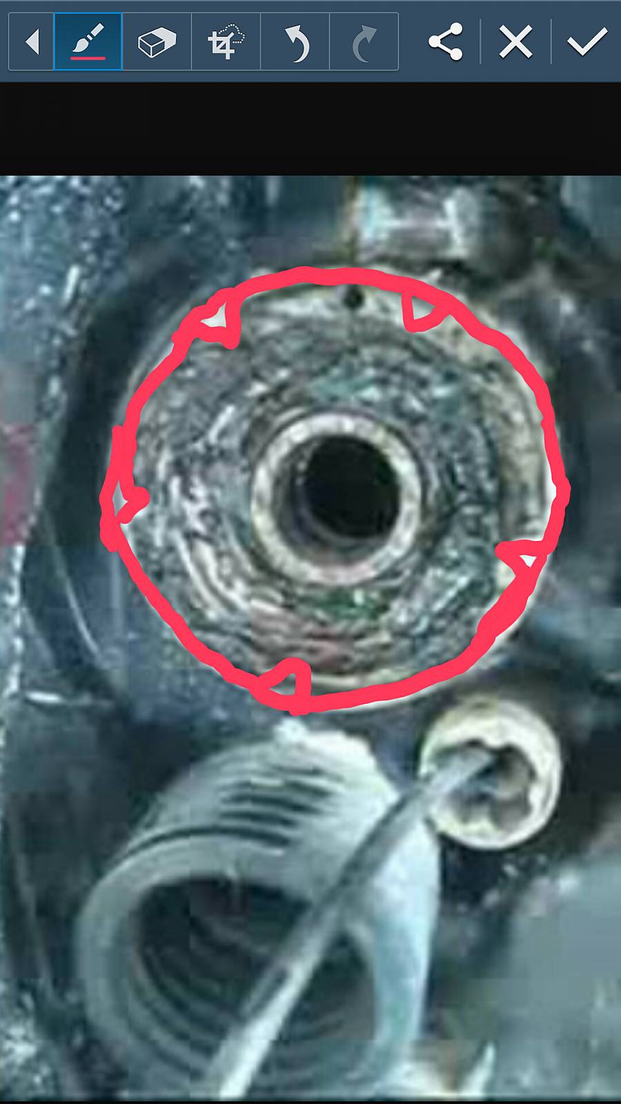

    Hi all,
    Can anyone please tell me what the round part with knobs on the inside is called.
    It is all eaten away at the bottom.
    I need to remove and replace it.
    Thanks,
    Mike

    Model and year of the drive and a more precise description of the part, maybe an arrow?

    Hi again hope this helps
    It a Mercruiser MC1

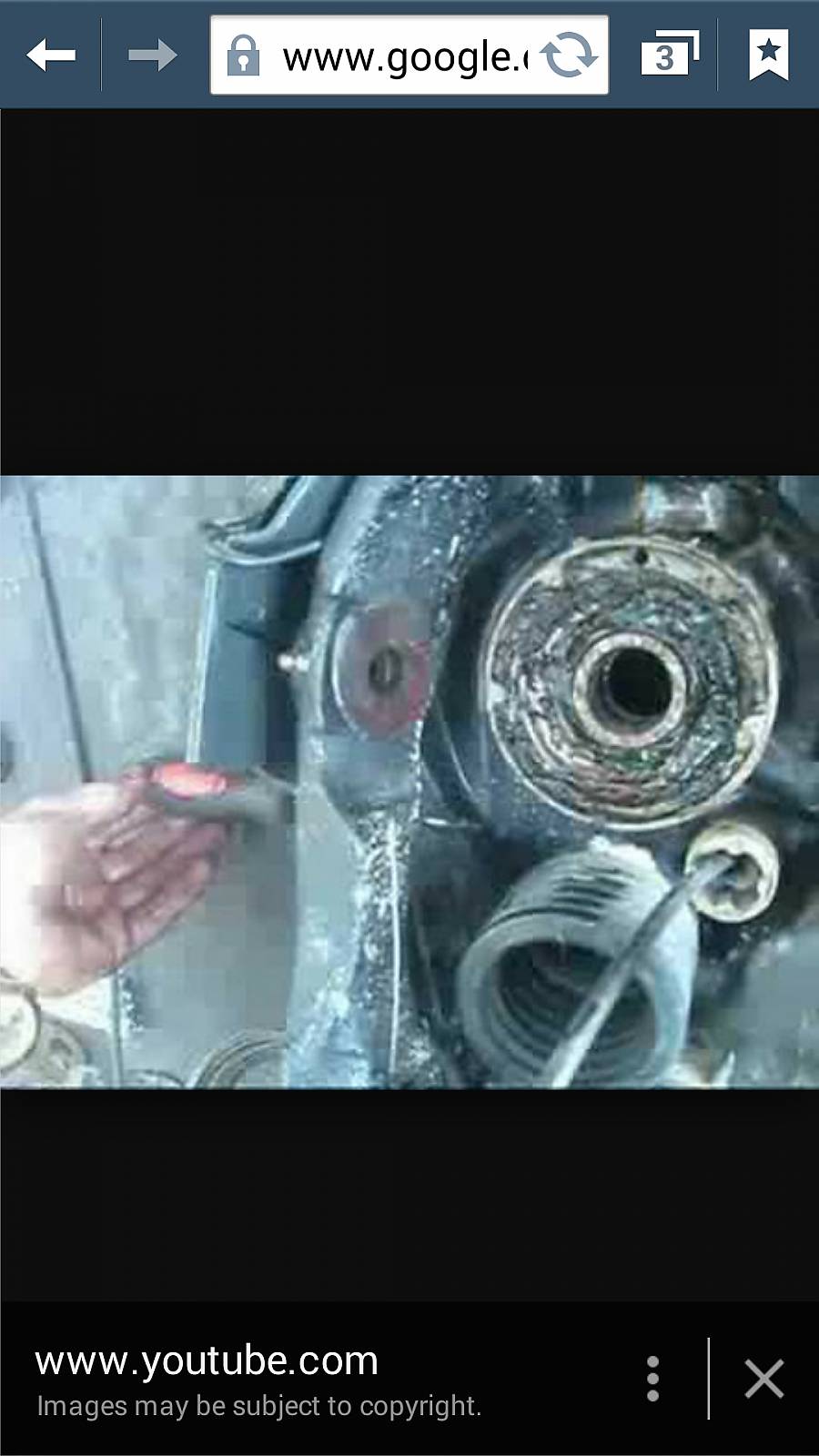

    it's not the gimbal bearing.
    I have removed the bearing and have a new one to install.
    The part I'm looking to ID is just behind the bearing towards the back of the boat.
    It has knobs small knobs on the inside that I am thinking fit a tool for removal.
    Thanks,
    Mike

    There's only three parts in that bearing bore, the seal, the bearing and the tolerance ring. The parts are listed in that order from front to back, so you need the tolerance ring. If you order (OEM 30-60794A4) you'll get both the bearing and the ring.

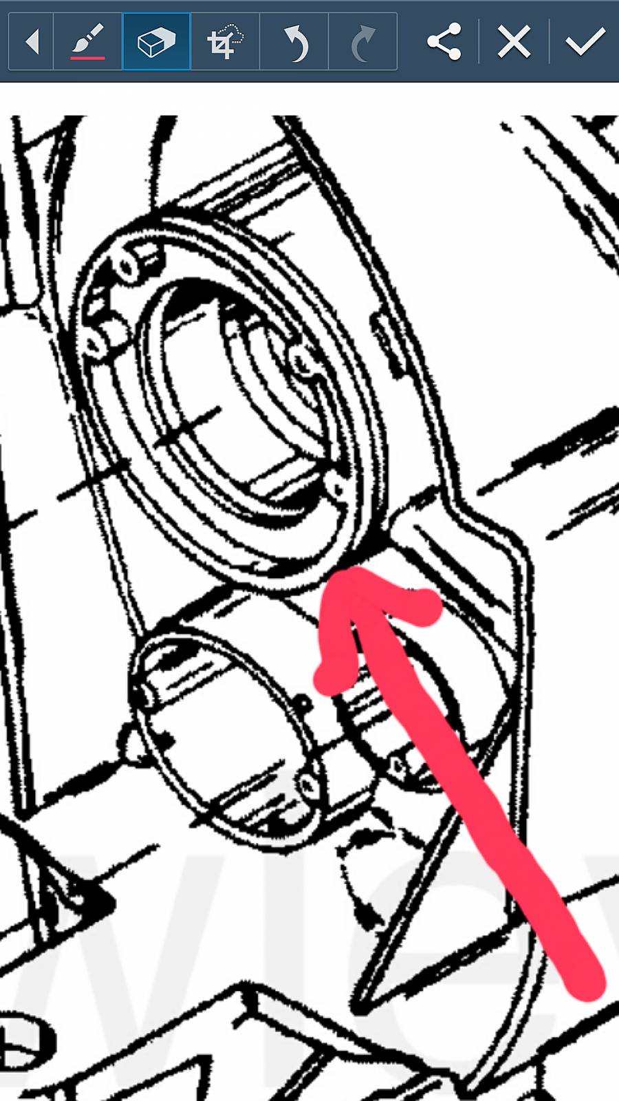

    This is the part guys

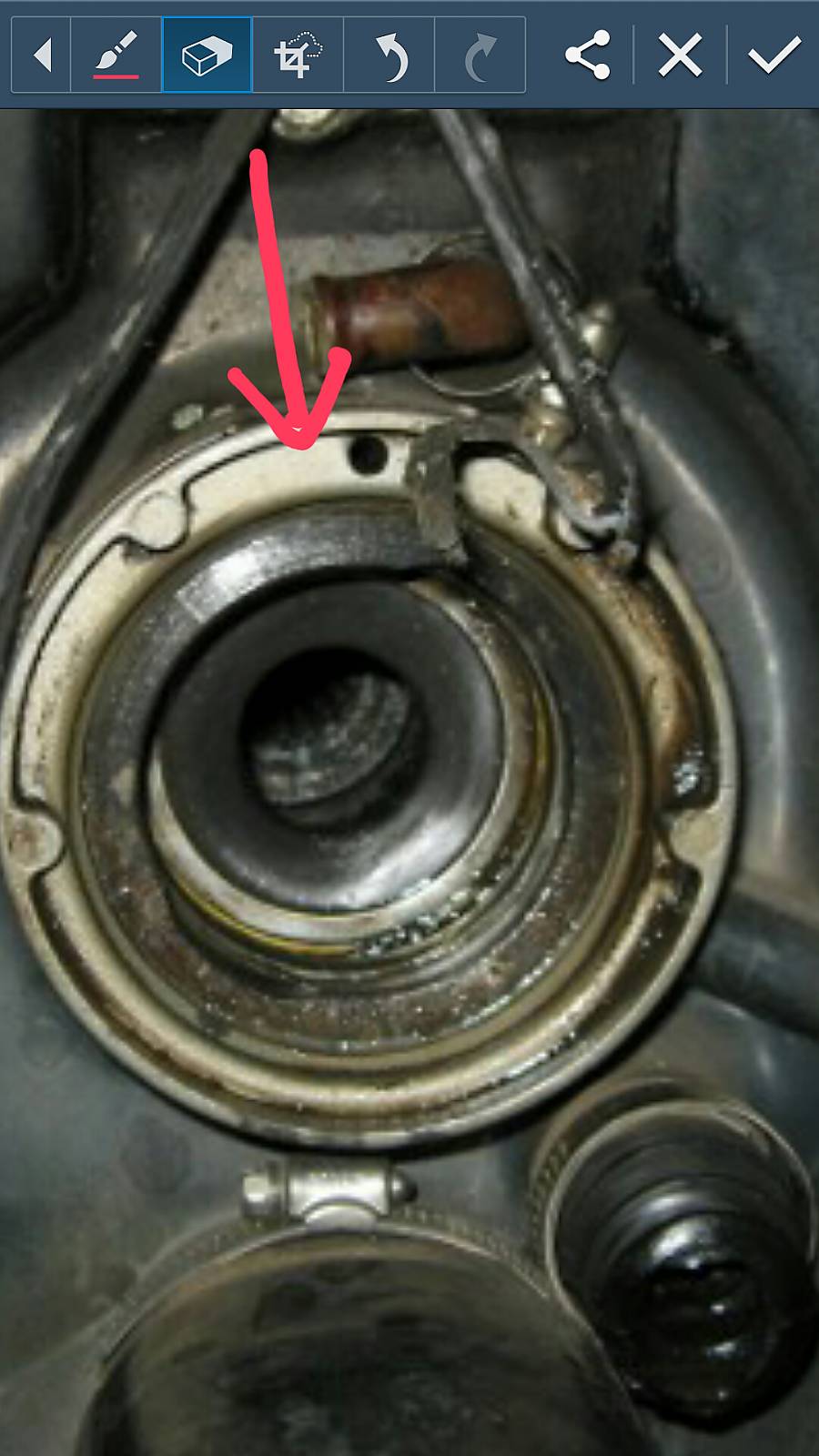

    This round part

    I think that's part of the gimbal housing itself, cast in the transom assembly. I don't believe that is a separate part.

    That is the casting itself. If it is so corroded that the bellows can't attach to it any more, you need a new transom shield.
