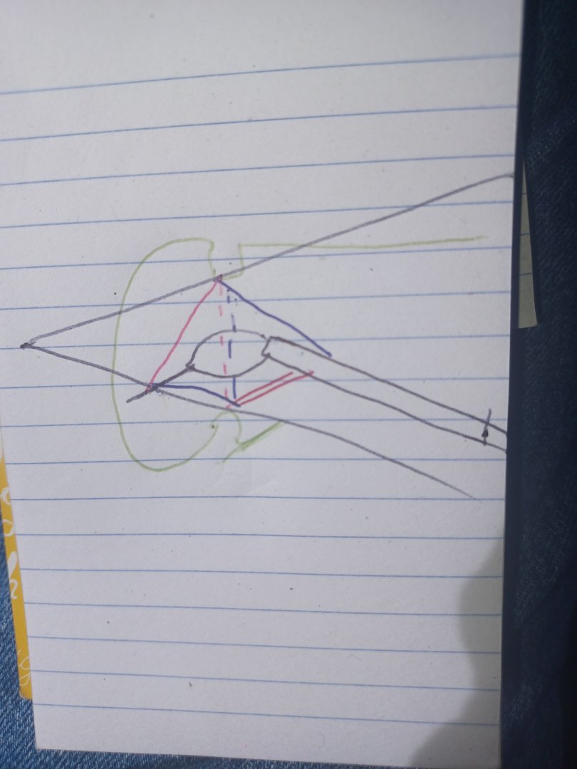

    Forgive my crude drawing
    The geometry has to be spot on and would be difficult to determine.
    - Counter crossing red and blue lines of equal static length should auto tack and jibe the mast.
    - The green line would allow for mast rotation tuning by allowing the red/blue turning blocks to move in/out board.
    - Force required to rotate mast must also be considered.
