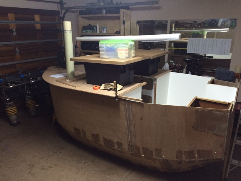

    Here are the pics of the mockups as I was playing along to see how everything is going to fit and to calculate weight distribution carefully.
    So the next project after the keel is the "roof" then the whole picture becomes a lot more clearer :cool:

    The battery says ‘‘Do Not Charge in Sealed Container’’ so don't forget to make provisions to vent the battery box I think.
  4. Manie B
    Joined: Sep 2006
    Posts: 2,043
    Likes: 123, Points: 63, Legacy Rep: 1818
    Manie B Senior Member
    The battery box is not sealed off to the top. There are lots of gaps and spaces where the pipe and cables for the 12v bilge pump comes out and then also the cables from the battery to the controller. It will be safe because the lighter than air gasses could raise and "evaporate"
    Fortunately my draw off the batteries is very low and the amount of charge going in is also relatively low. Keep in mind having 3x batteries is to have good "storage" when bad weather strikes, then the windgenerator will be stopped and of course the solar panels become virtually useless. Having the 3 batteries at least means I can also run the Torqeedo motor to move out of harms way for a couple of hours. That's also why the Lead Crystal is important because they can be run flat without damaging the batteries.

    Manie, you speak of a low draw off, but also of a chance of running the batteries flat by using the Torqeedo motor, after which the batteries will be recharged by the wind generator and the solar panels, or by shore power when berthed. I think letting the gases "evaporate" through some gaps in the keel battery box isn't up to any safety standards. Second thing is that after the "evaporation" through some gaps the gases are in the cabin, which I know will be well vented, but the gases shouldn't pass through the cabin I think. Maybe you have valve-regulated batteries, the so-called "sealed type", they need 25% of the standard ventilation requirements.

    Angélique you make some very valid points - but Lead Crystal batteries are very different to what is usually used, which is mostly deep cycle lead acid. Lead Crystal are completely sealed and can even be mounted on its side.
    And I quote - "During the first few discharge/charge cycles, the electrolyte solidifies and forms a non-toxic white crystalline substance. This results in a safe, fluid-less, high performance and environmentally friendly battery."
    http://www.rectifier.co.za/Batteries/discover/pdf/Lead Crystal Batteries.pdf
    I must stress that I am also very concerned about out-gassing but to date I have found no evidence that this could be a problem with Lead Crystal. I do stand to be corrected if anybody can post links to reliable documentation and not hearsay from the yacht club pub :)
    I have kept out-gassing in mind and there is provision for a vent pipe but I will only install that if I can actually find/prove that it is a problem.
