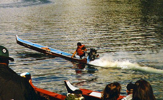

  5. SaltOntheBrain
    Joined: Feb 2007
    Posts: 123
    Likes: 7, Points: 18, Legacy Rep: 87
    Location: crosbyton, TX
    SaltOntheBrain Senior Member
    Like this?

  7. fernandodlc
    Joined: Jun 2014
    Posts: 13
    Location: United Kingdom
    fernandodlc Junior Member
    Not far off lol
