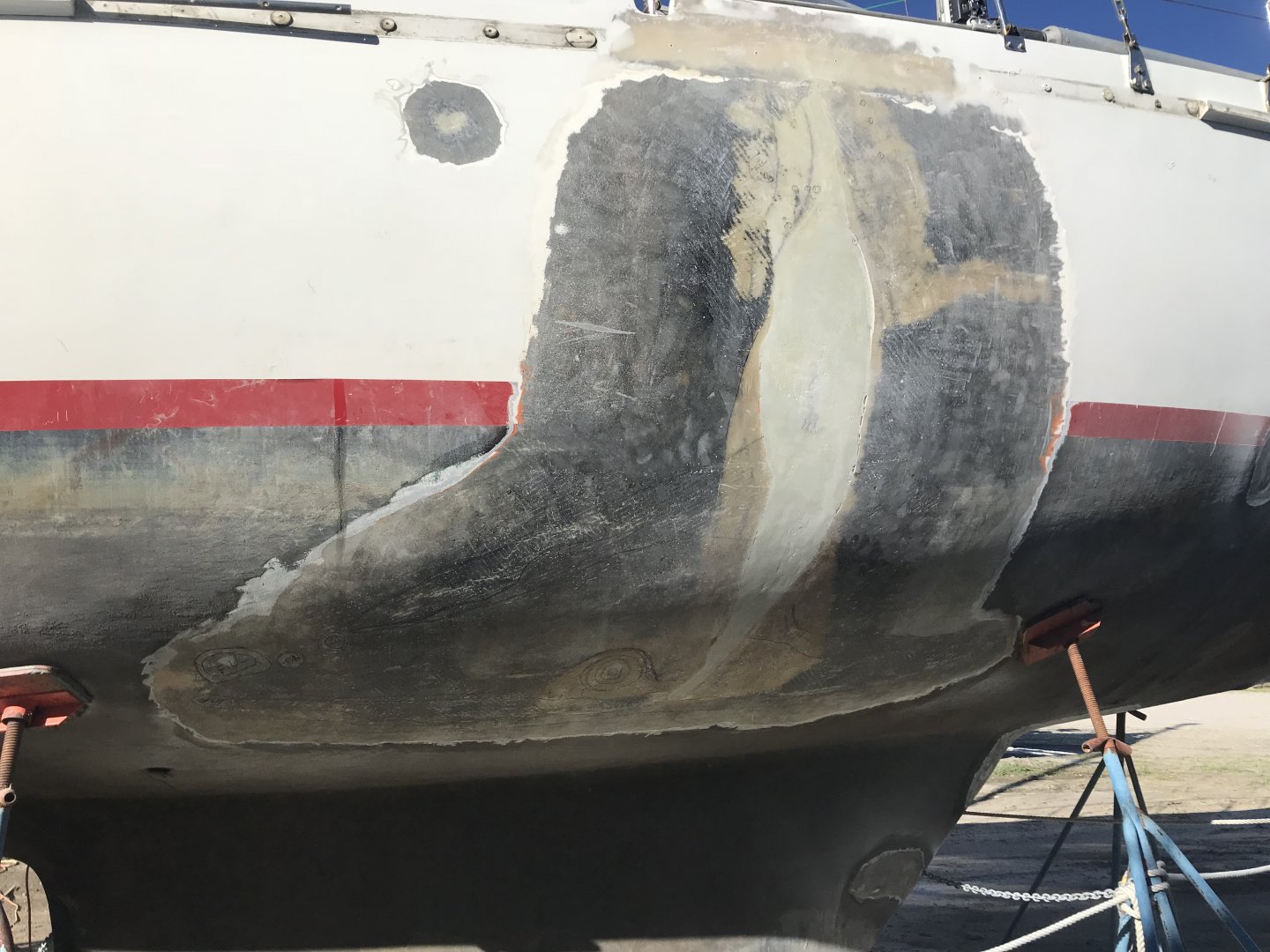

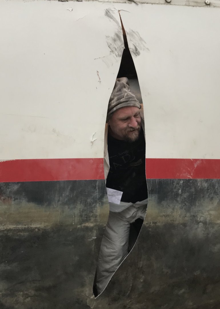

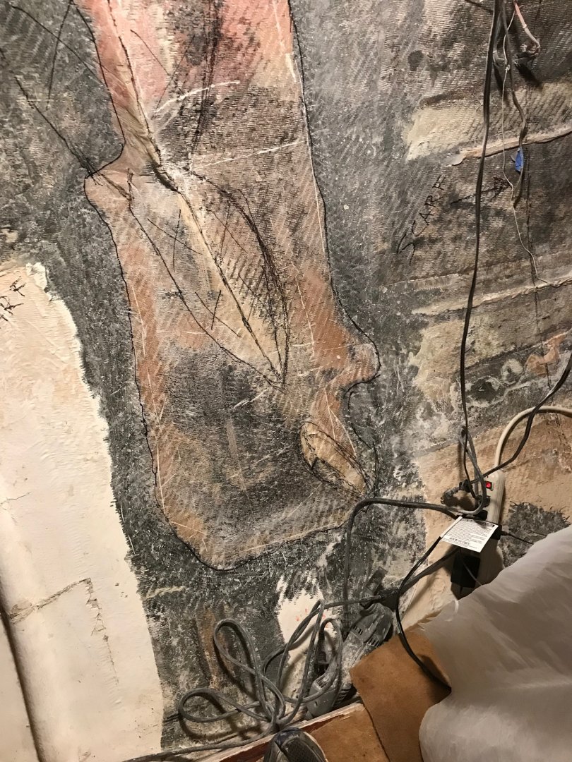

    regarding the damage - Almost finished removing all the delaminated damaged glass from the hull breach to determine the extent of the breach and size of new repair patch and removed one stringer.
    I haven't finished grinding in the scarf for the repair but I have determined the extent of the delamination and how much of the hull will need to be cut out and how much scarf I plan to add. I do plan to move that scarf line back at least a foot from where it was marked in the photo.

    I am pretty sure the scarf ratios you cite are unneeded. I think what happens is the longer the scarf the more likely you will have a void or error. I wish I could give you the actual number but 1:12 is fairly typical. How would you ever scarf into the hull accurately at 1:100 without damaging good hull? Isn't that a 50" scarf for a 1/2" hull?
    A few of the pro builders here might advise, but I would use a much lower number and focus on using more glass to strengthen vs a unusual scarf.

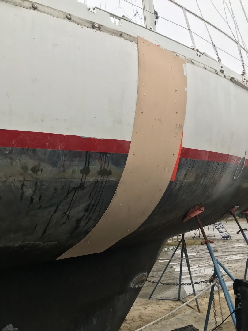

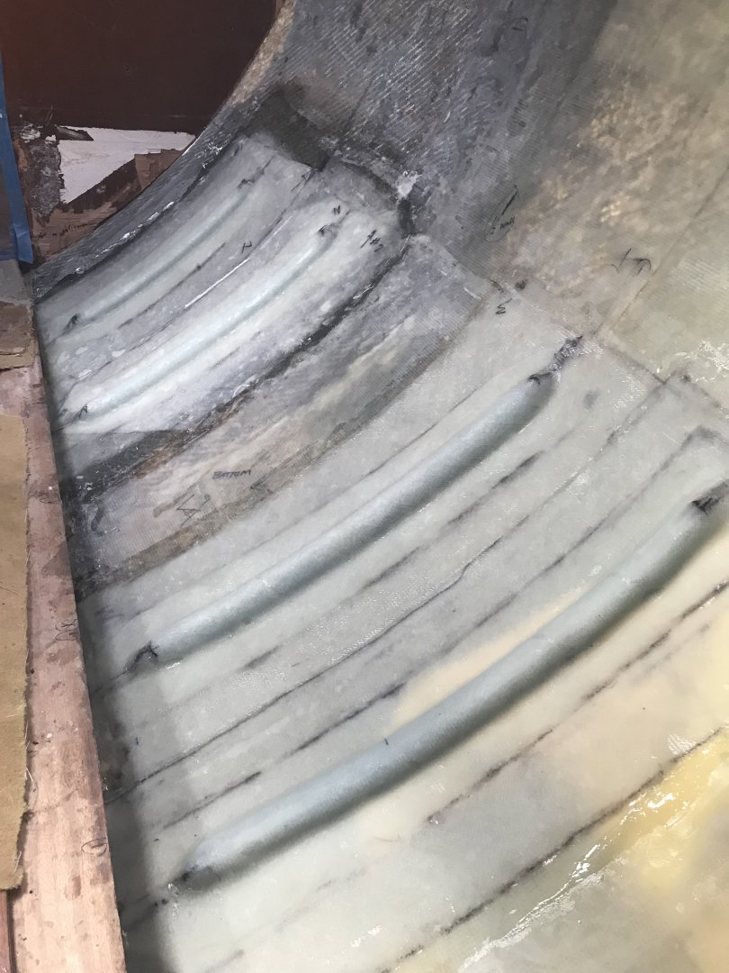

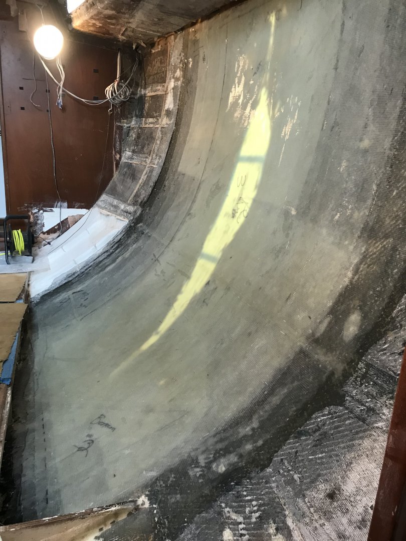

    Hull repair was completed with 13 layers of 17oz Biax and epoxy. Scarfed back a minimum of 48” fore and aft and a minimum of 28” above and below damaged area. 3 layers externally and 10 layers internal all overlapped 3-6 inches depending on location. Layers of Biax were alternated with glass strands at 90 deg and 45 deg alternating layers. Fill and fair and paint yet to complete. Currently working on bulkhead repair...

    BYW that exterior pic of the glass still has peel ply on it. It’s not milky or bubbles your seeing it’s the ply protecting it from UV and dirt til it cools off enough the fair and paint
