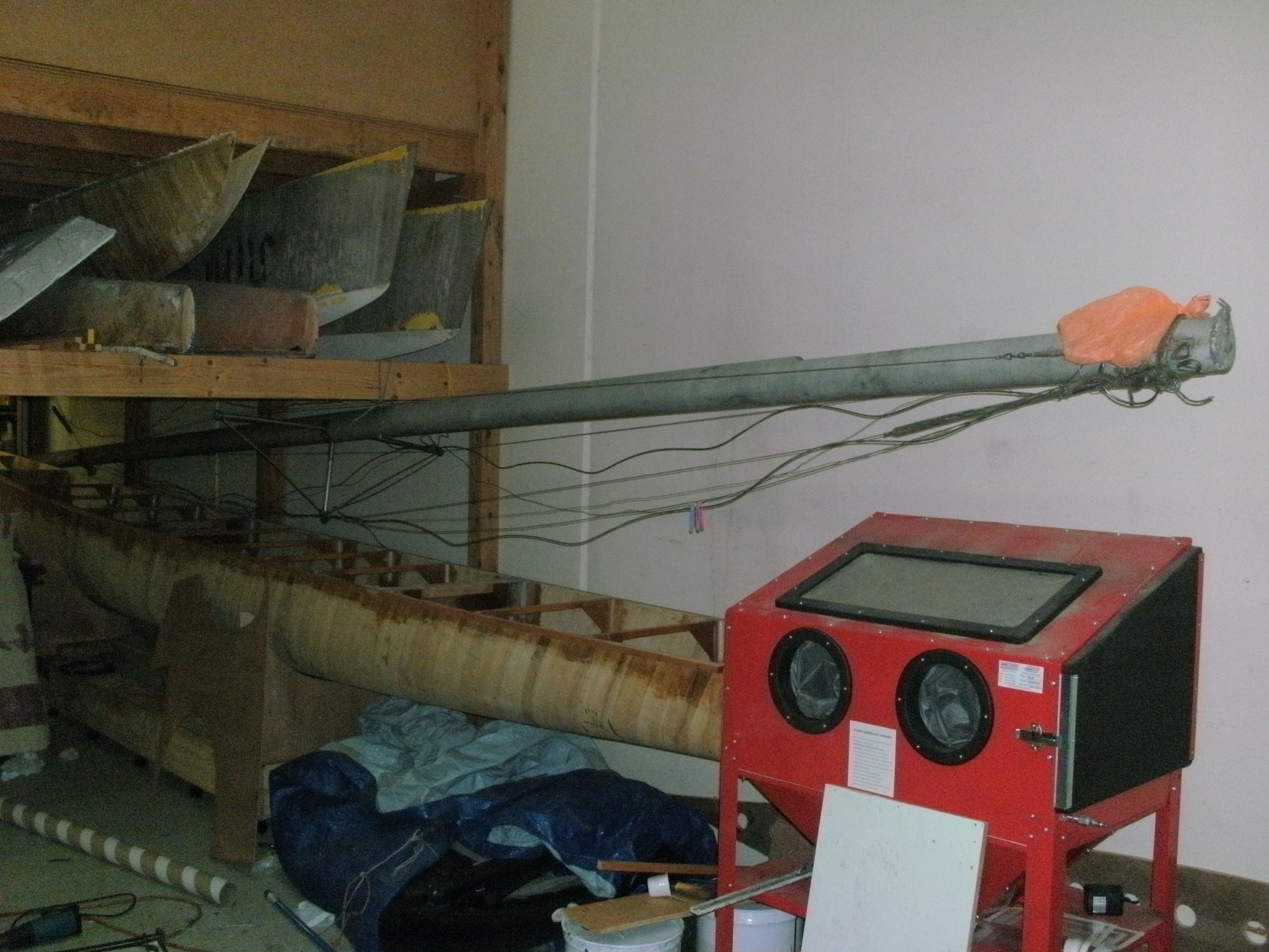

    I've retrieved the mast from storage. It all looks pretty good to be honest I'm wondering how best to inspect the fittings and whether it's a good idea to re rivet the hardware. I'm thinking of swapping some of the standing rigging shrouds/forestay and trapeze wires for synthetic. I've heard that it's best to leave the wires for the spreaders?
  3. Marmoset
    Joined: Aug 2014
    Posts: 380
    Location: SF Bay Area
    Marmoset Senior Member
    guessing spreader is stainless? looks clean
    Barry
