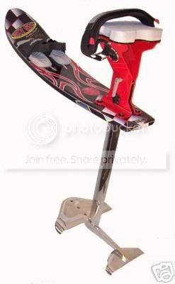

    So you’re saying that 80.5sq.ft. of SA (sail area) = 1sq.ft. of F(foil) area (ratio), or in kite measurement (7.8 sq meters) =1sq.ft. of foil. If this is true, than I believe that foil area could be reduced due to the amount of lift a kite would generate.
    From using the ‘air-chair’ foil (shown in the picture) Corey and I where able to use a 12m kite (129sq.ft of SA) in a 10knot breeze plenty powered with the ability to do aerial rotations.
    (Corey 185lbs)[​IMG]
    Granted a ‘boat hull’ would weigh more that a board, I’m not experienced enough with foils to size them up with a boat hull or in this case an ‘outrigger’. However I would say that the ‘outrigger’ would be considerably on the light side.
