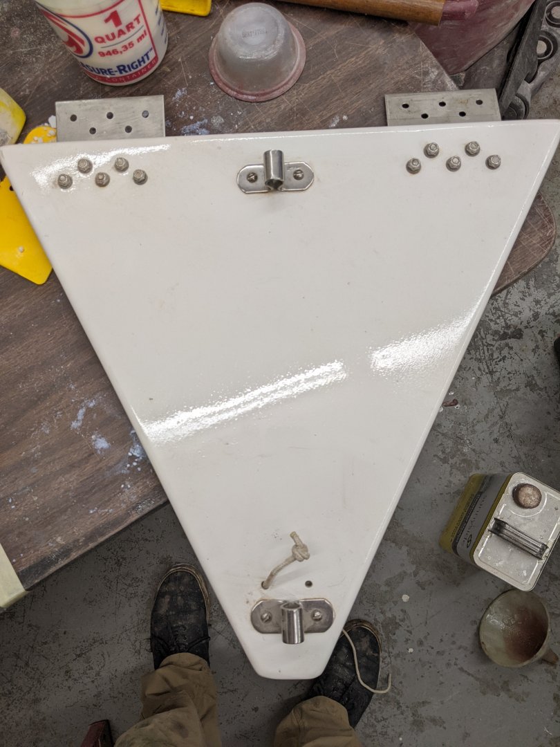

    I just verticalized the transom on my buccaneer. I'm building a rudder setup that is dagger style so it can be raised in shallow water, and also kicks up in a grounding. A regular swing rudder sucks to steer in a raised position, which sometimes I need to be when getting back to my slip. It'll have an aluminum cassette case, an epoxy/fiberglass coated wood rudder, and a false transom type setup to kick up. I'm also thinking about future t-foil on the rudder. But that's a different future conversation.

    My setup is still in progress. But here is a crappy drawing of what I have in mind. The hinge is a full width piano hinge and I will have to have a way to prevent side twisting.

    My seaclipper 16 uses the false transom with the hinge at the top. The hold down line works a little differently though. I can get you a picture if you're interested.

    Looking at the design drawing I would be concerned about the single central hinge and the hold down line.
    On the Seaclipper for example, the false transom runs almost the entire width at the top with hinges at each corner with the hold down line coming into the back at the bottom.
    With a single central hinge, I would worry about side loading and twisting, and with the hold down as a fence, too much potential movement.
    The rudder setup on my Tri is fixed into a plug that fills a slot in my transom to handle side loading and then uses a removable cross pin at the top to act as a pivot with a hold down line coming through the back. The rudder assembly can be pinned at a higher height for shallow water conditions, and can swing up if struck. It’s a little different approach but offers the same needs.

    PXL_20220104_153129471.MP.jpg PXL_20220104_153129471.MP.jpg Rberry I believe you are right same drawing. I've actually got the plans for the 36' less the full size patterns.
    Freddyj, here are the pics of the false transom they are pretty much as solgato described. We got snow here so may be a couple days before I get pictures of the transom.
    The first pic is the backside. The hole in the bottom right with the line coming out of it is the hold down the false transom is the same size as the actual transom less enough to fit into the recess. I agree on the hinge(s) they should be as far apart as possible and beefy. I ordered mine online. On the actual transom is a mating hole for the hold down. You glue a piece of stainless tubing bent up to the angle you want. You extend that well above the waterline by gluing a piece of rigid tubing over it. The sc16 has a slot in the aft deck the line comes out of to a cleat on the aft beam. HTH.

    Here's what I have IMG_20220211_141718013_HDR.jpg IMG_20220211_141713601_HDR.jpg IMG_20220211_141713601_HDR.jpg

    Looks good, nice job!
    Definitely doesn’t have the “hardware store” look of other examples.
    Is the locking pin at the bottom designed to shear when overloaded to allow the rudder to kick up?
