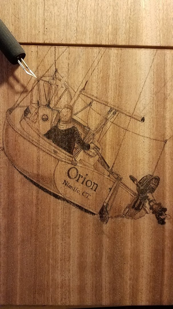

I am blown away by your work. Katie-J is beautiful.
I do art, a little woodworking, and pyrography. When I bought Dragonfly, my Mariner 19, I decided she needed new hatch boards and they should be a central feature of the Mariner's large cockpit. Your beautiful Katie-J has such a sweet main hatch, I hope you do something unique and special to show her off.
-Will

Hello Will
Thanks for your kind words.
Really enjoyed your art, thats some fine work there

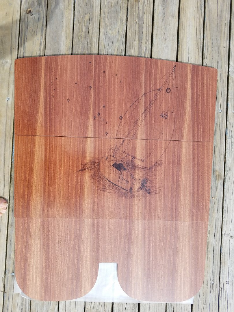

You are right about how iconic the main hatch of Pioneers 9 are and i intend to pay attention to it
A new one will be done of a single piece of good marine grade plywood. The boat is being refitted as a go anywhere boat, and in my book, if a thing doesnt have a second use , well, you either throw it away or you think harder about how to use it.
Maintaining it as a single piece will enable me to turn it into a table inside the main cabin.
When not in use as the main hatch or table it will be placed as the door between the main cabin and v bert. i will do that with some quick release hinges. 3 uses so far.
There is a 4 h and final ( i think) use for it. It will be the nesting place3 for a what a call a "passage table", ie, a similar countoured table but way smaller in area, to be used in the cockpit for passages, allowing for cup holding, screens, whatever other items
As for the aesthetics, i reckon it will be the only seriously varnished piece on the boat, with Epifanes products, and for sure the only glossy one as im a fan of the rubbed /satin effect.
Maybe i will get some idea (yet to form) suitable for CNC machining to decorate it by, playing with clear epoxy and pigments.
The boat will have a logo.
I didnt change the name of the boat because Katie J sounds just like a sexy sailor pin-up to me, so i reckon you can guess which way the logo will be. I have yet to find the artist but maybe you could contribute in that department, you sure have the skill set!!

Considering Katie-J's origins, I would be incline to do something like ancient Norse knotwork around the edge,
with Katie-J as a Valkyrie.
That distinctive hatchway does look like something a Norse dwarf from legends would craft.
-Will

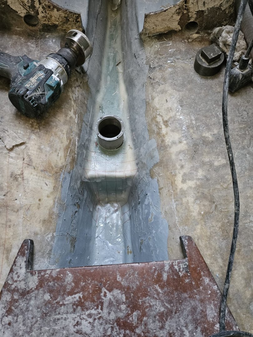

peek into the future
stb side cabinets cad plotting
after cutting the openings
lots more will have to be done until this piece is glassed in, mainly about the cabinets lids hinges and so forth, but this is a close depiction of the end result. i can say that im happy with the final volume created by the 6 individual spaces. much more than the original design afforded
closing the water tank
lining the fwd section with the appropriate epoxy based product
laminating the lids
as usual 2 layers of 400gsm biaxial cloth was used to tab everything together.
lids are done in 3mm G10 sheet
