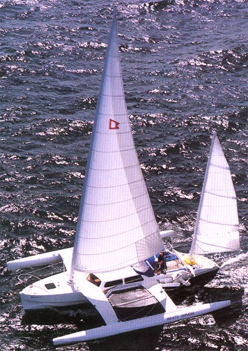

    I always liked White Wings, not junk rigged but a tri and free standing masts.

    That is one of the Newick's with the rotating Lungstrom rig, the sail opens into 2 for offwind area and rolls up on the mast for reefing. Dick's plans can be accessed through the Mariners Museum in Newport News Virginia. His own cruiser Pat's had 2 of these masts for a cat schooner rig.
    He also did some freestanding battened rigs but getting those sails cut to work with the bending mast was more of a chore. In any case sails like these don't have the turbulence of the offset junkmast or angled battens in the airflow. A wind tunnel would certainly help illustrate this, some of the current software should be able to look at flow and drag predictions.
