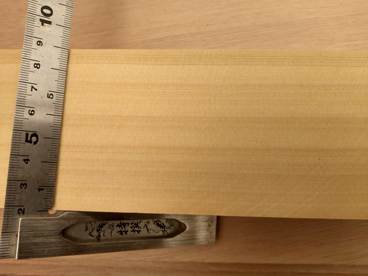

    All lumber is at nominal 2inch, most of it is near 5cm thickness. Just one large board is 4.5cm, few 4.6-4.7cm. Why i thought about planing or at least surface treating on tablesaw is to remove large grooves from a mediocre bandsaw that appears to be used. Probably i better ask for advice from Richard at this point, way too little to work with now and i will need every piece of wood i can scrap.

    Xellz, I believe your problem is a communication one.
    When you buy "nominal" wood the volume is calculated with nominal thickness and width and actual lenght. That means there always is a difference between nominal volume and actual volume. The weight you find in descriptions is "average dried weight" and actual weight usually varies.
    I don't know what your invoice specifies exactly regarding grading, but unless it says "grade A Select" a few defects are acceptable.
    Please recalculate your board feet and check the invoice for grading.
    Now for the practical aspects. Just sand the exposed faces with 80 grit to remove the offending toolmarks and be done with it. There is no need for the wood faces to be perfectly parallel, uniform and glass smooth. As fallguy said thickened epoxy likes rough wood better.
    If you need extra wood anything in the 450-550kg/cum is acceptable. I don't know what is available there but Douglas fir, all larches, all pines, all spruces are in this range.

    For sure, all those 4.5cm boards are considered 2" by Edensaw; standard for softwood is different than for hardwood

    I did calculate on nominal value too, but even if i was rounding up 5inch wide plank to 6inch (2inch steps) it still added only 7 board feet to my exact calculation. Where i'm missing about 80. Sure, weight varies, i understand this. But the difference i think is too large to cover this variation.
    In Japan it's hard to access clear grain timber, especially strong enough. I did search of course, but had no luck. Something that still possible to buy is about 380kg/cub, i.e. most common species, japanese pine. 4 sides clear is also ridiculously expensive. That's why i went through all this difficult and long process, started in last summer.
    CVG, so it seems one face is allowed to have small defects. I'm not sure if 1.5-2.5cm diameter knots counts as small, but this is a minor problem compared to lack of material. My order process was add 10% to required material from BOM then through mail ask if Edensaw can pull out enough timber based on my list of already processed timber sizes, i.e. how much 2x1inch, 1.5x1inch etc i need in the end. They said yes, they can, but because they don't cut to length/width or height the order increased by another 10% or so due to random length/width and stock is only available in 2inch thickness.
    For now my plan is to use thinnest plank as 2x1, i.e. 45mmx20mm finished is acceptable. So i'll go with suggested sanding only, first sand a bit then cut 1inch. It's 5.2 inch wide, so i should get decent 5 strips.

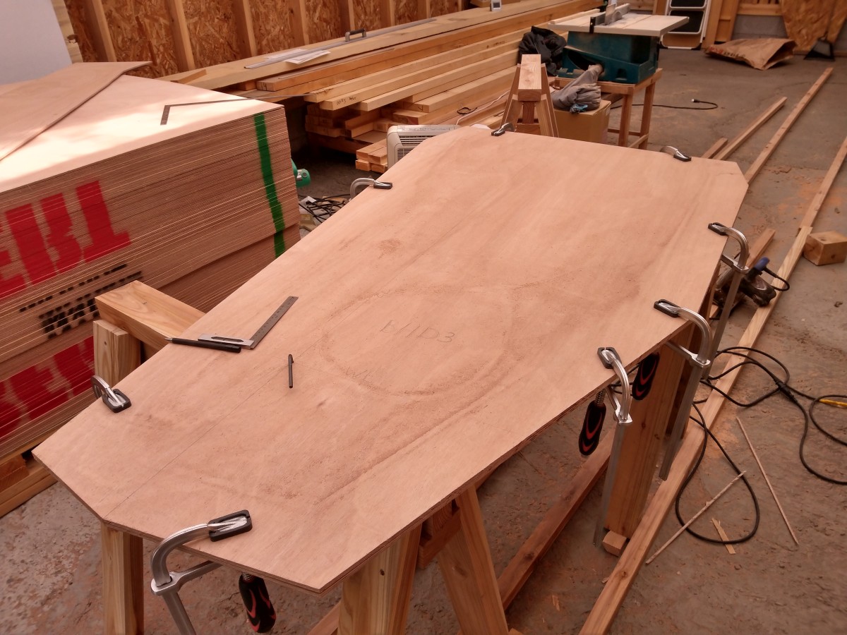

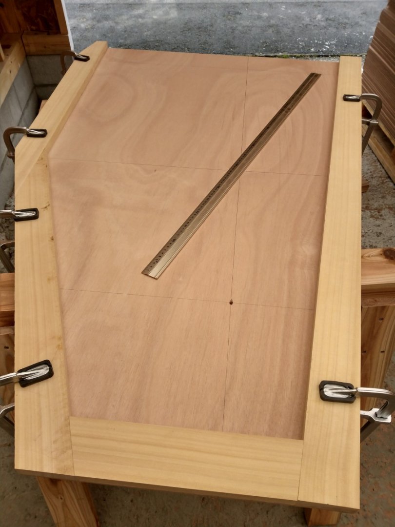

    So far i only finished cutting out all bulkheads and started cutting bulkhead framing. Speaking of which, once i started to read about epoxy bonding again i got kind of confused and now in doubt what is correct way. In photo bellow is how framing will be glued latter. Originally i thought it should go like this, wet-out with epoxy both surfaces, apply thickened epoxy apply pressure. In my case, stainless steel fastenings used. But is the thickened epoxy really needed unless surface is really rough? And is there any reason not to use yellow cedar saw-dust collected in table-saw bag as fillet?

    Epoxy is not an exceptionally good flat surface bonding material because clamping pressures are very good at squeezing out the epoxy due to viscosities we enjoy for wetting glass out.
    The ideal bonding/filler agent is fumed silica or cabosil or aerosil. For a project your size; you would need about...-20 pounds. I am around 25 pounds on the Skoota.
    wood sawdust can work, but large wood particulates leave voids which can collect water and have the potential for ingress,,,can be done
    Personally, sawdust tends to be hard to get to lay down smooth. Do not use it between stacks of timber and ply.
    For most of my wood stacks; I use a 1/16" vee trowel. I just did today and ran 24 oz epoxy. I usually run my batches at about 2.1 parts cab to epoxy by volume. So a 10 ounce batch of epoxy would get 21 ounces of cabosil...start lower and adjust as you see fit...I mix all my thixo on a board to make it more homogenous and prevent early kicking by keeping the epoxy in less than a 100g mass. It is also easy to slump test the mix. Pile it up and if it sags; you are too thin.
    wood is resin thirsty as well,
    All wood to be bonded requires prewetting to prevent dreaded drysucking of the joints...get some very cheap 1/8" nap rollers and cut them down to 3" and use them on a 3" roller frame. Roller drink the costly resins; so prewet and squeegee out the epoxy before pitching the rollers. They are not reusable. The squeegeed epoxy can be used for some of the thixo if you work fast.
    So, here is how.
    1. Prewet both surfaces to be bonded. It helps to label things to avoid prewetting wrong sides. Prewet at a rate of 2oz per sqyd of area. Get medicine cups for tiny batching.
    2. Apply thickened epoxy to the joint; I generally use the 1/16" v trowel. For vital strength items like beams, both sides should get thixo. For something like the BH timbers; one should do it as long as you prewet both surfaces.
    3. Clamp. Never too hard. Max vac pressure is about 10" HG. 9 is better, but I can't control that low. Absent vac; use clamps, but avoid overclamping. A 1/16" vee will result in about 0.032" or so glue joint.

    My only comment to fall guys about rips is this. Speaking as a 35 year carpenter, I make my rips with a skillsw, or circular saw. Long accurate tips with a table saw are possible, if you have an extended deck, which requires huge space, and a feather board. Otherwise they are extremely difficult. I have a really cramped shop.
    I built a tiny shelf on one wall, and I screw my stock to that through one edge, so it sticks out from the wall like a shelf. I have a couple skillsaws, so I took one that's battered, but with good bearings, and I screwed a long smooth block of wood to the underside, so it can only make 1 width of rip. My helper, an absolute beginner, can make perfect rips consistantly at ⅝". About 1 a minute from a 2*10*16. No skill, no space, no cost. Perfect pieces.
    I also finger fingerjoint the ends of each board before ripping, because its enormously faster and less wasteful to fingerjoint than to scarf.
