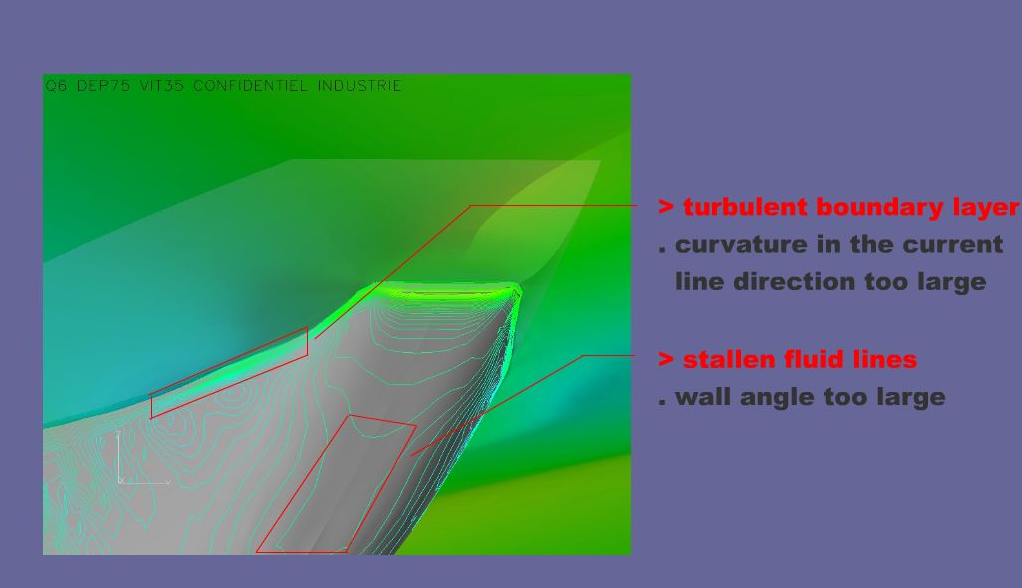

    This suject reminds me a study that we've made for a racing catamaran 120' Q6. This study has been conducted in the Engineering laboratories of CENTRAL NANTES, which were in charge, with the same code, of the simulation of our french warships. NextFlow, developing next-generation CFD software - Centrale Nantes https://www.ec-nantes.fr/who-we-are/partners-and-networks/nextflow-developing-next-generation-cfd-software
    Induced forces of lift were to be balanced for our new hull (Y-momentum stands for Pitch momentum). The basic idea was that, playing with the slope counter (back) angle of the hulls, around the average awaited speed, will allow us to generate a lifting force in way of transom.
    We compared Q6 with the preceeding hull forms, which have already broken the record we were to push out of his limit again...) First results were encouraging, but not satisfying at greater speed than 30kts.
    We analysed in details the results. The drag curves around the hulls showed that we should have to make our focus downstream !
    As an aeronautical engineer, I checked the skin friction coefficient value (Skin-Friction Coefficient - an overview | ScienceDirect Topics https://www.sciencedirect.com/topics/engineering/skin-friction-coefficient) without approximations, but truly in exploiting the local values of the U field to calculate ∂τ/∂y. NO APPROXIMATIONS OTHER THAN THOSE INTRODUCED BY OUR FINITE ELEMENT ITSELF.
    The diagnostic was direct. We could identify the regions of the hull responsible for the generations of the effects, or forces, that we wanted to get rid of. From this study, we made the definitive hull forms, making the geometrics changes that were required.
    We spoke over the force, over the media (too much of a little, because it doesn't seems to put anyone in distress in this conversation the fact that, being stuck to Bernouilli shouldn't allow to speak of real fluids at all...but...anyway.....). We should also speak about the shape, because there is no induced force without a proper shape to create it.
