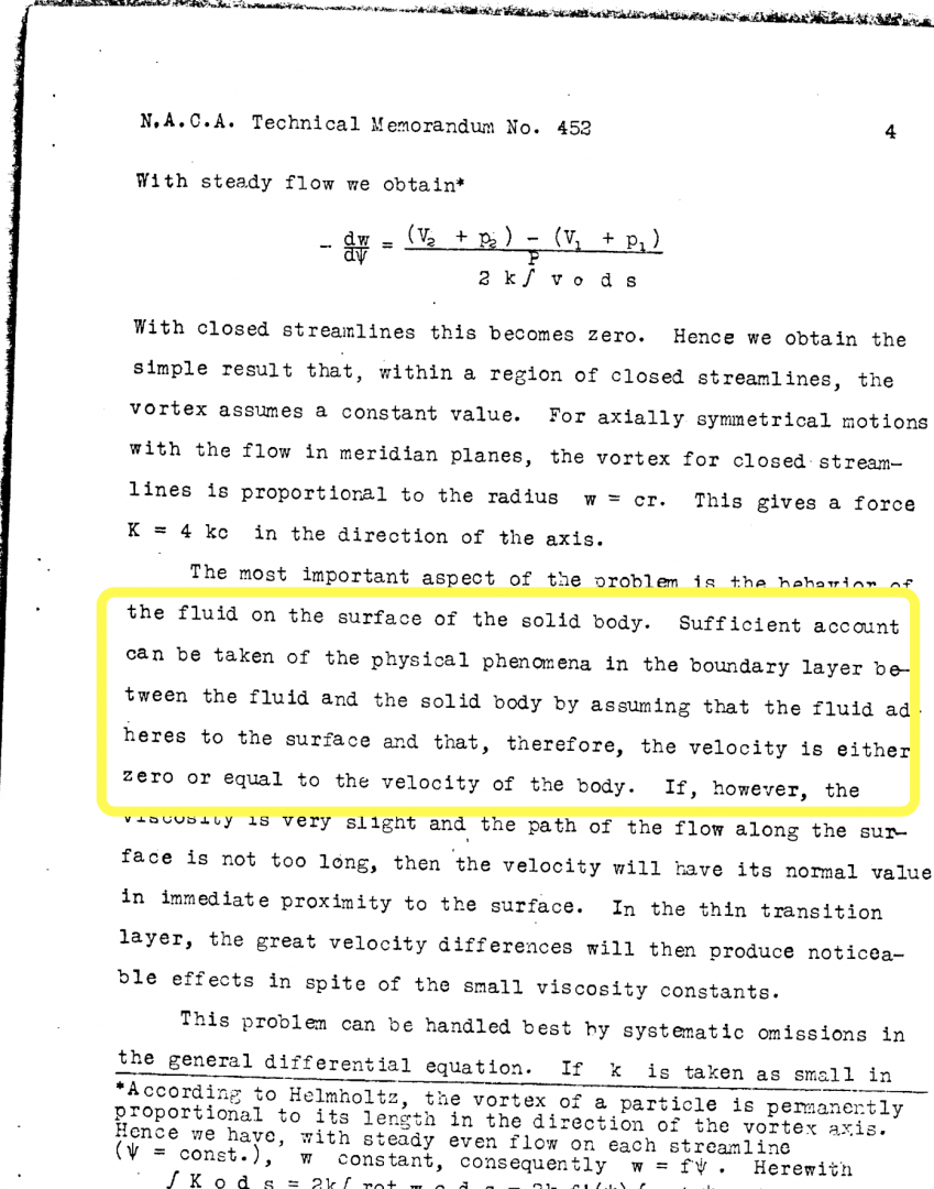

    Actually, no, that's not the the case. Here's the quote from O.G Tietjens translations of lectures by Prandtl in Fundamentals of Hydro- and Aeromechanics:

    You would have to take a microscope in polarized light to see the bunch of water molecule glued to the wall.The water molecules near the wall do not move, so there is no accumulation at the interface. It may be more evident @3.00, in this other video.
    Inside the boundary layer, the flow has a "U*"(traditionnal notation) velocity component, that drives the white bubbles and prevent them to accumulate. The viscous forces elongate their traces inside the boundary layer. What is to be observed here is the shape of this elongation. Prantl's postulated that the "non-slip" condition correctly reproduces mathematically this shape.

    Your assumption is completely wrong. Boundary layers have been the subject of very extensive research since the early century, and that research continues. The structure of boundary layers and the interaction between solid surfaces and fluid flow including the validity of the "no-slip" conditions have been probed innumerable times using many methods including hot wires and laser anemometry.
    The no-slip conditions is valid until you look at length scales comparable to the mean free path of fluid molecules between collisions with other fluid molecules. At that level the general treatment of a fluid as a continuum also becomes invalid. The behavior of discrete molecules need to be analyzed. By the way the mean free path of molecules in air at sea level atmospheric pressure and density is around 60 nan0meters or 0.00006 mm, which is around 1 / 1000 of the diameter of a human hair. So in other words the no-slip condition is a valid approximation for virtually any purpose other than in very rarified conditions such as on the edge of space.
    D'Albert's paradox is that the inviscid and incompressible flow around a solid object does not produce drag unless vorticity is somehow generated by the object. The no-slip boundary condition does not enter into it. What Prandtl's division of the flow around airfoils, etc into an outer potential flow away from solid surfaces and an inner boundary layers near solid surfaces did was to provide a framework for understanding that how vorticity was generated by solid surfaces and shed while the flow away from the surfaces and outside the wake was inviscid and irrotational, and to then make calculations.
