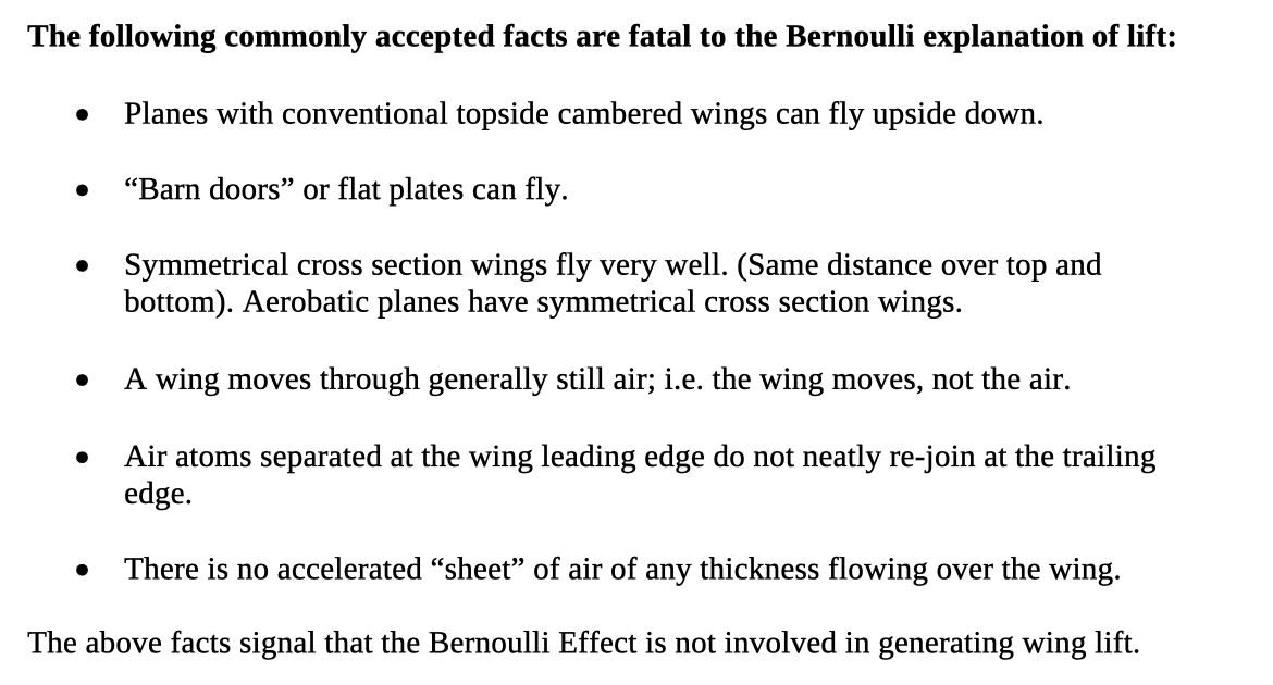

    Just to keep this thread ticking over, I thought I'd offer this little gem.
    The link to the paper that started this thread is now dead, but I have tracked down a copy here
    I realised author is clearly a nutter on Page 3 when introducing us to vortices, he offers:
    "Electrons are said to possess spin, contributing vorticity to atoms and molecules. These in turn form part of larger vortices such as ocean and atmospheric currents."
    I then identified him as a director of a pump manufacturing (now defunct) business located in Queensland, Australia. Whilst he titles himself as Dr. Day, I suspect it's more to do with his qualifications as an osteopath and acupuncturist than it is to do with the hard world of science.
    However, before proceeding with his bizarre explanation about how Circulation generates lift through a form of "pressure impulse" that is transmitted by diffusion, he does make some very prescient observations on Page 3:
    I'm not the first to suggest that there's no acceleration of airflow over the wing and Bernoulli's theory has nothing to do with aerodynamic lift.

    While (for some reason) you may never accept the validity of Bernoulli's equation, perhaps you'll have any easier time with continuity (The mass flowing between adjacent streamlines stays constant.)
    If so, then you have to agree that the bunching up of streamlines on the upper surface just aft of the leading edge shows larger velocity and the spreading out of streamlines on the lower surface shows lower velocities.
    I'm anxious to see if you will try to claim that compressibility of the flow invalidates my conclusions or that smoke trails don't count as experimental evidence.

    It is not true that I don't accept the validity of Bernoulli's equation. Of course I do, it has been scrutinised by scientists, mathematicians and engineers for hundreds of years.
    What I don't accept is that it applies to the air flow over a sail of a yacht or the wing of an aircraft.
    And whilst I believe there are multiple reasons for that, the one that I think is most revealing is its requirement for an increase in the speed of the fluid to generate a low pressure.
    As I said, this is one of the reasons, but from a purely logical point of view, if a theory fails on a single reason, then the theory fails.
    It is for this reason that I have pursued this line of argument and why the issue of whether the air speeds up over the top of the foil is so important to me.
