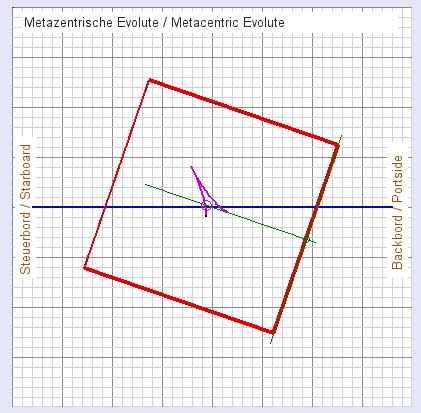

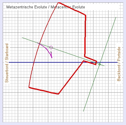

    The linked paper shows the movement of the (true) metacentre (page B-100). This leads me to an extension of my calculation sheet by a diagram showing the locus of the metacentre (0 deg. to 71 deg.).
    (Locus of metacentre: violet curve, WL: blue line, cross section of hull shape: red line, heel: 71 deg. )
    Not only a sqare prism shows this curve, but also a boat shaped hull.
