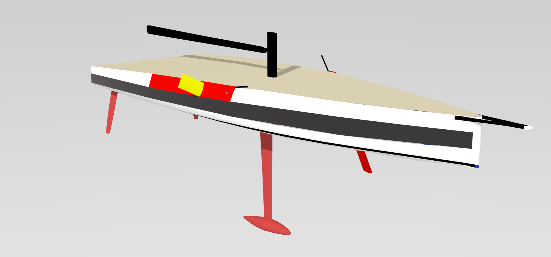

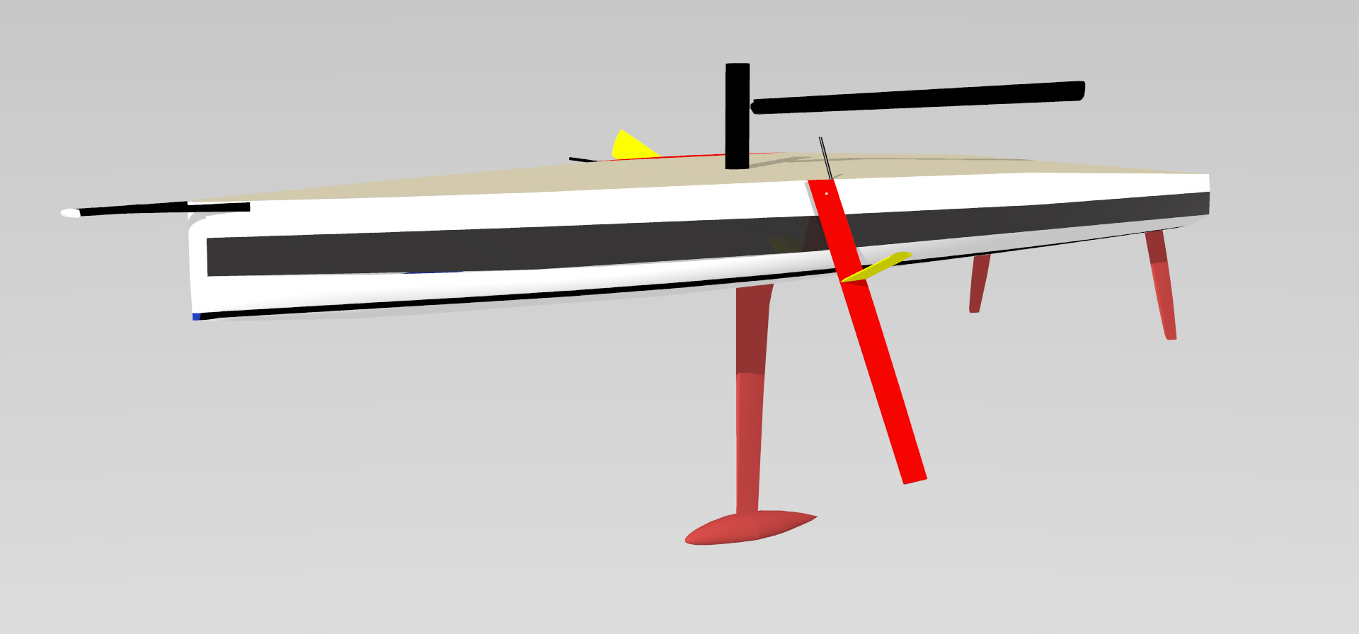

    This is a radically new set of foils for Bastide Otio with an interesting story from The Foiling Week. http://www.foilingweek.com/blog/2016/03/des-foils-pour-bastide-otio/
    The studies were conducted by a small group of experts in the aviation industry, discreetly. The idea was to do differently from the other 60 'equipped with foils in 2015 and to have independent thinking, without any pressure. Computers and brains were heated for weeks to create an original, simple and hopefully effective.
    The team of researchers, led by Laurent Prunet, worked to significantly improve the performance of Bastide Otio downwind without degrading them into the wind, which can represent 30% of the conditions encountered in the Vendée Globe.
    It is simply to add foils existing drifts, allowing in particular to use the two appendices downwind to lift the boat and get on plane. On the contrary, when the drift is rising, the carrying surface is flush with the hull not to slow down the boat in light air, for example, where we saw the new boats severely handicapped.

    Cool upgrade of an Imoca :cool:
    It's quite near the configuration of the 888 mini transat :
    I think too that upwind performance in light and moderate winds can make a difference, like in the last Transat Jacques Vabre between PRB and PB VIII.

    Good point-very much like 888!
