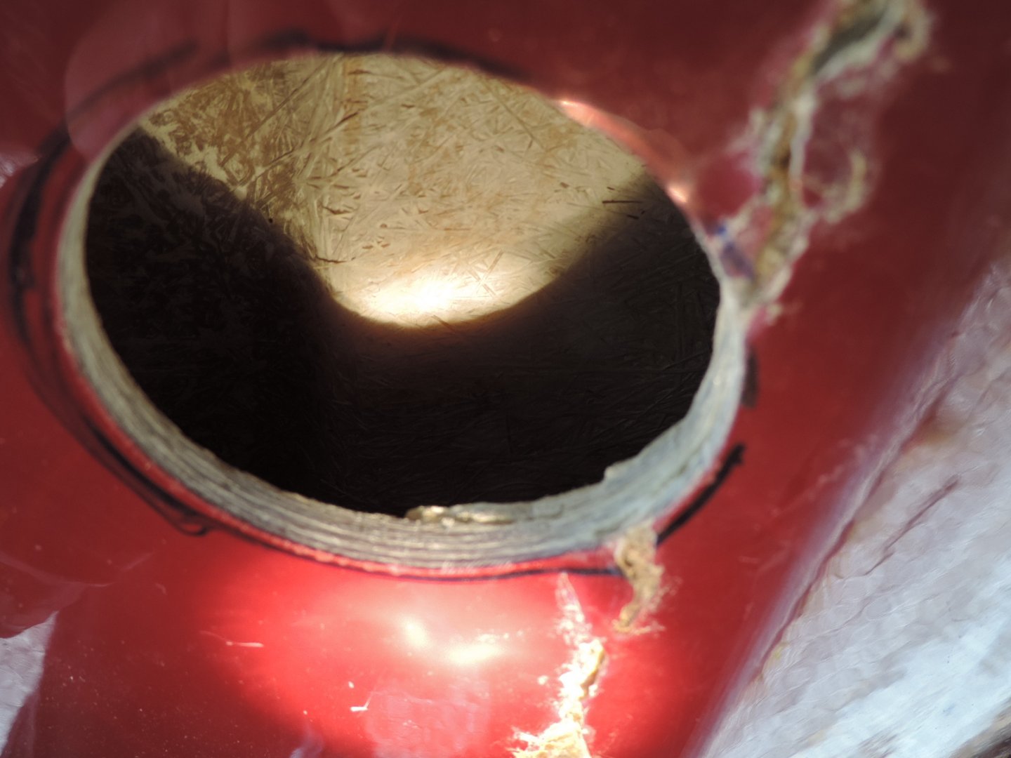

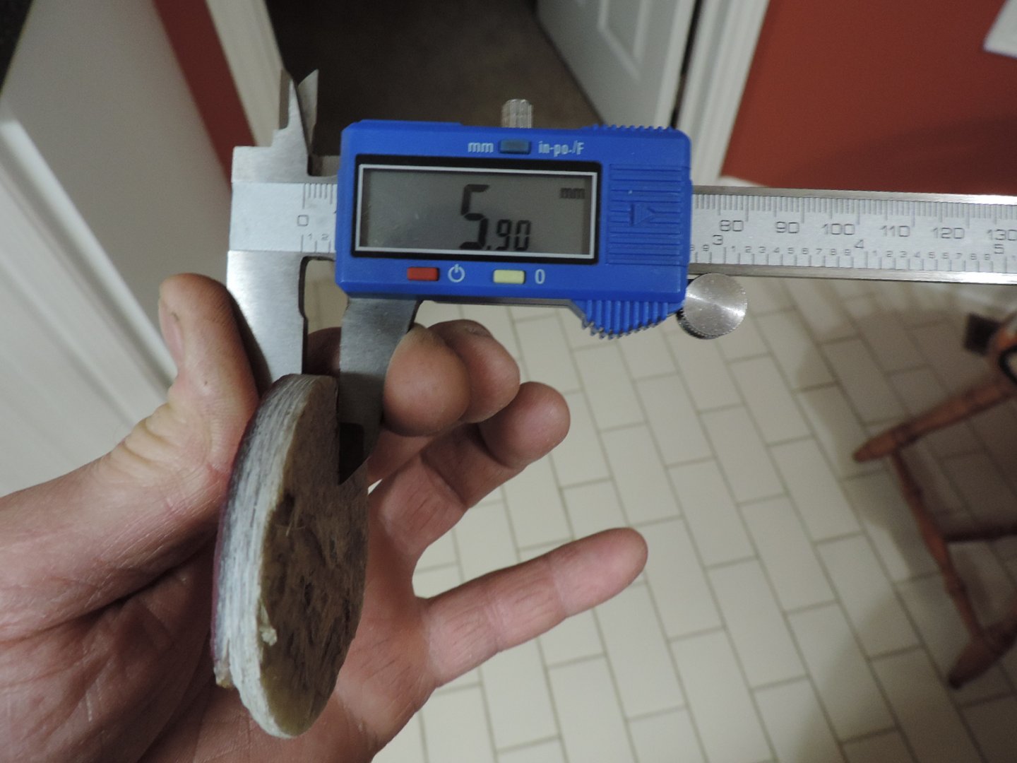

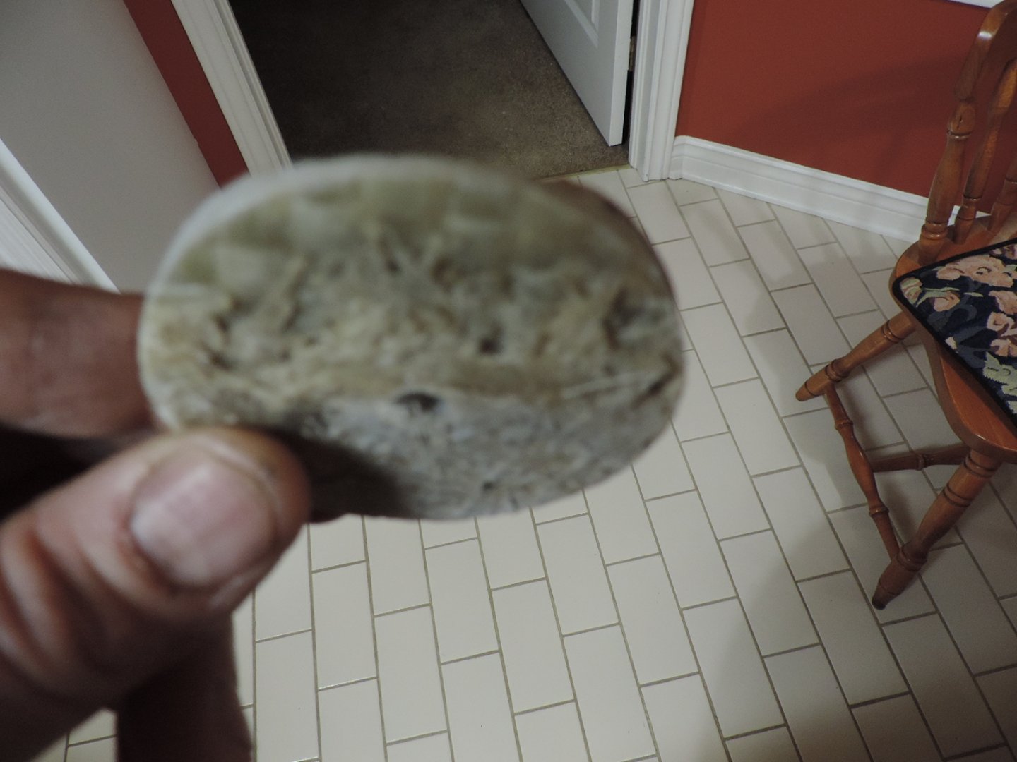

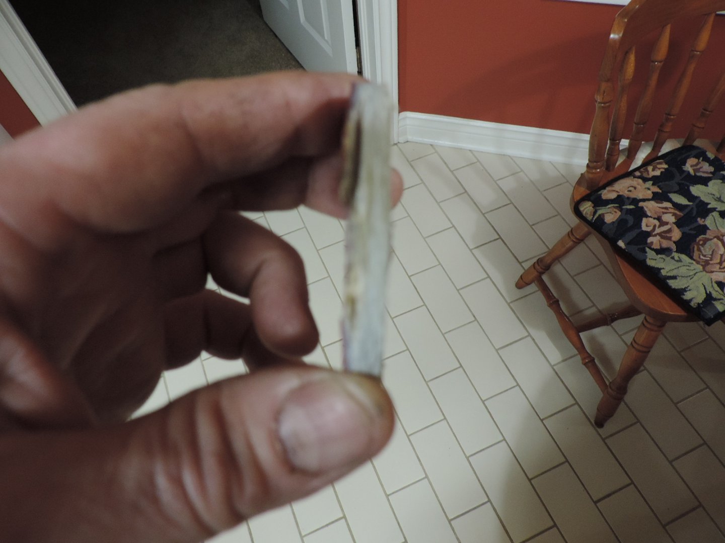

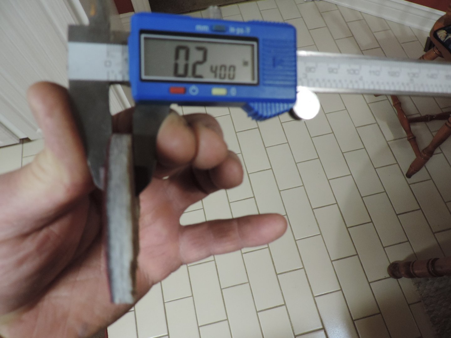

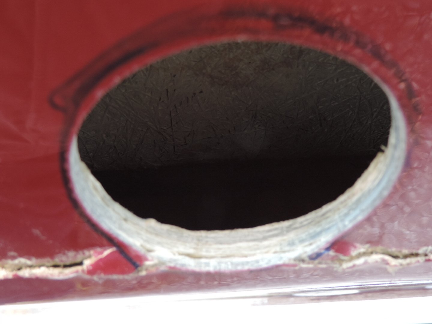

  15. bucketlist
    Joined: Nov 2020
    Posts: 31
    Likes: 2, Points: 8
    Location: London Ontario
    bucketlist Junior Member
    Update . hull core cut out . Cut on edge of the large crack , close to the keel V . I am surprised at how thin it is . I thought it would be built up a bit at the V center point . Funny thing was , when you stick your finger inside toward Starboard , then thumb on outside and pinch - it feels a fair bit thicker . I can't see a separate core in the middle . There is a flat fiberglass panel , 2 '' above the cut out . I think it is a support panel for the waste tank . Only way to get tanks out of way is to cut the floor out or disassemble boat . -- Opinions ? I am working toward a repair this winter . Thanks
