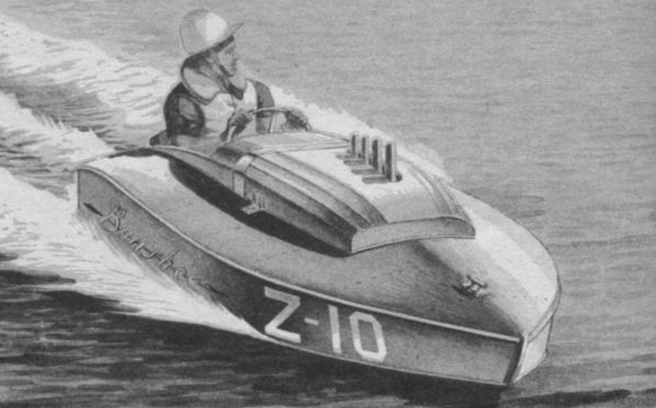

    Fifty or more years ago before the advent of jet based personal watercraft
    I seem to recall all kinds of plans in magazines such as Popular Mechanics for
    tiny run-abouts and tunnel hull inboards and outboards that you would build
    from plans. I have not followed real well the evolution of PWC personal watercraft
    but the ones I have seen lately have a lot more hp than all the boats my family
    had growing up that we would water ski behind and zoomed all around the lake in.
    That and the fact that I remember as a ten or twelve year old I even
    skied behind my grandpa's fishing boat that had only 35 hp and it was just
    me an him on the lake. So I am therefore led to believe that the jet
    drives are MUCH less efficient and probably became popular because they
    did not want kids swimming around small boats with props exposed to
    sever limbs etc. Today our little industrial engines from Briggs and Honda
    have made great strides in that the largest V-Twins are up in the low to mid
    30 hp ranges now and I think a small little wooden boat with an inboard
    lawn mower engine could be designed ( redesigned ) to again zoom around
    a lake at least 35 or 40 mph or more. The other great benefit would be
    the fuel savings for a whole day at the lake of using 35 hp instead of 150hp
    as exists on a lot of the PWC.

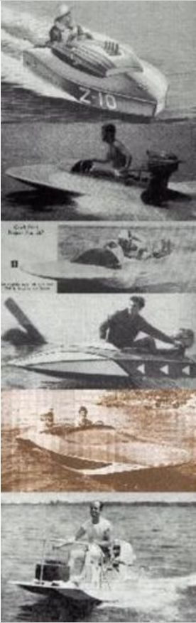

    I have actually found a few pics on the old POP MEchanics mags etc. and will try to attach a few.
    Also I went to a few of the big boat plans websites and found a few 11 and 12 foot
    plans for homebuilt inboard boats. One boat was even smaller and would get up
    onto plane with one person while using only a ten HP outboard motor.
    18mph I think they said it could go. not bad for just ten HP.

    What ! Not a single comment about the photos I attached. Are all
    you guys heavily invested in PWC companies or what? With the price of
    PWC up in the 20K and 30K thousands of dollars.... how can there not be
    more interest in smallish homebuilt boats ? I also liked those teeny tiny tunnel
    hull mini racing boats but perhaps they are using small outboard motors.
