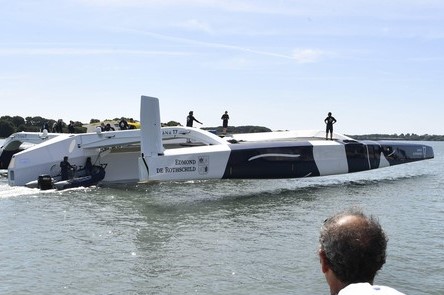

    ... as visible on this photo of G Gitana17 launch.jpg itana 17

    On this interview of G.Verdier in 2017 by Voilesetvoiliers, just after the launch of Gitana 17, there are 2 answers in relation with hulls shape. Here the proposed translation of these two Q/A + the full text in French with small sketches about the cylindrical versus U hull sections issue :
    Voilesetvoiliers.com : U-shaped hull shapes are very pronounced. This drawing is very original ...
    G.V. : "Not so exceptional eventually : it looks like what we did on the AC72. We know that a spherical or cylindrical shape offers less wetted surface but it has a huge drawback : under 10 knots speed, it is sucked down. At 25 knots we doubled the mass of the boat in suction down ! So let's get rid of it and adapt what we know, from a water ski for example. Finally flat bottom shape avoids this sucking. This makes much lower dynamic mass. "
    (see sketches in the interview here below) : "These sketches explain the interest of flat bottom floats. According to the creators of the trimarain (?), they create a lift, avoid being sucked down, increase the ability to fly and provide excellent stability in rough sea."
    Voilesetvoiliers.com: And also allows more easily the lift ...
    G.V. : "Exactly. And even when he does not lift, he sinks less! This has the disadvantage of more soliciting the structure. There, we took a step compared to what was done before. One of the peculiarities of the trimaran is that we think that, to have a better control of the boat and the appendages, a rather rigid platform is necessary. We started from what had been initiated in multihull by Nigel Irens with very flexible shapes that allowed to well pass in rough sea. It was the « flexible-soft ». When we imagine foils of such size, we can no longer afford to have structures that are poorly controlled. Although it is very interesting to be flexible when you start flying. But, if we want to transform the propulsive energy into speed, with shapes that generate such deformations this propulsive energy will go into a twist and that's not good ! We departed from this approach for that reason. Which explains why the floats are big enough between the arms. We have arms that are closed rectangular boxes while before it was I-beams more sensitive to torsion. We wanted to minimize the unknowns because it is very difficult to calculate a flexible structure. And as we are not very smart we went to what we master in terms of calculation.
    Below, we have a slightly inverted hull line, for hydrodynamic reasons. When we get closer to 50% of the displacement of the boat we end up with a more appropriate hull. It's to help take off."
