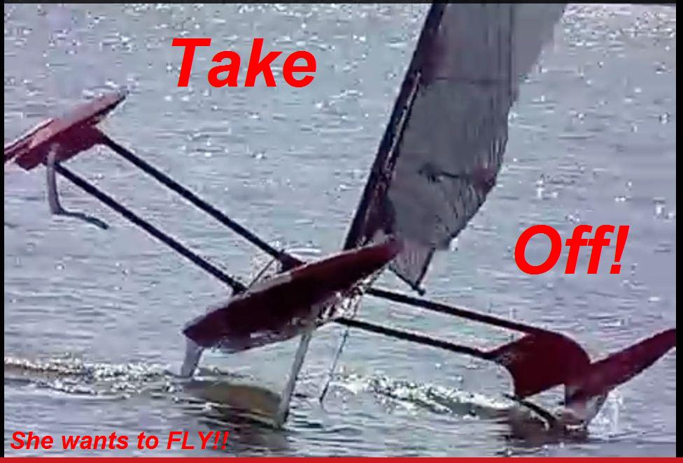

High Performance MPX Foil/Self-righting Trimaran-The Test Model
Fire Arrow Variation and Fire Arrow
Its so shallow here-do you have any ideas how I could deal with that better than I already am?
In the first tests(2nd day) with the Fire Arrow model, I had inadvertently made the main foil wands too long and the ama foils didn't have enough area. And the rudder on the boat had too much authority. The result was that the thing would jump clear of the water, pitch up and mush back down as the foils stalled and even though that second test overpowered the rig substantially no capsize -not even close. However, she did do a beautiful 45-50 degree pitch pole*, righted herself and sailed away. The "two stage ama" and crossarm dihedral allows there to still be lots of righting moment up to and a little past 90 degrees.

I don't know how you can improve your situation, but perhaps there are some advantages that you haven't thought of.
When I was a kid in St. Petersburg, there were some knee-deep flats that were great for sailing models. I could be right there with them, instead of on-shore. These were free-sailing models though, so there were no worries about getting an RC controller wet.

I'm not concerned about the model or models-just the fullsize version.... Pounding the foils or side of the ama into the bottom is worrisome. I guess the best answer for shallow water is to make it as hard as possible to roll past 40-45 degrees?
Fire Arrow Variation-full size
I've done some preliminary design work on the Variation based on the Fire Arrow using Welbourn -type ama hydrofoils instead of uptip ama foils. No decision about going ahead with a crowd funding proposal yet but if I build anything in the next three years it will likely be similar to this. Primary goal is extreme comfort and excellent performance including takeoff in around 5 knots of wind. The boat will have very shallow draft between 2 and 3' off the foils and less when flying. The boat will be able to sail without the lifting foils-though not as fast.
LOA 14'/4.27m
Beam 8'/2.44m
---beam with ama foils deployed 15'/4.57m
Weight-
--- boat ready to fly minus crew--190lb/81.8kg
--- boat + crew--380lb/172.7kg
Sail Area-
--- upwind-150 sq.ft./13.9sq.m
--- downwind- 270sq.ft./25sq.m

So far in the limited model testing I'm convinced that the dual wand* controlled main foil works best because it's 100% automatic and requires no crew attention.
In the last test of the model, the foil system ,including the wand controlled main foil, worked 100% perfectly in light air foiling.
* one midship wand on each side of main hull-windward wand clears the water when flying.
