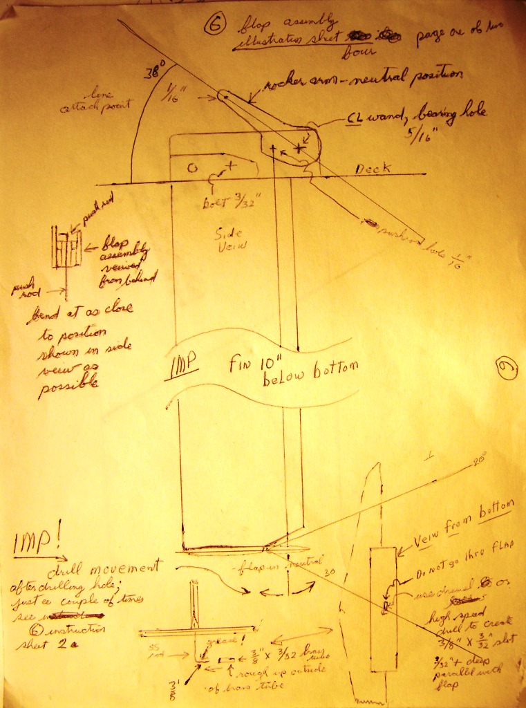

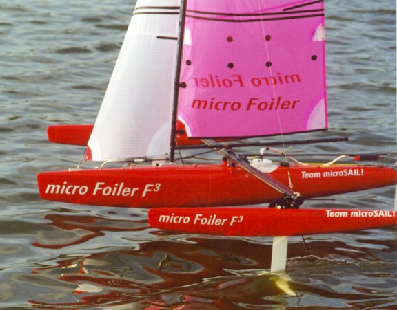

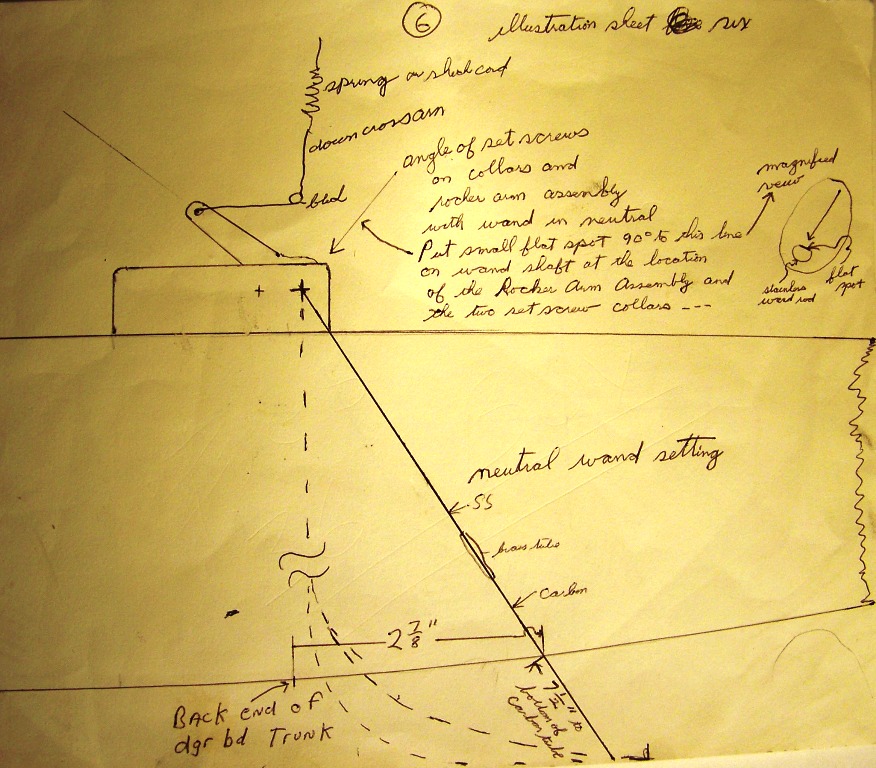

    Great , Ian. From what I could tell it seemed that the flap might not come up enough? For what its worth: on the Rave,Osprey and F3 the flaps are set at 30 degrees down and 20 degrees up. The angle of incidence of the main foil(flap neutral) was +2.5 degrees and the rudder foil was set at zero degrees-all relative to the flight waterline(which was parallel to the static waterline after takeoff).
    The tension on the bungee/spring was greatest when the flap was up: water pressure on the wand keeps the flap down(vertical lift) but keeping it up for downforce requires tension from the bungee/spring to overcome water pressure on the wand......
    Original F3 wand set-up sketches. I used partial span flaps.Flaps attached to foils with thin mylar sheet molded in. Note how angle of rocker arm is such that effective tension on the wand increases as the bottom of the wand moves forward. F3 weighed 7+ pounds(56"LOA-72" Beam) , main foils carried 80% of the load, each main foil was 17 sq.in., foil loading was .188lb/sq.in at takeoff:
    click-

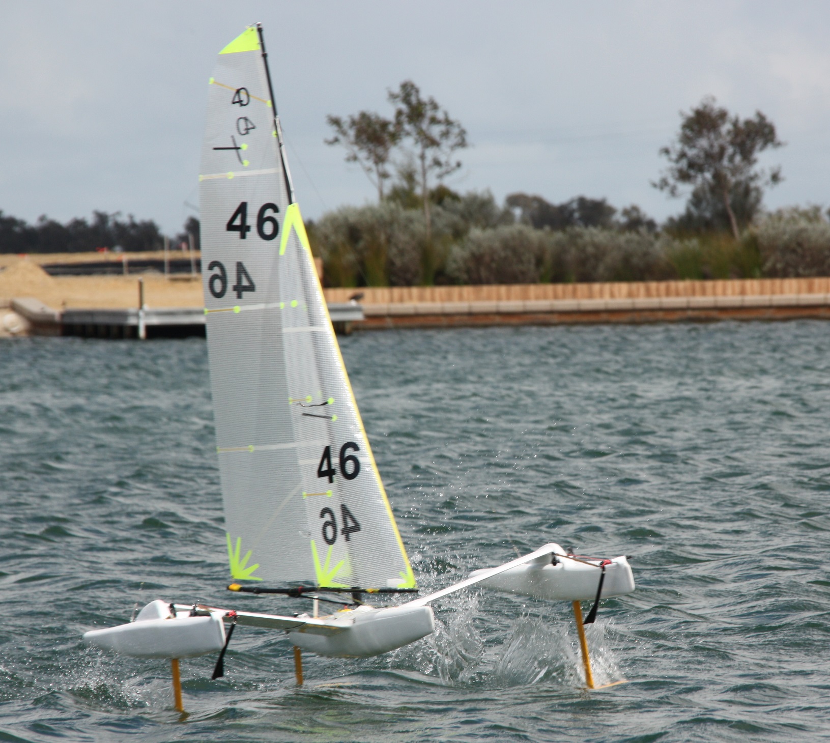

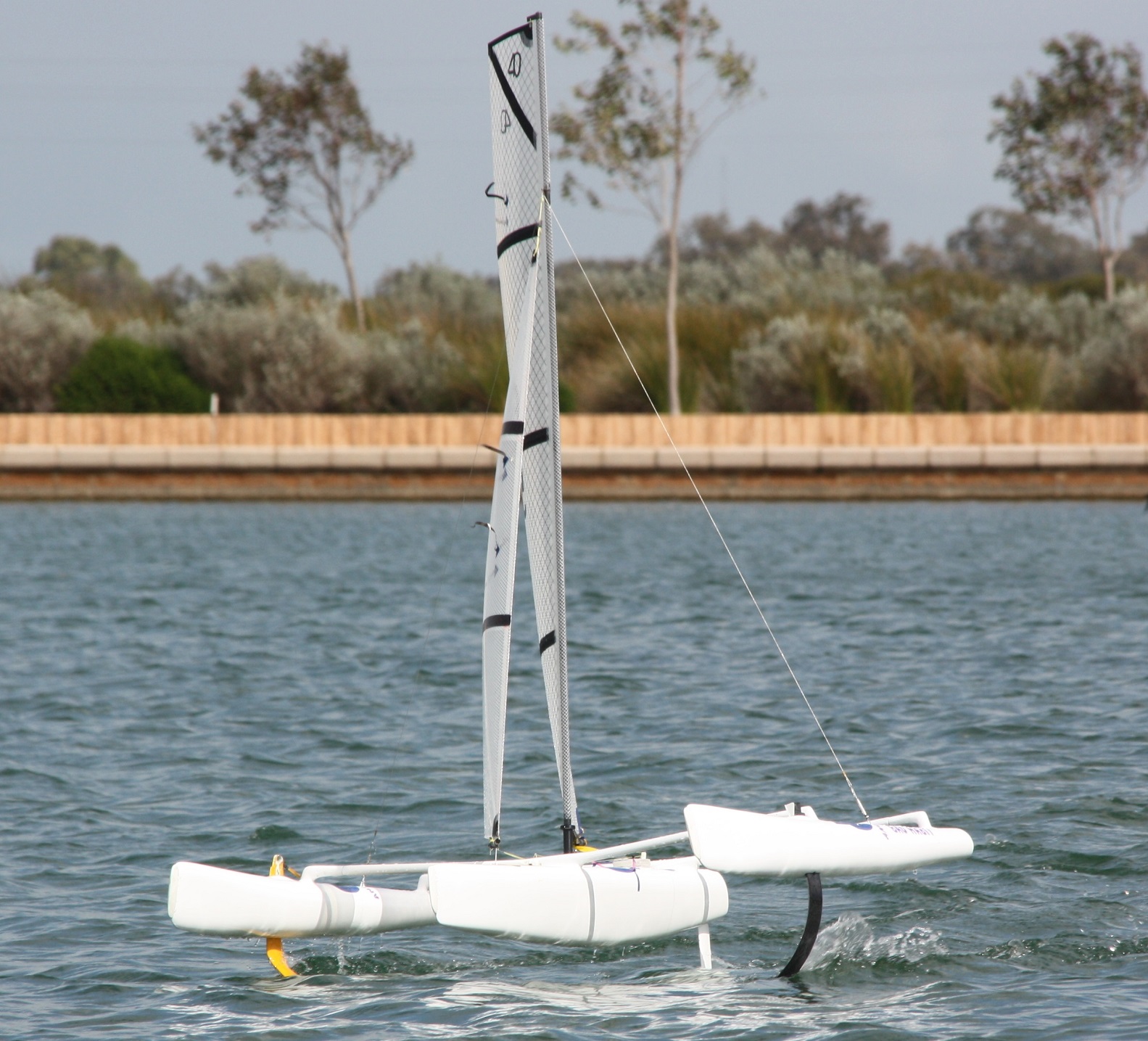

  4. PerthMini40man
    Joined: Jan 2014
    Posts: 117
    Likes: 35, Points: 28, Legacy Rep: 48
    PerthMini40man Senior Member
    Foiling Mini40

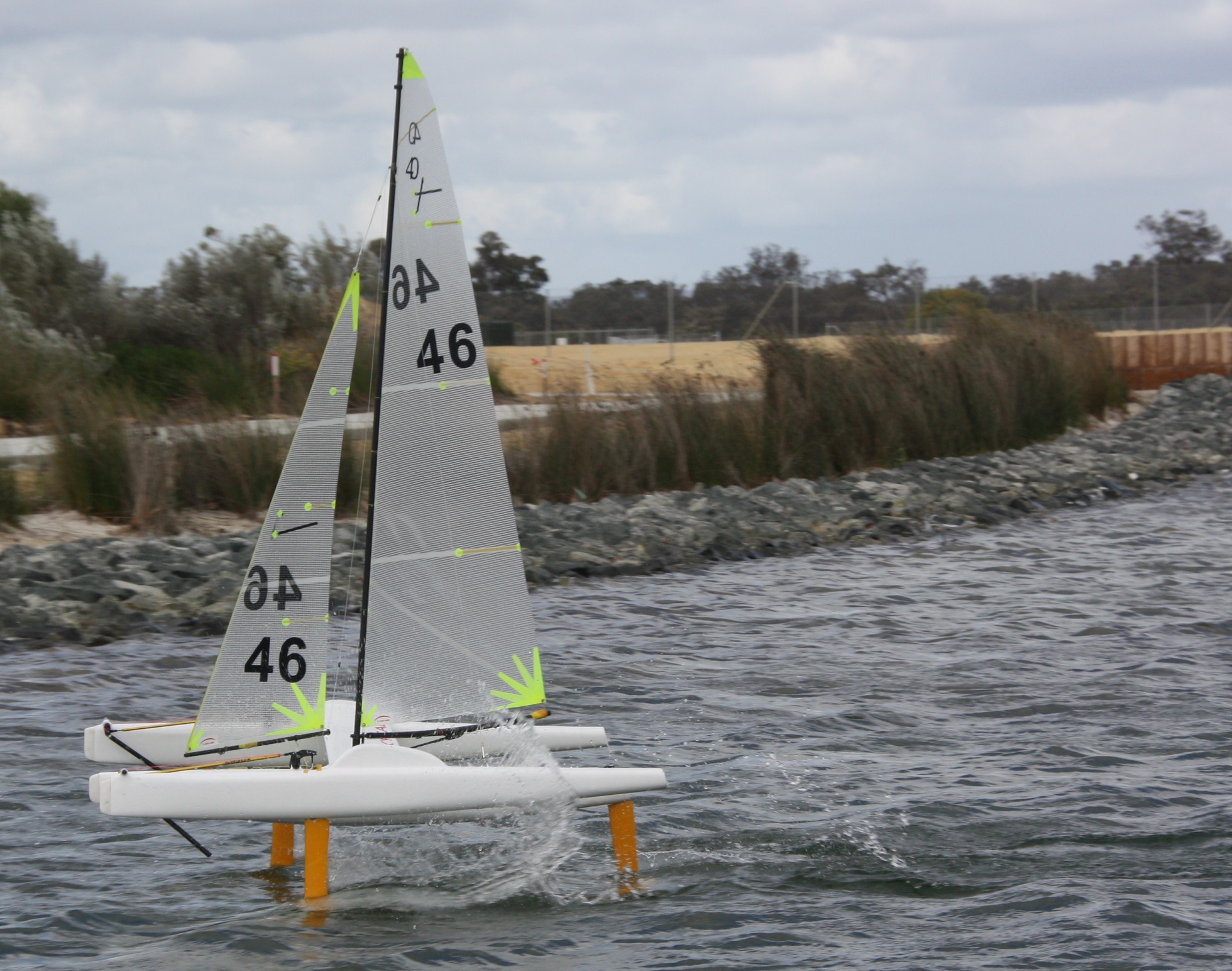

    Second sail, in much lighter winds. I have sorted out the port foil - the fixed part of the foil did not have any positive angle of attack, so I have rectified this and in fact the boat now foils more evenly on starboard tack than port tack. Late in the afternoon I also reduced the pull-down force from the T foil on the rudder and this helped a lot, with lift-off much more even when it gets up onto the foils. Proving very useful to be able to adjust the angle of the rudder shaft.
    https://www.youtube.com/watch?v=HrArHjsw6NQ&feature=youtu.be

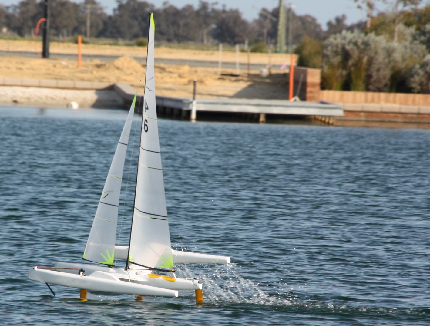

  5. Doug Lord
    Posts: 16,679
    Location: Cocoa, Florida
    Doug Lord Flight Ready

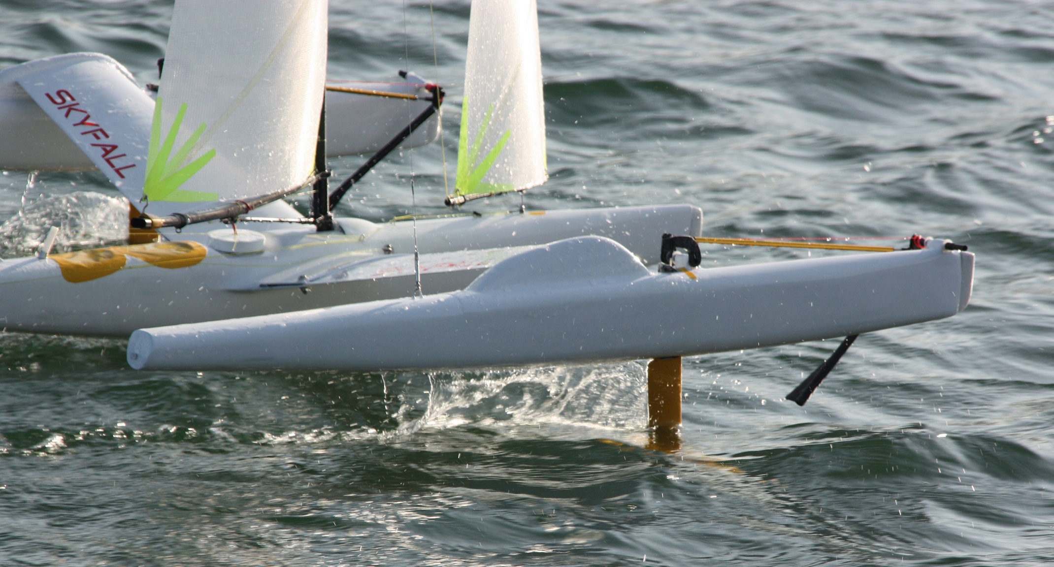

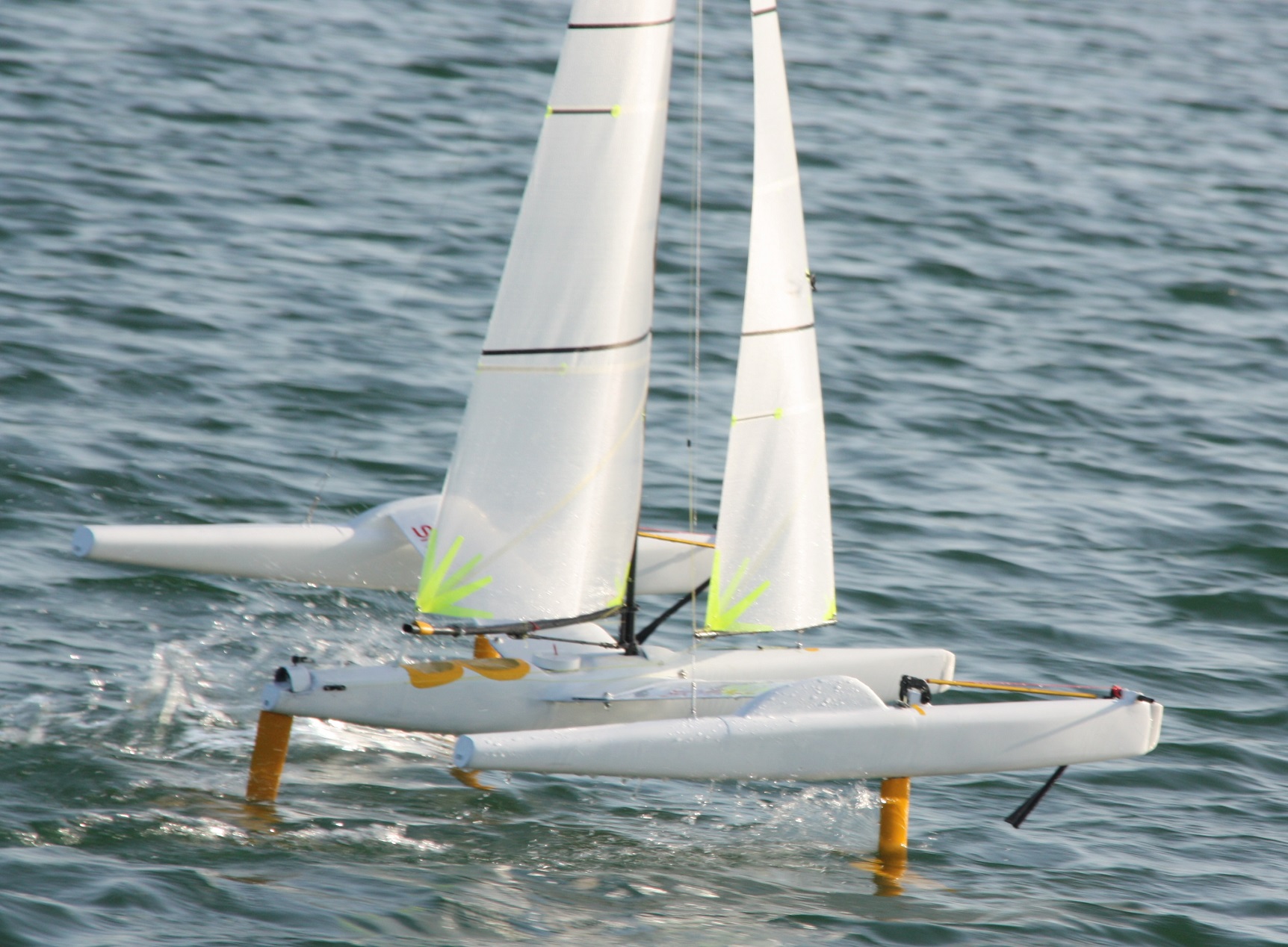

    Skyfall
    Ian, what is the boat weight and one main foil area? As a percentage, how much weight do the two mainfoils lift? Any numbers, regarding your design, will be interesting and appreciated...
    PS-there must be a story behind "Skyfall"?

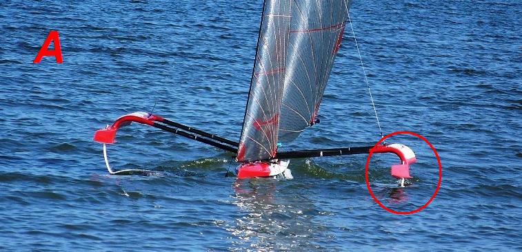

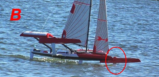

    17) Technical Impressions of the Foiling Fire Arrow:
    Above on this page is the updated list of mods made since the last video on July 24th, 2014. I've posted a list of the history of the development of this boat with all the related videos on this page as well, but I'm going to add another list and that is the things the worked the way they were supposed to-or better. The last video showed some major accomplishments of this design so far:
    A) The boat foiled in a 5 mph wind.
    B) the boat foiled in a 5mph wind at a weight of 21.13 lbs+ with just the main and jib. That is a major accomplishment because the main and jib have a combined sail area of 3390 sq.in. which is 160 sq.in/lb. The production RC foiler I designed 14+ years ago(F3) also foiled in a 5mph wind but she was 8lb with 1668sq.in. of sail or 208 sq.in. per lb.!
    C) This boat foiled using two completely different altitude control systems-for the first time on any size trimaran anywhere, as far as I know:
    a. The main hull uses a dual wand controlled flap equipped main foil to help the boat fly in light air and to add righting moment in stronger wind,
    b. The amas used a refined version of UptiP foils, pioneered by Team New Zealand in AC34, for the very first time on any trimaran anywhere as of July 24th 2014! My design for the Fire Arrow foils attempted to create a foil that would require little or no adjustment while foiling while keeping the ama flying as the main foil unloaded and the boat sped up. There are pictures showing this actually happening-"A" and "B" below illustrate the ama flying before the main hull while keeping the ama at about the same altitude even when the main hull flew-so these UptiP foils worked under two completely different load and speed cases-can't get much better than that. I think that the ama foils may have to have their AOI(angle of incidence) adjusted down during high speed sailing but we'll see down the line. No adjustments were made to the ama foils while making the last video.
    D) The foil configuration used by the Fire Arrow, as mentioned under altitude control systems above, is a one of a kind with tremendous advantages-particularly for an over square platform: Thanks to the wand controlled main foil the boat will fly the main hull in very light air which would be impossible if one waited for the sail force from the rig to allow the main hull to fly. The significance of that is that the oversquare beam is not a hindrance to light air performance and adds tremendous righting moment in stronger wind due to the very wide platform. But, the main foil isn't finished yet: as the boat speeds up the main foil is unloaded but as soon as it is required the wand controlled foil will add righting moment to the boat equivalent to half the boats weight or more! It does this because as the apparent wind increases and the boat heels a little more the leeside wand reacts by raising the main foil flap and that causes immediate downforce(righting moment).
    a. when the mainfoil is unloaded or creating downforce it "works with" the rudder foil in pitch control giving this platform tremendous resistance to pitch excursions compared to almost any other boat.
    b. the main and rudder foil together control the ride angle of the ama foil so that it is incapable of any sort of pitch reaction on its own-either up or down.
    This was one of the things so evident in the video and one of the great successes of July 24th.
    E) This doesn't mean the boat was perfect in the last video-the first full foiling video-I, as well as a few others, have pointed out areas that need work. We haven't sailed in strong wind with the boat working this well and there is plenty of refining to do(see the "mods" list above on this page). But I wanted to take a few minutes and point out the things that were successfully accomplished on July 24th, 2014. I hope I can get the help I need to follow up the excellent results on the 24th in 2015 in heavier air with some exciting video.
    All videos can be seen on my youtube channel here:
    https://www.youtube.com/channel/UC6S7JPG1d2uZ91lqt7ObyIw
    Pictures "A" and "B" as discussed in 19c above:

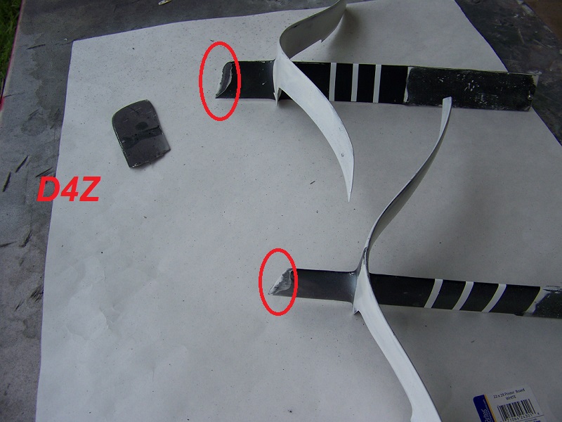

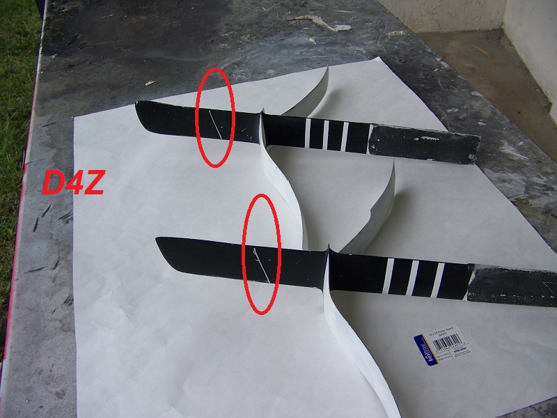

    D4Z, an AC 4.8(5.0?)RC America's Cup Cat
    I had some time so I decided to compare the D4Z daggerboard lateral resistance with that of the 20+ year old F3. It turns out I was able to reduce
    daggerboard area by almost 32% by matching the D4Z dagger + the projected vertical area of the surface piercing T-foil on its nominal flight waterline with that of the F3 daggers when flying. Should have done this to start with. The F3 would foil upwind and even tack on foils. The D4Z is designed to fly the windward surface piercing T-foil at an angle of heel of 4 degrees, so the areas were matched to one D4Z main foil. At that angle using one main foil the total lateral resistance area of the one foil is about 1% of sail area-same as the F3 using both its main foils.

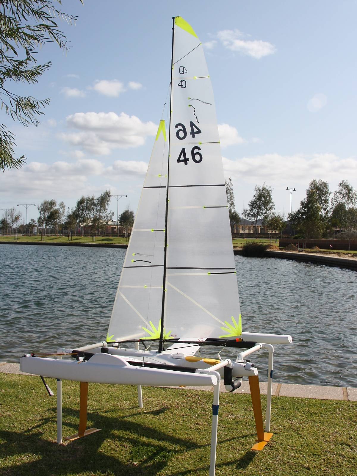

    Some foil stuff I find interesting about the D4Z at 8lb(incl. ballast system but no ballast).
    There are two main categories of hydrofoils-surface piercing and fully submerged. The boat now has a surface piercing T-foil on each side. If I put wand controlled foils on it they'll be identical to the F3 fully submerged foils:
    1) Surface Piercing T-foils(very experimental).
    a. area of one foil=30.87 sq. in before take off and as low as 12 sq. in. after takeoff. Altitude and foil area vary with speed. Designed to be able to sail on a single main foil with the windward foil clear of the water at a 4 degree angle of heel. Uses iFlap to increase lift at takeoff with the flap coming clear of the water after takeoff. Requires movable ballast.
    2)Wand controlled fully submerged foils-proven on F3 and Fire Arrow.
    a. area of one foil=17 sq. in before and after take off. Needs to always sail on two main foils-34 sq.in total. Needs 30 degree down flap to lift off. With 20 degree up flap windward foil can develop downforce. Whether it does so efficiently or not depends on the beam of the boat-the D4Z is probably too narrow for the wand controlled foils to work well. The foils on the D4Z would be 30" CL to CL compared to the same exact foil on the F3 at 60" CL to CL-both lifting the same weight. What that means is that the foils on the D4Z will have to work much harder to develop righting moment compared to the F3-and that will be slow. BUT, if the movable ballast system is used the foils could be unloaded so that they only have to lift the weight of the boat not the "extra weight" required to lift the boat AND create RM.

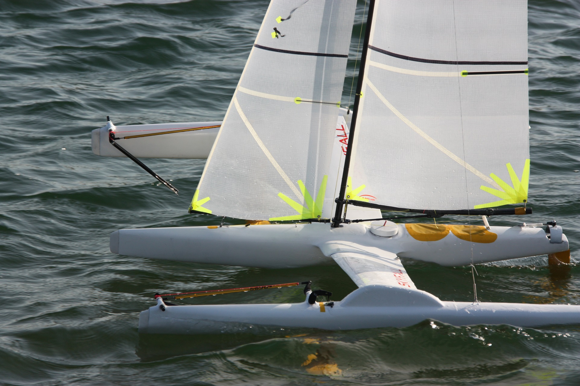

  11. PerthMini40man
    Joined: Jan 2014
    Posts: 117
    Mini40 stuff
    Saturday sailing is here
    https://youtu.be/6R6c89InfCE
    Sunday sailing and Daryn's winter swim is here. We need a canoe . . .
    https://youtu.be/dX4LJolHYSA
    The foils on my Firedragon are no longer connected to servos. I have burnt out 2 servos and was suffering from lack of power. I need to understand the electronics better before I repeat this idea.
  12. Doug Lord
    Posts: 16,679
    RC Foilers
    Always interesting, Ian. Sure would like to see some specs(weight, SA, foil areas) on the wand boat. Any chance of getting that info?
  13. PerthMini40man
    Joined: Jan 2014
    Posts: 117
    Hello
    I could give you the data you are interested in but really not sure how relevant it is, as surely the efficiency of the foils is more important? So far I have found that their shape - and especially their angle of attack - is the most single most important factor in getting the boat to foil. The weight is almost irrelevant other than a heavy boat is really handy in strong winds, and I have already used all 3 rigs on Skyfall
  14. Doug Lord
    Posts: 16,679
    Well, that info would help to see how efficient the foils really are-it's very relevant to analyzing the performance of a foiler. Since this is a design forum discussing and sharing details like that would help anybody interested in small foiler design. All the detail you're willing to share would be helpful.
    Foil loading is very important. You need to know the all up weight, the amount of weight the two main foils are carrying-usually around 70-80 % and the main lifting foil area including flaps. Sail area for the lowest windspeed the boat will take off is helpful. CL to CL location of the T foils is important for determining how foil loading is affected by the need to develop righting moment on a wand controlled foiler. The angle of incidence of the fixed main foil(s) is important.
    I think we could ,possibly, both benefit from a detailed discussion of the design choices you've made on your wand controlled foiler and it would surely be interesting for others as well.
  15. PerthMini40man
    Joined: Jan 2014
    Posts: 117

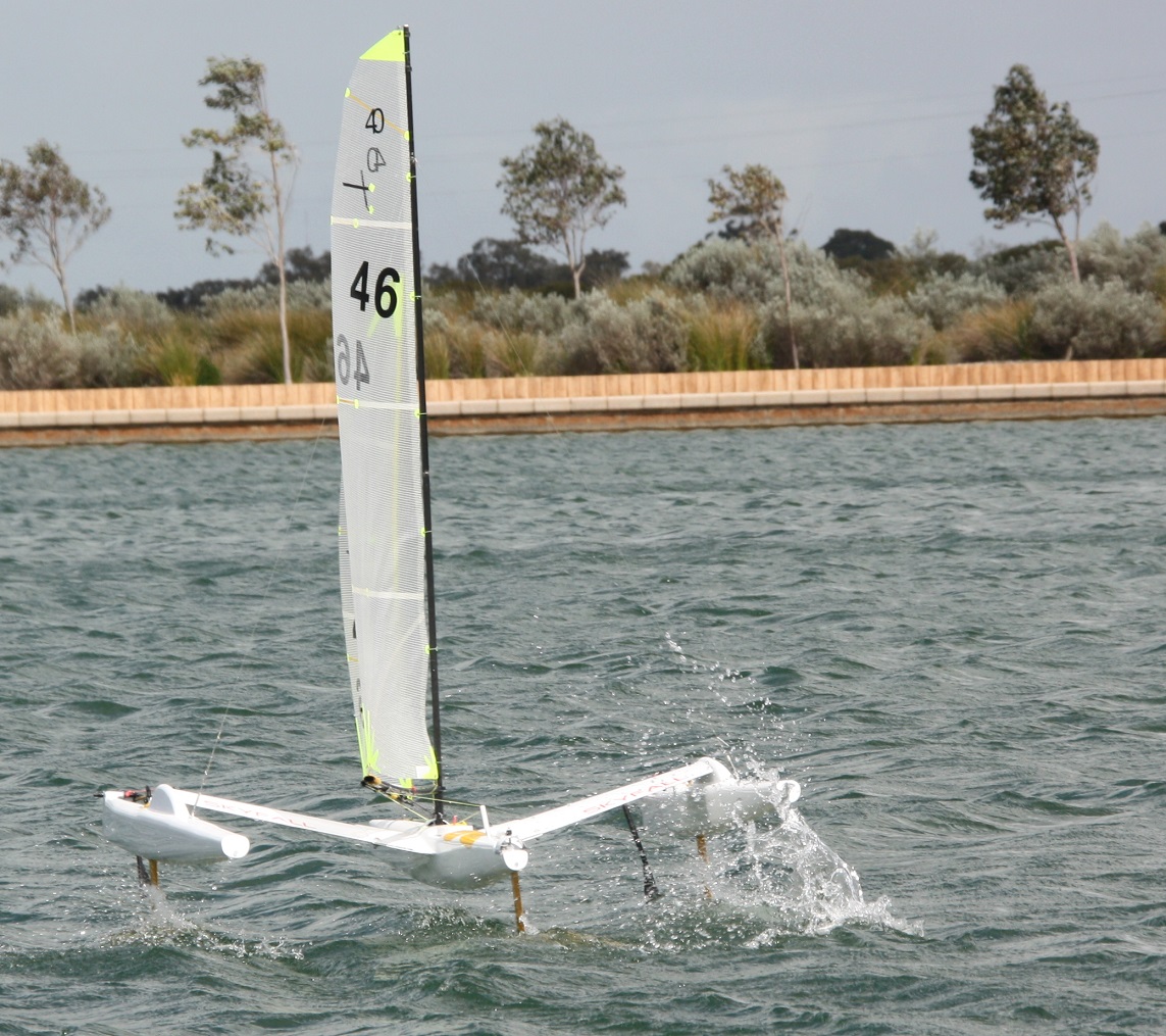

    Sailing weight = 4.2kgs
    Max sail area = 0.9sq m
    T foil area (each); fixed section = 16cm x 1.3cm. Angle of incidence = 2 degrees. Flap = 16cm x1.5cm
    Rudder foil = 18cm x 3.5cm. angle of incidence = zero
    T foils are 118cm apart
