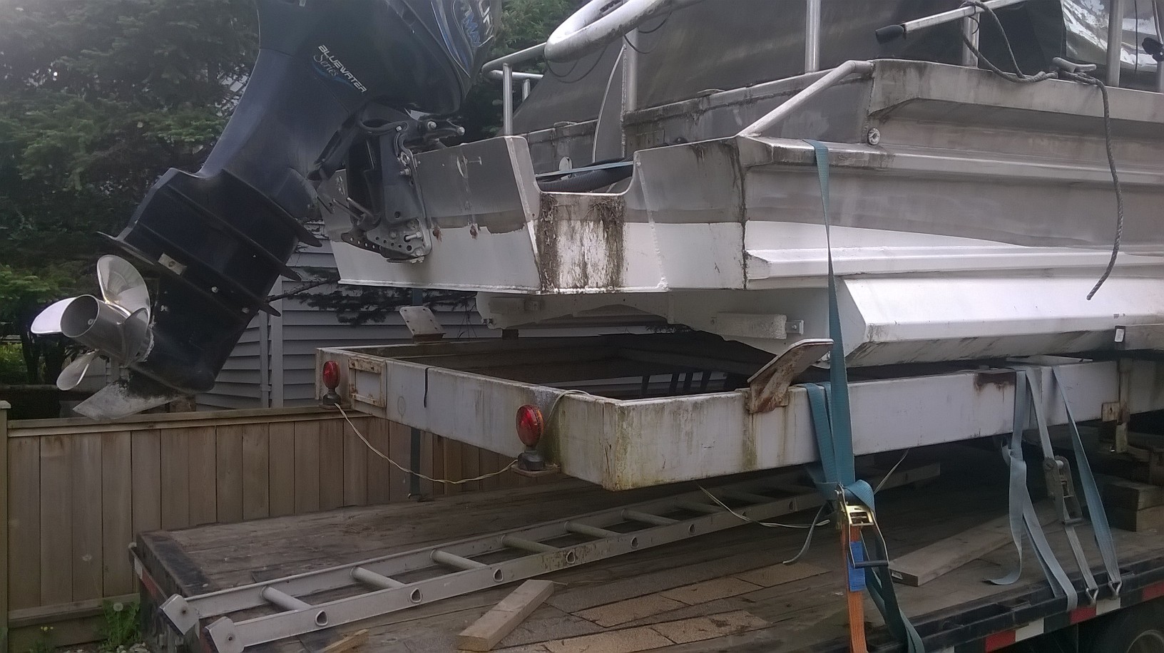

How did you determine the outboard positions and spacing in those photos?
BB
Good Question BB. The engines were mounted at the shop of the company which manufactured the hydraulic jack plates I selected, that allowed for a 6" vertical adjustment. Bob's Machine Shop of Tampa, Florida also modified the lower units with low water pick-ups which allowed for an optimum running height at speed, reducing drag and enhancing an already impressive shallow water capability.
Like the 18', the 27' retained some invert all of the way to the transom, so the center line of each motor was lined up with the inner edge of each keel flat. Initially, we tried to do without a tie bar to ensure proper engine alignment, by setting up the hydraulic steering in a certain manner. This worked, but not well enough, so we ultimately installed a bar.
Overall, it all worked quite well and I would do it again.

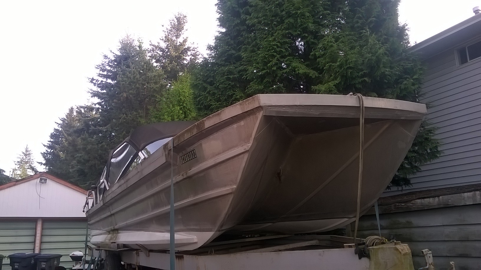

More of Robint777's boat.

Those latest pics, DC, suggest that the outboard leg is running pretty deep, unless the photo is deceiving, it has the kind of leg that might allow that, with another splash plate about 5" higher than the cavitation plate. I'd prefer a leg like that, if there is doubt about the prop getting clean water. Some legs get somewhat less streamlined, not far up from the cav plate.
