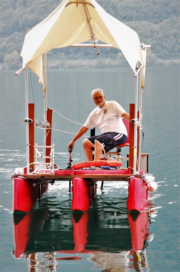

    I have a 12' (3.66m) trimaran which I would like to turn into an electric hydrofoil airboat.
    Questions:
    1. Does anyone know of an 24-48 volt outdoor motor capable of turning a 48 inch or so pusher prop powerful enough to get the boat (1000 pounds total weight, boat and people) up on a hydrofoil?
    2. Any ideas for a retractable hydrofoil for a trimaran?
    Everything above the deck in the photo can be removed in the reconfiguration.
    Thanks

    kerosene Senior Member
    No.
    I give a no to the general concept of:
    -12 ft tri (quite short for getting near foiling speeds)
    -retractable foils (retractable in itself is not impossible but add weight and complexity)
    -electric powertrain for such srtup is really challenging as more power means more batteries means more power needed...
    Electric foilers so far are:
    -hitech builds, heavily engineered, carbon compositrs etc.
    -optimized for one purpose an generally _very_ limited range
    What is your ballpark budget and ideas for power (hp or kw)?
    Sorry to be negative.

    Kerosene, I have no problem with your comments; they were negative in a knowledgeable way! If you have time, I would like some more information, such as:
    - please explain why 12' is too short for foils. I see foiled windsurfers all the time here at Lake Como. Is it a weight to length issue?
    - there retractable foils I am thinking of are not high tech. I thinking about a hinged or daggerboard type design which could simply be opened/dropped into position once out of shallow water, then locked.
    - as for power needed, this is one reason I posted. I have no idea how much power a standard swamp/airboat needs, but I would guess that I would need less. I am not looking for super speed, just a nice pace on foil.
    Thanks

    The book is a great first step.
    You will learn weight is the enemy.
    Too bad it has to be retractable, it adds complexity.
    It is completely doable.

    Why do it if it's not necessary?
    The added complexity means added challenge, design, compromise, weight, cost, work, and maintenance.
    Did your book arrive?
    Can you get rid of the centre pontoon?
    You have the budget for Lifepo4 batteries, right?
    "Everything above the deck in the photo can be removed in the reconfiguration."

    Bluebell got there before me; remove the centre pontoon to reduce weight, wetted area and for lower centre of gravity (with remaining pontoons immersed a bit more).
