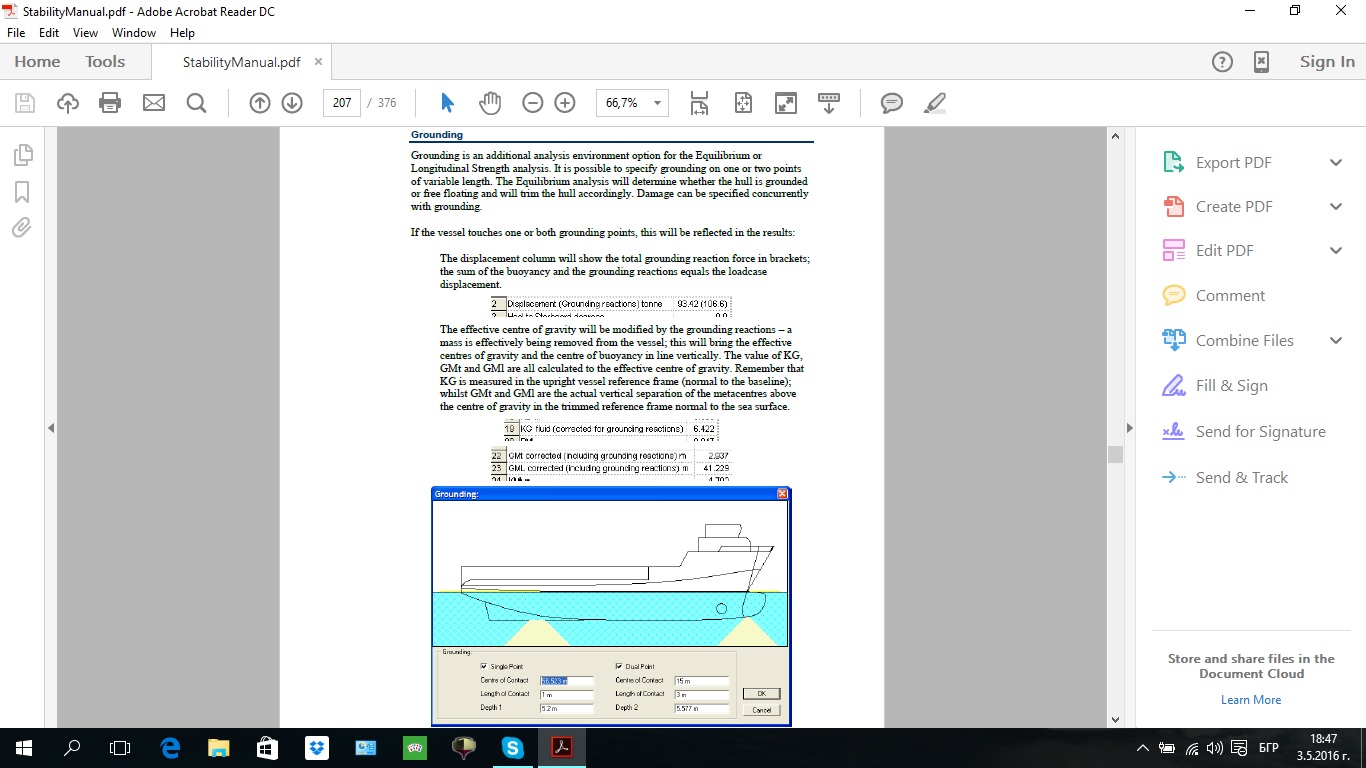

    Hello everybody,
    For those from you which are interested in computer calculation of the grounding I want to show the capabilities of the program Maxsurf Stability.
    See the file from the Maxsurf Stability Manual.
    ______________________
    NA Razmik Baharyan
  13. Niru
    Joined: Jul 2010
    Posts: 50
    Likes: 1, Points: 0, Legacy Rep: 32
    Location: Philippines
    Niru Mr.
    Good day Rabah.
    Have to check this on my free time. never thought its possible on maxsurf stability.
