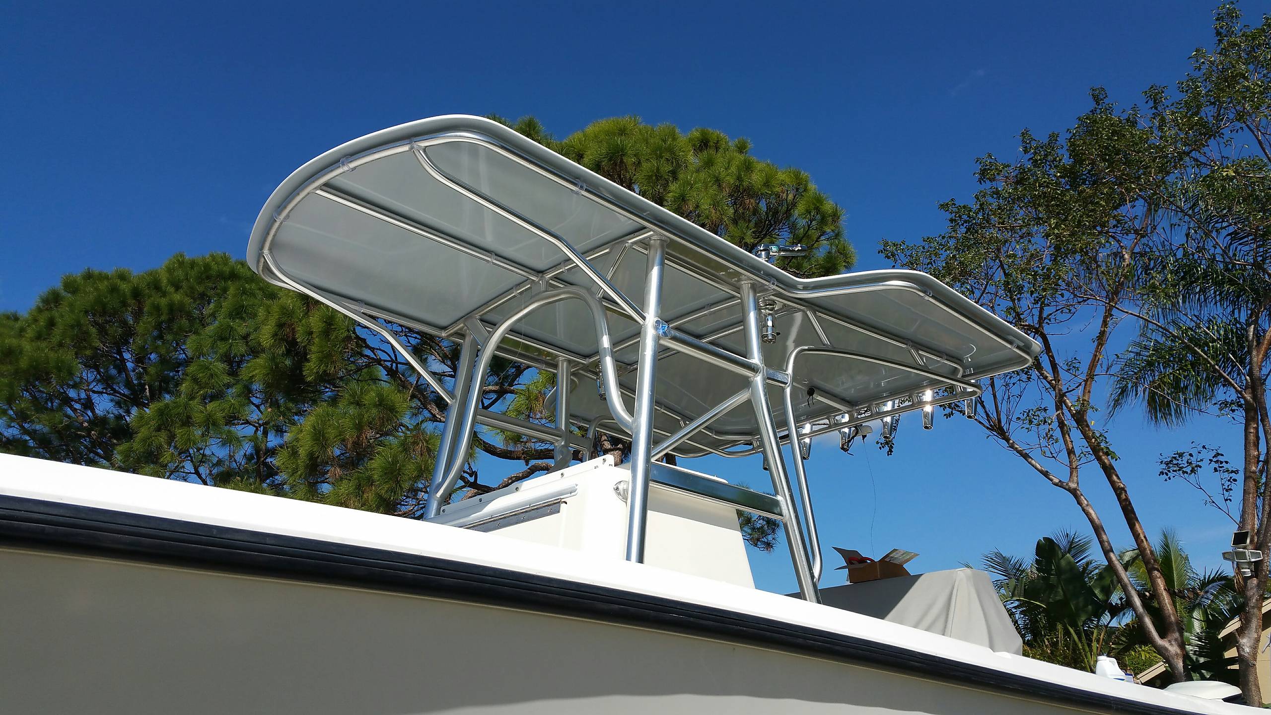

    OK, I guess I don't have a clue but I'm not sure you do either.
    How can this top "oil can" with all the support from the frame as shown in the picture below? You can do chin-ups on any of that tubing and it doesn't move. In addition, there's two layers of 10 oz and then 1708 on the top as well. It's not exactly "flimsy".
    If it rips off I guess you can say "I told you so" but I'm using the Sikaflex 221 with the 205 primer. I'll also have 4 attachment points.
    Wish me luck.

    Thanks for the picture. There is plenty of framework there. That's what I meant by "bows underneath". I didn't know what the T top frame looked like. All that framework often is built inside the hardtop.

    I don't think your top will oil can (seems too well built for this), though I do think you'll have a "zipper" failure in the bedding, without significant hard mounts, regardless of what this might be. These sealant/adhesives are great for some plastics and in locations where high elongation is required, such as dissimilar materials, but once you get them started, they tend to zipper along until something stops them. A good example of this behavior is the little rubber strip on the back of a gift card, that attaches it to the cardboard it's sold on. To remove this little rubber strip, you pull on one end and it stretches out, pulling more and more until the whole thing releases. Another example is the picture hanging strips they now sell. You apply them to a wall and they have a little hook imbedded in the adhesive, they hold fine, but to remove them you grab the tab and pull, where it then comes off cleanly. The adhesive deforms, stretches and peels right off.
    My previous comment about a bonded hard point is simply bonding (directly to the laminate, not the paint) a "T" or other shape (metal of course), that can be physically attached to your top cage. I understand your not wanting penetrations in the nicely built top, which is why I suggested this approuch. I'm assuming the top has a perimeter frame, probably of aluminum? Even if it doesn't and the top is stiff enough a plate with a bolt or perpendicular welded to it could be bonded, then attached to the cage. There is a stainless piece for this used on binimi's and windshields. It's designed to be machined screwed, but could be bonded as well. Picture a length of pipe, cut in halve or nearly so.
    If you made these up yourself, they could "capture" the top without bonding, assuimg it couldn't flex enough to release itself from the containment.

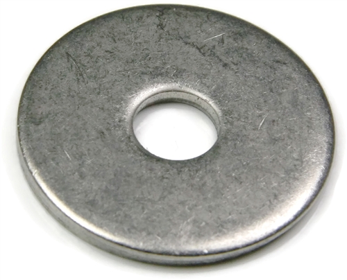

    That's a nice fitting PAR. He could use stainless steel structural washers under the head of his machine screws to spread the load a bit and make a nice looking top as well. I used these structural washers all over my boat where I needed additional strength to bear heavier loads. All of my cleats, the attachment points on the swim platform and railings were done with these washers and nylocks. I've never had an issue with anything loosening up or crushing.
    I understand that you don't want to drill through your top fly, but if you have a change of heart........well these would serve you well.
    https://www.albanycountyfasteners.com/Fender-Washer-Extra-Thick-18-8-Stainless-Steel-s/767.htm
