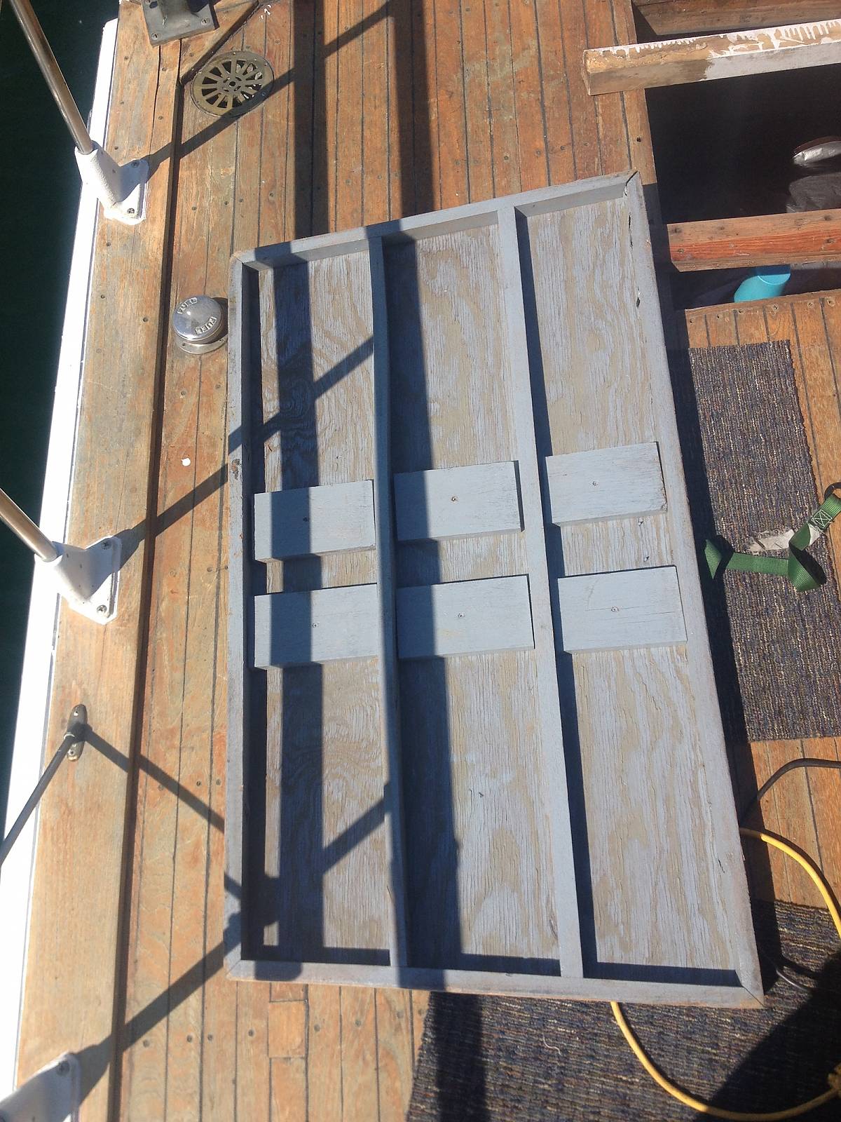

    Hello !
    long time lurker, i just joined :
    I've got a flush wood deck hatch that leaks like a sieve - relatively large - about a 24'' X 48'' trapezoid shape on a cambered deck - it's not hinged - and doesn't need to be - just a drop in setup - and thats fine with me. previous owners have had at it and i'm just about finished peeling off layers of muffler tape and damaged fridge seals. i'm not certain what was initially in there - after 50 years on there isn't enough archeological evidence remaining of a gutter system - but that is what i think would offer up the driest solution- the hatch is over the tank room -but when it leaks it ends up getting into the aft cabin bulkhead - which i've just replaced - re: 50 years of leaking finally took it's tole on the material there.
    a gutter system might be an ideal solution - as I tackle ALL projects at the same time on a new (to me ) boat - i'm trying to find the easiest solution possible to trying to keep a wood hatch cover in a wood deck - i can re-used the existing hatch cover (although it will need replacing/repair in not too long)
    does such a thing exist as an aluminium or stainless extrusion well suited to gutters ?
    there are plenty of options (deck scuppers ) to plumb it into - it's mainly the gutter system - B plan could always be plywood and epoxy - i'm just curious if there was faster solution...
    thoughts, comments or ideas are all appreciated !
    many thanks
    marc

    It would depend on the construction of the hatch. Can you post a photo? There are several possible solutions.

    bottom side of hatch cover
    hatch opening

    The typical solution is a frame made of U-channel welded at the corners with one or two downpipes. Connect hoses to the pipes and drain to the bilge or outside.

    You can make a copper, aluminum or stainless steel channel, which is difficult without some metal working skills. You can also build it from wood or even a 'glass channel. The wooden one will be in keeping with the boat, the 'glass one will be more water tight. It's not an especially difficult thing, though a little tedious getting the deck crown and sides worked out, with drainage. You can bend some aluminum U channel to work, miter the corners and install some drains, to pee through the transom or under the rub rail. Considering it's relative exposure, I'd make them deep, with large diameter drain hoses.

    Usually these types of hatches have a flat stainless strip around the perimeter to prevent the hatch from falling through. The one photo shows where this might land.

    large diameter .. 1/2''
    or larger ? for the channel i'm considering 1'' flanges by 2'' webbing - sufficient ? insufficient ?

    I've done many wooden hatches that don't leak either, though the caveat is initially. Eventually things start to move, unless encapsulated and/or sheathed with something. Soldered copper works well and doesn't corrode, welded stainless, bronze and aluminum also work well. A well done 'glass laminate will also tend to have serious durability, without leaking.
    As to the size of the perimeter channels, you really can't go too big, but sure can be undersize, so 1" wide and 2" deep sounds slightly small to me. 2"x2" sounds about right, at least to me. A couple of 1.5" drains would be a good start, to get the water out of the channel as fast as practical.

    Thanks Par - 1.5'' drains is great direction - useful information.

    it is huge, a person COULD fit a bath in there or even a tender - the premise was being able to remove the tanks from the aft hold if required - i've got a goodly amount of rot to repair - but I thought i'd start with fixing the problem that caused the rot in the first place and go from there, the P.O had scabbed in some replacement 'joist' sections where the originals had failed = known issue causing rot - i've now replace the entire aft cabin bullkhead - and will redo the 'scabs' with some white pine - this mainly so i can mill them back to reset 1/8'' thick aluminum plate frame - to which i'll weld some 1'' deep by 2'' wide gutters - with 1.5'' drains in both aft corners -
    The hatch lid sits in the actual gutter - so no point in sealing the hatch - just manage the water - which i think was the original intent with the wood gutters. Once i've got that working...it's looking like the aft deck and some framing is going to need a complete going over :(
