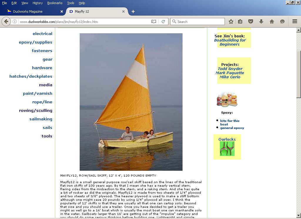

    I'm thinking the large payload on a relatively short boat does not make for high performance. I think it would be better to have a boat intended for more modest performance, that will not disappoint when loaded down.
    Another problem with dinghies intended mostly for racing is the Center Board tends to be in the middle of the boat, if not far from it, on the center line of the boat. This robs sitting space.
    Attached is a design with plans you can get for $27 US.
    It is very simple, definitely not a thing of beauty. Its Centerboard is moved so far over, its out side of the hull. The designer calls it a "Lee Board". But there is only one. And, other than it being outside of the Hull, it functions exactly the same way.
    Building this 12ft boat in a 12 ft shed could be a problem. Probably best to build it outside and store it in the shed, when you are not working on it.
