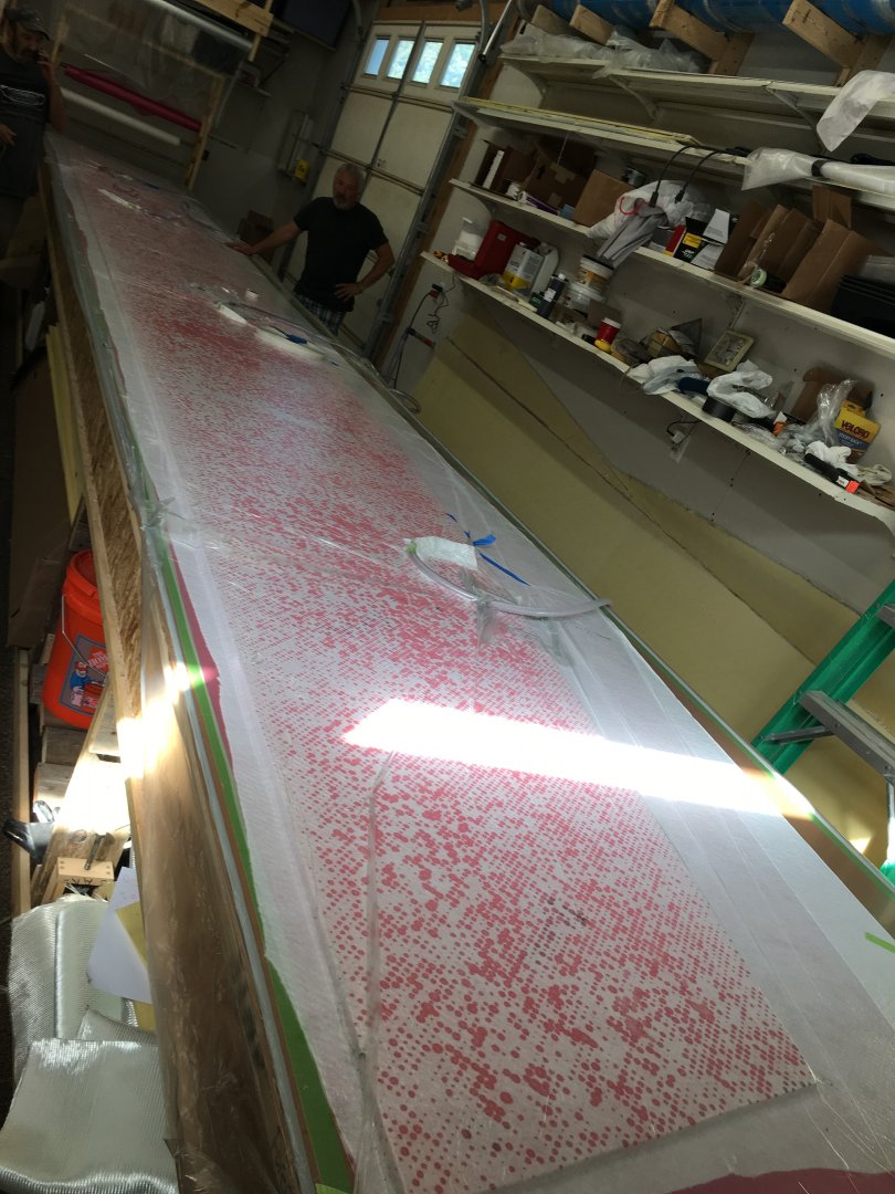

    No way would I build a Merten's small boat in foam. The build speed with plywood is significantly faster. To be honest, if I was to start over. All of my work would be done with infusion. Wet bagging is stressful. Wet bagging also has higher waste rates than infusion. The issue is you don't have 60 minutes to play with and minimize resin use. From the time you mix; you have about 50 minutes to get the parts in the bag before gelation. This includes wetting both sides for a two sided layup; wetting the downside core. Wetting the topside laminate which is the same size. Peelply laid nicely. Release and breather and bagging. Removal of gum tape backers on 3 sides. Laying the bag well. Pleating. All must be done before gel or you entrain air.
    Here is a 33.5' panel in the bag. These used a tropical epoxy that was post cured as a whole hull in an oven. Our times ranged from 110 to 63 minutes on these large panels with 120 minute epoxy. Two of the 8 large panels were rejected; likely due to the bottom side gelling too fast on us and entraining air. Those pieces were used in other less exposed areas of the build. I am in my 4th year of full time work. The 33 foot panels were built with a three person crew. For 16 foot panels, you need two people for wet bagging.
