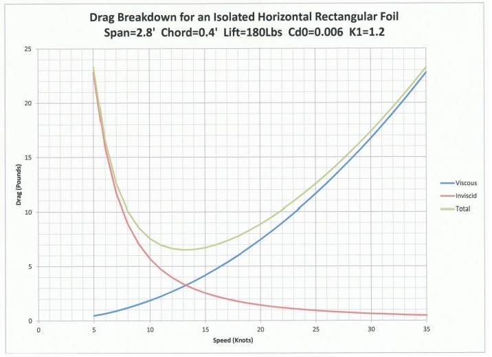

    I believe for the IQfoil (foiling windsurfer) both the sail area & foil area are specified. How much of a disadvantage say 10 or 20 kg of extra weight would then be? For the Formula kite, the foil area is specified, but they can choose from 4 kite sizes, 9 sqm to 15 sqm, depending on the wind & rider weight.

    It is probably oversimplified, but assuming the total drag D is the induced drag of the foil, D ~ L² (squared lift) and weight W= L (lift of the foil).
    the thrust T = D, as T ~ (Vapp)², square of apparent wind, you get dVapp/Vapp=dW/W, so you need more apparent wind to achieve the same velocity.
    An accurate VPP wuold be necessary to get exact figure !

    That is indeed oversimplified!
    Induced drag is the largest contributor to the total drag at low speeds, but it gets smaller as the speed increases. Friction has an opposite trend, being small at low speeds but becoming the dominant contributor at high speeds.
    The result is that curves of total drag versus speed look quasi-parabolic, similar to that shown below. The locations of the drag minima vary with foil parameters and lift, allowing designs to be optimized for low or high speeds, heavy or light skippers, etc.
    Mikko Brummer, Skyak and revintage like this.

    I agree, but the question was the disadvantage for an heavy skipper using same foil and same sail than a lighter skipper.
    You should give the same curve for 210 Lbs of lift, which will show the drag penalty !

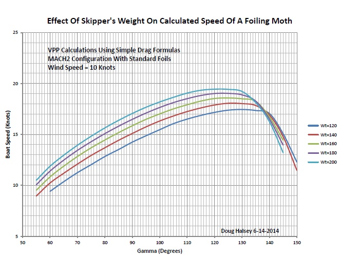

    The drag curves only tell part of the story, and only for specific configurations & conditions.
    I did some VPP calculations a few years ago for a Mach2 Moth showing that even in very moderate conditions, heavier skippers had a decided advantage. I suspect that the assumed value for the center of pressure of the sail was unrealistically high, but that just helps emphasize that many factors enter into the analysis, making simple answers difficult to accept.

    I expand on this by saying that wind conditions are important to the question of advantage. A nation could send an excellent team of heavy sailors and get trounced in light wind. It would be wise for a country to make sure they cover the wind spectrum. The problem is highlighted by looking at takeoff time at different wind speeds -if you are heavy you will never make up the time lost getting on the foil. I would also note that these board classes where the craft weight is small compared to the skipper and sails are not at a a fixed angle allow jumping onto the foil in ways normal sailboats can not -with pumping and jumping. The NACRA 17 does not have this luxury, but it is a surface piercing foil which is different due to variable area.
    An excellent example of foiling weight advantage was the last Sail GP series in Italy. For maximum advantage in light wind they dropped the grinders and sailed the F50s with a crew of 3. It's on Utube and I would recommend it.

    Thanks, Doug. Very interesting curves, and counter intuitive to me ! looks that the optimum weight with your hypothesis is well above 200 Lbs ! So the Righting Moment looks as critical parameter. I assume you accounted for windward heeling contribution to RM ? Looks like when you compare to a Floating Moth, heeling moment arm increase with flight height, and also sail is higher in the surface wind gradient which increase sail force !
