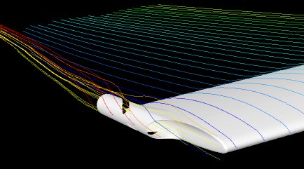

Tip vortex reduction
I want to thank you everybody contributing to this forum!!!
There has been great stuff above about effective foildesign. However I wonder if the vortex at the tips of a hydrofoil is a problem and if it could be reduced.
/Niklas Lundberg (Sweden) :confused:
NiklasL said:
...I wonder if the vortex at the tips of a hydrofoil is a problem and if it could be reduced.
Everythng one does to reduce induced drag reduces the tip vortices. This inlcudes increasing the span (most effective way), shaping the planform, and adding tip devices (like winglets). The vortex is not shed just at the tip - vorticity is actually shed wherever there's a change in the spanwise lift distribution. (There aren't many hdyrofoil illustrations of this, so I'll have to resort to using aircraft as hydrofoil analogs.)
If the condensation over the wing in the photo above roughly represents the spanwise lift distribution, one can see that its slope is greatest at the ends where the lift has to go to zero. So this is where the shed vorticity is the greatest. If there's a rapid change in lift elsewhere, a vortex will be shed there, too, like at the ends of partial-span flaps:
In between the vortices is the downwash region, in which the flow has been deflected by the foil:
But this downwash affects the foil, too, acting as a downward current that the foil has to continually "climb" - this is the origin of the induced drag.
The best way to reduce the downwash and cut the drag for a given amount of lift is to make the span greater. This deflects a greater amount of fluid a lesser amount, which is a more efficient way of producing the same force.
If the span can't be increased, then the next best thing to do is to optimize the shedding of the vorticity along the span. It turns out the induced drag is mimized when the downwash velocity is constant along the span, and proportional to the dihedral angle of the foil. This applies to struts as well as horizontal foils, and it's possible using computational fluid dynamics to design a planform shape and twist to accomplish this, taking into account the interference between the various components.
It's possible various tip treatments can reduce drag, although it's not easy to design something that doesn't add as much parasite drag as it saves in induced drag. Otherwise, there's no net benefit. The best improvement with the least parasite drag typically comes from extending the physical span.
